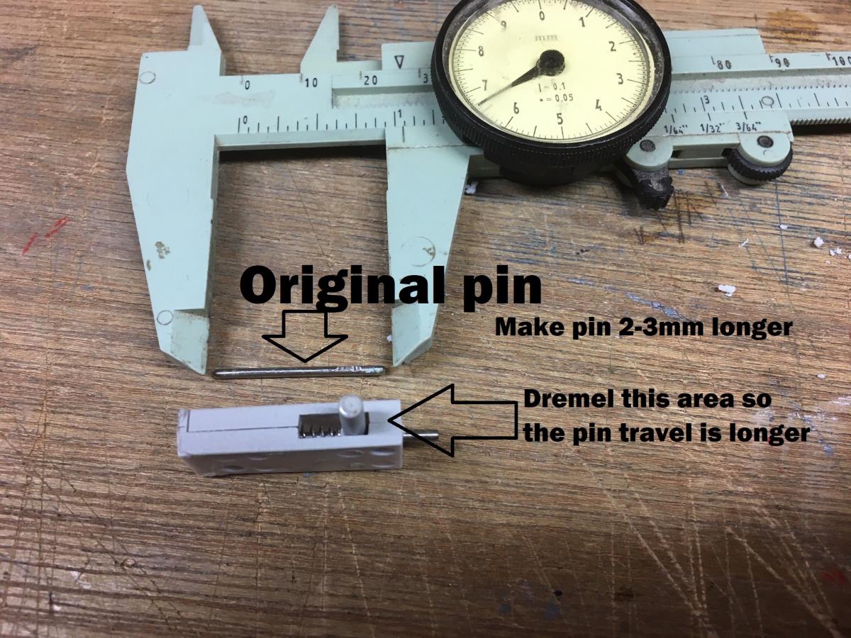

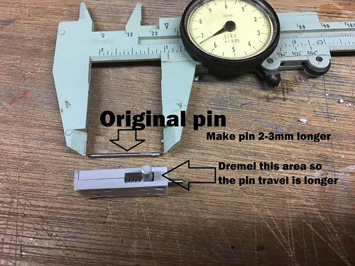

                              what is the canopy mod.. searching here doesnt make it show up
                              • sam51401
                                • 368
                                • Sellersburg IN
                                #1175
                                Modding the rear hold down. I added additional plastic plate across the rear edge of the canopy that filled the gap left when the canopy is seated. I think I used about 3/32 or so thickness which gives the pin more to latch to.
                                  • 5385
                                  #1176
                                  I put a thin foam strip along the front and then spaced the hold down plate a little. I also swapped the pin in the latch for a little longer one. Gave me the same gap front and rear.

                                    #1177
                                    Evan
                                    How did you install a longer pin in the latch? I am currently putting a magnet at the rear of the canopy.
                                      • 5385
                                      #1178
                                      The pin is just a short piece of piano wire. I pried the latch out of the wing, split it in two and the little post has a set screw on it, undo the set screw and use the old pin to measure a slightly longer one and then reverse for install. I think I put pictures in the thread on RCG but maybe here too.

                                          • 5385
                                          #1180
                                          I really helps too. Until I did that there was enough flex to pop the canopy.
