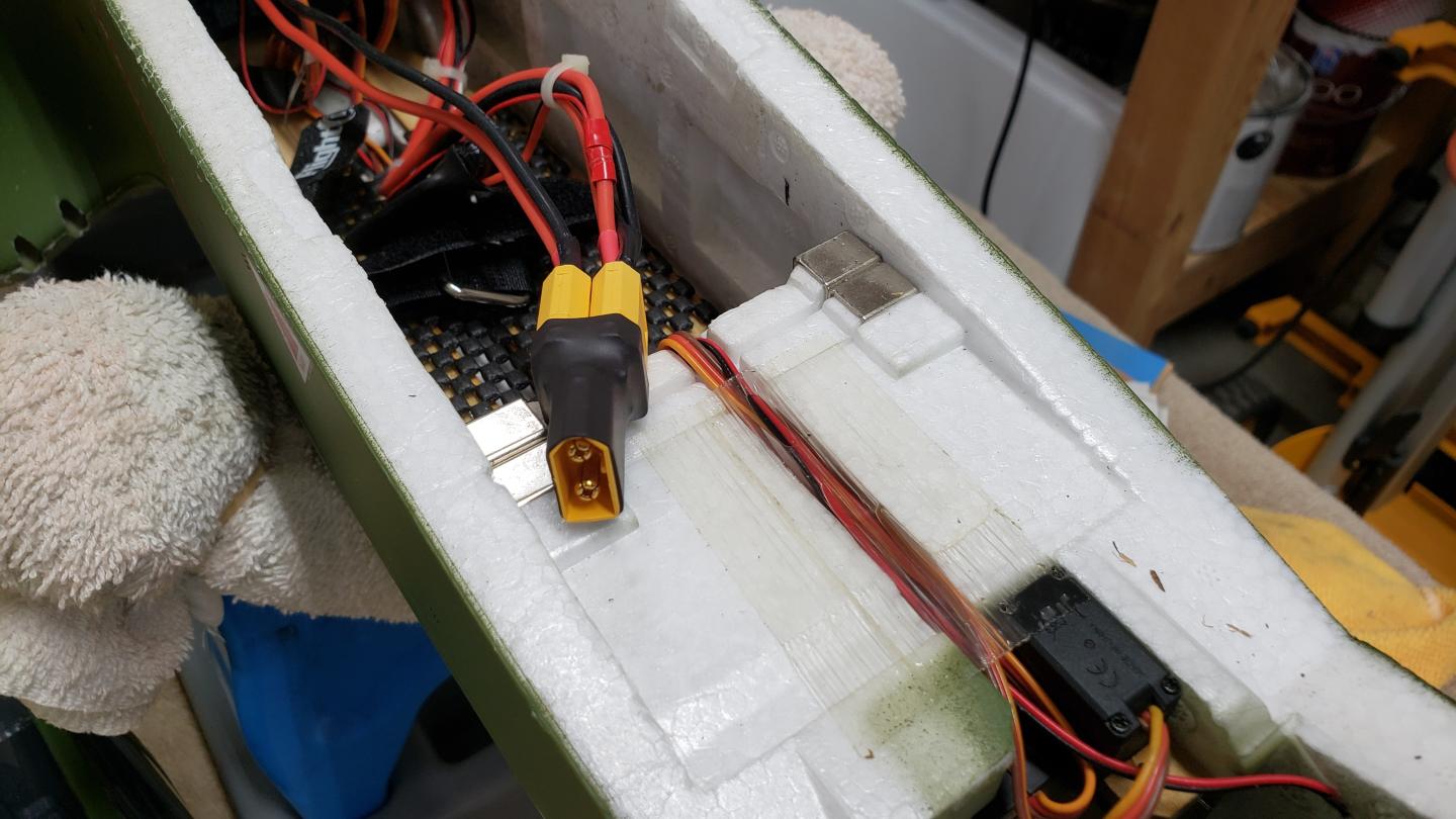

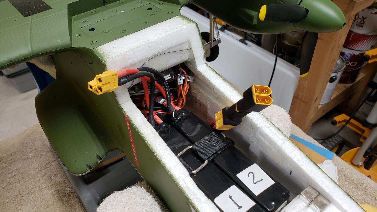

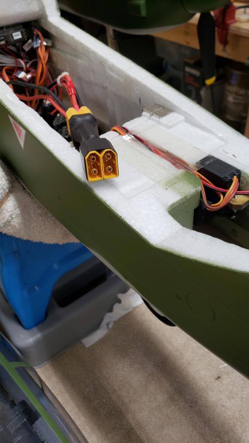

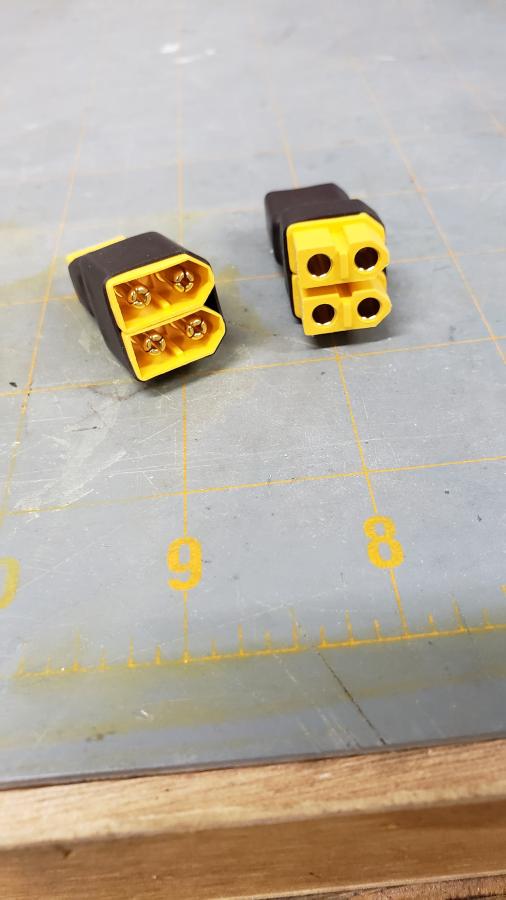

                                  “I always wire my twin setups in parallel so to avoid a catastrophic engine loss on a twin due to losing a battery dedicated to a single motor.”
                                  Ever since I read OV10’s comment in his build post (#42), I wanted to wire my OV-10 batteries for parallel operation just like his. Soldering XT60 connections is daunting enough but soldering them hanging out of the fuselage was not happening and I really didn’t want to dissemble the wing.
                                  Here’s my solderless solution and completely “plug and play”. 1 each BenchCraft XT60 Parallel ESC Adapter to plug the ESC’s into and 1 each BenchCraft XT60 2 to 1 Parallel Adapter to plug the batteries into. Plug the adapters together and you are in business. With only the ESC adapter you could use one large battery.
                                    • 5385
                                    #1217
                                    Just remember you have the power of both motors going through one XT connector.
                                    • Uncle Bob's RC
                                      • Mar 2020
                                      • 11
                                      #1218
                                      Thanks, I hadn’t considered that. I’ll check the actual amp draw of each motor at full power tomorrow. From what I’ve read, the XT60 should be good for 60 amps. Two 30 amp ESC’s = 60 amps. I’ll only be using full power for takeoff and some occasional aerobatics.
                                        • 5385
                                        #1219
                                        Yes, the stock set up isn't that powerful, that's why I said "remember" and not "caution". You should be fine. That said it would be best to solder a jumper between the wires instead of using adapters, I really dislike using them... :)
                                        • Uncle Bob's RC
                                          • Mar 2020
                                          • 11
                                          #1220
                                          I agree that a jumper would be better and at some point I will probably do that. With a watt meter this morning I got 50 amps running both motors at full power.
