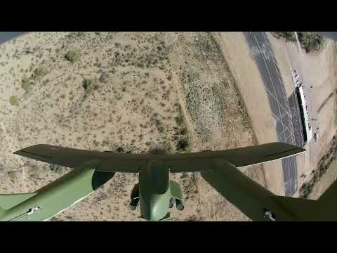

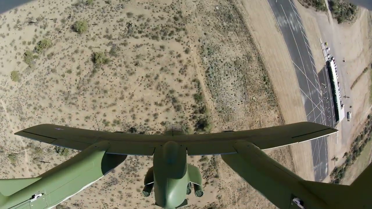

                        I had a nice flight today. i think I can get at least 8 min of flight time from the 4s 3000mah batteries. Maybe even 9 or 10 minutes. Here is a video for you.

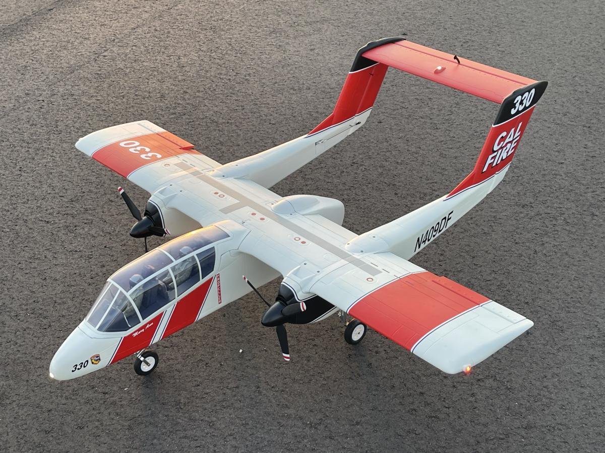

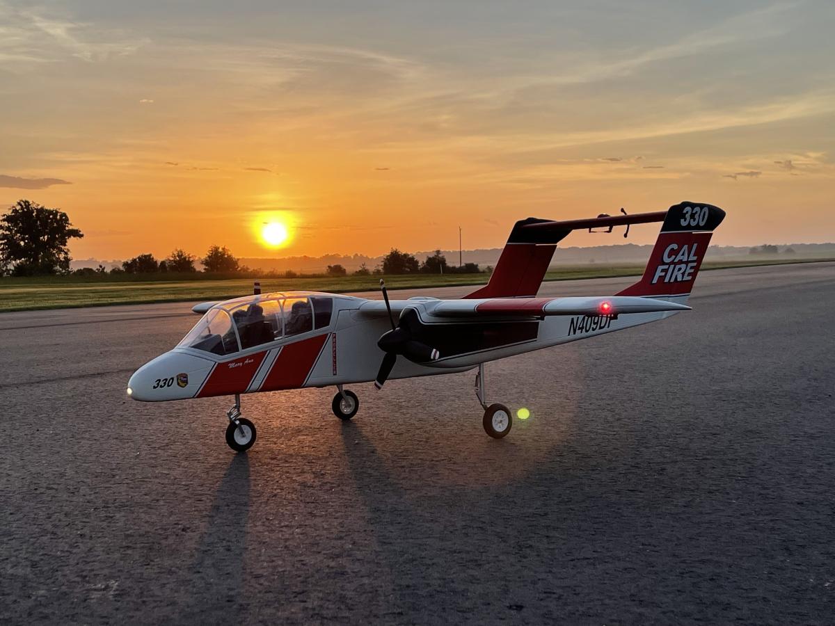

                                          Just wanted to share my recent re purposing of my Bronco to a Cal Fire (fighter). I'm into red and white these days.
