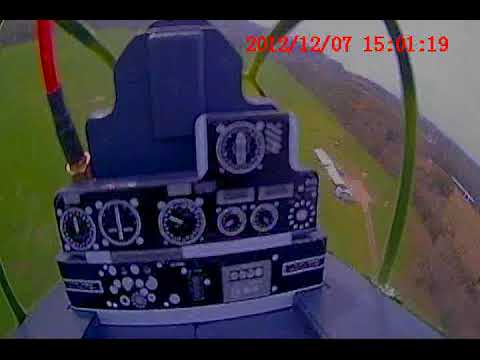

                  • Here's what mine looks like, I just did a headlight restoration kit on the plastic with this one.
                    • Here's from the back seater.

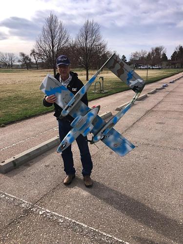

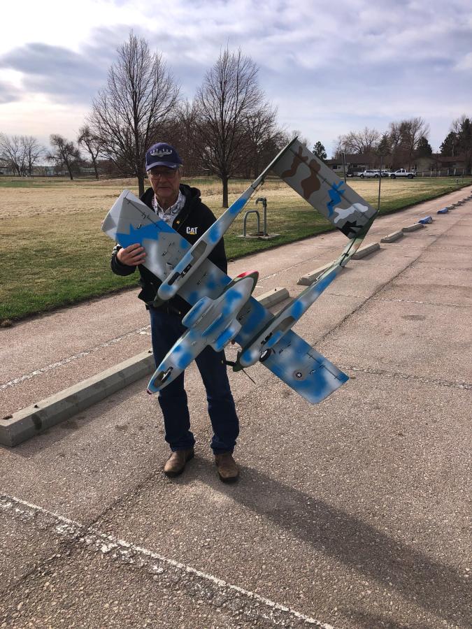

                                        • Test flew this one My Brother gave me for my Birthday last month. Great flying twin Military Aircraft
