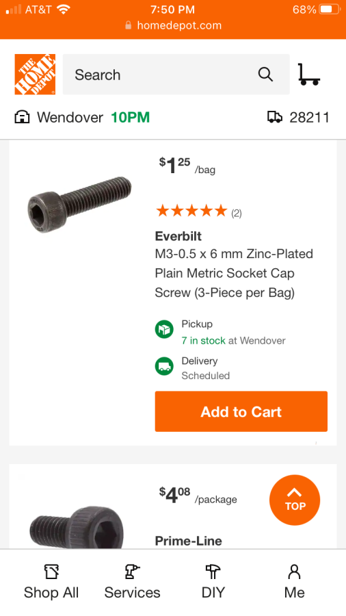

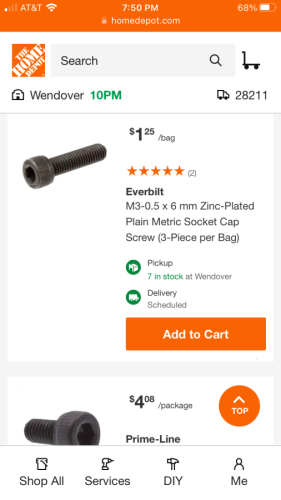

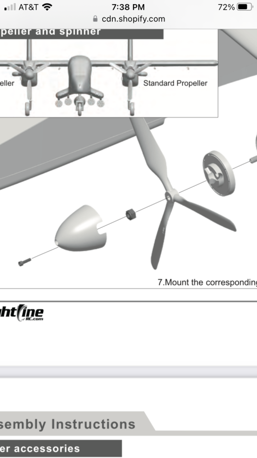

                My name is Phil. I'm looking for a place to buy Flightline OV 10 parts. In particular the metric allen spinner screws. I got them with the kit but can no longer find them...... Thanks !!
                  • 5385
                  #1368
                  Click image for larger version  Name:	A18C25B1-2C25-43DB-A45C-B73204B94FC4.png Views:	0 Size:	120.9 KB ID:	383116Click image for larger version  Name:	62406412-B8F4-4BCC-B298-7D54895B232F.png Views:	0 Size:	0 ID:	383117
                  The M3x6 small screw? I’m sure I have lots of them in my spares. Where are you located?
