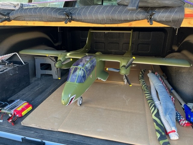

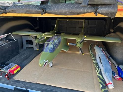

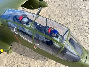

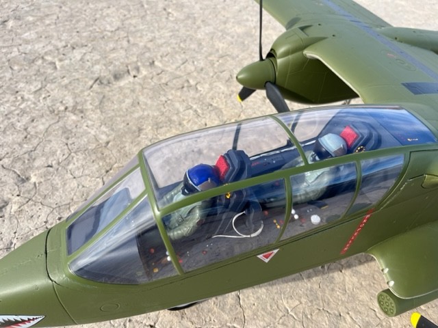

        Maidened mine yesterday. Four excellent flights. Click image for larger version

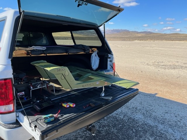

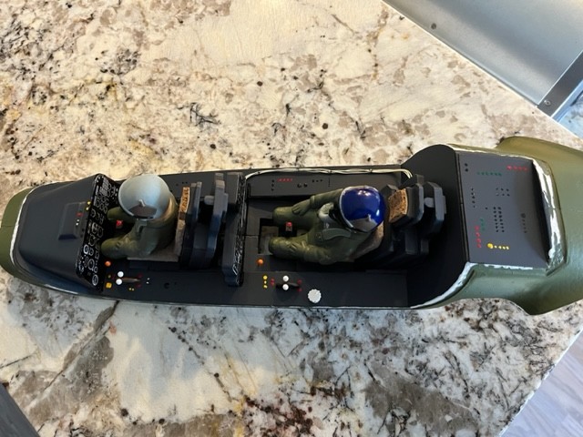

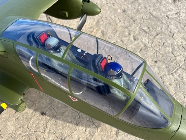

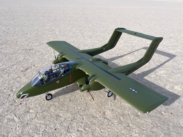

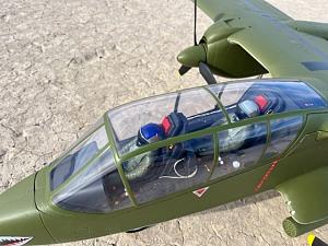

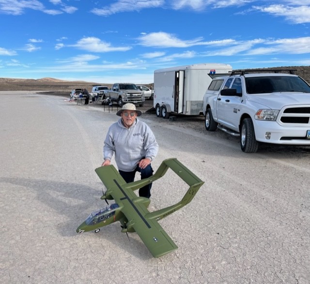

                      3 more amazing flights! This is becoming my favorite R/C airplane! Click image for larger version

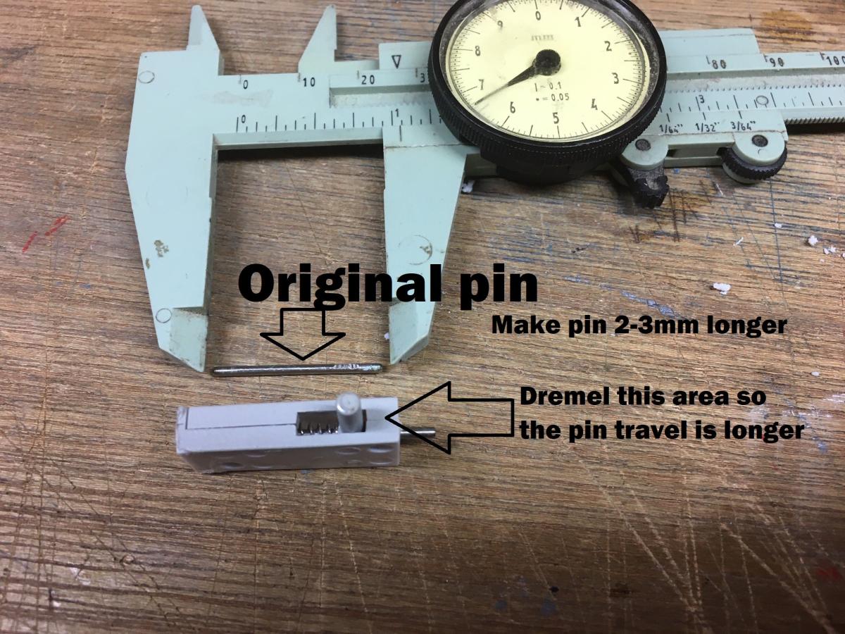

                          Why add extra magnets? The issue with the canopy is the fuselage flexes and the latch becomes unlatched. See my fix for the latch.

                              Thanks Evan D for the mod to the canopy latch. You can bet I'll take that advice. Also, thanks xviper for your comments. If I understood the Y cable issue was that the combination of Y cable on the battery and on the ESC was that it prevented a dead battery causing a engine failure or no power to the BEC. This will be my first venture into twin engine plane. And the thought of losing a engine in flight would be a major failure that would ruin your day and probably the loss of a plane. Like I said, that post got my attention. So, being that the plane as delivered from the factory is somewhat under powered, would you recommend not using 4S 3300mAh batteries rather than the suggested 4s 4000mAh batteries?

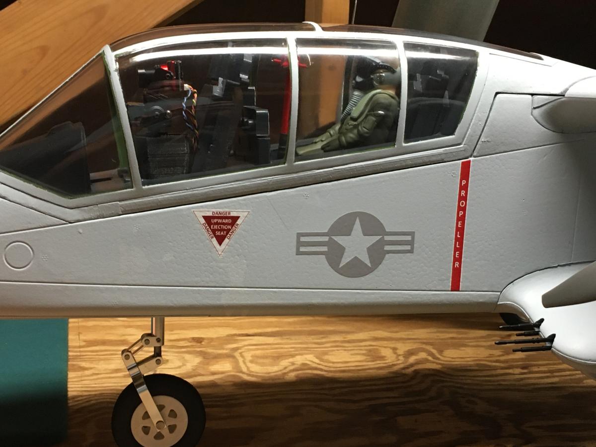

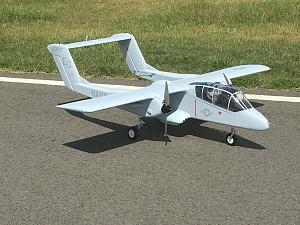

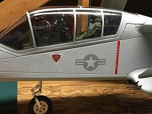

                                I've never had a motor out with an electric twin. Both ESC BECs supply power to the radio in this. Added together it's just not something I worry about. If it is something you do worry about making a H harness to wire the batteries together would be good peace of mind.
                                The stock power is very easy on batteries and you can get long flights off a pair of 3300-3500.
                                I saw one fly before I built mine and I like "extra" power. When I built mine I put in a system that pulls 3X the power as stock. I also programmed in crow, very high flap travel, rudder airbrakes and differential throttle. It does some crazy stuff. I also repainted it and put in a digital FPV set up... It's a great great plane.
                                https://youtu.be/eRDArATnri0

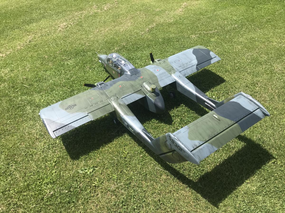

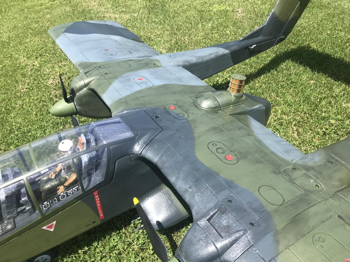

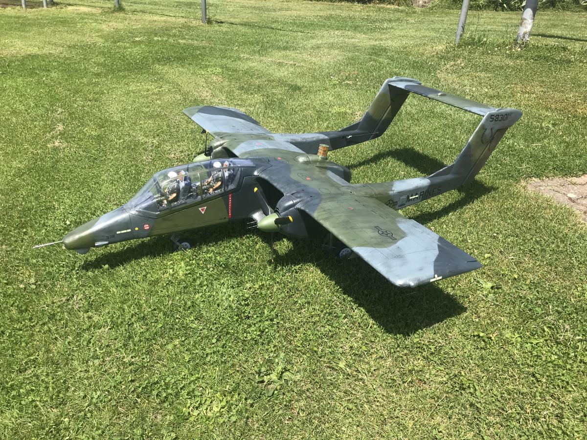

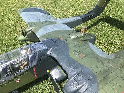

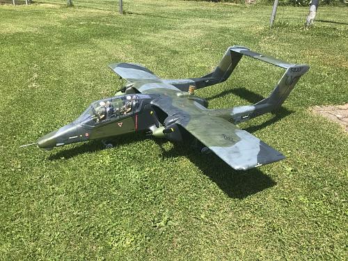

                                    Hi guys,
                                    I would like to share my complete re-do of the Freewing OV-10 finally. It is a conversion to a OV-10D. Nose is carved and shaped out of construction foam with consecutive sanding/filling/sanding. 3d priting of cockpit and „disco light“ with the files mentioned earlier in this thread, as well as the pilots from realmodelpilots/uk.
                                    I would like to thank all of you for advice and inspiration i.e. regarding the holographic rainbow foil for the IR jammer or FLIR.
                                    Had fun building it, having fun looking at and flying it, going to have fun in spring!
                                    Take care,
                                    Axel
