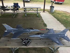

            • Yesterday I had out two F-16s. The fixed gear snaps on and one person took and unsnapped the mains off, gave them to another “friend” who came up and said he found them out on the field. Since the F16 rest’s on the strakes I didn’t notice they were mine… Friends…

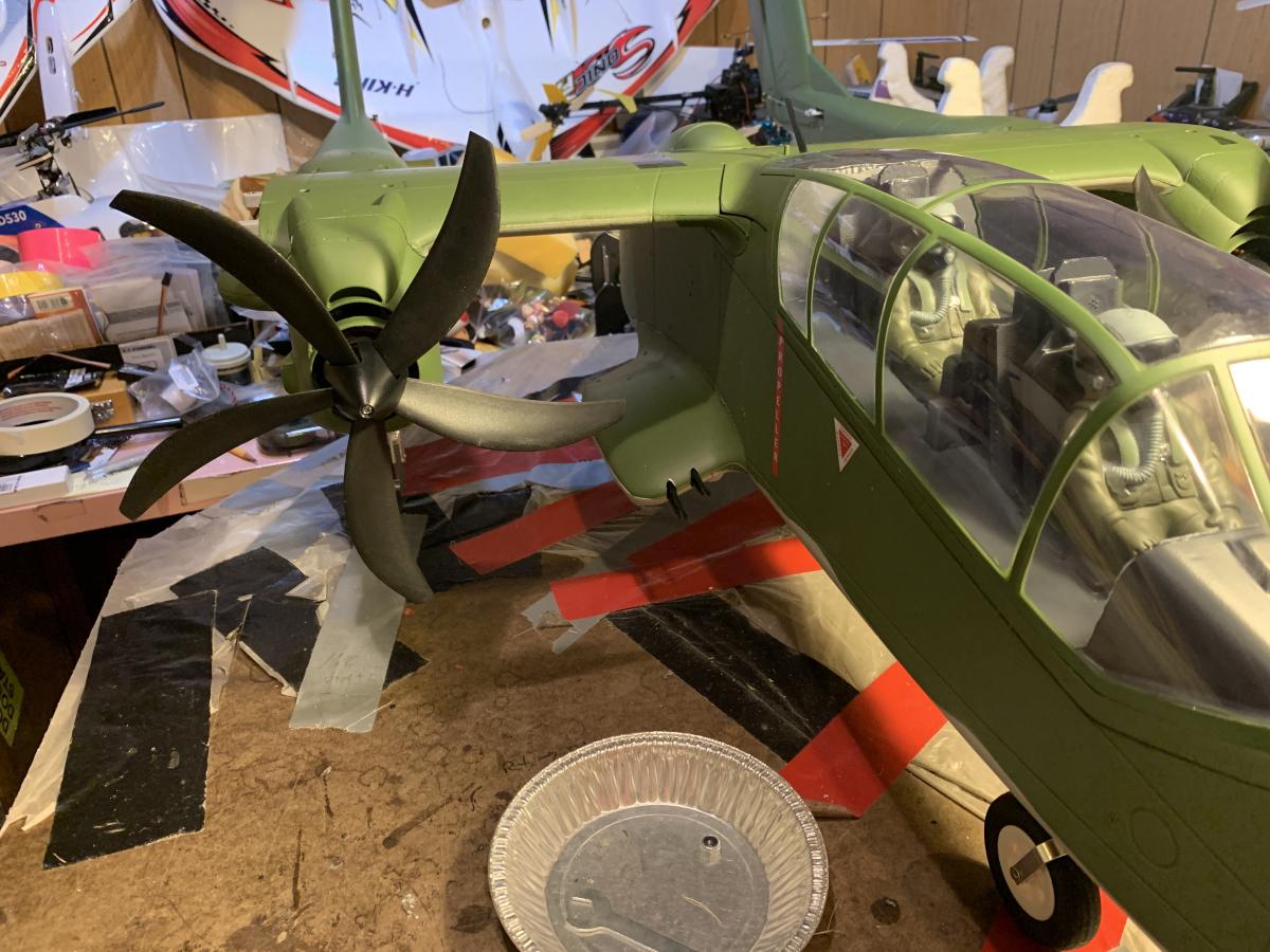

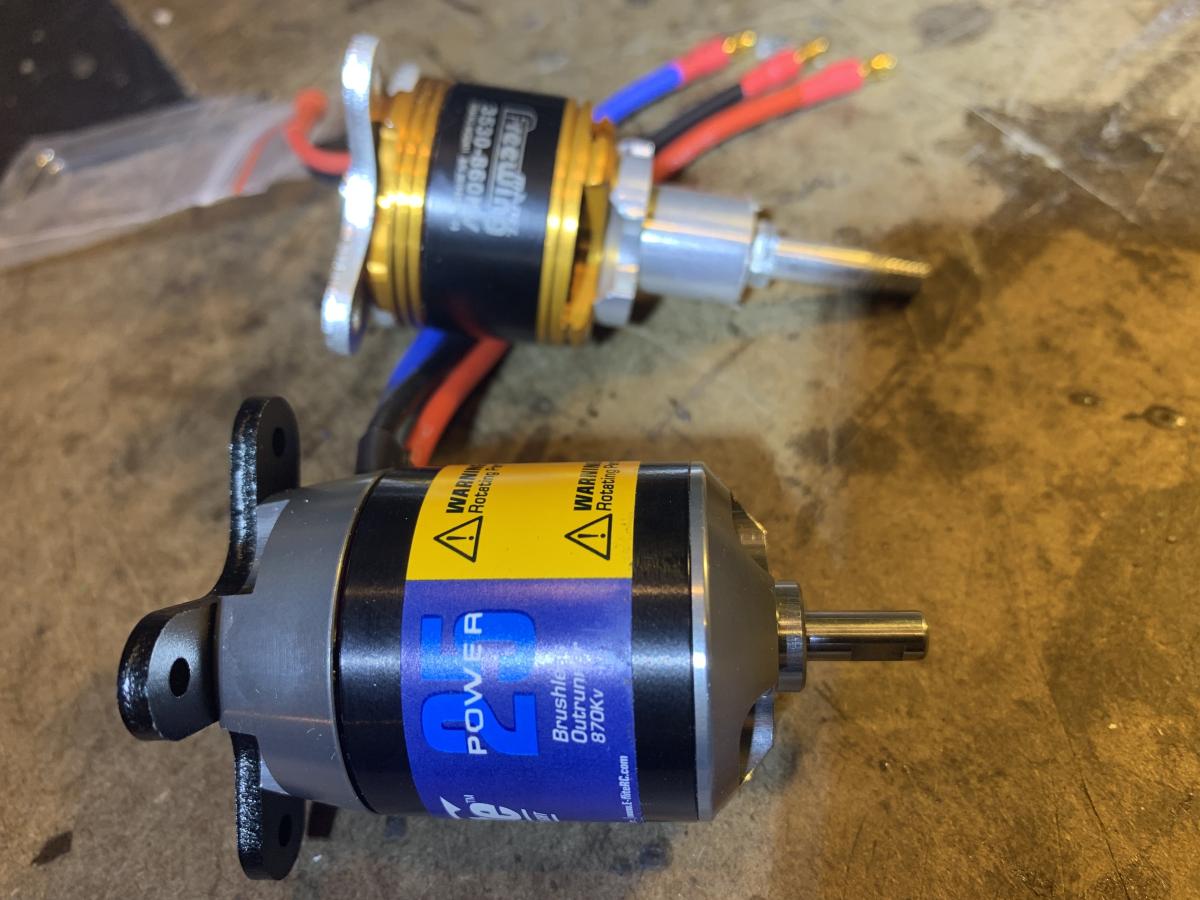

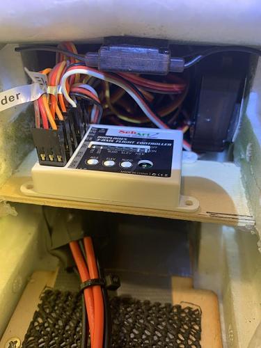

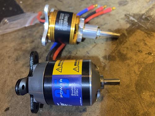

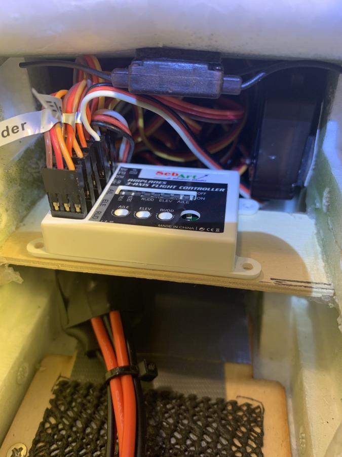

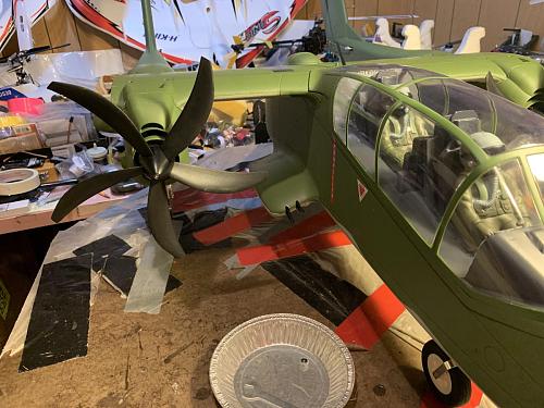

                                      • Before the first season got too far with this plane, I was wanting more power. I went with 60A ESCs, Eflite Power 25 motors, 5-blade Scimitar props and spinners from an Eflite EC1500, plus a Freewing E51 gyro (made for SebArt) with moderate gain on the rudder to tame the tail waggle. It has become one of my favourite prop planes.
