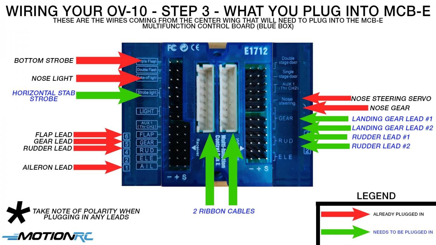

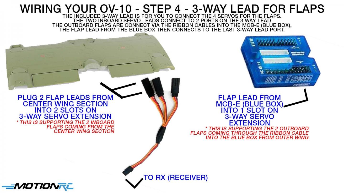

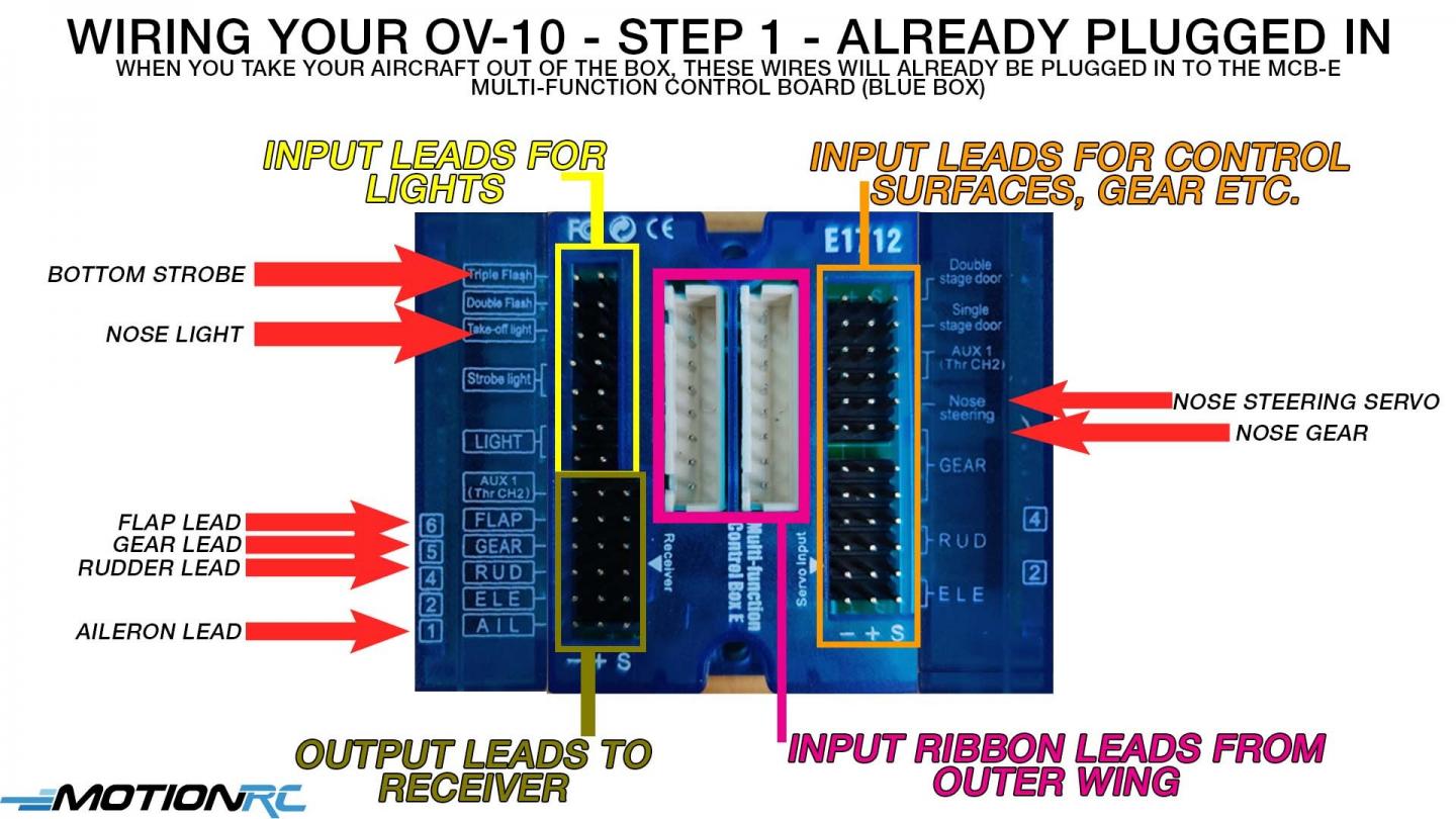

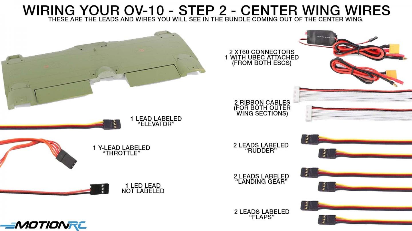

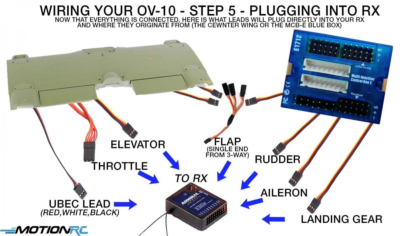

                          • Hey guys, I made a 5 page diagram for you all to download (PDF in attachments) on how to wire your OV-10A Bronco and a video that goes over it in detail.

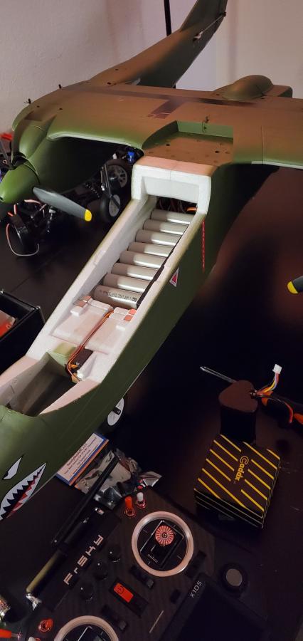

                            • Man this plane is cool! Just mocked up a 4s4p Li-ion pack consisting of 21700 cells. Seems like it'll fit and balance perfectly, and give me 16.8Ah on tap. Off to do some spot welding.

                                  Wowser! That's a serious collection of electrons! It'll be just as interesting how she performs weight/speed, as will flight duration... 😁
