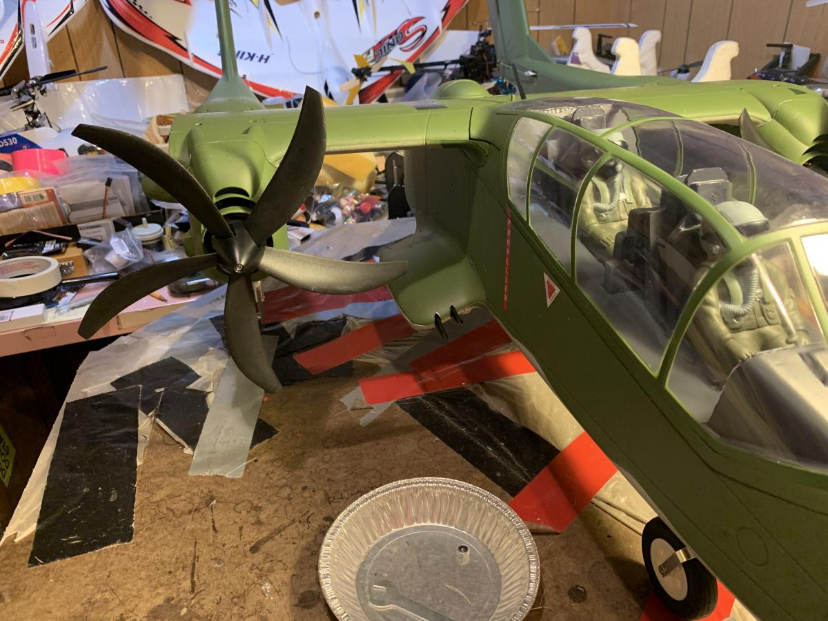

      During my conversion to Scimitar props for this plane, one of the prop adapters broke just under the threaded shaft. I bought a couple of replacements as follows:
      https://www.motionrc.com/products/fl...adapter-type-c
      These seem like the correct adapters, EXCEPT that they are actually for the B-24. They are the right size and length but the holes and screws are not the same. They are designated the same for both the B-24 and the OV-10. THEY ARE NOT!
      1. The holes in the front of the motors are NOT the same size. The little screws provided with the adapters are for the B-24 only, which are smaller than in the motor for the OV-10.
      2. The holes in the adapter themselves are also smaller because they are meant for the B-24. However, it is possible to "tap" them to the proper size using the OV-10 screws. It's delicate, so they MUST be lined up correctly or you may break one or more. If you do break one, I'm not sure Motion RC will be able to match them for you because they may be under the impression that they are the same. Sending you another adapter kit WON'T work as they'll come with the same smaller screws and same smaller screw holes. YOU MUST KEEP THE OLD SCREWS FROM THE OV-10 ADAPTER.
      Even though it's listed that the two motors are the same, they are NOT - at least not in the sense that the holes on the front of them are the same. OV-10 - bigger holes, thus bigger screws.
      I hope Motion RC sees this and do some homework to get the right sized screws and adapters when a customer orders up a replacement prop adapter kit. Also, for when a customer orders up a motor for the OV-10. If it's for the B-24, the old OV-10 adapter won't screw on.

          You going to power it with a couple of these?

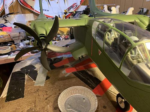

          • Tell us about the props. They look like they will pull a lot of power.
            • They are the props from the Eflite EC-1500.
              https://www.horizonhobby.com/product...select-efl5750
              They are 10x8x5, counter rotating. I also had to use the back plate and spinner from the EC and a longer screw to hold the spinner on. I've doubled the ESC size to 60A. I just hope the OV's motors will hold up. I'll have to watch how long and how often I max out the throttle. The EC uses a Power 15 motor, 650kv. It also weighs a couple hundred grams lighter and can do 3D hovering with it's powertrain. The EC seems to fly much faster than the OV-10 and with more grunt. Both fly on 4s. I hope to give the "new" OV a try this weekend.
