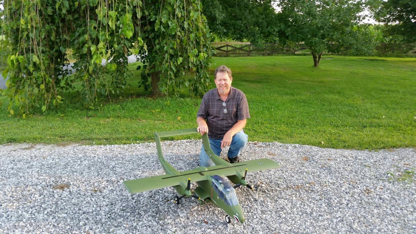

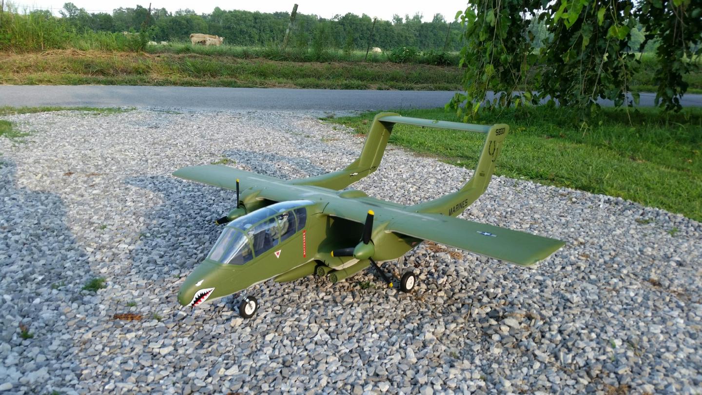

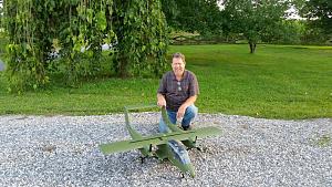

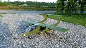

                        • I finally got my Bronco put together and spent last night programming my radio for the plane. Don't know when I will get to maiden it due to having to take care of my wife since she has been diagnosed with cancer, we are fighting it with chemo and keeping a positive attitude on getting her back to good health.
                          Click image for larger version  Name:	ov102.jpeg Views:	0 Size:	260.6 KB ID:	268879Click image for larger version  Name:	ov10.jpeg Views:	0 Size:	295.9 KB ID:	268880
                          • Very nice!
                            • MY God be with you and your wife. Nice bird.

                                god speed best wishes 4 good recovery mad baron

                                    Oh man , so sorry to hear that, in our prayers. Your Bronco looks great.

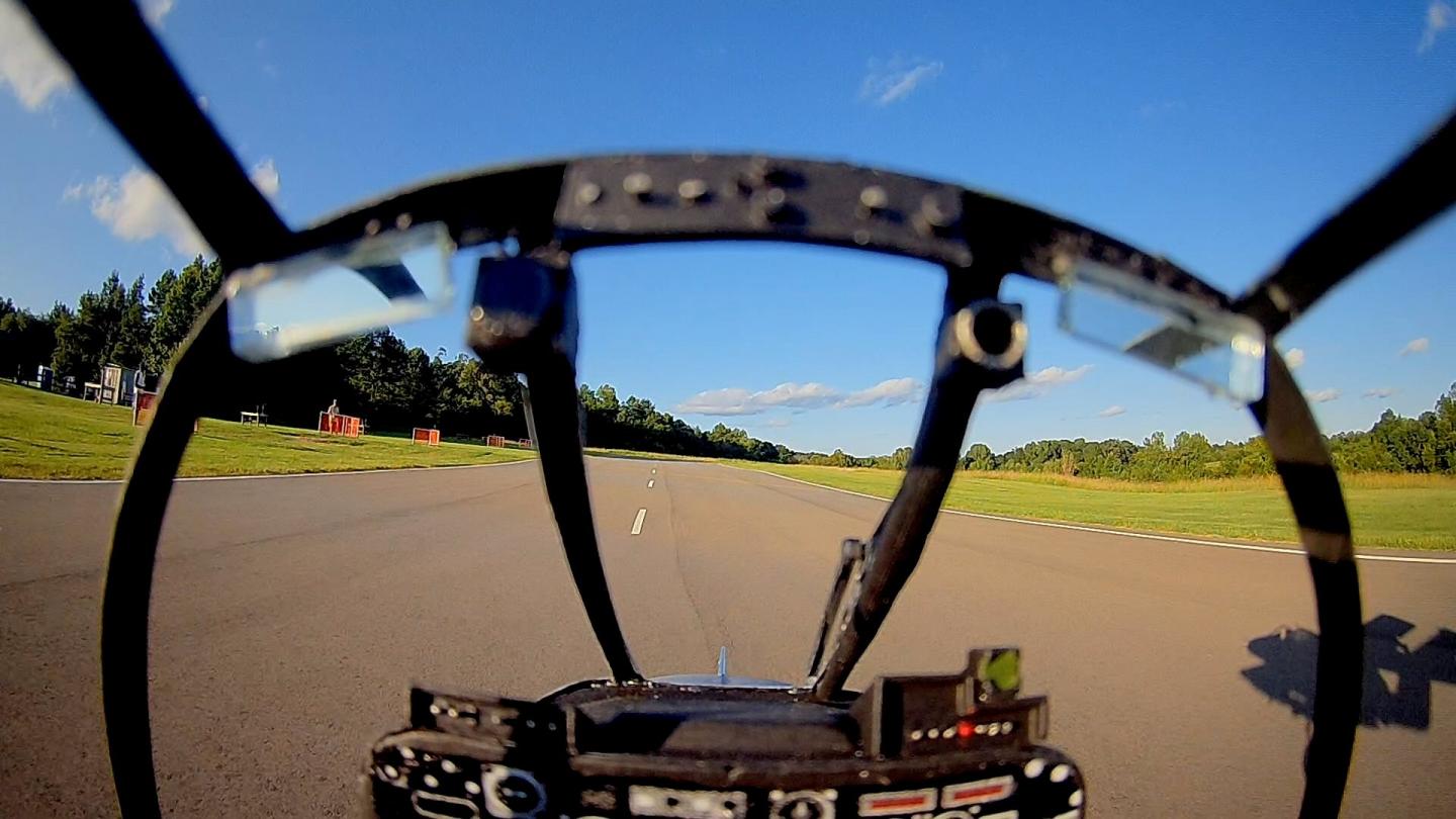

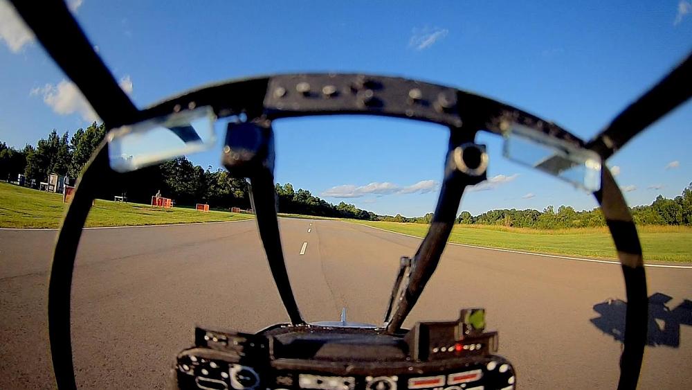

                                    • Here is a video link from one of yesterday's flights. It's a fixed forward camera non-FPV flight. Loops, rolls and some spins. For some reason, I'm having the video cut off when I use head tracking. Works fine if I don't use head tracking but it's not as enjoyable of an experience for me/ Happened to me a couple of weeks ago and I thought the video cut out because it was so hot outside. Yesterday wasn't as hot and it happened again. Tonight, on a bench test it did it again. Definitely not the heat. This is the second Runcam Split 3 that has done this on my Bronco. I understand that the wires from the camera to the board are very delicate and I have them out in the airstream. Perhaps the wind is causing them to vibrate and create a short? If anyone has had a similar problem with the Runcam Split 3 let me know if you have solved it. Thanks and enjoy.
Name:	Vid Cap 1.jpg
                                      • Nice Vic, I got some FPV flights on mine today too. Also some quad flights...
                                        • Coool!
