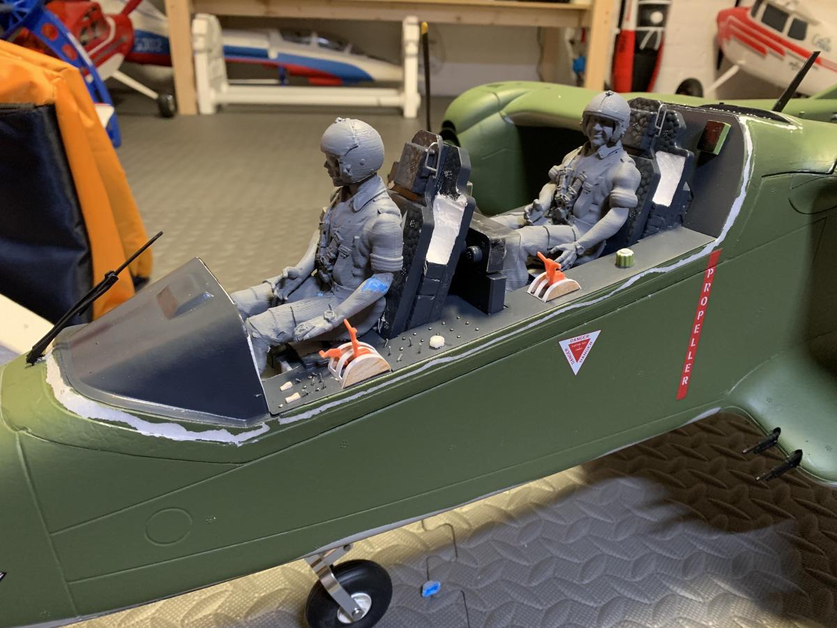

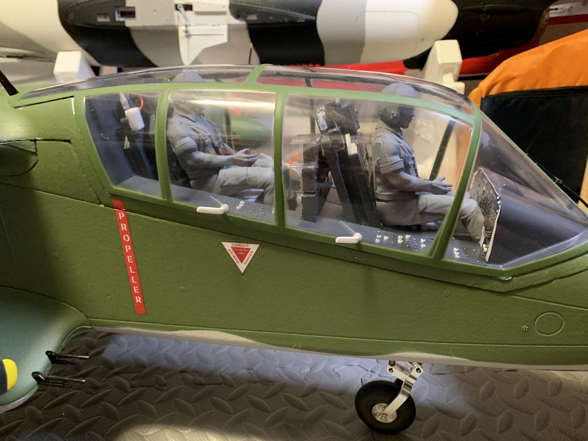

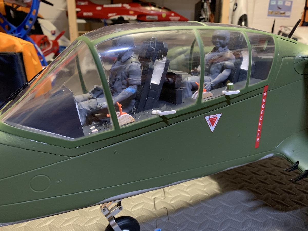

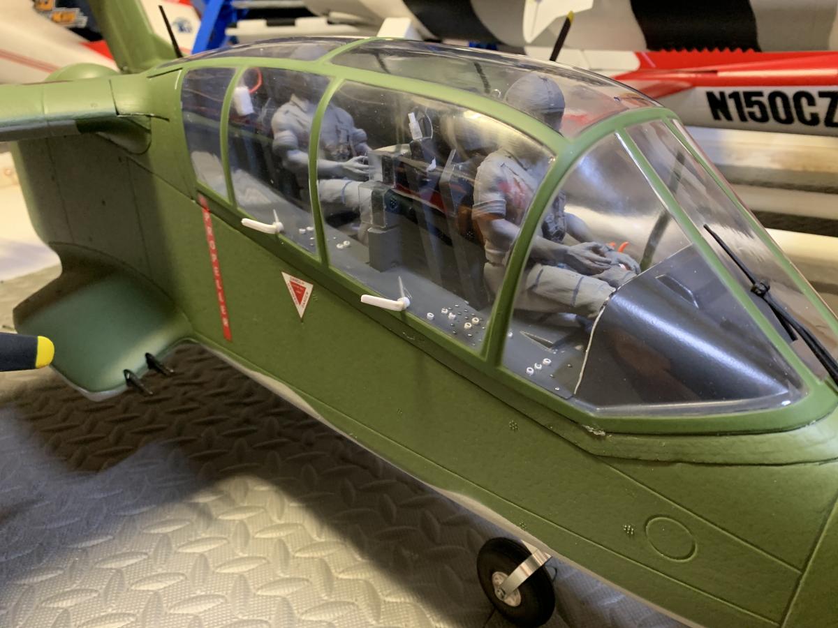

ID:	269628 Cockpit upgrade coming along to my satisfaction! Click image for larger version

      #922
      Nice. What nose wheel is that?
      • t01ga
        " T "
        • 197
        • UK
        #923
        Thanks. Changed all wheels to J Perkins airwheels. I believe it is a British brand.

          Looking good! What file did you use for the pilots?
          • t01ga
            " T "
            • 197
            • UK
            #925
            Thanks. They are Huey pilots from Real Model Pilots in the UK.

              #926
              t01ga, Outstanding work! couple of questions..... did you replace the seats with site ejector seats? Assuming you used 1/9 scale, how did you fit the full legs or did you cut them off. First time seeing this site, THANKS!
              • t01ga
                " T "
                • 197
                • UK
                #927

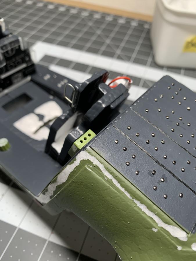

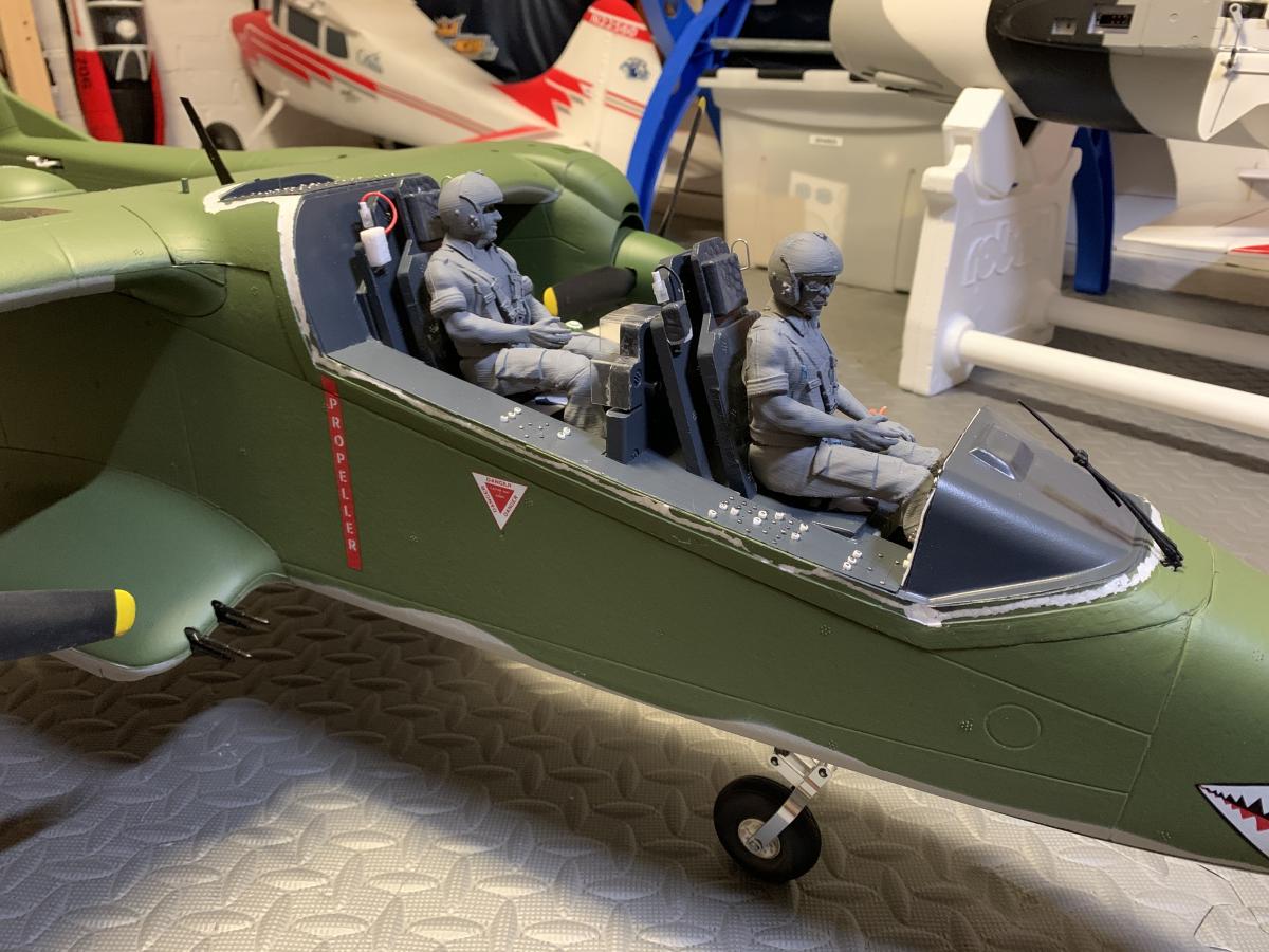

                Thanks bud. No the seats are the same, I just cut a piece of foam as in the picture. The pilots; before ordering them I assumed like you that the plane would be 1/9 scale. So the 1/9 scale pilots I got was way to be big. So I took a measurement between the front seat base and the tip of the seat head rest and ordered new pilots by that measurement.
                To fit the pilots I had to cut the boots of the front pilot and just the tip of second pilots boots and enlarged the whole a little at the foot wells.
                    Tolga..... Thanks for the info, checking out the site to order now!
                    Thomas, you can contact Sean on the website and ask him if he could print the same pilots giving him my details (Tolga Yilmaz).
                    I can send you photos of where I cut the pilots and the foot well.
                    I also modified the arm of the front pilot. I cut the left arm at the elbow at 45 degree angle then cut a wedge from the lower arm , twisted and glued back so the hand is parallel to the ground as if operating the throttle.

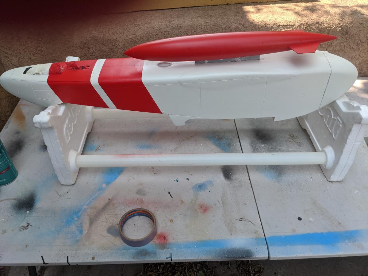

                            After a break to get my kid off to college, and also because it was too damned hot, I finally got back to my Cal Fire Bronco.
                            Graphics by Callie, and some waterslides I made myself.

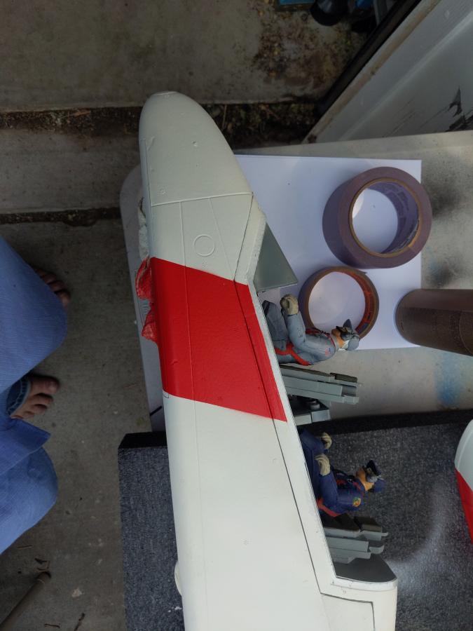

                            Civilian pilot and observer are a mash up of a figure from Thingiverse and another couple from CGTrader. Insignia and patches are waterslide decals printed on a laser printer and cut to size by a cricut vinyl cutter.

                            Horizontal stab with graphics from Callie and sealed with gloss polyurethane

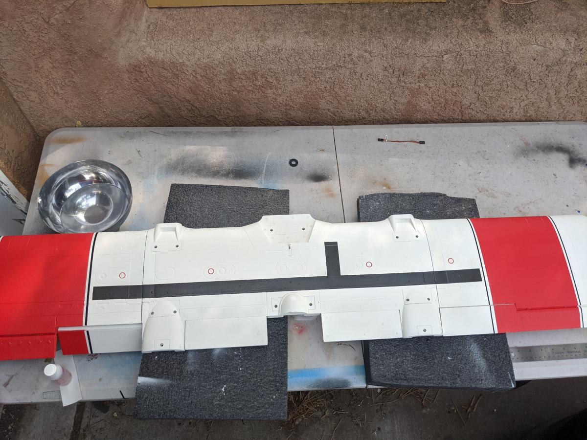

                            The wing is ready for for Callie

                            And finally the fuselage is getting its stripes. I'm doing one at a time to keep the masking simple. Second stripe and black pin stripes tomorrow.
                            Next up will be the booms
                            I'm looking forward to when the canopy is back in stock so I can finish her up.
