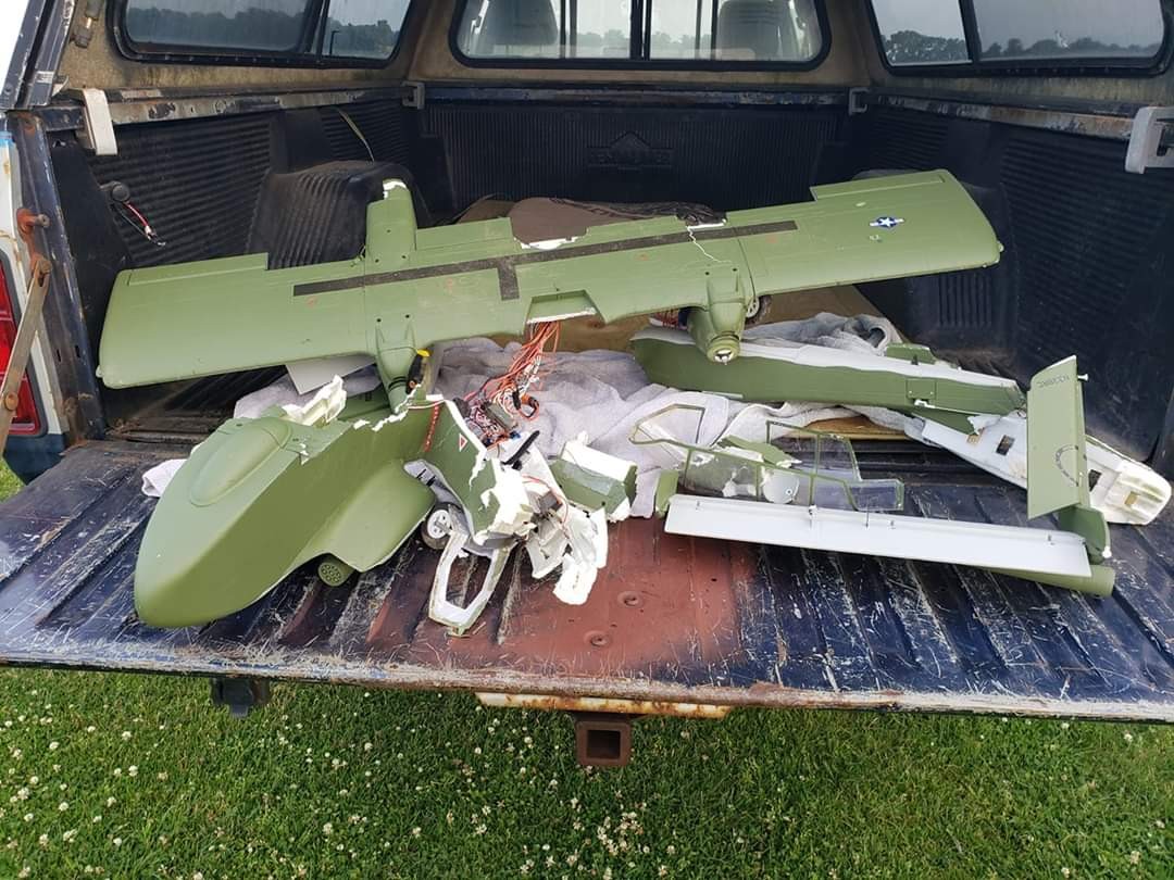

I ordered one today. I’m having huge frame losses on my AR637T. Horizon sent me a new one. They also suggested I try range checking other planes with Spektrum receivers. 300 in the first range check, 688 on the second and 733 during the first and only flight.

Did you check the telemetry after a range check? I’m going to try a new AR637T. I don’t trust the first one after 733 frames lost. Loss of aileron control sounds like a receiver or transmitter problem. I’m now waiting for basically the whole plane in parts to show up.Originally posted by KC8REH View PostVery disappointed in the OV10. 2 flight the second one lastni maybe 20 seconds before it was lost due to loss of aileron control. $578 lost total after rebuilding after crashing on the maiden with the Same loss of aileron control. Not shure if I can justify money for a second model.

I'm going to take a jab at it and say you may have had one of those "faulty" blue boxes. Loosing only aileron control is not likely due to a receiver issue, as you've already shown by using that RX successfully since the crash. I had a similar situation but mine was more of "glitch" in the aileron response in my T-33. After hooking up the ailerons directly to the RX, the ailerons worked perfectly. As long as there continues to be reports of crashes that point toward these blue boxes, I think I'm going to bypass the BB for all critical control surface functions - AIL, ELE. Rudder is debatable since you can always "bank and yank" a plane.Originally posted by KC8REH View PostIt was Not My AR637T. It has flown sense with No issues.

Telemetry shod no holds and 12 or so packets lost. The radio tests fi e along with the reciever. I have been flying for over 30 years and have Never had 2 crashes in subsequent flights were the Same issue was the cause. The first flight was with an Orange 6 channel rx which has sense worked Flawlessly in My 450 Helicopter. The AR637T has flown in a Dynam F6F Helcat also with no issues. The TX is not the issue or I would have seen it by now.Originally posted by Jpmcdo View Post
