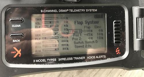

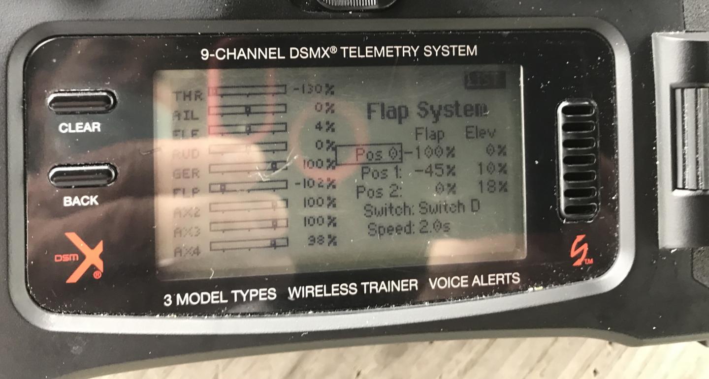

    I am wondering what the flap/elevator mix works best. The book says + 9% on low rates and + 18% on high rates. mine had problems with this mix. Also gear up or down to ballance. The book does not specify this. Thanks!
    My setting which work great. Click image for larger version

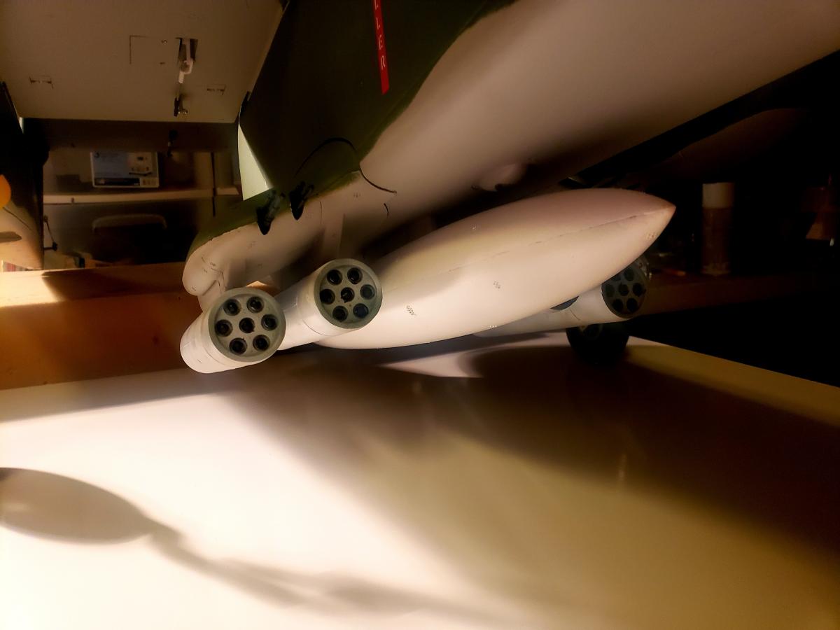

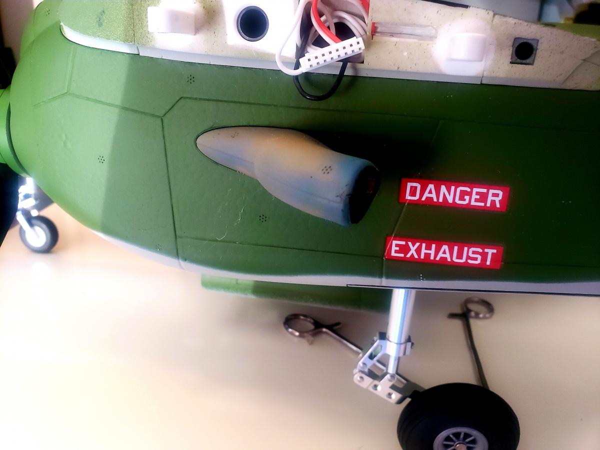

                                      • Just learning how to airbrush rocket pods belly tank and turbo exhaust pianted ..
