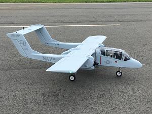

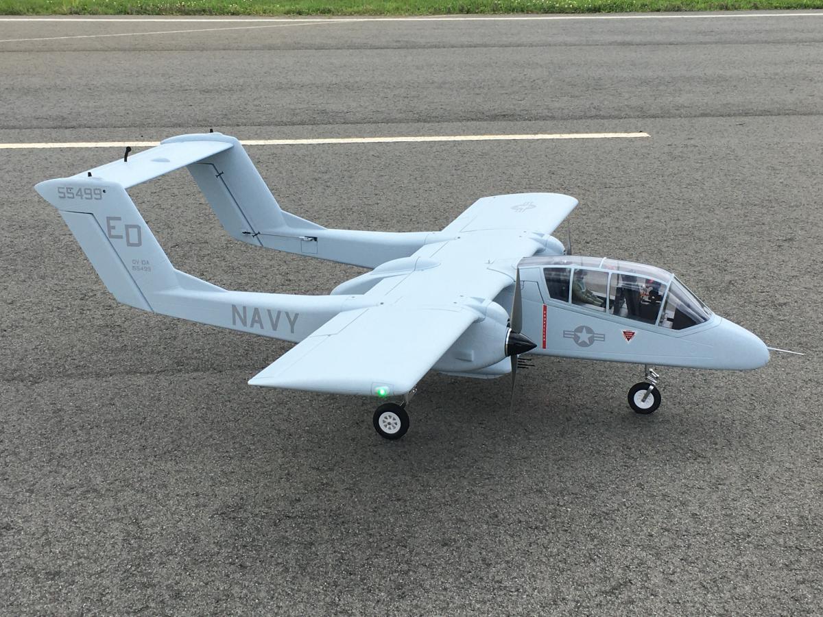

                      • I got the markings on and took it for a spin this morning. It was windy today so the nervousness in yaw was back.

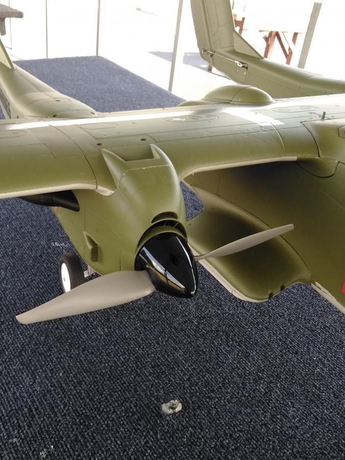

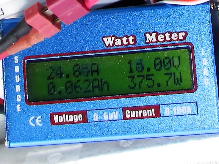

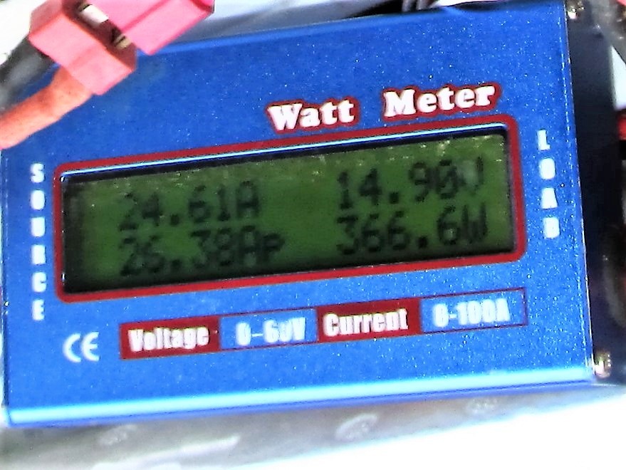

                              • Just to let you guys know, test flew my OV-10 today with the APC 10x8 two blade props, not counter rotating. It made quite a big improvement in speed and pull, which is what I was hoping. The airspeed itself was probably 5 to 8 mph faster, but the big difference was in the pull going up, mainly in doing a loop/climb, definitely better. The non counter rotation made no difference at at, not that I thought it would. I may try two 10x10 props later, but right now happy with it. The total price for to 10x8 props and two 2" spinner was about $22. Here are pics of amps and watts with stock three blade and with 10x8 two blade.

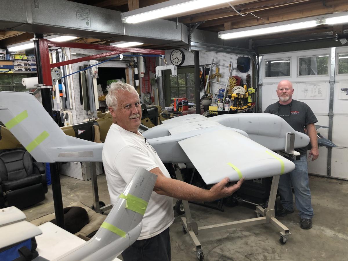

                                    • I don't know if this was previously mentioned... I was catching up on a few podcasts and the guy from Legends Hobby (formally VQ Warbirds) was on and said they will be having an OV-10 towards the end of the year. WITH A 14 FT WINGSPAN. My first thought was what the heck are they going to power it with? He went on to say a couple of his "premier" customers that he gave a heads up to mentioned putting a couple of turbines (turboprops) on it. Now that would look scale.
                                      • Originally posted by Bellke View Post
                                        I don't know if this was previously mentioned... I was catching up on a few podcasts and the guy from Legends Hobby (formally VQ Warbirds) was on and said they will be having an OV-10 towards the end of the year. WITH A 14 FT WINGSPAN. My first thought was what the heck are they going to power it with? He went on to say a couple of his "premier" (Code for Doc/Lawyer that can afford $10-20K birds ) customers that he gave a heads up to mentioned putting a couple of turbines (turboprops) on it. Now that would look scale.
                                        And it would need it's own dedicated rollin hangar too I'm just hangin loose to see if that A-1 that they just acquired is gonna have any quirky issues before I step up
