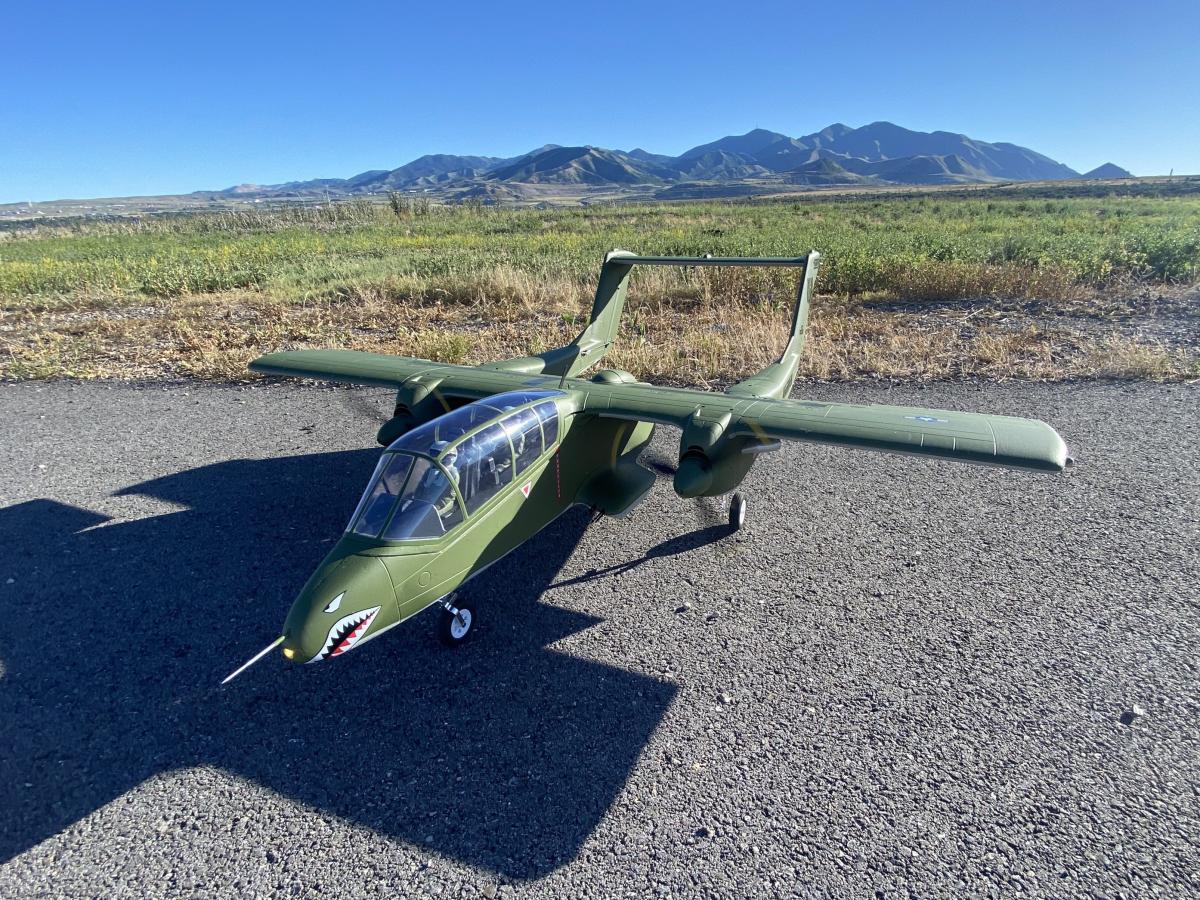

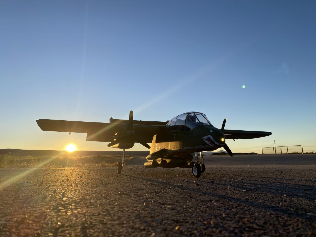

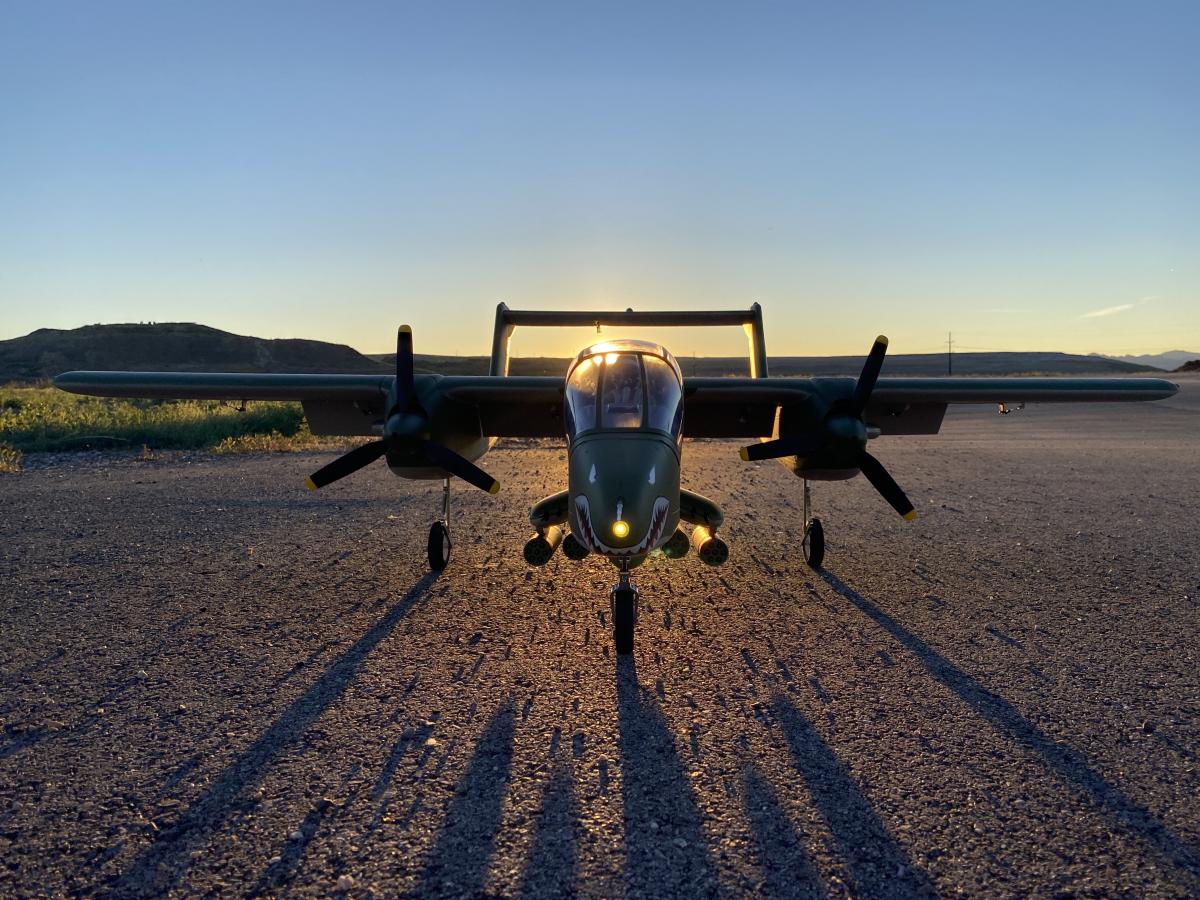

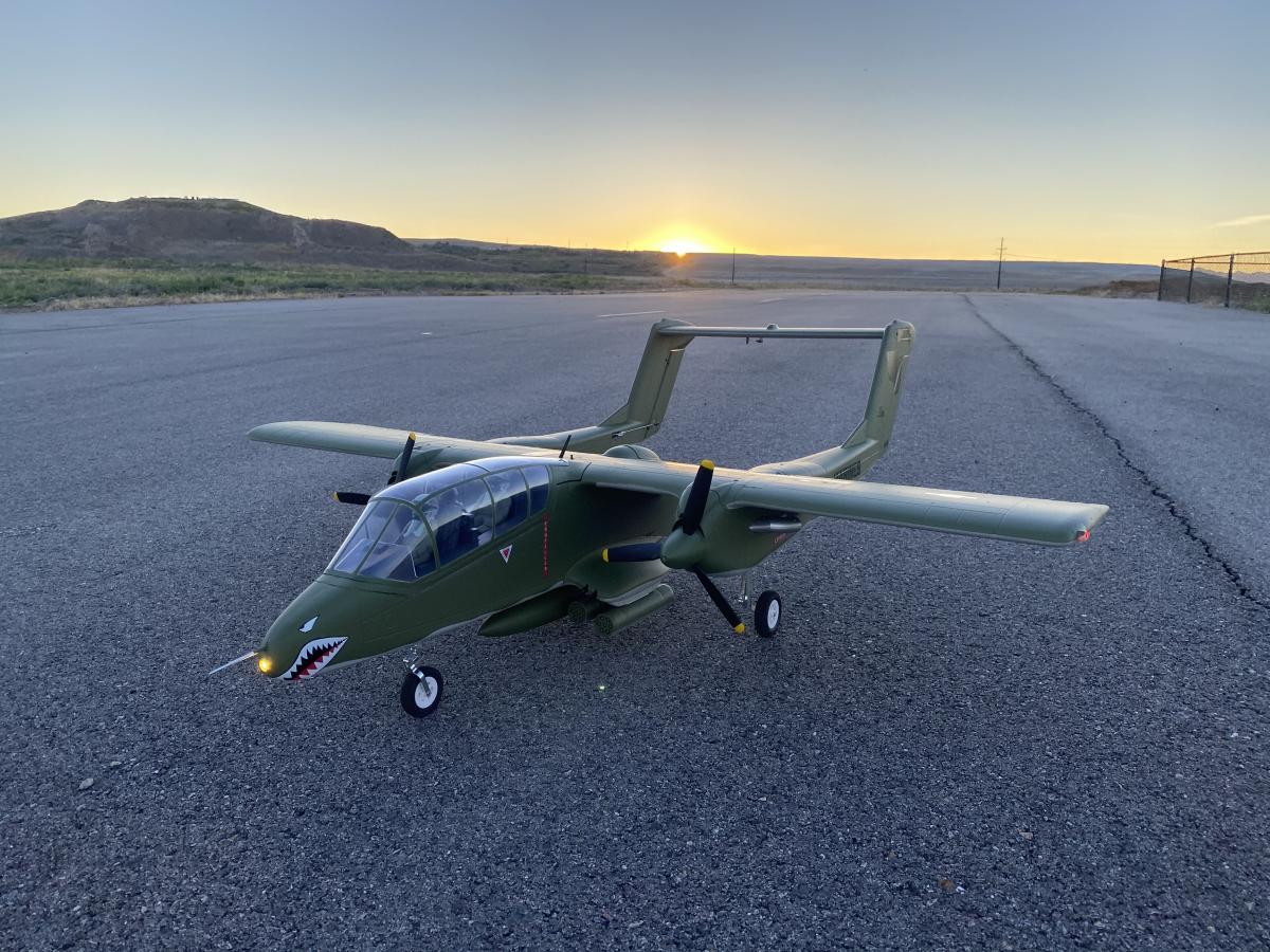

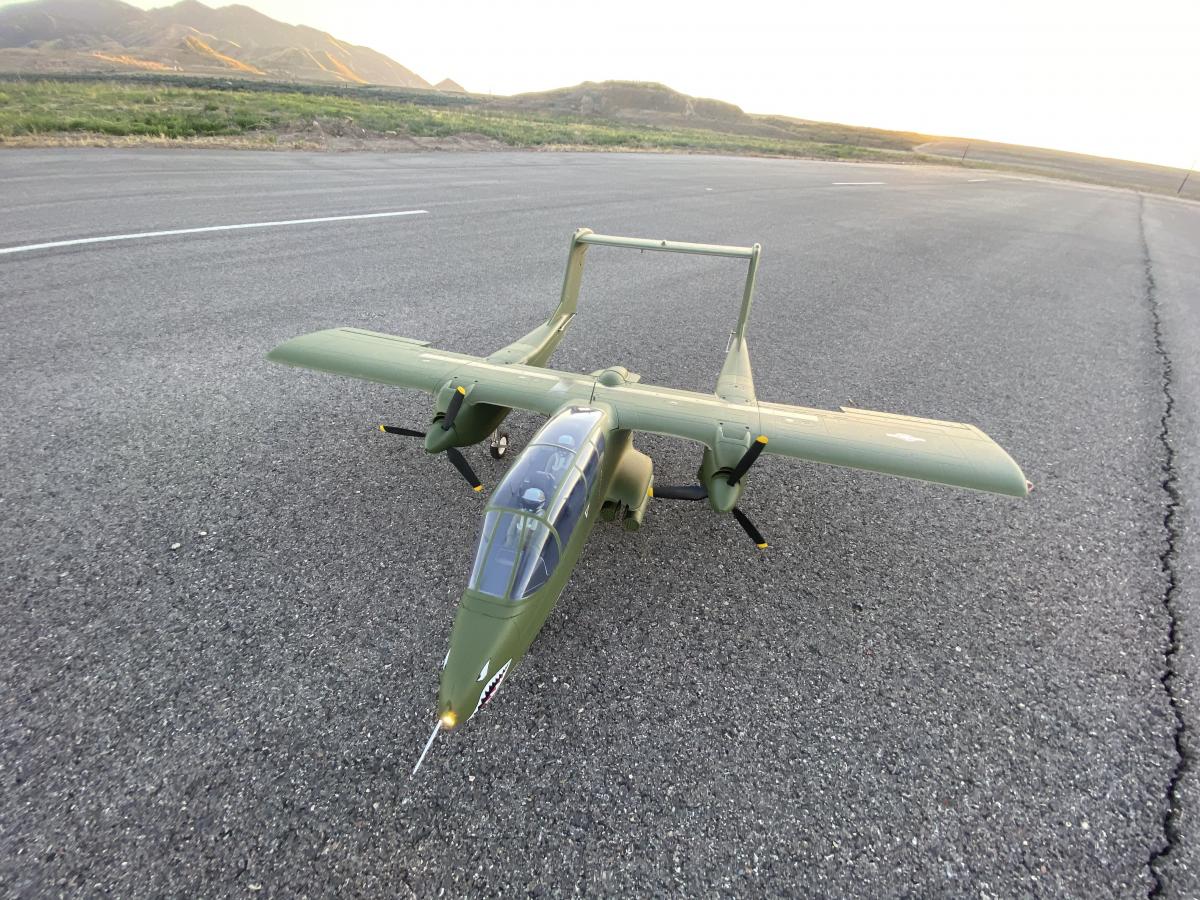

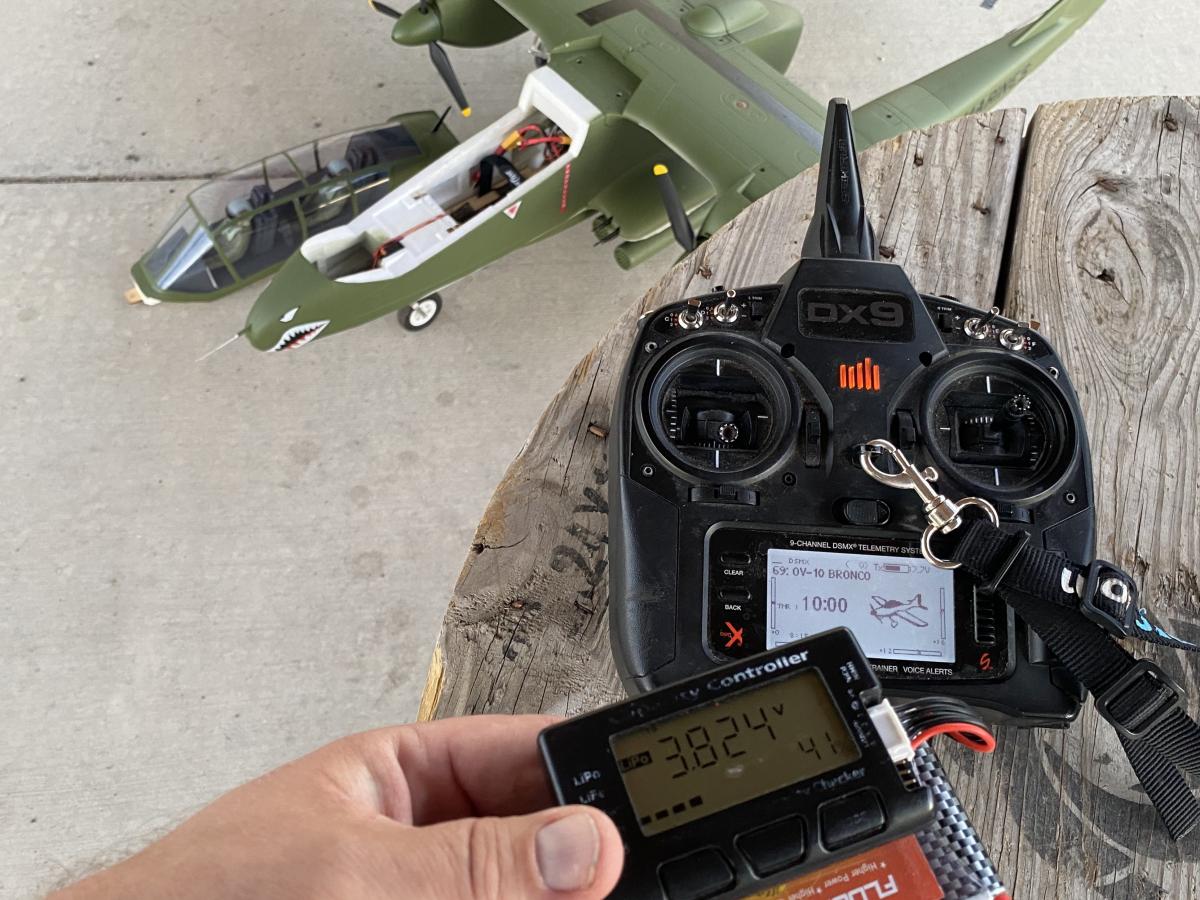

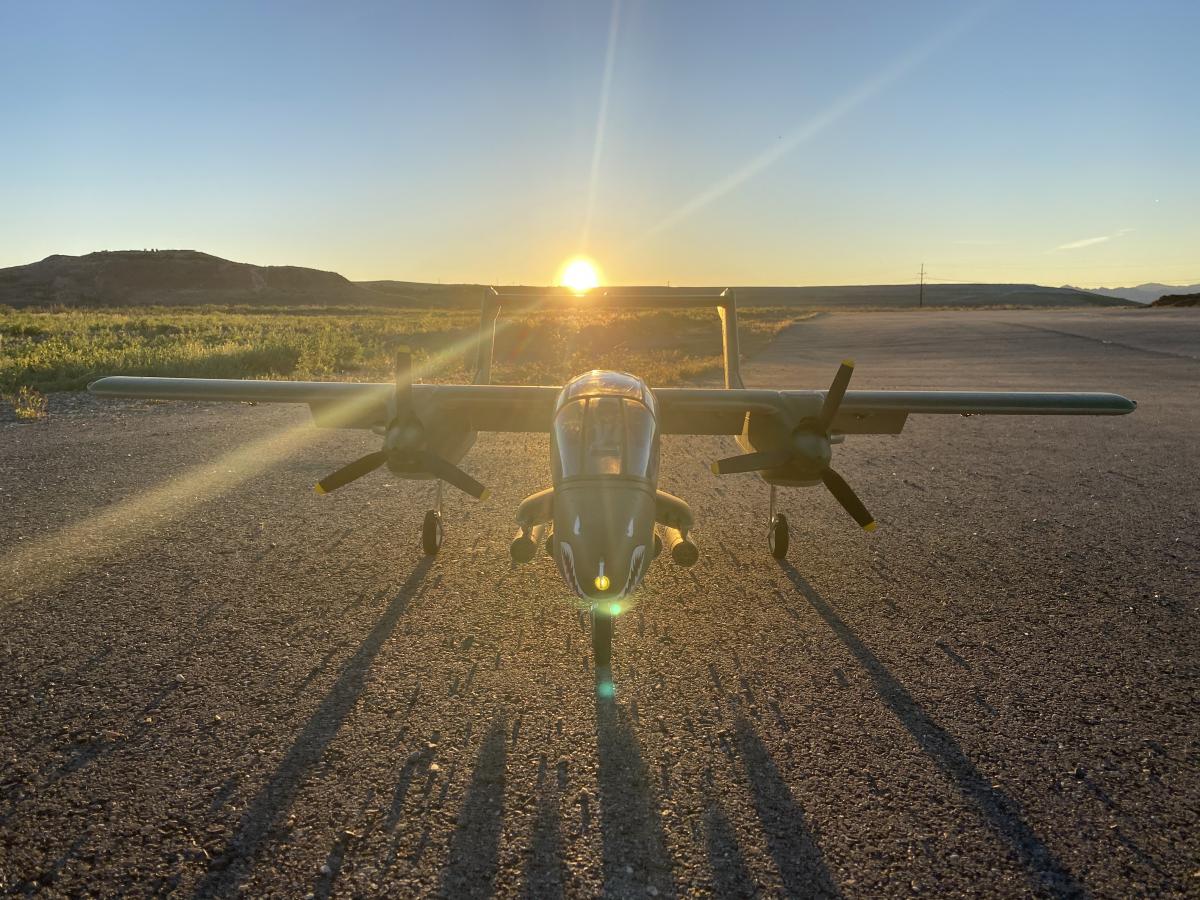

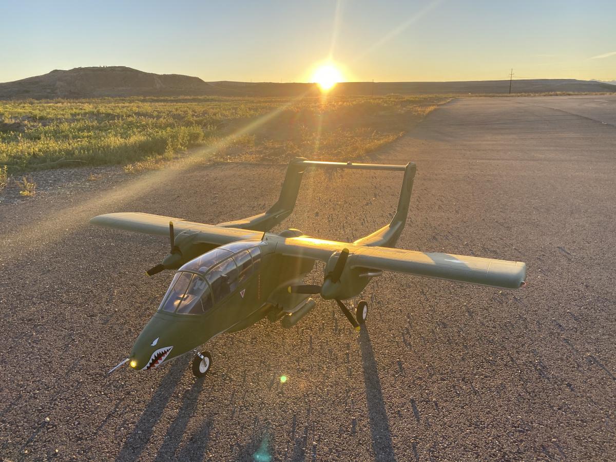

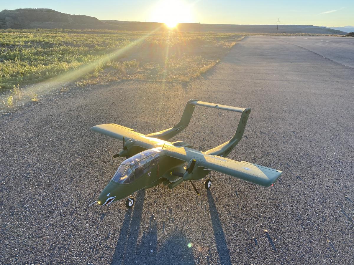

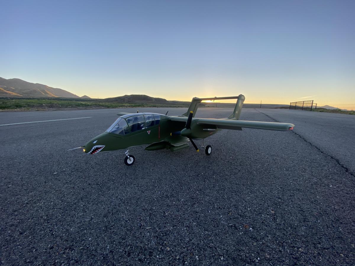

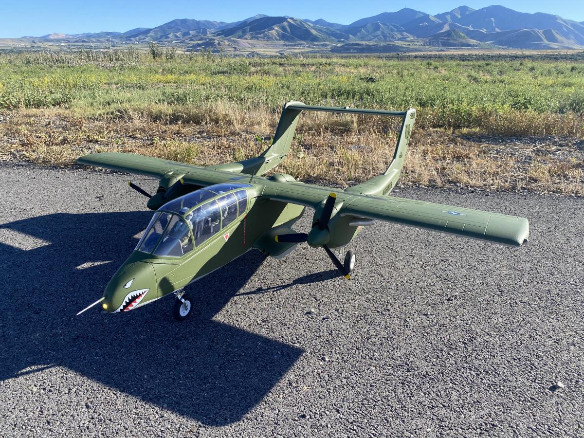

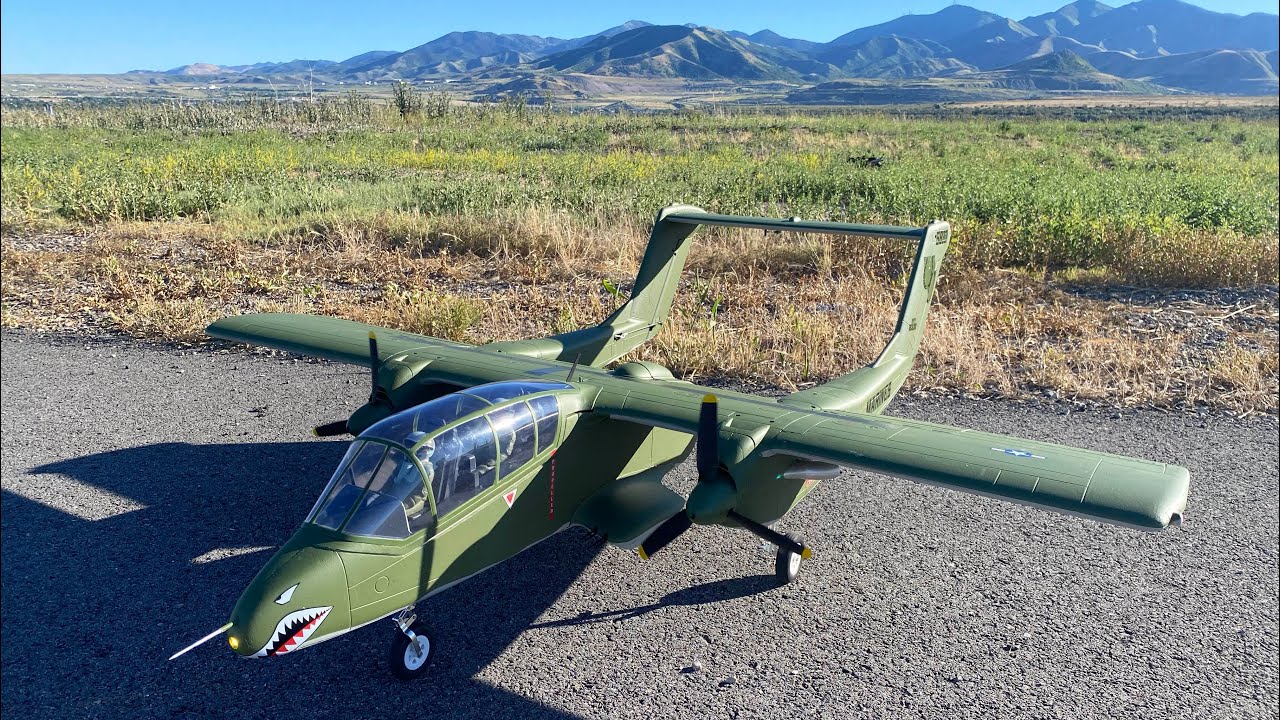

    • Flew the maiden flight LIVE on FB, and she flies great. Super stable, flaps up or down. Also will take off in less than 50ft with takeoff flaps here with density altitudes over 5,000ft.
      After the maiden I still had 68% left on twin 4500mah batteries. So I took her back up and had over 40% left after a total of 10 minutes of flight.
      Another fantastic product from Freewing and MotionRC
      • Pics of the maiden

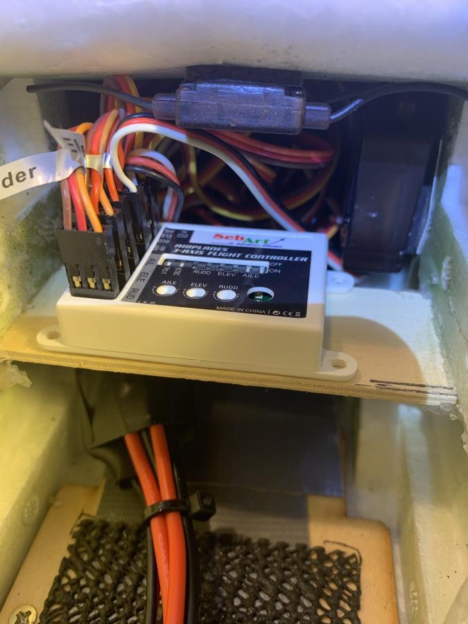

          • Nothing much good on the TV tonight, so went downstairs to play with some planes. One project was to install a Freewing 3-axis gyro into the OV-10. Got it all put in. Made a shelf. Lots of room for everything, even enough space to reach the gain pots for adjustments. Lots of room for the batteries to go in with a little wiggle room for different sizes.
            I had this gyro in my 3.0m Fox Glider so that it would stay level after throwing it. I'm getting rid of the Fox, so the gyro was free. It was very effective on the glider and bench testing it on the OV, it would appear that it will likely help a great deal in calming down some of the "wildness" that some have posted about. Mine was very much affected by any wind gusts on the roll axis and the tail waggled a lot, wind or no wind. As soon a the rains stop, it'll get some test runs to fine tune the gains.

            • Definitely let us know how the gyro works out. I have exactly one flight on mine and love how slow it can fly but somehow need to tighten the way it flies. I don't mind a tail that doesn't 'track like it's on rails', as they say, but it's tendency to rock left and right is annoying and too sloppy for my taste.
              • I did my maiden this past weekend and noticed right away the dreaded wiggle even with no ordinance. I have a frsky s8r installed and gyro was active in stabilize mode only with gains set about 50%. I tried lowering and raising rates during flight but it didn’t help. So I don’t think the gyro will help much. Something is just a bit off with this plane. Maybe the pods are just not stiff enough. I don’t know but this is the second ov10 at my field with same tendency. I’m going to get it out again and run a few more tests.

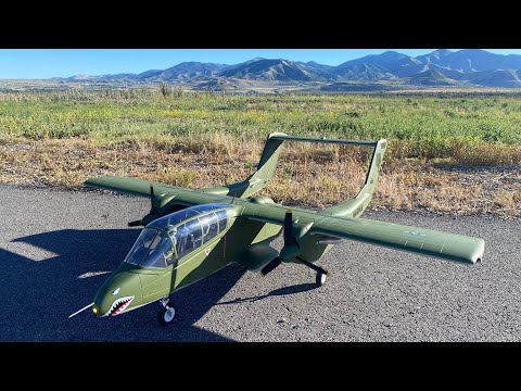

                  • First FPV flight video.
                    https://youtu.be/JUnxr4rrELQ
                      Love that Evan! That large canopy really helps the view! What TVL is your fpv lens? Seems not as wide as others I've seen.

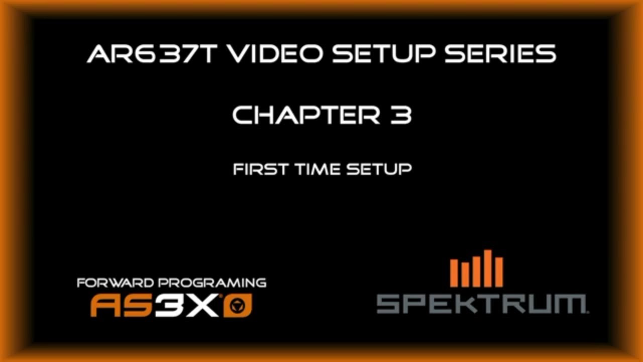

                                    I'm not suggesting that you're doing something wrong, but just to cover all the bases, are you doing it this way?
                                      Yes thanks, I did everything he said up to video 3. It should have bound on video two and stayed bound. My plan is to get it bound, fly it then do the forward programming. If it won't stay bound, it doesn't make sense to go any further on his videos.
                                      • I was unable to keep my ar637t bound because I had the power UBEC lead plugged into the bind port. I temporarily moved the UBEC lead to the aux port, and used the bind button on the receiver to start the bind process. After a power cycle the receiver stayed bound, and I plugged the UBEC lead back into the bind port with no problems.
                                        • Originally posted by AuggieJuan View Post
                                          I’ll give that a try. I ended up moving the UBEC to a Y on the flap channel. The receiver bound fine. I’ll see if I can move it back now. May just have to keep it on another channel via a Y adapter. I was doing what was done on the MRC build video.
