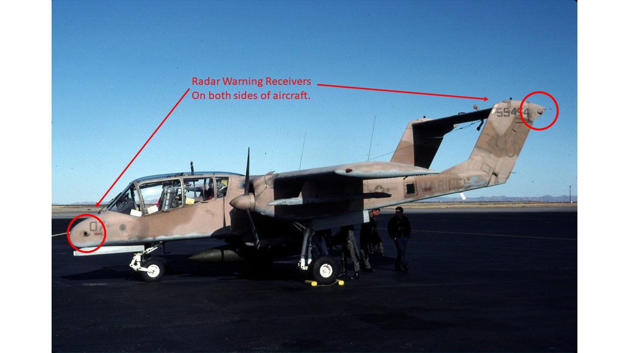

                        Here's one more file tonight. These are the APR-39 Radar Warning Receivers for the later model of the USMC OV-10's. I also have the cockpit indicator designed and will upload hopefully this week.
                        There are 4 APR-39 Radar Warning Receivers on the late versions of the OV-10. Two are positioned on the nose and two are positioned on the top of the tail booms. Look on the web for placement details. The indicator was placed on the top of the instrument panel coaming.
