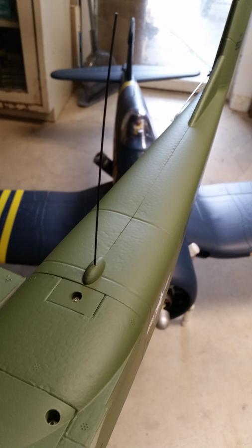

                            Originally posted by vduniec
                            Here is the Thingiverse link for the FM Antenna humps that go on the twin tail booms just aft of the wings. I glued them in place and put a nylon bristle from a floor broom in the hole.
                            These are the antenna mounting humps that are on the top of the twin tail booms of the OV-10. They are scaled to fit the Flightline OV-10 Bronco. I used a bristle from my nylon house broom to replicate the whip antennas. The actual antennas are vertical when the plane is stationary but they bend slightly in flight. The nylon bristle does provides the same effect.

                            I printed two humps, painted and installed them with a little foam-tac. I used a bristle just like your suggestion.
                            I love adding details like this! thanks man!

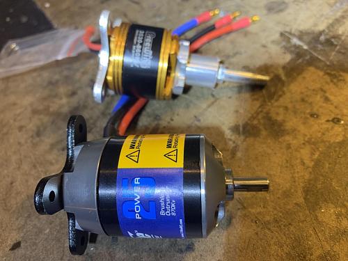

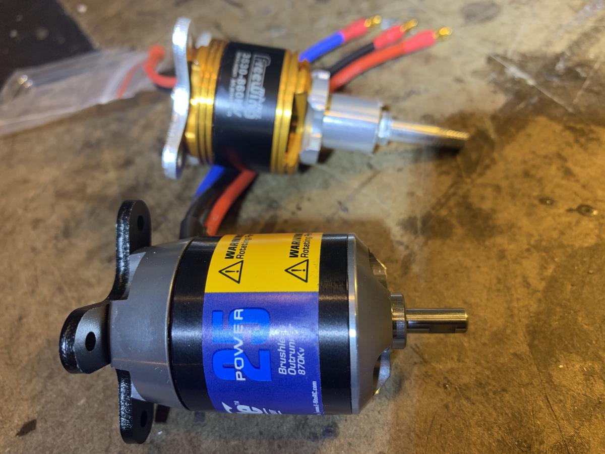

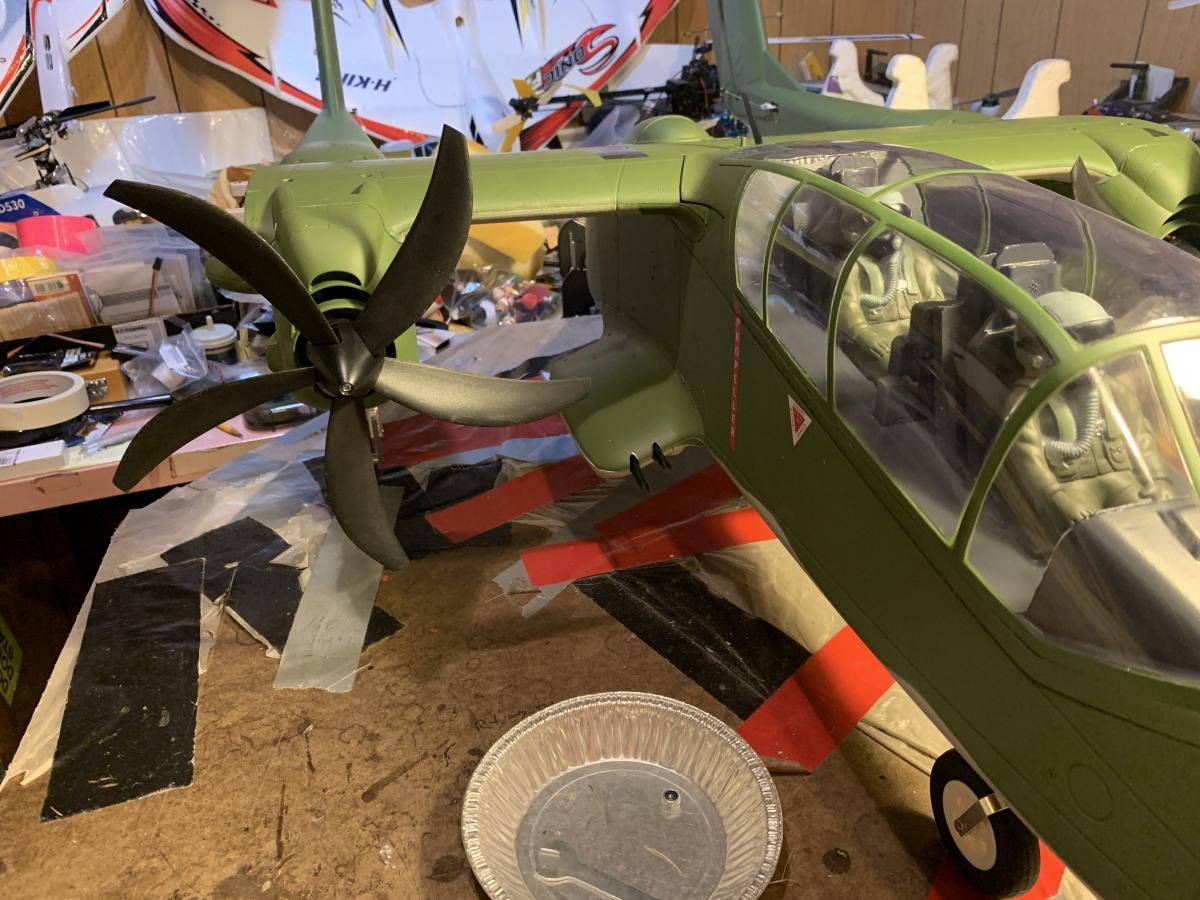

                                Just finished installing Eflite P25's into the OV-10 so they can drive the 5-blade scimitar props. As previously noted, I've already installed 60A ESCs. The stock motors can't quite spin those props us to speed, so I'm hoping these motors will make them sing and give the OV the kick in the pants I'm looking for. The new motors are a bit longer overall than the stock ones and there's quite a gap between the cowl and the prop base plate, but I care more about the performance than the looks. The picture of the prop is with the stock motor. Test flight will be in a couple of days.
                                Click image for larger version  Name:	IMG_3705.JPG Views:	0 Size:	113.8 KB ID:	266129Click image for larger version  Name:	IMG_3692.JPG Views:	0 Size:	150.8 KB ID:	266130
                                  • 5385
                                  #836
                                  They look like they are bigger diameter and mounting pattern. May be difficult to put them in...
                                    • 8749
                                    #837
                                    They're actually already in. The holes in the supplied X-mount match the holes in the motor mount exactly and there's plenty of room in the nacelle for the diameter. But because the motor itself is longer (but still fits inside the nacelle) and it uses a different prop adapter, the gap is about 1/2".
