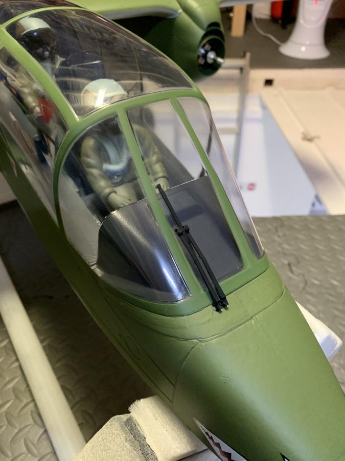

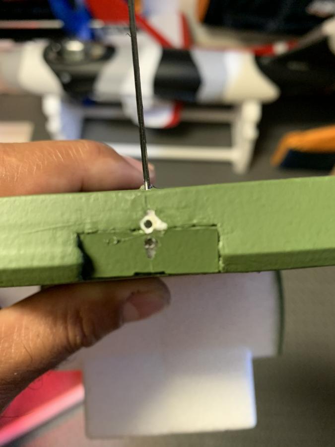

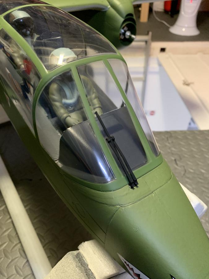

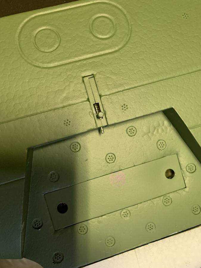

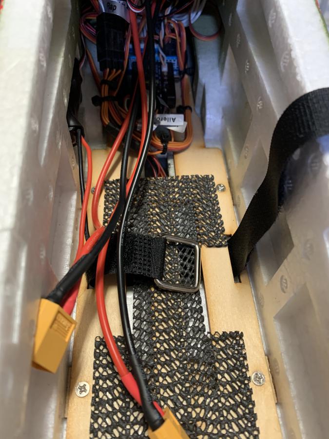

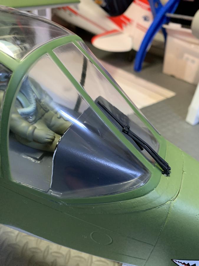

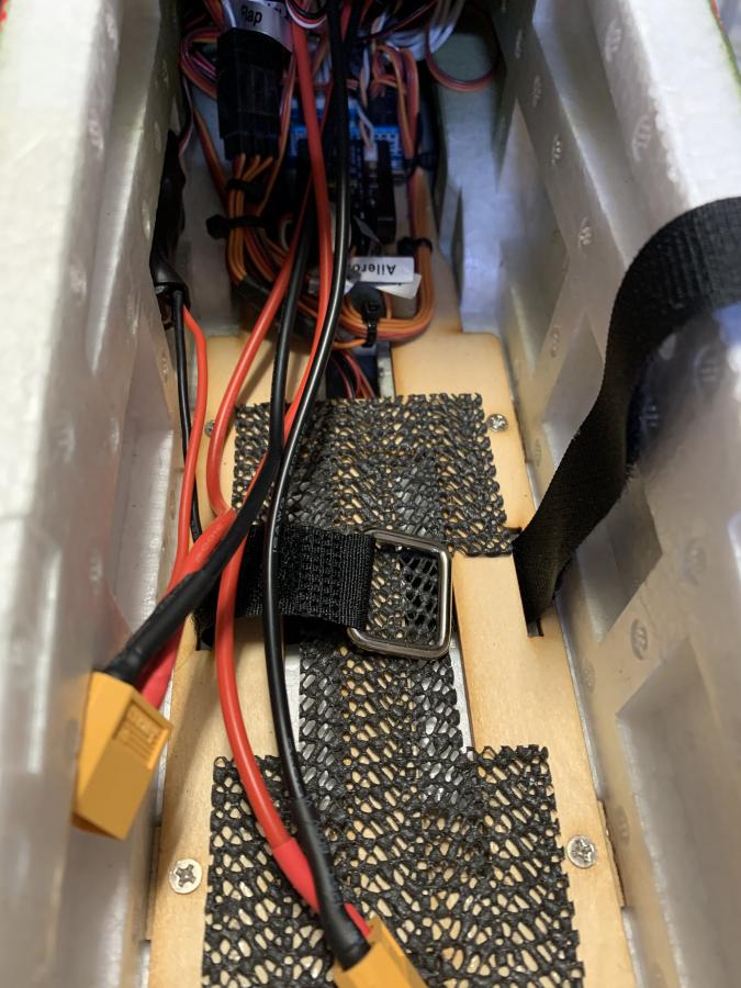

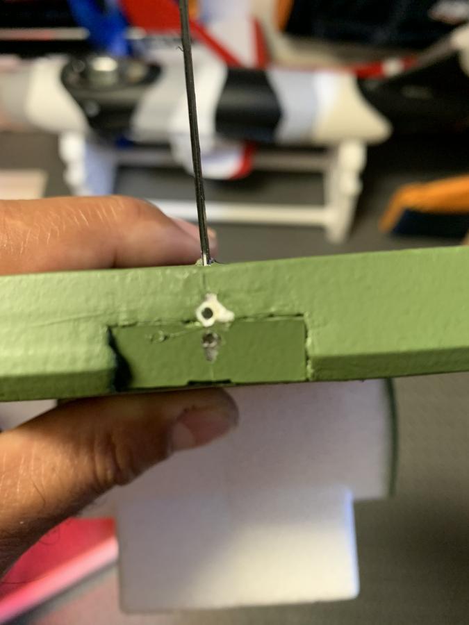

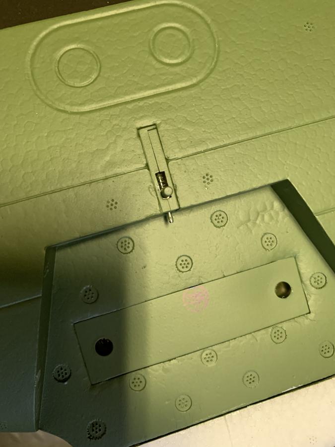

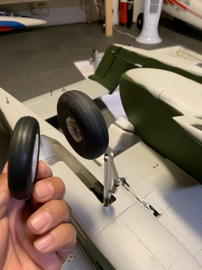

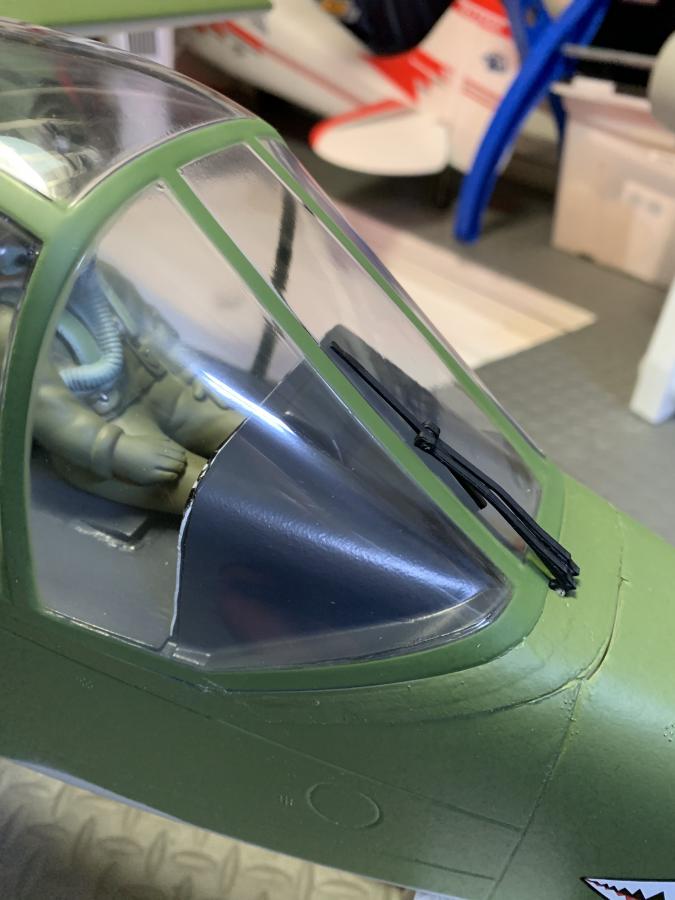

ID:	262873 Mine is ready to maiden. I have done couple of mods and will wait for weathering after the maiden. Swapped wheels for more chunky ones, install a windscreen viper and adjusted the canopy latch. If you think your latch pin is not long enough you can actually extend the pin by pulling with a plier and ca the other end to fix the extension.
                              Also tidied the battery bay so there is no rats nest.

                                • Im interested in your wiper, 3D or spare parts box?

                                    • I like the wiper!
                                      About the latch, I don’t understand “and ca the other end”. If you take the latch apart there is a hole and set screw in the bottom of the part that sticks up (the pat you move with your finger), the latching pin goes through the hole and is held in place by the set screw. If you can pull it with pliers it’s loose and will end up moving. Plus moving it means the back part of it is no longer in the hole it’s supposed to ride in. It may be working but it may end up where you can’t open the canopy or it loosens and the canopy comes off.
                                      • Originally posted by sam51401 View Post
                                        They are 3D from Thingyverse. I can’t remember the file name.
                                        You can search the RCG Flex Cessna 170 thread where I had seen them initially.
