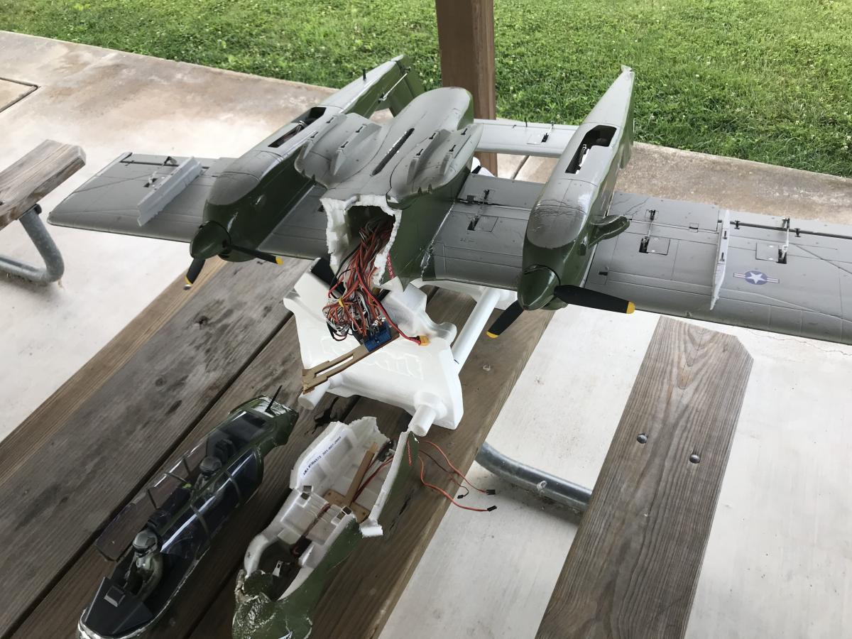

                    • 13th flight, exploring the edge of the envelope. This is NOT a manufacturing defect, but Pilot Error! Too slow of a loop with a significant crosswind at too low of an altitude. Accelerated stall and spiral dive into the ground. New fuselage, cockpit and center wing section and she will fly again.
                      • Sorry about your loss... 🤔
