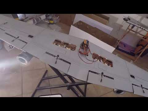

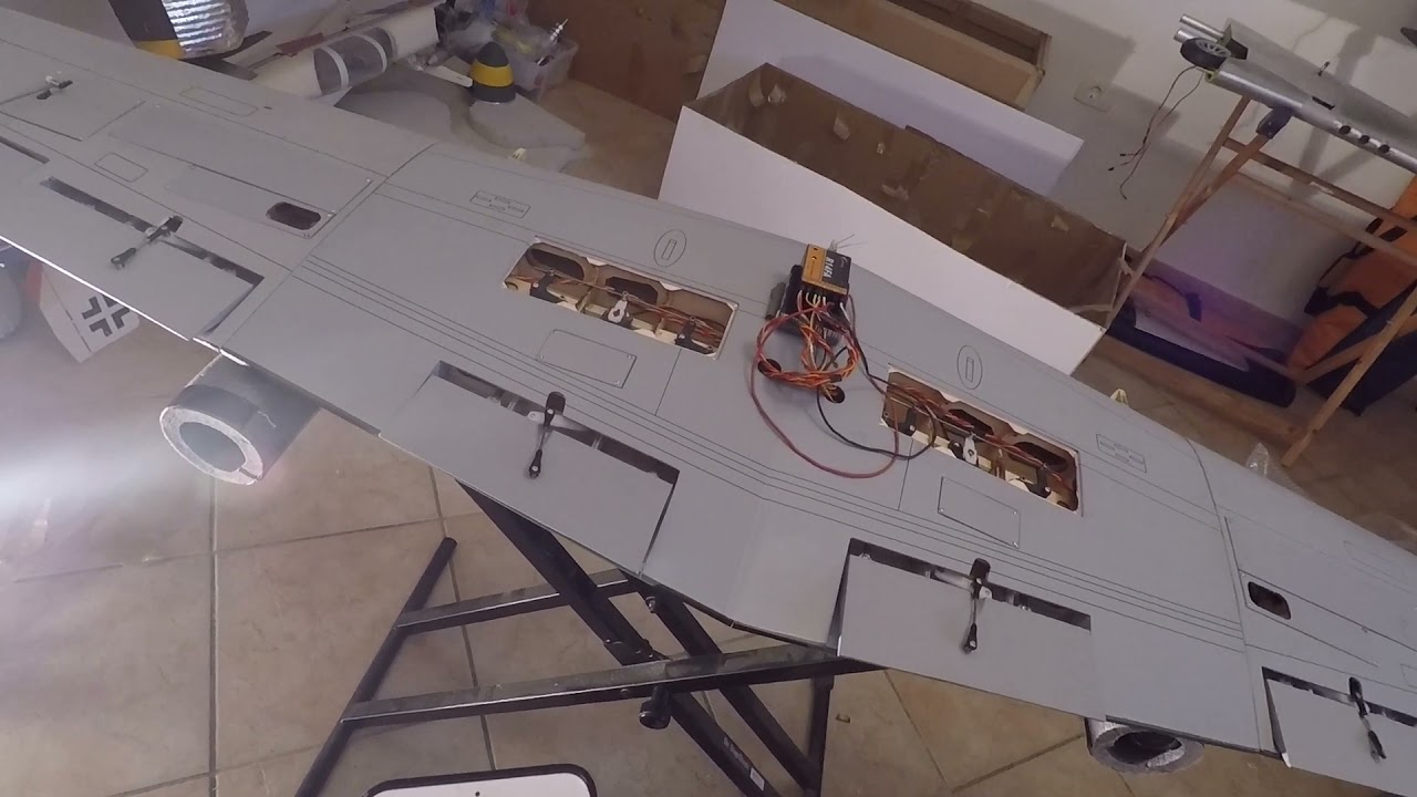

                                          #100
                                          Hello my fellow RC flyers and P-38 lovers. I am new to the thread. I am making a short youtube video thread regarding this Nexa/VQ P-38 Lightning. I am posting daily videos, so please follow and like. Thank you!
