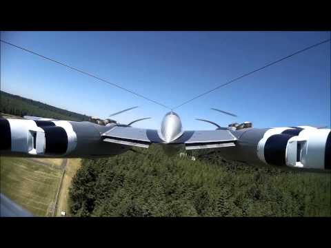

                          My buddy built this model for me back around 2011 or something like that and by FAR it was the most difficult aspect of the build. We never, ever could get them to behave with full close and open. Here's a video where you can plainly see the flaps unequal and unable to fully close in flight. Great flyer though!

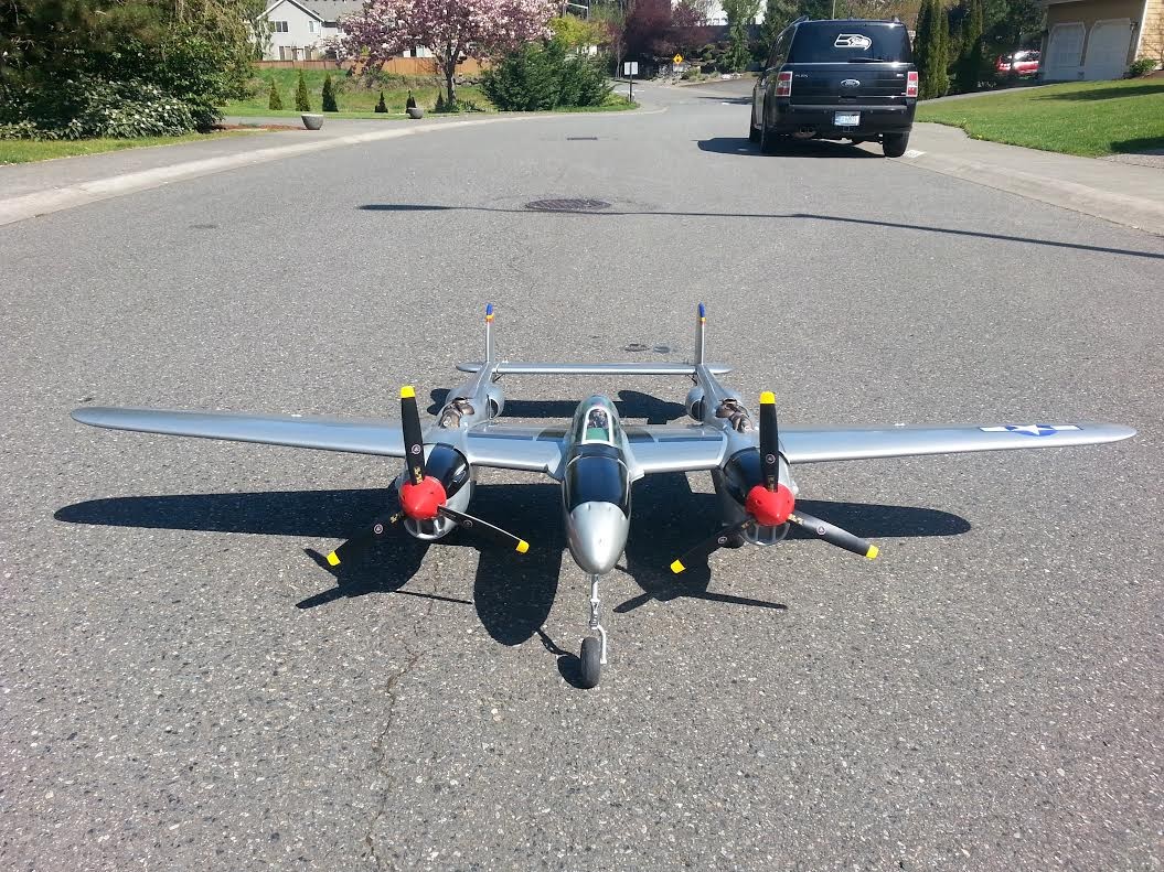

                                  This was my setup 9 years ago. Dualsky 470Kv motors swinging Master Airscrew 16x10x3 counter rotating props with Castle Edge 100A ESCs and 20A Pro Amp BEC with a Spektrum AR9020 9ch RX.
                                  Flew fantastic with that combo.
