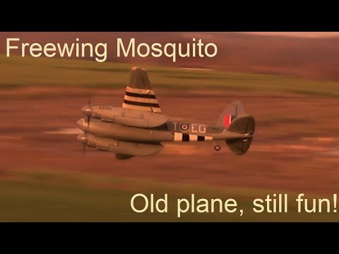

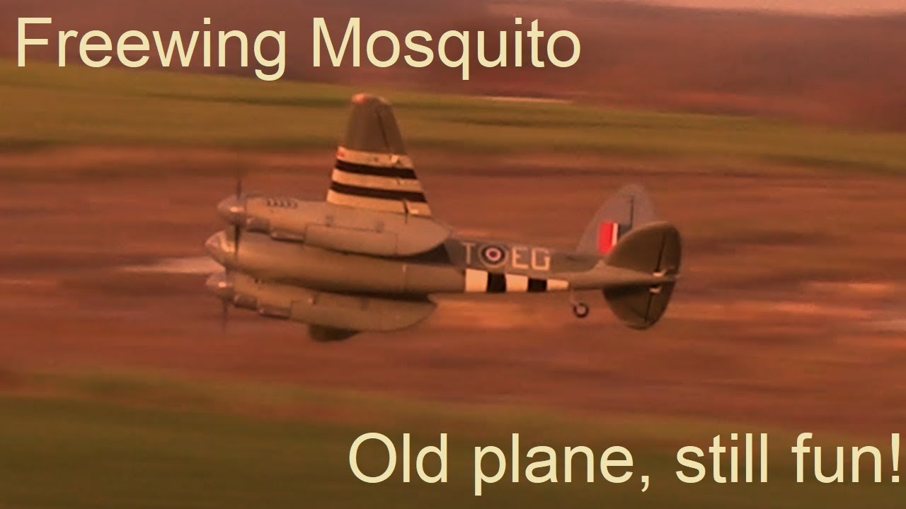

                                  Here's a whole uncut flight I did today with my Freewing Mosquito. Still going strong since 2016 and big fun to fly. Too bad the plane was discontinued ...
                                  Enjoy the whole flight and watch till the end for the silky-smooth landing

                                    Man, I'd love a V2 Mossie. Well done!
