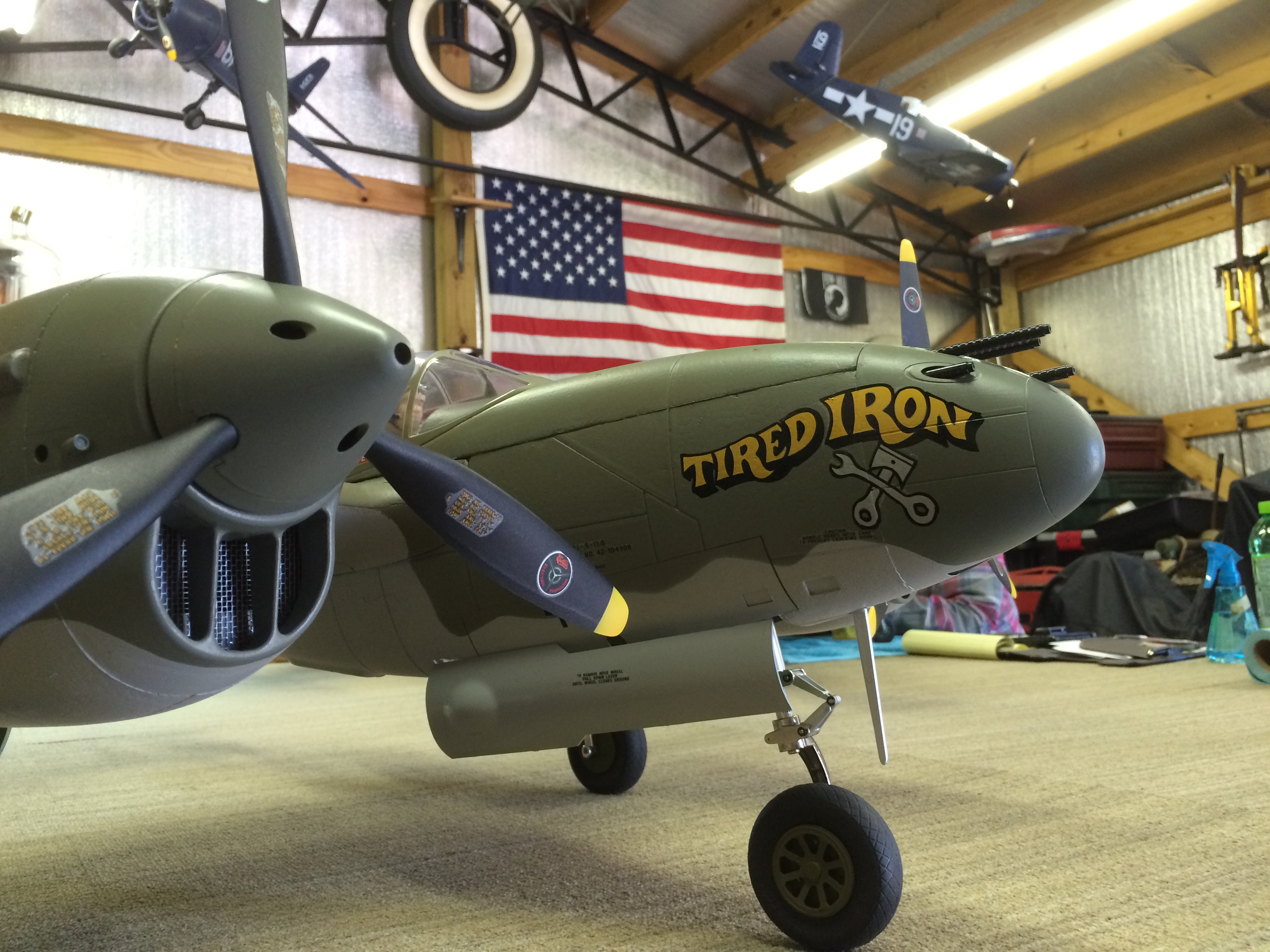

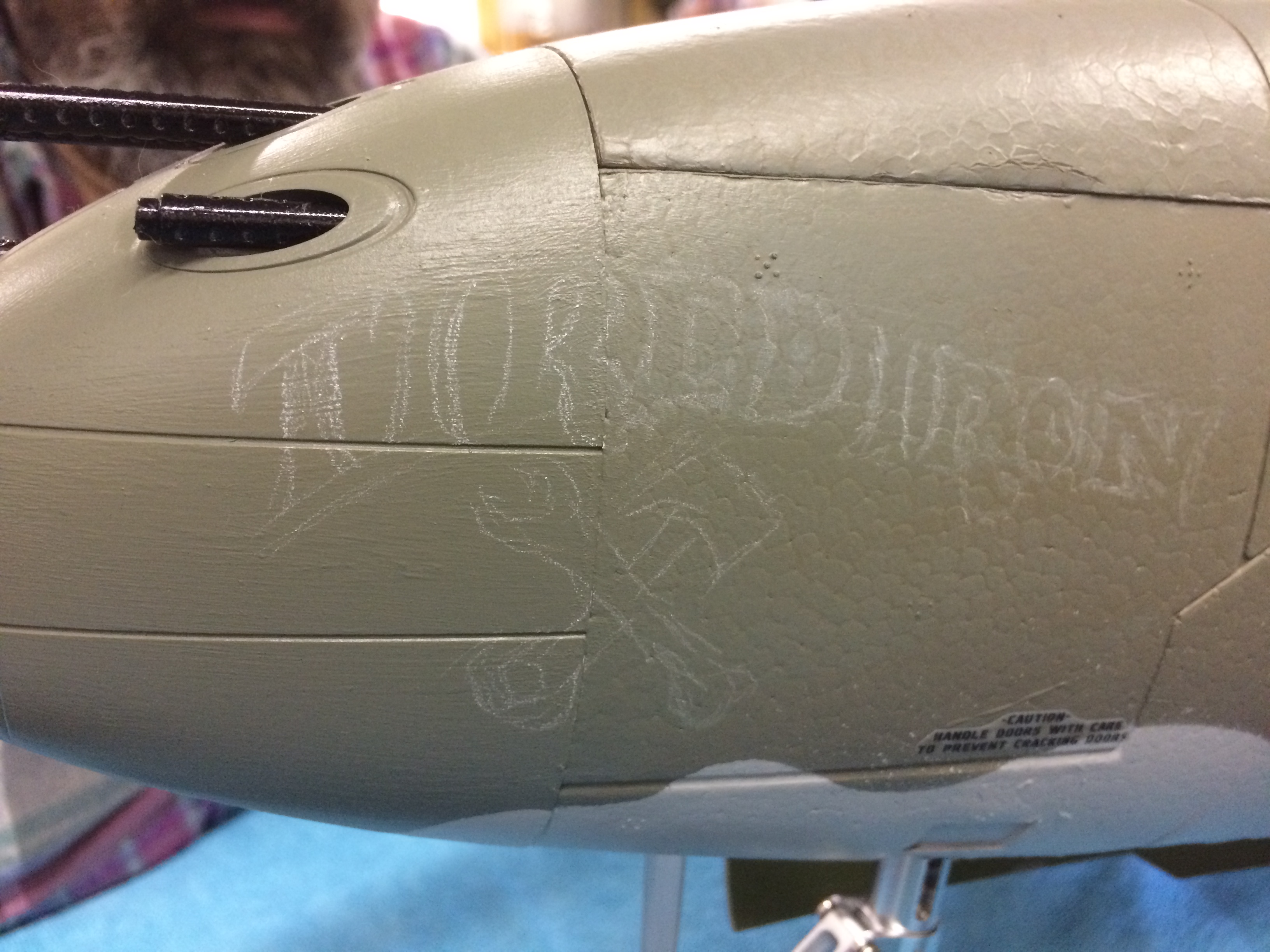

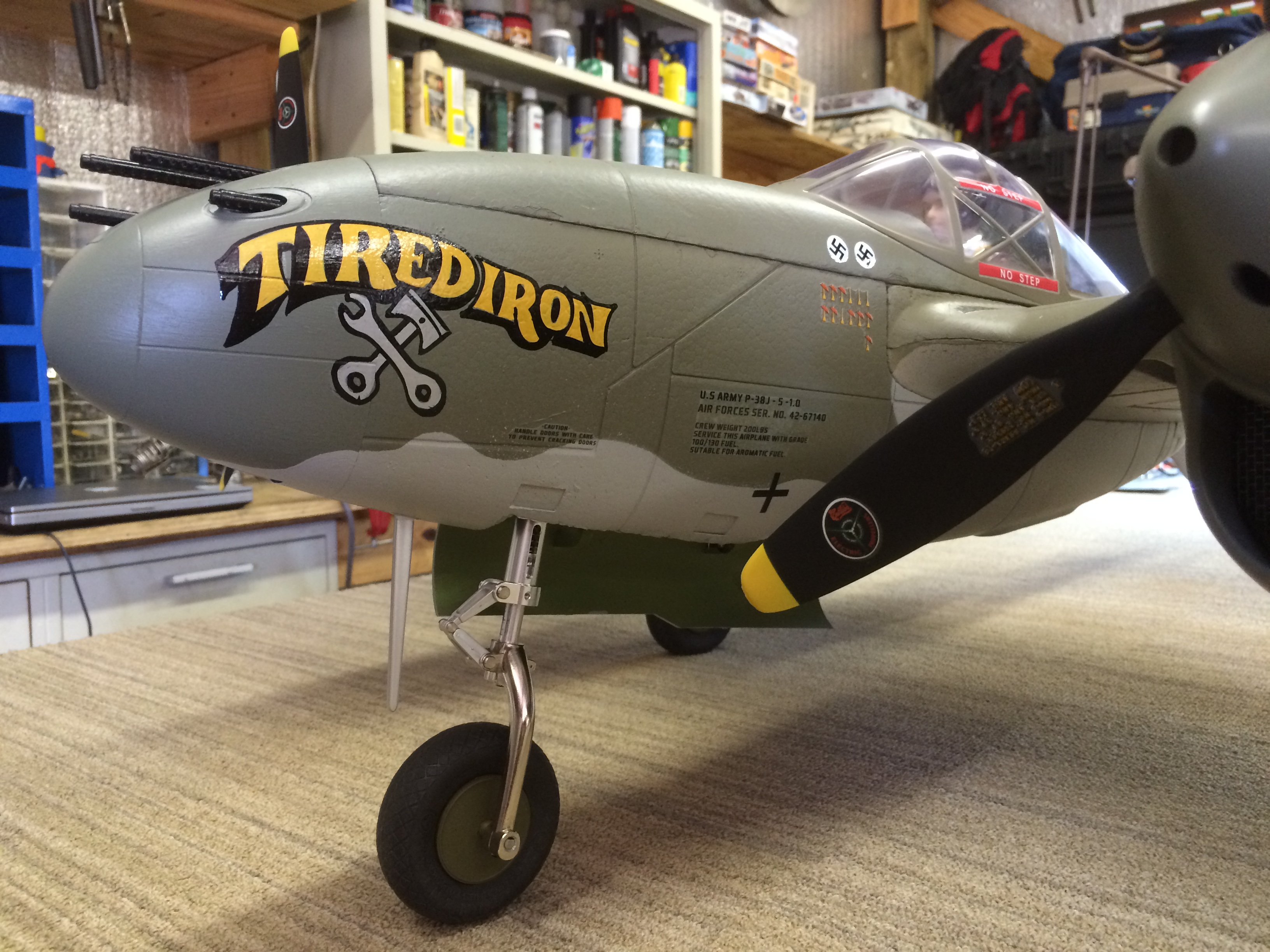

    Wow, actual, honest to goodness nose art! That is amazing work!
    My Pinstripper came over and did my nose art...
