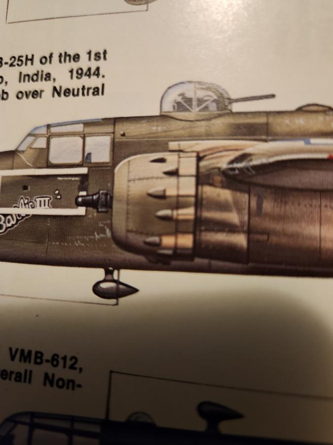

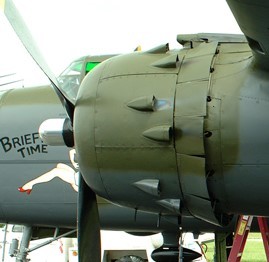

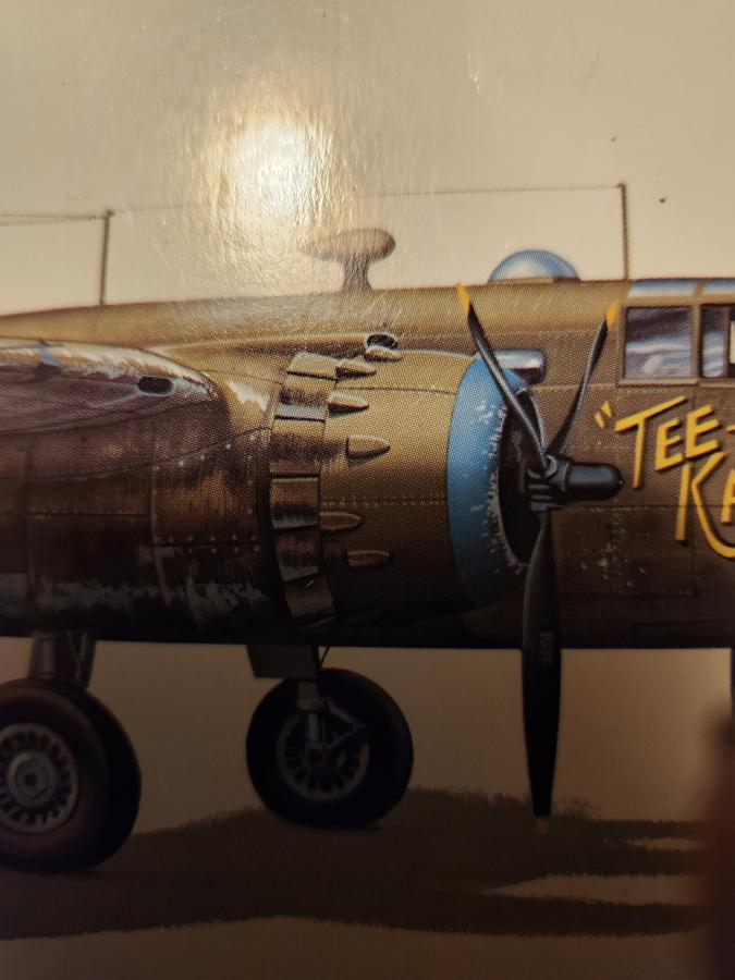

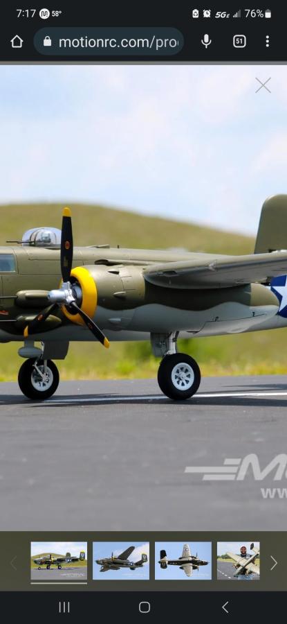

ID:	386077 The exhaust routing for the engines was changed for the B-25 wit Click image for larger version
ID:	386076 Click image for larger version
ID:	386078 h the C/D versions.
                      instead of exiting out the rear of the engine cowlings with multiple cylinders collecting together. The individual exhausts from then on were routed thru the sides of the cowlings making a marked change in the appearance of the cowlings.
                      Flightline has done an incredible job of recreating the B-25 J version. So I am happy that the only outline discrepancy other than the wheel rims is the number of exhaust stacks that are visible. And those appear to be a fairly easy fix.
                      somebody with FAST N LIGHT's skills will knock the design out before breakfast.
                      The only idea I came up with was to cut apart some old BIC pen caps and glue them around the cowling until I realized the plastic they are made of won't hold paint. My olive drab plane would look silly with blue and black lumps around the cowlings.
                      I definitely think a 3D printing would be a much better solution.
                      SpadDriver

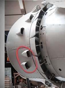

                              I think I am following. You want to add the 2nd row of exhaust ducts which are forward and circumstantially offset from the ones on the FL model?
                              Certainly this could be solved.
                              Challenges
                              1) Modeling the duct. I haven't modeled this type of geometry before, so would need to invest some time in learning.
                              2) Matching the existing ducts. I would likely cover or remove the existing ones to get the set to look same & scale.
                              3) Attachment to the nacelle. Would be helpful to see what is behind this exposed surface to create the attachment features for the duct.
                              4) Design for print-ability. Depends on 1 to 3.
                              If I had the B-25 model in hand so I could get all the needed data, estimate I would take 15 to 30 hours to develop this duct (eg design, print trials & initial installation).
                              There may be others who can knock this out more quickly - please be my guest!

                              The modeling challenge is very similar to the gunship nose so I will start exploring with that challenge in the next 2 or 3 weeks.
