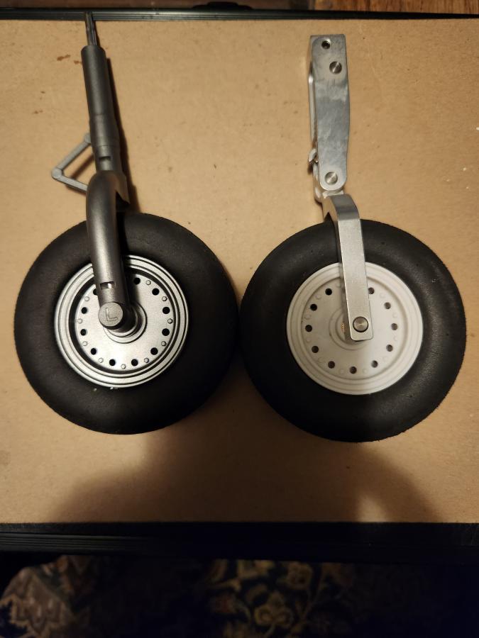

                        Gentlemen,
                        I put the Robart 2.25 wheel on the nose and it fits just fine and will use it until I can get the rims 3D printed.
                        AND I think I found a solution to our tire problem.
                        Those of us that have upgraded our A-10's or B-24's suspensions have soft squishy tires already in our spare boxes!.
                        the tires off of the original stiff struts that we replaced are an exact match for the stock tires on the B-25's struts!.
                        And I'll bet they are available on MRC'S website as replacements for the A-10 and B-24.

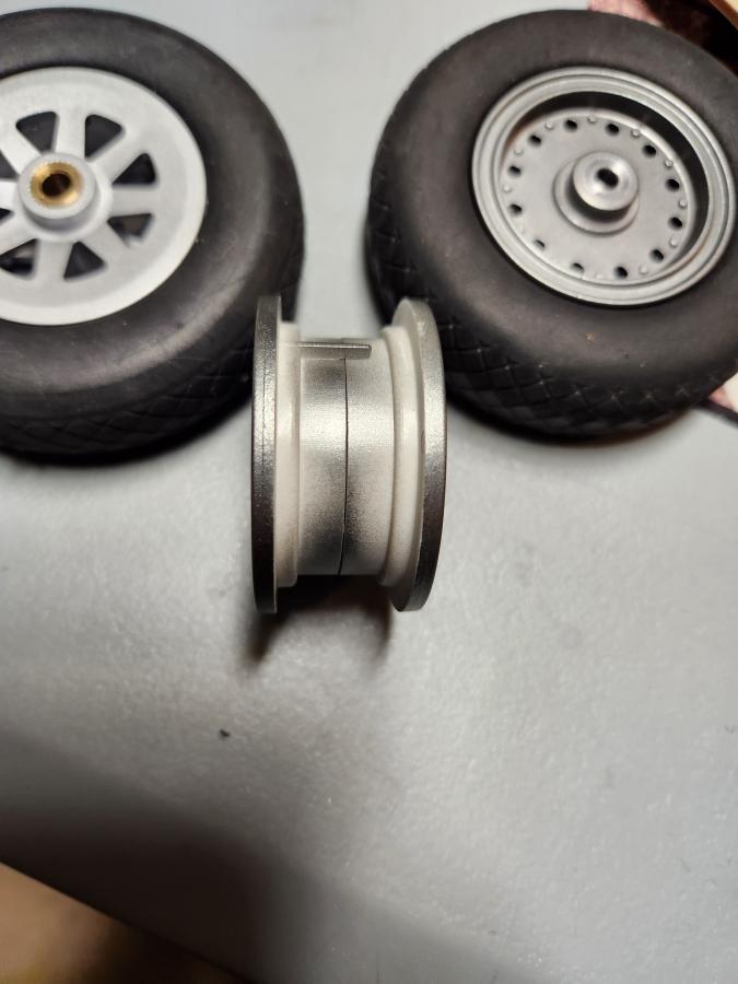

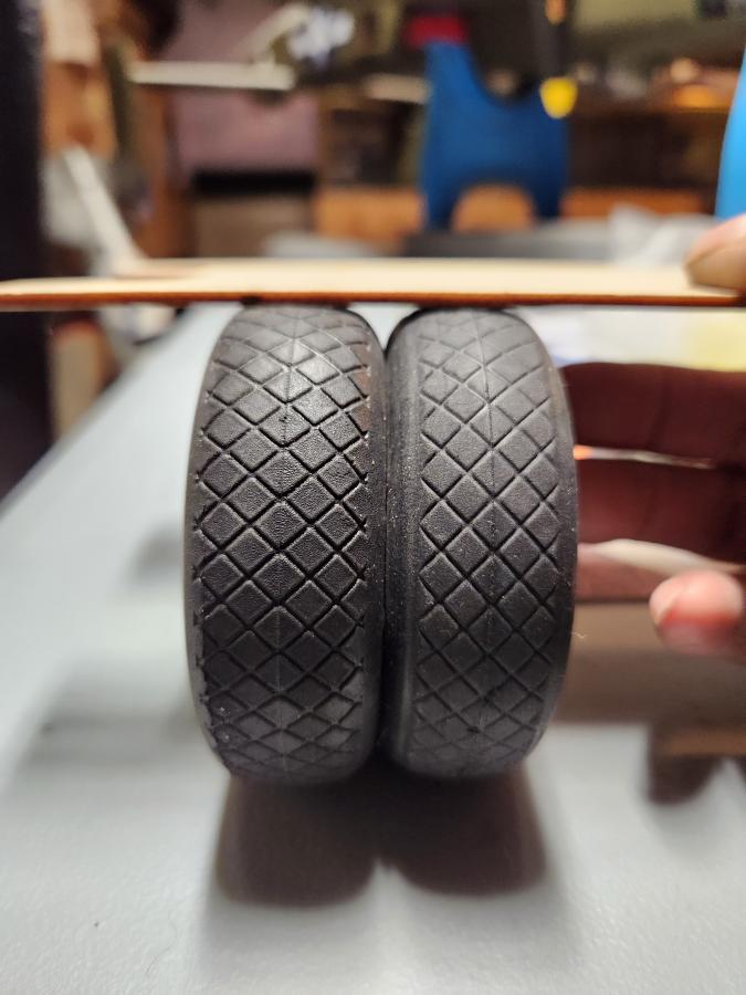

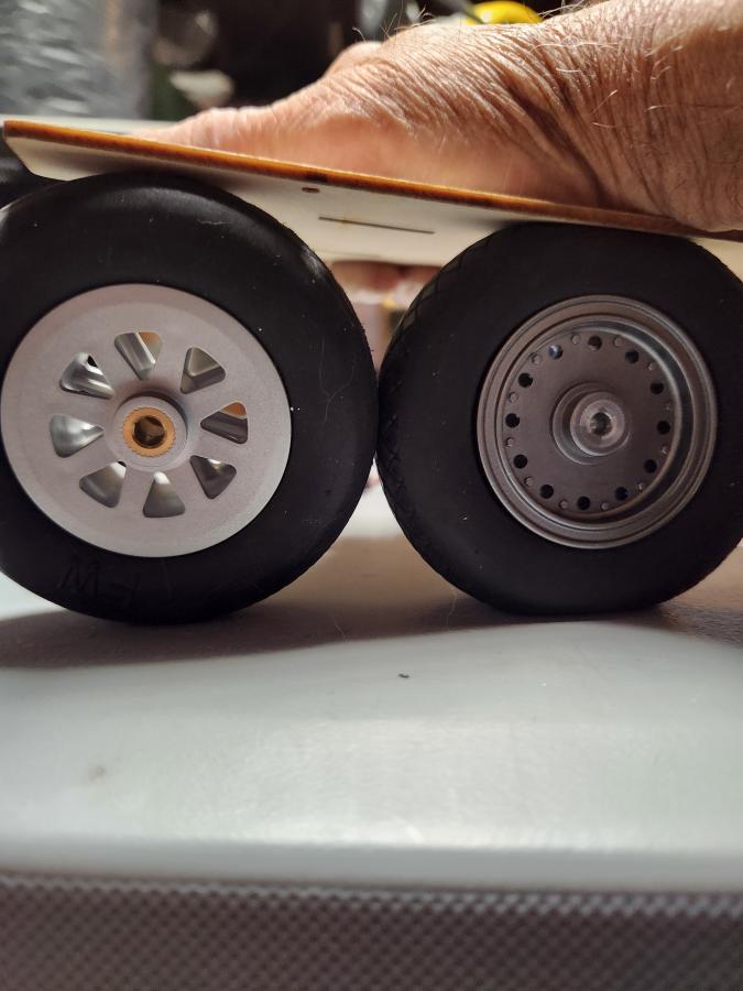

                            the Robart 2.25 rim is 26mm in diameter. The axle shaft width is approximately .5mm wider than the stock shaft. So use the stock axle width so there is less chance of the wheel binding.
                            The stock main wheel is 50mm in diameter. The width is 25mm with a 3mm rim. Axle shaft is 26.5mm in width. Measurements made with dial calipers.
                            The tires that I'm using will peel off the stock rims with a little effort and should fit on your rims when I have them made.

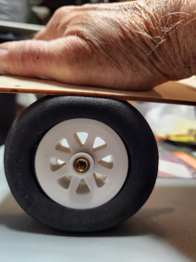

                            Some pictures of the difference between the stock wheel and tire versus the B-24 wheel and tire.
                            trying to show that the tires are the same physical dimensions but have vastly different stiffness.
                            The first picture is showing them under compression.

                              #494
                              Correction!.
                              The dimensions I gave for the main rim is correct for both the B-24 and the B-25. But the axle shaft diameters are different.
                              the B-25 shaft is larger than the B-24's so I will be using the B-25's rims with the B-24's tires.
                              perfect fit!.

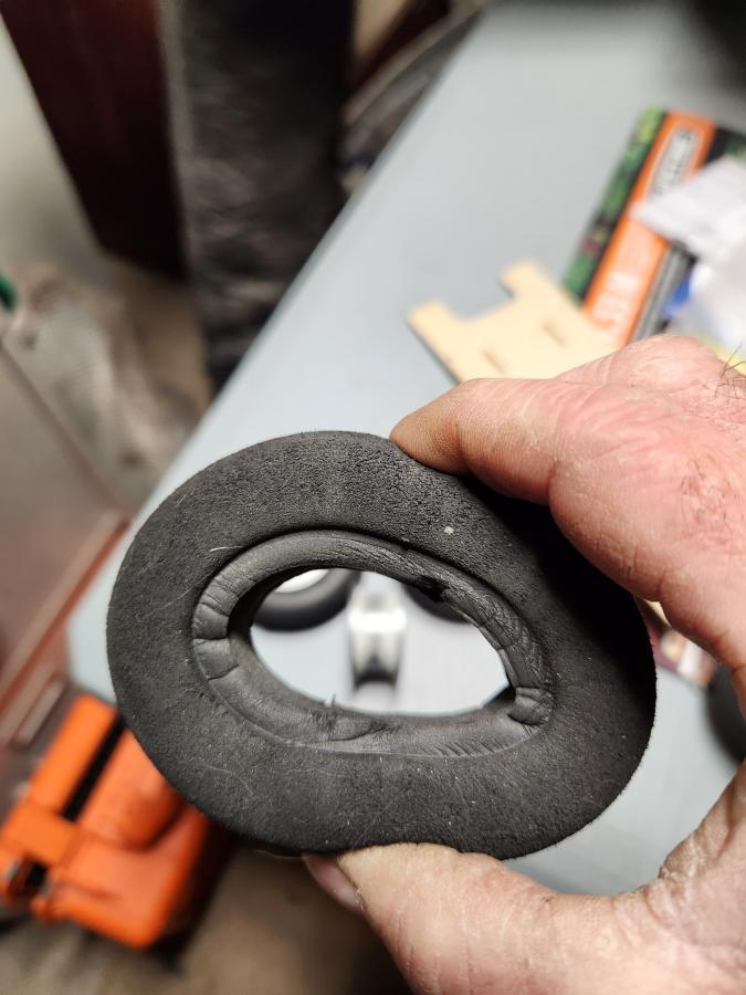

                              Spad Driver Click image for larger version

                                #495

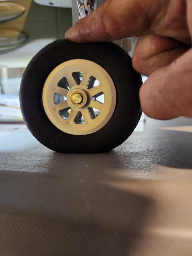

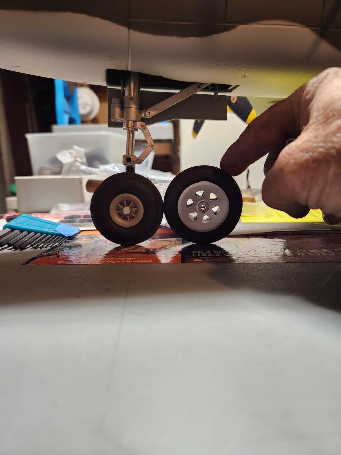

                                Robart 2.25 nose wheel with stock wheel beside it.
                                B-25 rim with B-24 tire installed under compression.
                                Spad Driver

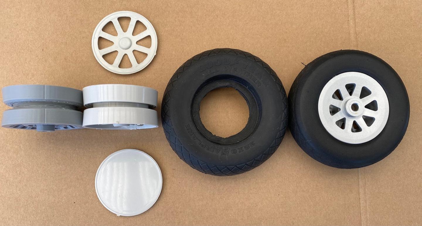

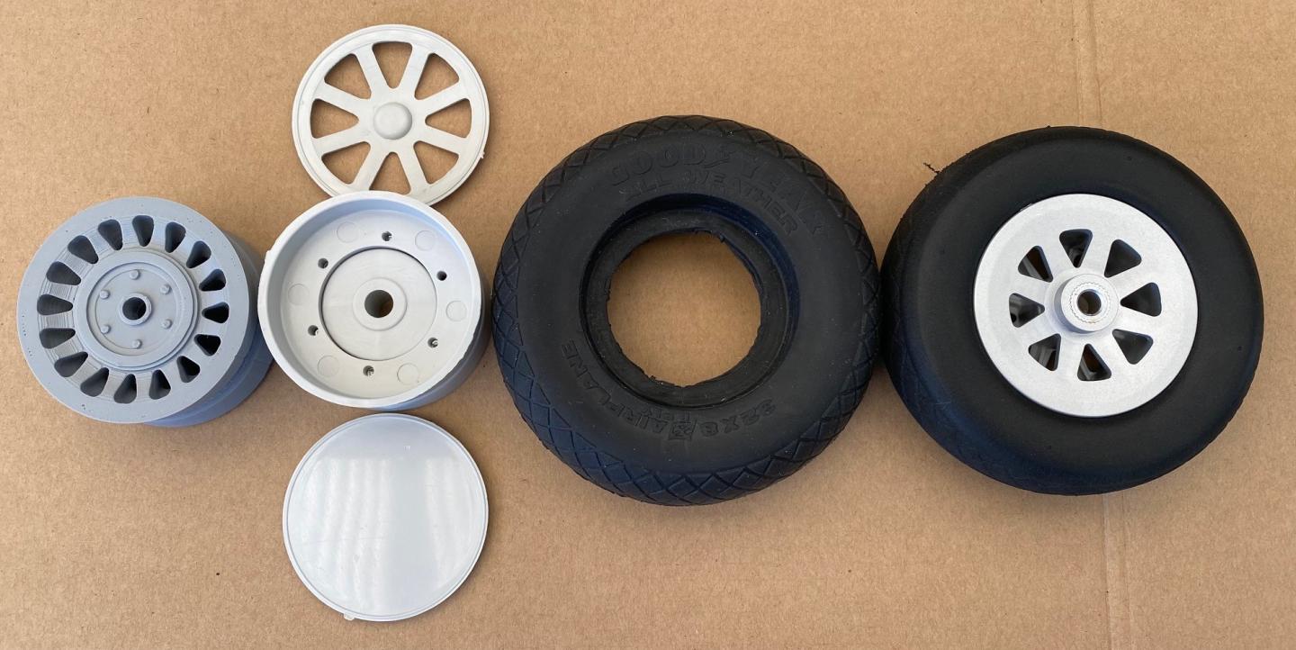

                                  Looking at the Robart website, it appears their rim for 2.25", 2.5" & 2.75" tires are identical. Therefore I am expecting that the rim I designed with a 2.5" tire will also work with the 2.25".
                                  It looks like the tire shown on your nose gear is a Dubro low bounce tire. They perform well as a low bounce tire, but the rim diameter is too small to fit the rims which I have designed.

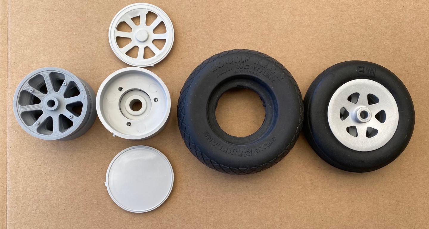

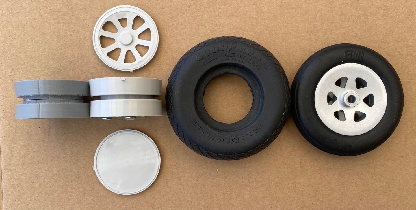

                                  Updated .STL files are posted on Thingiverse with the modification I have made since I started fitting them to the B-25 model. Still a work in progress....
                                  Front wheel from left to right, G16.STL printed rim, Robart rim & hub caps, Robart 2.5" tire, FlightLine OEM tire & rim
                                  Click image for larger version  Name:	IMG_4081.jpg Views:	4 Size:	134.4 KB ID:	388550
                                  Click image for larger version  Name:	IMG_4082.jpg Views:	4 Size:	149.9 KB ID:	388551
                                  Main wheel from left to right G16.STL printed rim, Robart rim & hub caps, Robart 3.5" tire, FlightLine OEM tire & rim
