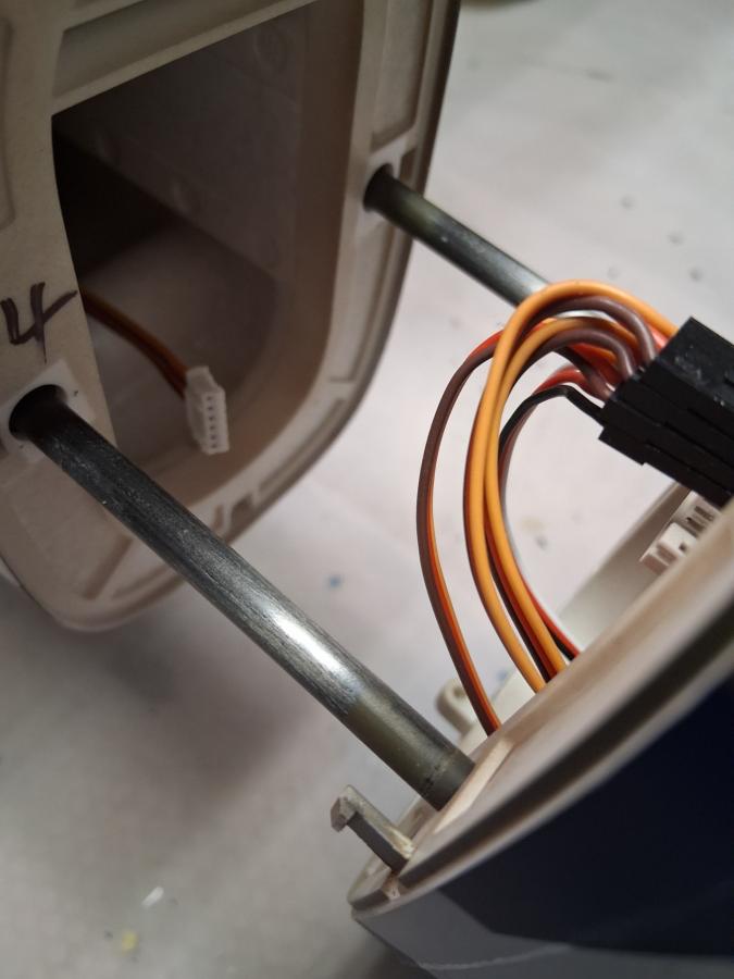

          Here's what I found when I slid back the tail section. The plug was , well, unplugged...
          Click image for larger version  Name:	20260922_191236.jpg Views:	0 Size:	45.4 KB ID:	453041
          So that's why you had no rudders of elevator. I can't figure out why this would come loose, but I ordered a new circuit board and will have a look at whether I can use a zip tie to help hold it in maybe.

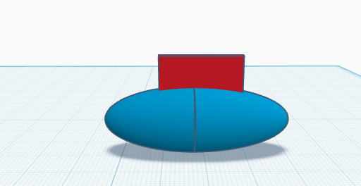

          For some reason, MRC doesn't offer one for sale. Worse comes to worse, I'll design one if one of the guys would be kind enough to measure the piece for me.
          Elbee had been kind enough to offer the STL files for the forward greenhouse and cockpit, could you print these for me when I get them?

              Thanks for finding that out. Since I definitely did NOT have elevator control at the critical moment for takeoff, I've got to assume that somehow, it came loose after I completed flight number 10 and found out about it unfortunately, on the takeoff roll of flight 11 (101 career takeoffs.) Since it never got off the ground, I can't count that as a flight, but you can add number 101 and more when you get it all together in flyable condition again!
              Sorry, I have not found the ADF antenna in my kit. I don't think it was destroyed and I thought I took it off or found it on the ground nearby, but so far, no.
              Perhaps you could ask Elbee if he could send you an STL for his B-25 and we could print it up for you. I did see that he offered to send you some STLs to this would undoubtedly be much better than the OEM foam antenna that came with the kit. I'll continue to keep a lookout for mine.

                That'd be great, or at least the dimensions so I can create one myself. I looked through the spare parts page twice but there is nothing there, strange eh?

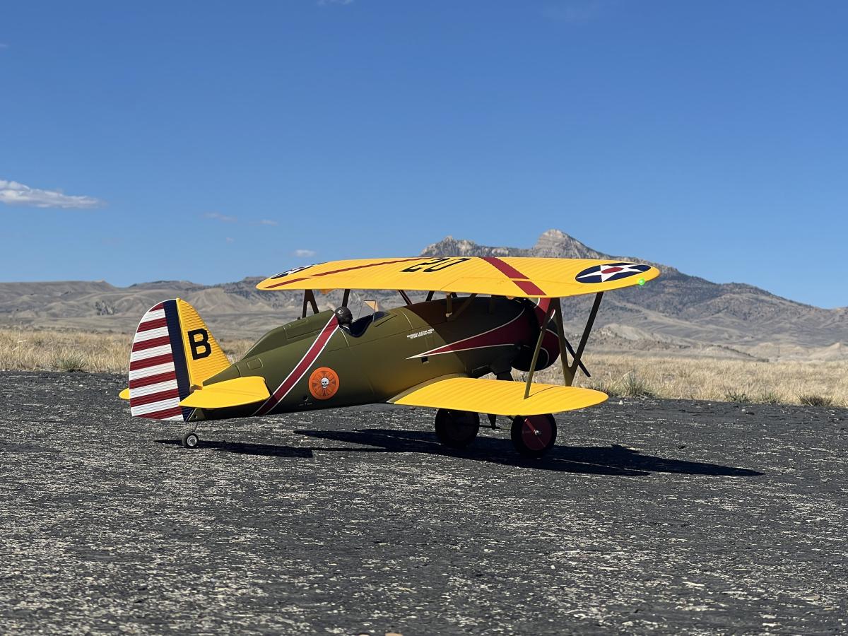

                  I used 5000 mAh batteries exclusively on the B-25. I did find a small weight, about 0.7 ounces that must have been in that forward cockpit area somwhere, but I have no recollection of putting it in there. I cleaned it up and put it in the nose of the P-12E as it needed just a little nose weight on mine, just to be perfect. Maybe I could get away without it, but I'd prefer it to be slightly nose heavy for flying. You might want to double check the CG when you get it all back together in case it needs a little extra weight in the nose for perfect CG.
                  Gonna try it early next week. Went out to the field today to do some ground tests, too windy to try putting it in the air. I'll attach a couple pics. It really is a very cool airplane, and the Navy version is very popular amongst modelers that I have seen. We'll see how it flies next week.
                  I read that RC Geek did a lot of the development of this model. Looks like he was spot-on from what I've seen so far!

                    Good looking little airplane!
                    There was a cutout hole on the floor of the nose, I think you may have put the weight there and then mounted the gunner over top of it. At any rate, I'll do some CG tests before filling it in.

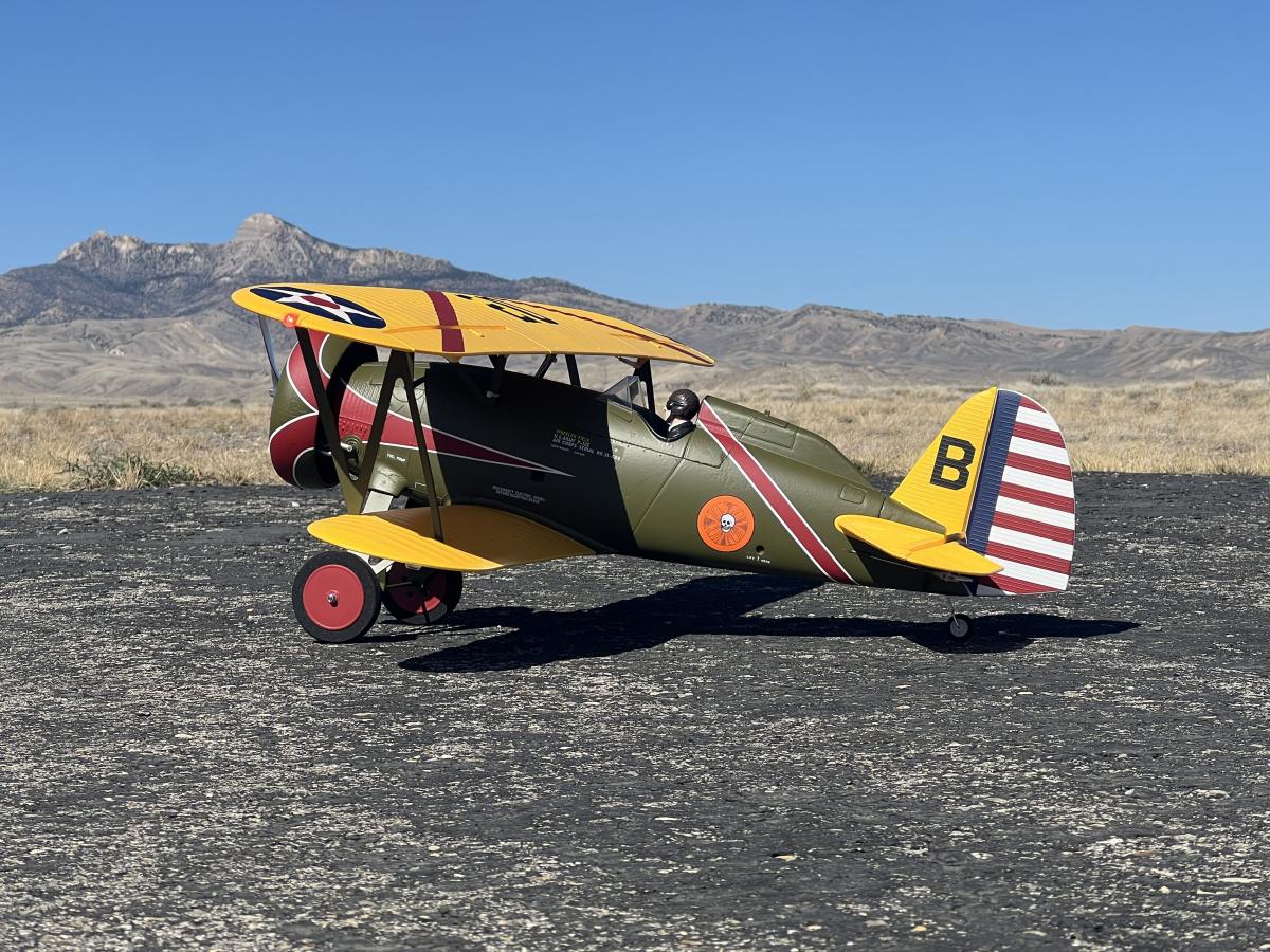

                          Dry Fittin' The Kitten!
                          Got the new front gear door on and had a piece break on the starboard main strut. Took it a part last night and glued it with E6000. Seemed pretty good today so I reassembled it and ran the gear a few times, worked like a charm. I ordered a new piece just in case and will probably swap it out.
                          Here's how she looks so far, mostly paint work left. Had a quart of grey that I used for the P51B so I used that as a base coat, not quite the right shade, a little too blue, but good enough for something I'll probably end up sanding. Let's see, a little white to lighten it up and orange to neutralize the blue (primary colors red yellow and blue. Complimentary color to blue would be a combination of the other two primaries, yellow and red, which equals orange)

                            Grossman56,
                            Looks like normal wear and tear to me, Dan.
                            A little light weathering and you're good to go.
                            Nice work, Sir.

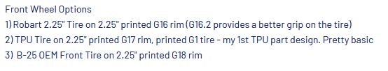

                                In May 2024, I released an updated version of the Robart front rim to help with the side loads. A dab of glue should work on the original Oct 2023 version, but the latest one should work without that assist.
                                Link to Thingiverse
                                https://www.thingiverse.com/thing:6184138/files
                                . Click image for larger version  Name:	2026-09-30 19_09_57-B-25 J RC Airplane Scale Wheel Rims FlightLine by FnL_Flyer - Thingiverse — Mozi.jpg Views:	0 Size:	11.8 KB ID:	453190 Click image for larger version  Name:	2026-09-30 19_08_29-B-25 J RC Airplane Scale Wheel Rims FlightLine by FnL_Flyer - Thingiverse — Mozi.jpg Views:	0 Size:	17.9 KB ID:	453191
                                Amazing to me that the Thingiverse post has seen 6.300 views and over 1,200 downloads since it was the very 1st wheel set I designed. The subsequent wheels have been of even better design , but come nowhere close to the number of hits.... Most of those designs are listed on Cults https://cults3d.com/en/users/FnL/3d-models with a minor fee to support my efforts.... Is $5 or $10 support for my efforts really unjustified?
