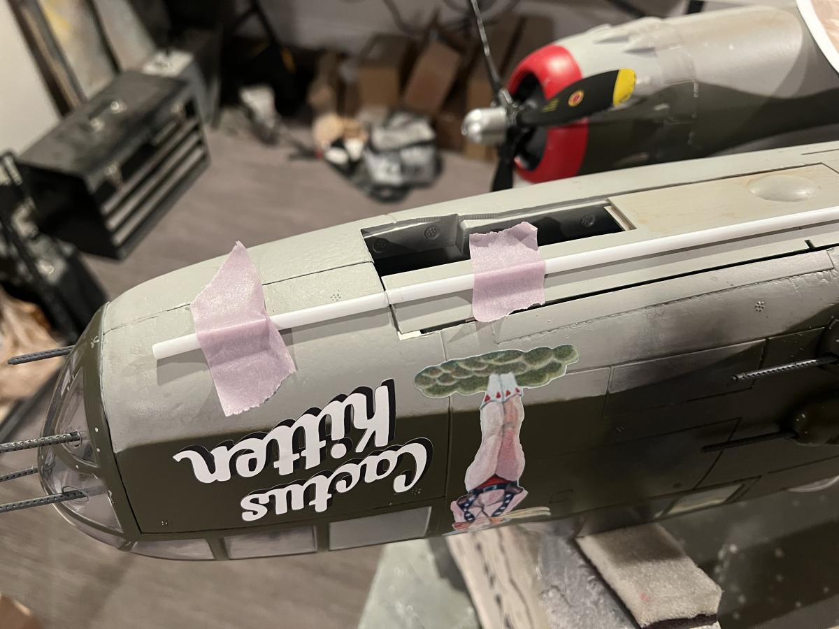

    The next step is to work on a scratchbuilt replica of the venturi tube that goes underneath the forward fuselage of the aircraft. This tube helped remove gun gas fumes from the nose section in flight. I'll take some more pics as I proceed with it. Not much to go on, but I think I can come up with a fairly believable replica of this part that was on planes like Cactus Kitten that I am working on.

        Thanks, Steve. Just a preliminary first step in sizing how this will go together. Charlee confirmed for me that there was a "break" in the venturi tube at the forward edge of the nose wheel door. So, there are basically two tubes that make a fairly tight fit with the gear up and doors closed. The forward tube is bolted to the forward fuselage, and the rest of the tube is bolted onto the nose gear door itself.
        Charlee explained that the reason for that blister being off to the right side of the nose gear door and not centered on the centerline as the Flightline folks designed and produced it, is because for whatever reason, the nose wheel when retracted is not centered on the fuselage but actually is angled off to the side, thus the reason for the blister being offcentered to accommodate that fact. I found that very interesting why it was designed that way. Nevertheless, that is why I will have to modify that gear door with the blister now off to the side. The venturi tube is curved to follow the shape of the relocated blister with the exhaust for the air just behind that blister.

                  I've been working a lot the last day or two getting my venturi tube replica finished. It actually went pretty well, and I have essentially finished it now. For those who may not have read my other posts on this, the plane that I am detailing from the standard liveries available from MRC, is a B-25J called Cactus Kitten. These B-25s that were converted to low altitude (I mean REALLY Low!!)strafers and bombers. They added a ton of firepower in the nose sections of these airplanes multiples of .50 cal machine guns, and in some cases a 75mm cannon, the same as on a Sherman tank! Anyway, with the gunships they collected a lot of the gun gases when all these machine guns fired. They needed a way to evacuate the smoke from the nose section ASAP. What they came up with was a hollow tube that ran from the nose to the back of the nose gear door. This tube in flight would have high speed ram air running through it and would suck those fumes into the venturi tube and then out of the airplane.
                  Up until a couple of weeks ago, I didn't even know this device existed back then. I was really impressed with the head work and competence of whoever figured this out. My Cactus Kitten plane can be seen in one or two period photos with this tube on the underneath side of the fuselage. I just HAD to add it!
                  Below are some progress pics. I had to do a little "surgery" on the nose gear door to make this work and everything lining up. The model has this blister in the wrong place. I had to carefully cut it off with a razor saw, do patching, sanding, all that stuff, and eventually I got the look I wanted. I used Evergreen 3/16 OD plastic tubing, and some.010" sheet for other detail areas.
                  Click image for larger version  Name:	IMG_2333.jpg Views:	0 Size:	70.5 KB ID:	412013
                  Click image for larger version  Name:	IMG_2337.jpg Views:	0 Size:	71.3 KB ID:	412010 Click image for larger version  Name:	IMG_2338.jpg Views:	0 Size:	126.3 KB ID:	412009 Click image for larger version  Name:	IMG_2339.jpg Views:	0 Size:	133.0 KB ID:	412006 Click image for larger version  Name:	IMG_2340.jpg Views:	0 Size:	73.4 KB ID:	412007

                      This is one that has to be mostly "eyeballed" since I have no design drawings, but I think I'm fairly close. That's about all I can do for what it is. I'm glad I put it on, though. Good to get the ol' noggin working to figure out how to do it. Not a big deal, but sorta fun, too.
