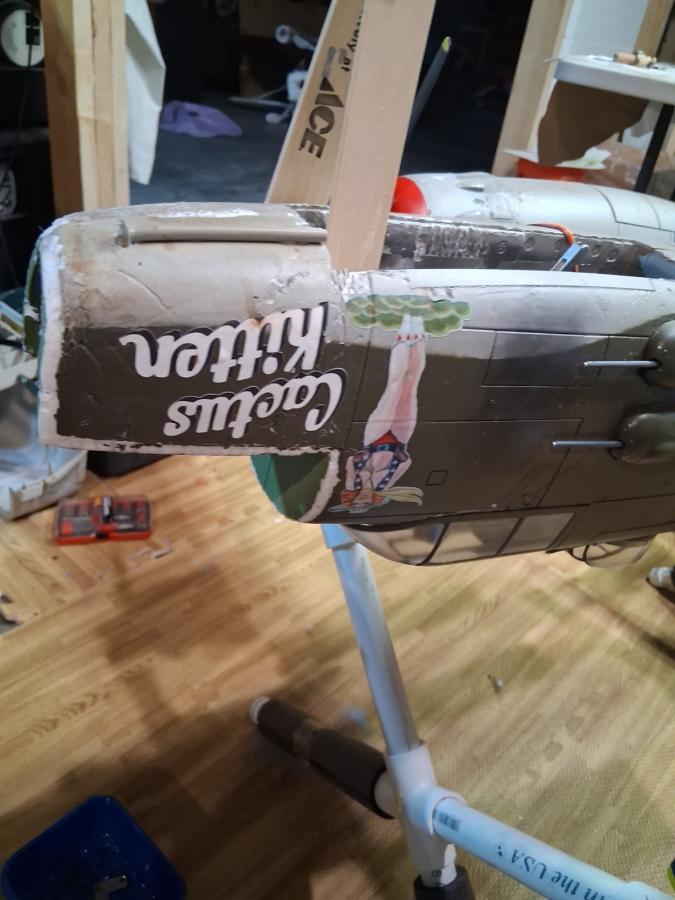

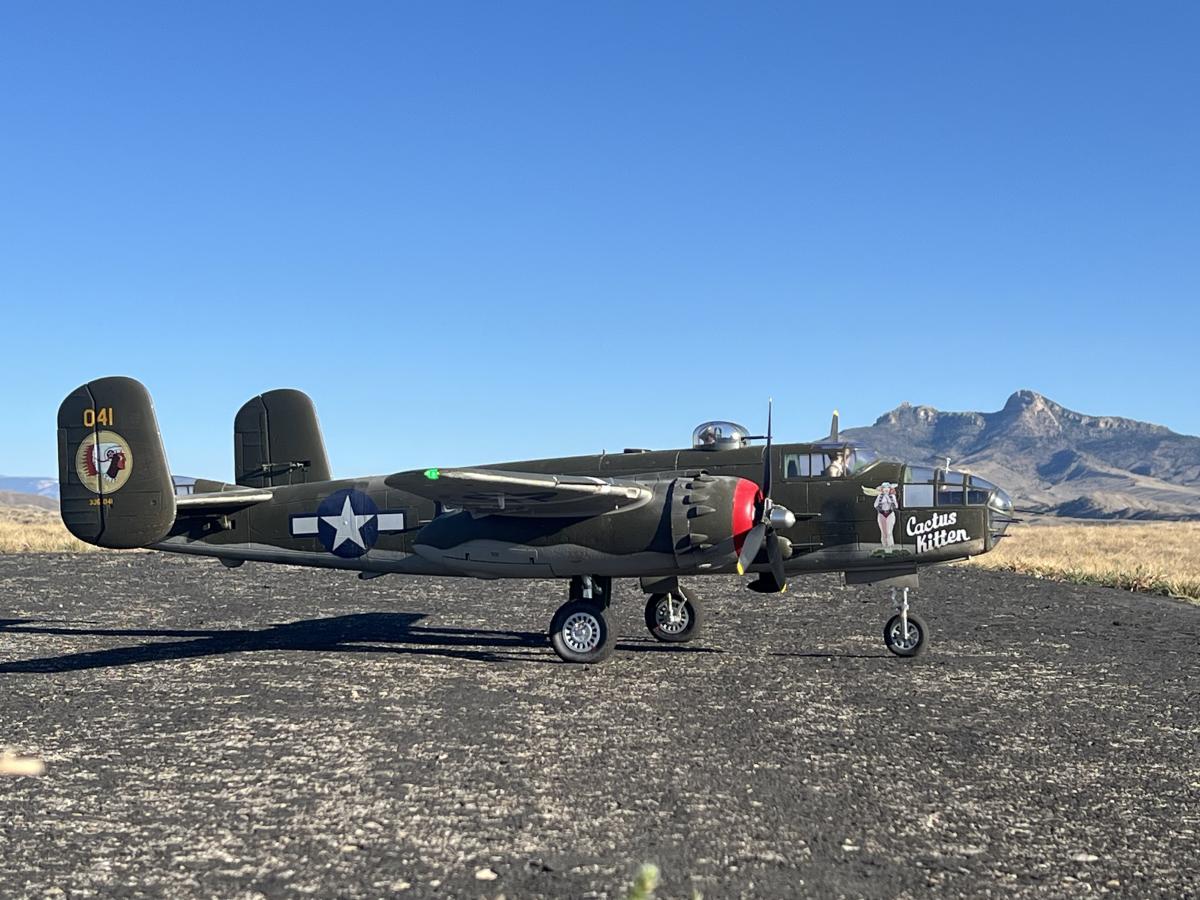

          I have every expectation that Dan will be able to rehabilitate this airplane to its former glory. Over the weekend, I decided I wanted to get my 100th flight in that day. I was sitting at 90 and just decided to keep on flying it until I hit 100. It has never been severely or even mildly damaged up to this point. Anyway, got FMS P51 Mustang 1450 & 1700 Flight Times? in, but before packing it up, I thought I'd like just "one more" to finish up its career as the previous landing had been less than ideal, not terrible but one I wanted to improve on. I had no plans on flying it after that.
          Unfortunately, even though I had 100 successful flights on this airplane, the takeoff roll went normal and then I noticed that I had no control of my elevator as the airplane was screaming down the runway towards the end. I was too slow to try and use the Very impressive reverse thrust on this airplane, and it went rolling at high speed off the end and impacted into some nasty scrub brush which wrecked the nose section. The rest of the plane was undamaged. So, a major chore will be finding out what happened to elevator and rudder control. Nothing obvious at this point.
          I offered the plane to Dan, as he is well known for his amazing restorative skills with foam airplanes. There is still a lot of life with it if he can repair the damage to the nose. I also offered that if that doesn't work, he can buy a replacement forward fuselage section for about $117 and essentially have a new airplane.
          I did a lot of upgrades with the plane that are still good. The Robart diamond tires, WWII scale wheels for the nose and mains, and other stuff like that. This was based on a real airplane that lfew in the Southeast Asia Theater in WWII, and was lost to antiaircraft fire near Saigon in what was then French Indochina. All five crew were lost, unfortunately.
          So, I"ll look forward to see Dan's progress and hope he has a lot of good flights on it like I did for over two years.

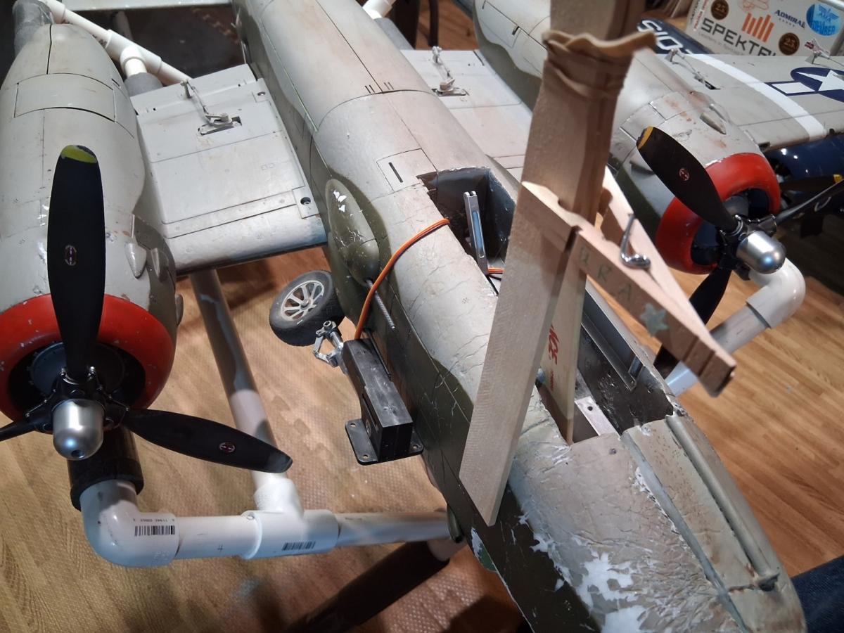

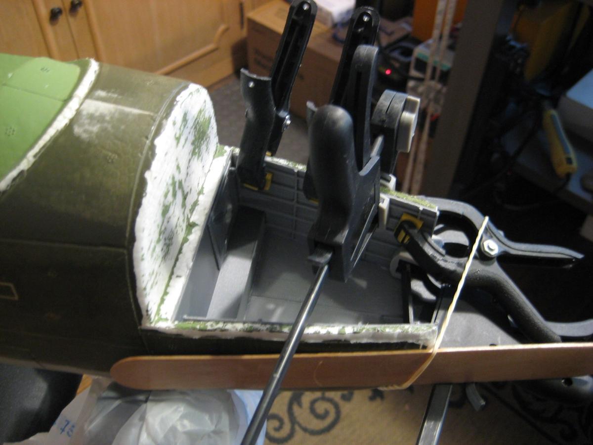

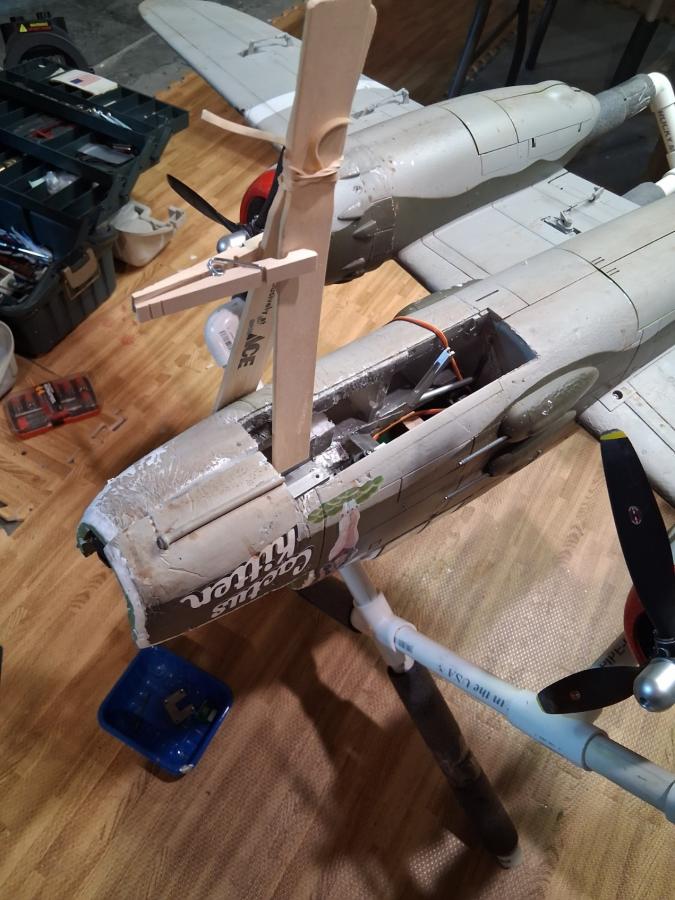

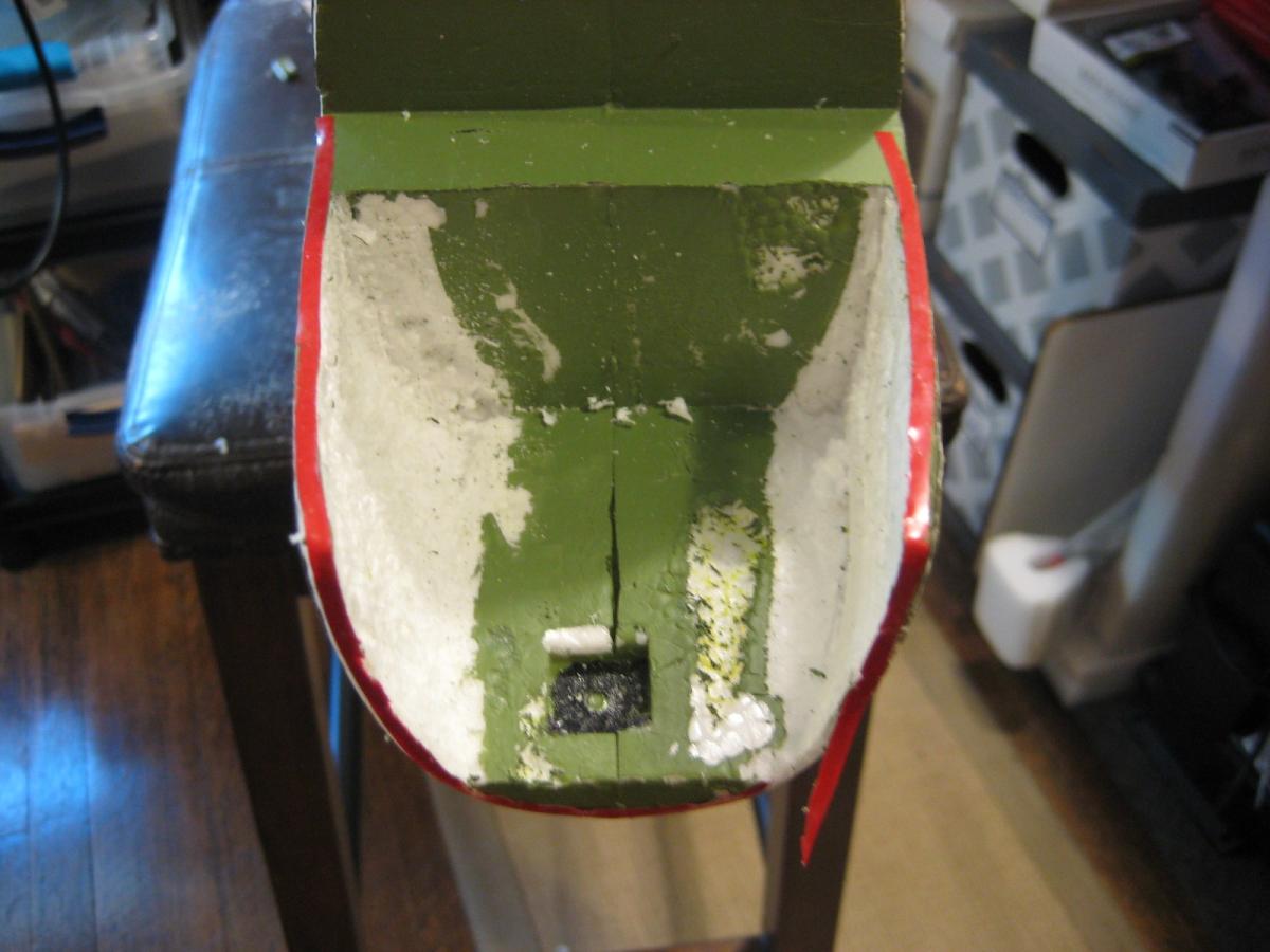

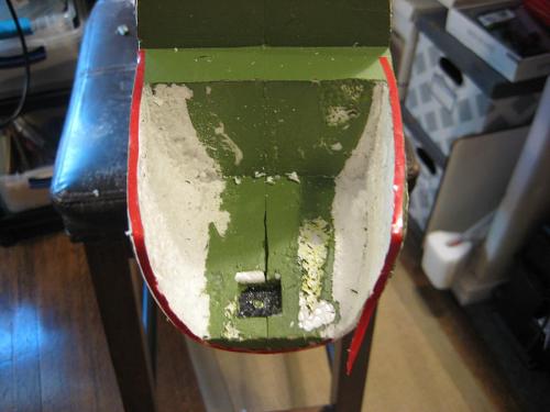

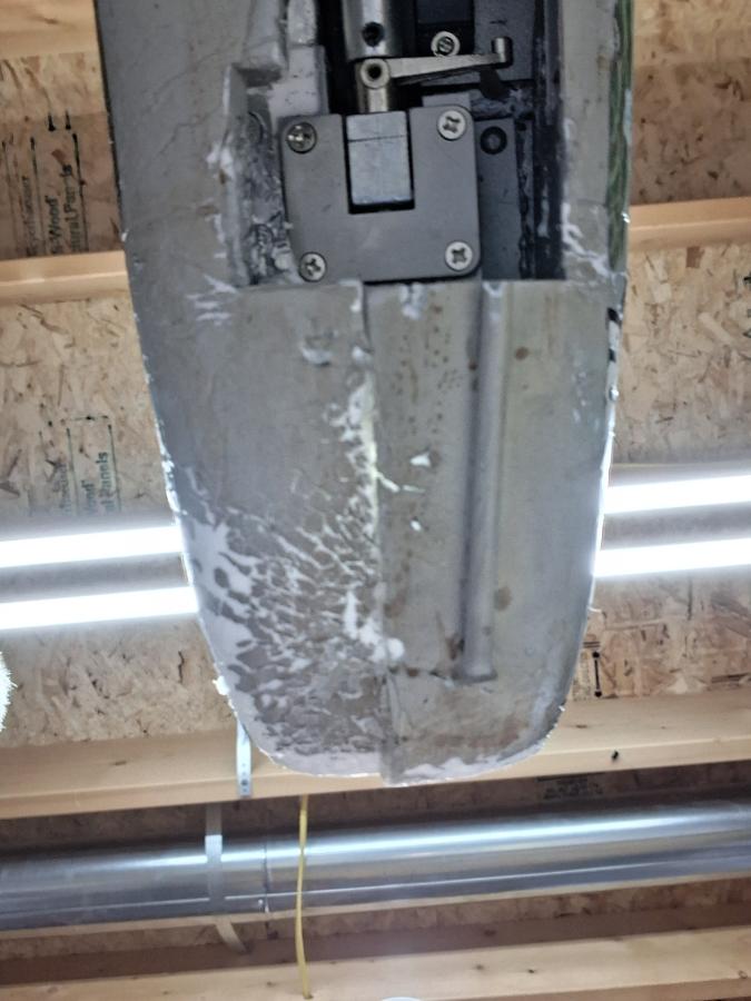

            Making impressive progress!
            Dan's patented airplane pinchers at work, the clothes pin adjusts the amount of pressure applied while the elastic bands hold the thing together.
            Wheel retract mount is back in place. Future note, reinstall this piece first as it would have been much easier. It also adds a lot of strength to the forward section.
ID:	452866 Click image for larger version

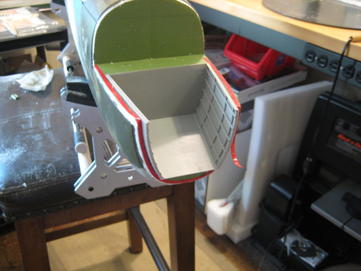

            The forward section is still split. Last step is to glue them together once the other parts are dry.
            hen a little sanding and a little painting ad voila! She's new!
            A couple of parts to order like the forward cover and gear door, pitot tube and the Radom underneath seems to be missing as well. Then bind it and drop the gear, see what's up with the electronics.
            (Dangerous Dan)

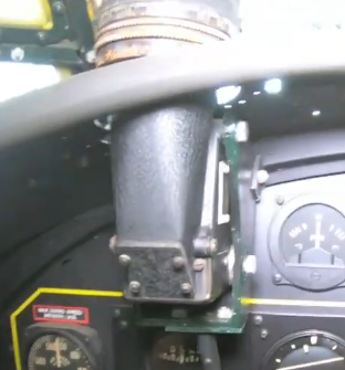

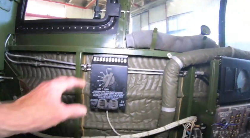

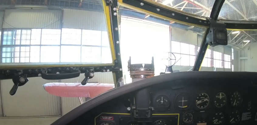

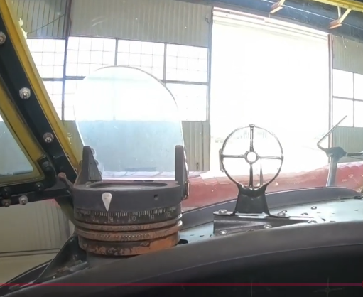

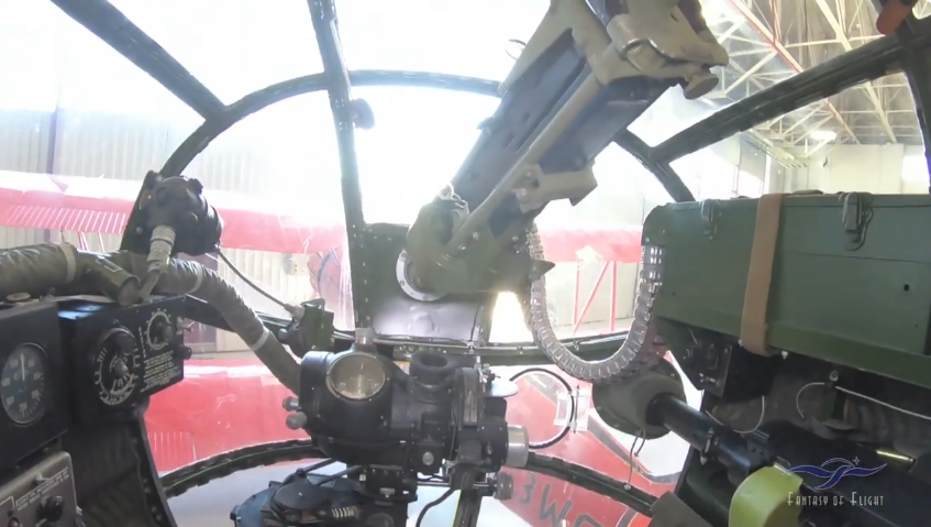

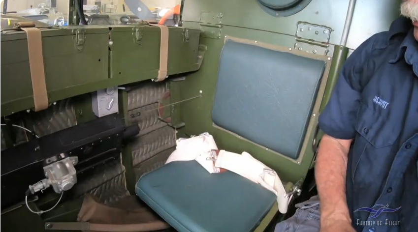

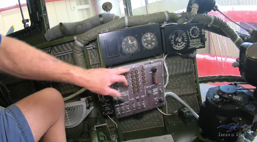

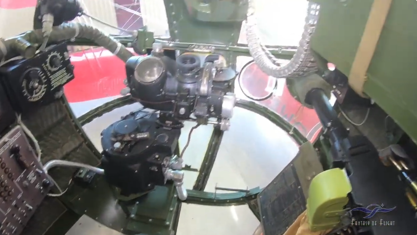

              Got some stills off Kermit weeks tour of his B 25, good stuff as his is very authentic.
Name:	Screenshot 2026-09-20 220054.png
ID:	452870 Click image for larger version
Name:	Screenshot 2026-09-20 220222.png
ID:	452871 Click image for larger version
Name:	Screenshot 2026-09-20 220307.png
ID:	452872 Click image for larger version
Name:	Screenshot 2026-09-20 220447.png
ID:	452873 Click image for larger version
Name:	Screenshot 2026-09-20 220620.png
ID:	452874 Click image for larger version
Name:	Screenshot 2026-09-20 221231.png
ID:	452875 Click image for larger version
Name:	Screenshot 2026-09-20 221301.png
ID:	452876 Click image for larger version
Name:	Screenshot 2026-09-20 221557.png
              Gret for reference.

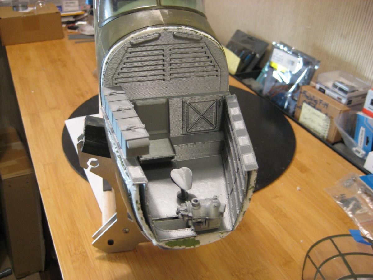

                  Danger,
                  Ah yes, the "Kermie Cam"...great videos.
                  Are you going to detail out the cockpit and forward gunner's office?
                  I know a guy with STLs. LOL
                  Best, LB

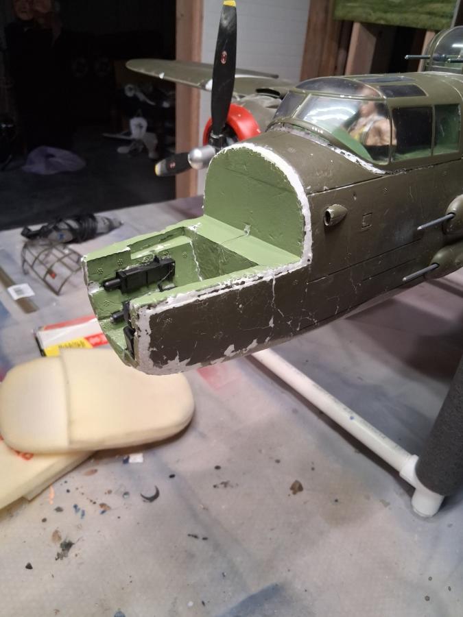

                    #869

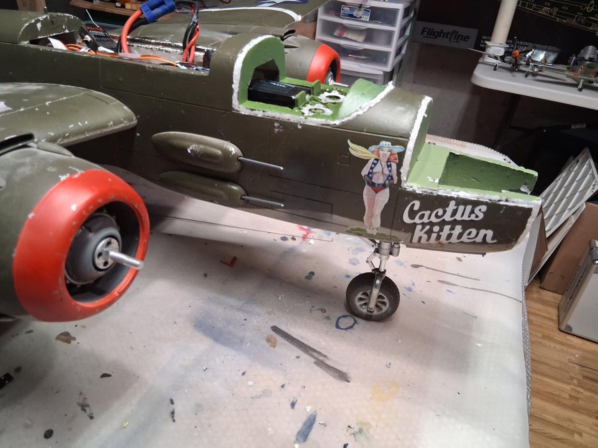

                    You must have been reading my mind Elbee!
                    What with having the green house off and the canopy as well, plus winter coming,
                    PROJECT!
                    She's out of the clamps, bound and gear is down.
                    As Dave was saying, there is nothing on the southern end. No rudders and no elevator.

                    I suspect the little box at the rear so I have another one on the way as well as the birdcage and a new gear door.
                    Then I'll pull the tail off and see what's up.
                    Should have ordered some prop blades as well, I was thinking that they were the same as the Tigercat but according to Wes, they're different although they fit in the spinners.
                    At this point they're not necessary but always nice to have some spares.

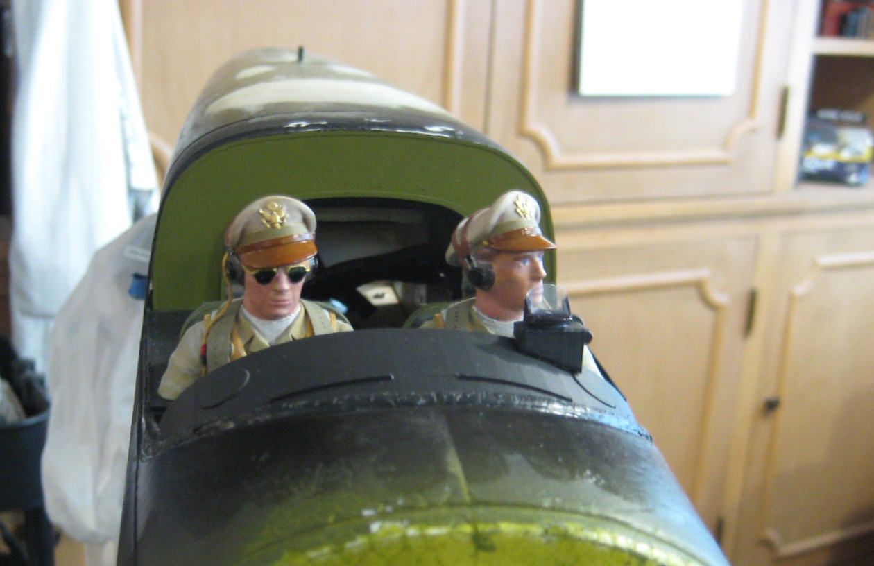

                        I have the aft greenhouse if you want it.
                        I modded mine to a "C" variant, so no greenhouse, just a bubble.
                        Also, if you'd like some of the STL's for the forward greenhouse, let me know.
                        Best, LB

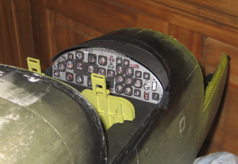

ID:	452951 Click image for larger version
Name:	Rear Fuselage Bubble-2.jpg

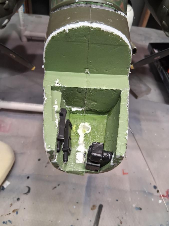

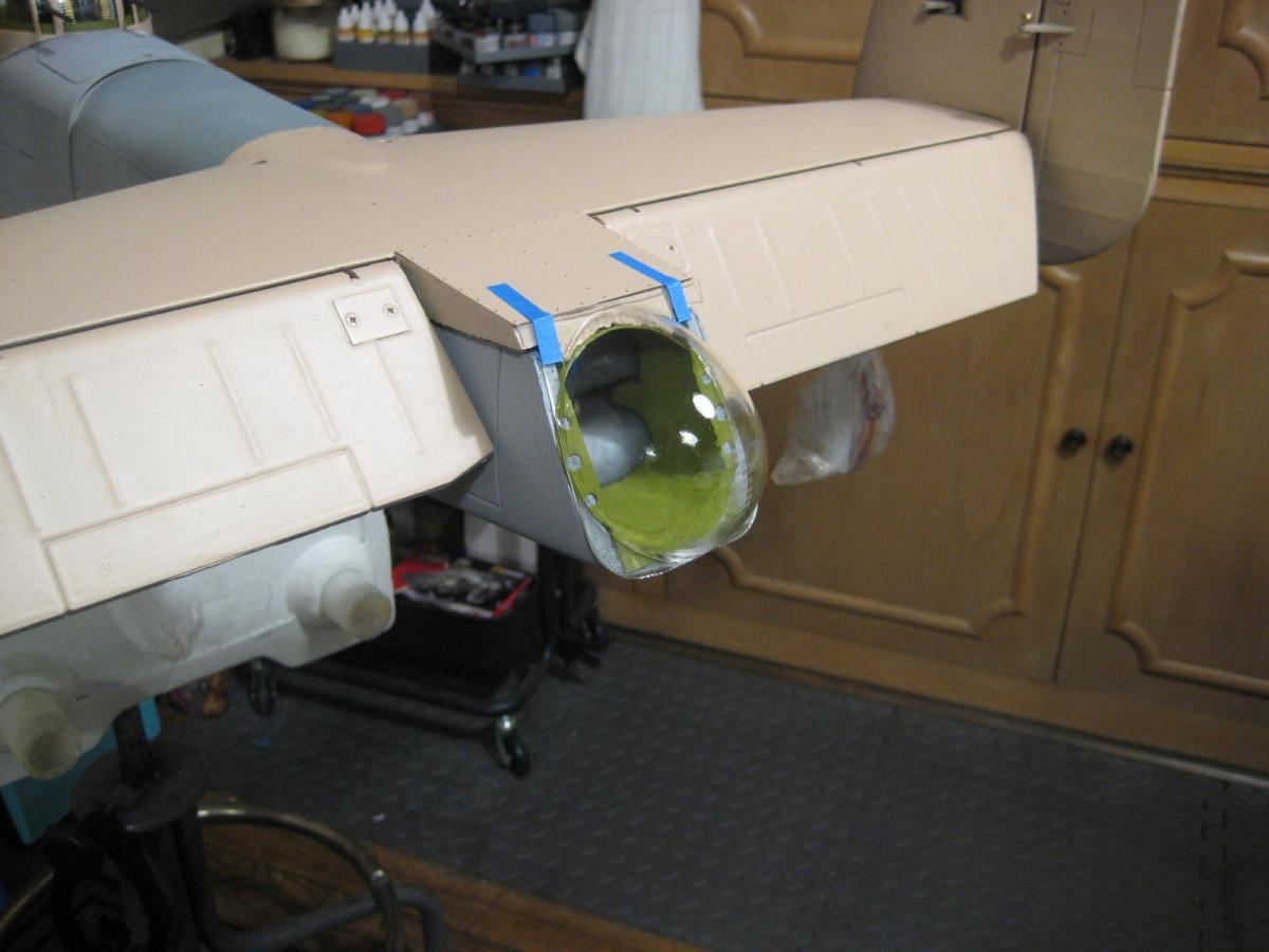

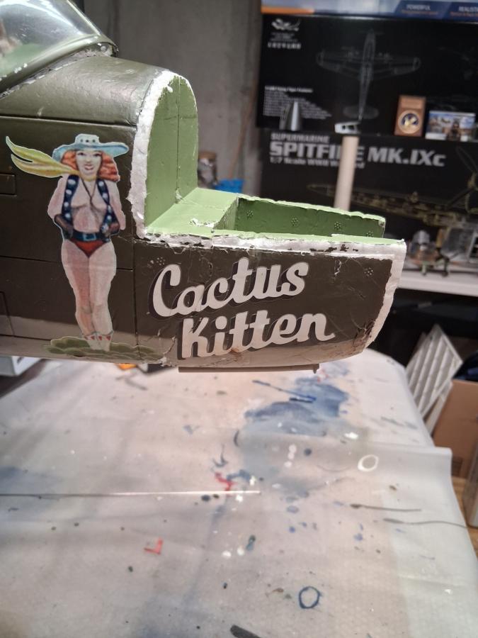

                          I'm looking at the forward area as per the first pic and the cockpit pieces (seats, gunsight and instrument panel)
                          I think that with adding the printed frame in the nose, it would add to the overall strength and rigidity of the damaged area.
                          I'm looking back through your build thread, was there something you did to strengthen the nose gear area?
                          I'm going to stay true to Dave's Cactus Kitten so nothing in the rear will change unless I can find a good pic of the gunners bay, then I'll hop on Tinkercad and see what I can do.
                          (Dangerous Dan)

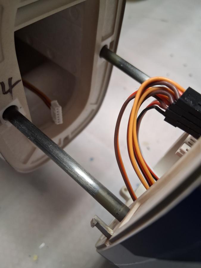

                            • 7423
                            #873

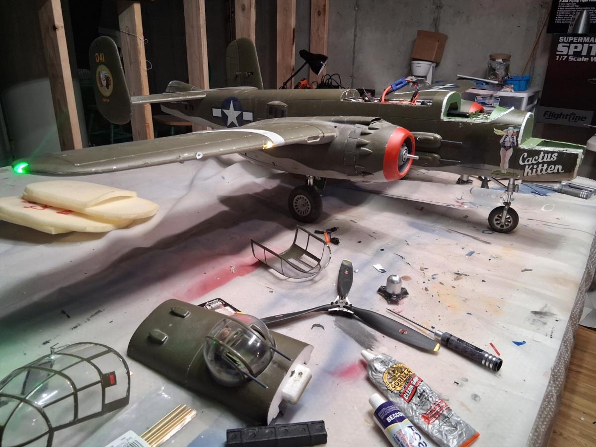

                            Sure as all get out!
                            That wire had come out and you can see where she was sitting!
                            Maybe, as a maintenance directive, put this on your list to check to see that the plug is secure.
                            Dave had 100 flights on her and 101 was the bingo flight.
                            Let's face it, with Winter coming along, it's time to do the work.
                            I have a new attachment circuit coming and I think I'll replace the old one to make sure it snaps together.

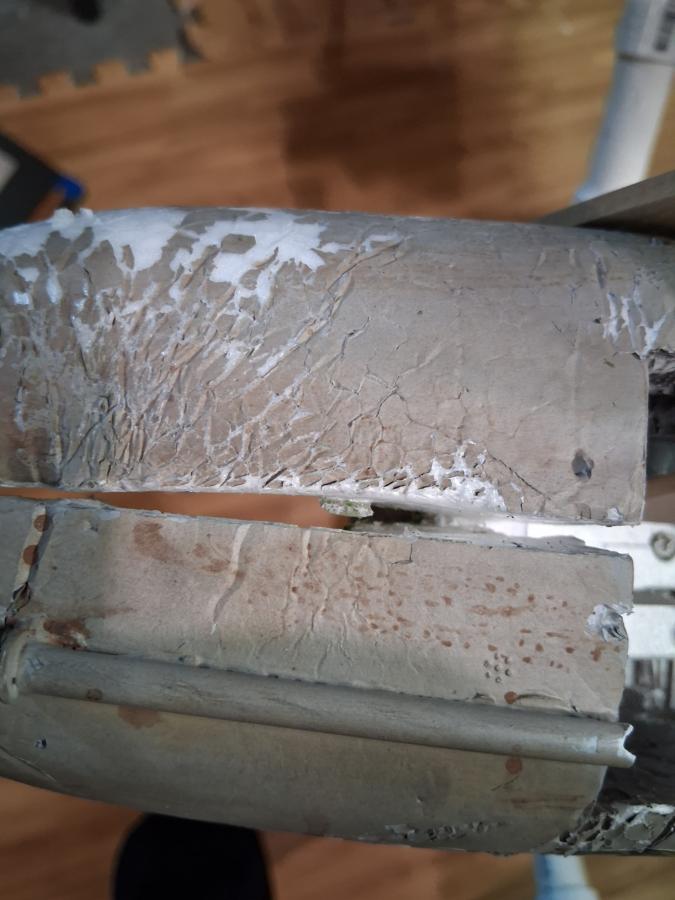

                              #874
                              Grossman56,
                              What are you using for filling the cracks after gluing the pieces back? I use lite-weight spackling but wondering if there is a better filler that sands finer.
                              Best Regards, Rex

                                Grossman56,

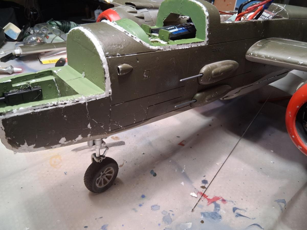

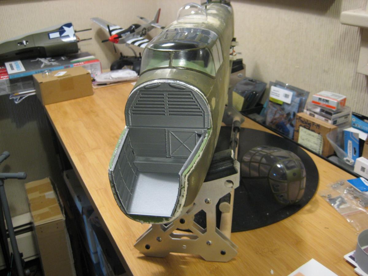

                                The printed side walls, floor, and aft bulkhead parts should stiffen the thinned foam of the nose.
                                Once you've printed those you can begin to dry fit and see how much foam you'll need to alter or remove.
                                You'll see that the nose retract mount is the compromise and I epoxied bulkhead parts to help stiffen that area.
                                That whole process was slow as the design changed when I realized the limitaions of the foam to remain structural.
                                Figured worst case, I'd have to start over with a new fuselage.. but it all worked great.
                                I'll need to send the STL files via email and I have that.
                                Give a day or so to go through all the STL files and pictures.
                                I'll check to see if I have your home address to send the greenhouse.
                                Best, LB

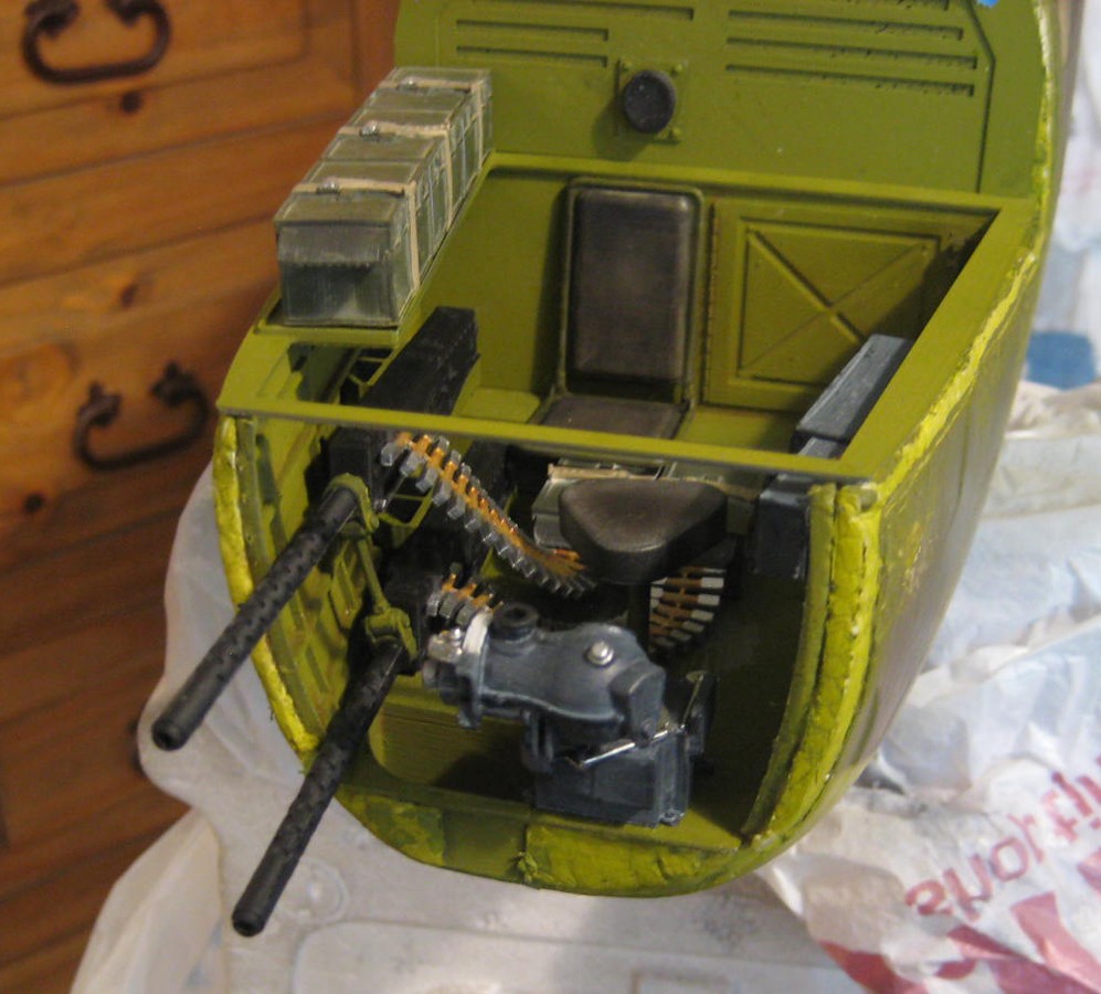

                                    F&L,
                                    Good to hear from you, Sir.
                                    Yes, the ammo boxes, pilot heads, & Norden are resin.
                                    Note: ammo box 1 is FDM and box 2 is SLA.
                                    All the 50 cals are FDM printed on my ol' i3 Mk3 upgraded to a Mk3S+.
                                    HatchBox Silver or Black PLA depending.
                                    Post process with acetone and lacquer paints.
                                    I am going to send some STLs to Grossman56 as soon as I find a little time.
                                    Think I will post all the B-25 cockpit bits and fwd greenhouse to Prusa Printables, again as soon as I make some time.
                                    If you're interested in someting, PM me and I'll see what I can do, Brother.
                                    Best, Steve
                                      • 7423
                                      #878
                                      Originally posted by jetfool
                                      Grossman56,
                                      Best Regards, Rex
                                      I use no shrinking Wally World light weight spackle, probably the same as you have. Also, Urethane gloss makes a decent if time consuming filler as well for the fine stuff. Click image for larger version

                                          #880
                                          Grossman56,
                                          Use the same as you. Works well just wondering if you used something better.
                                          Thanks, Rex
