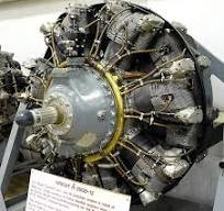

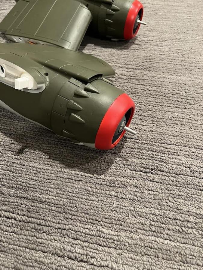

                              I just started in on my new B-25J that arrived yesterday via FedEx. The only things I've done so far is add the extra header printed exhaust fairings onto the cowlings (now 14 per side as this was a 14 cylinder R2600 engine) and they came out pretty well. I also repainted the yellow cowls to red, per my intended replica of Cactus Kitten when I get done with it. In my reading, I found that the crew chief of this aircraft was from Wyoming, so he painted on a sexy cowgirl as the logo for the plane on the right side of the fuselage. Always like having a connection with Wyoming wherever possible!
                              The other minor painting detail I did was repaint the crankcase cover from silver to semi-gloss grey. I masked off and found that Tamiya spray Ocean Grey was a pretty close match to the bluish-grey crankcase covers on round engines at the time.
                              Click image for larger version  Name:	0.jpg Views:	9 Size:	152.8 KB ID:	410858 Click image for larger version
ID:	410871 Click image for larger version

                                  Thanks, Elbee. The printed fairings from Fast N Light were a very close match to the foam ones molded on the cowls.
                                  davegee

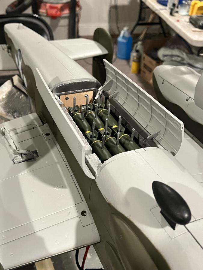

                                        I made some progress on assembling the plane yesterday. Got the wings on for the first time, painted white stripes on the outboard wing sections that this unit had, and did a test bomb drop in the shop just now. The main purpose for today's test was to be sure that the bombs (6 of them in this test) would drop clear of the airplane when the doors are opened and the bombs slide down the aluminum tubes.
                                        I took note of the unfortunate accident that our friend Arthur from France had on his maiden flight of his B-25. I don't know exactly what happened there, but I did take away that is is possible for the pilot to get distracted watching the bombs or parachutes drop out of the airplane during flight. I took that to heart, as I could see I could be distracted for a glimpse of this just long enough to lose control of the aircraft. I'll be sure to keep my eyes on the plane at all times, and if a friend is around to snap some pictures or video that is a much better way to go for me.
                                        I'll include a photo of the bombs in the airplane. I tried a10 second video of a static drop in my shop but it was too long. I might try another one later, but this one proved what I needed to know for now.. Each bomb (up to 12 max load) has a 5mm 16 screw that is screwed into the nose. This will hopefully give some stability and realism when they are actually dropped on a flight. We'll see.
                                        Possible maiden has slipped to sometime next week, weather permitting. It will still be a work in progress for several months as I do some additional detailing and weathering of the airplane. So far, I'm liking this airplane.
