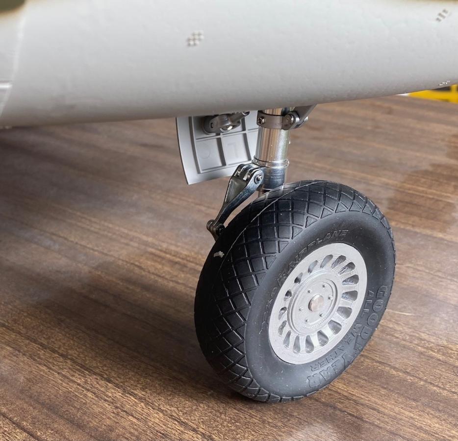

        Got started on my build and have the following updates on the scale rims. Thingiverse
        The OEM nose gear wheel measures 2.4inch and has very little radial clearance to the support strut. The Robart 2.5inch wheel measures ~2.64inch which results in interference with the support strut. I will evaluate the Robart 2.25inch wheel as a possible mitigation for this issue. Hope it fits without modification to the rim.
        Metal finish on the nose gear strut look pretty bad. Hope the metal structural integrity isn't compromised.
        The OEM main tires measure 3.33inch and the Robart 3.5inch measure ~3.53inch. The increased diameter can cause interference between the outboard gear door and the Robart tire. Moving the wheel inboard can address this issue. Removing the OEM 1.75mm aluminum spacer will create space for the outboard gear door to close. A ~1mm washer may replace the spacer with minor adjustment of the outer gear door push rod.
        The 3.5inch looks great but the fit to the gear door remains a close fit. I don't think the tires touch the doors on my setup. However, if you prefer more clearance, Robart 3.25inch should fit on the printed rims also.​
        PS - Thanks JD for the feedback!
        Click image for larger version  Name:	IMG_4060.jpg Views:	0 Size:	129.5 KB ID:	388181 Click image for larger version  Name:	IMG_4061.jpg Views:	0 Size:	101.7 KB ID:	388180 Click image for larger version  Name:	IMG_4062.jpg Views:	0 Size:	55.2 KB ID:	388179 Click image for larger version  Name:	IMG_4059.jpg Views:	0 Size:	70.0 KB ID:	388182

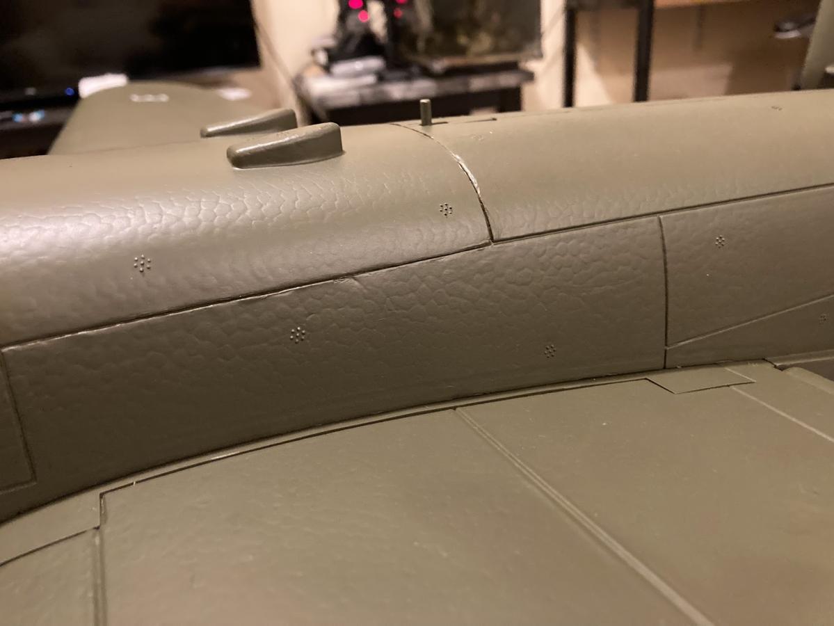

              Originally posted by Elbee
              Mike, Welcome to Hobby Squawk, Sir.
              If you are able, post a few pictures of your issue.
              Uncertain about the heat explanation, as the whole box would have to 'heat soak' down to the paint finish.
              With all that 'foam and cardboard' inbetween, the airframe is well insulated.
              If there is a real issue, document it!
              Motion RC has great Customer Service.
              Best, LB
              Have the same issue on MANY Freewing/Flightline products. Dating back as early as late 2021 (Been a Freewing customer for years, early 2022 or late 2021 was the first time I encountered this issue)
              I have a whole story to share if somebody is interested. I will cut it short here: MRC CS is a joke. I don't wanna mention names. But if you are talking with someone's name starts with a D & an M. You are better off just rubbing it in.
              This "Gatoring" issue has been going on for almost 2 years. And no one at MRC ever wanted to address it.
              I am currently arguing with MRC about my B25. Screenshots from Arthur RC's video show how bad some of the "gatoring" is. Some of them are minor. Like my Ta152 and Mirage. You could probably deal with it. Some of them are just unbearable. Like my P38, B25 & A6.
              My speculation on this is the "Gatoring" happened during sea transfers. Which I think MRC is in charge of, correct me if I'm wrong. Because none of the social media in mainland China have I ever heard about this "Gatoring" issue complain. Nor has any of my friends in China ever experienced this "Gatoring" issue from Freewing/ Flightline products. At least not on a large scale (small imperfections are acceptable, but this is way beyond).
              Edited 1: I don't think it is caused by sitting at the US customs for inspections. As Arthur RC is located in France, and received his B25 in early August. Also, it doesn't explain past "Gatoring" on other models.
              Here are some examples of the A6 and the B25. Open attachments to see more life-like gators! Lol​
              Click image for larger version  Name:	A6 bad fuse.jpg Views:	0 Size:	102.0 KB ID:	388329 Click image for larger version  Name:	B25 bad wing 2.jpg Views:	0 Size:	54.6 KB ID:	388333 Click image for larger version  Name:	A6 bad fuse 5.jpg Views:	9 Size:	65.7 KB ID:	388313 Click image for larger version  Name:	B25 Arthur RC bad fuse.png Views:	7 Size:	1.07 MB ID:	388319 Click image for larger version  Name:	P38 bad wing.jpg Views:	7 Size:	44.9 KB ID:	388306 Click image for larger version
Name:	B25 bad fuse 2.jpg

                Really appreciate the effort.
                Some experience sharing. Robart wheels are also a bit thicker than the stock wheels. But if you make the rim thinner. When you squish the rubber tires, they "zoom-out" some. So I think the 2.25" will probably be a better choice for the nose. Same goes for the mains.
                Best of luck with the mod. Looking forward to getting this mod for mine.
                                      Yes the 2.25" is the better option for the nose to prevent radial interference with the strut. Motion shipping those Robarts my way at the moment.
                                      A bit of tuning the main rim design and the 3.5" looks good to me. The clearance might be too tight if your going to get mud on the tires, but I won't be doing that. 3.25" should also work fine and no one will notice the difference unless your parked next to me. lol
                                      The tire to rim interface I am using is similar to the Robart rim which only provides lateral tire support at the center-line. Currently testing thinner gap geometry there to see what effect it has.
                                        • 4871
                                        #479
                                        Enzo_K Fast N Light ,
                                        So just for clarity, both Robart 3.25 and 3.5 are good-to-go for the MGs, and Robart 2.25 for the NG.
                                        Have either of you noticed the Robarts 'ballooning' some at landing speed RPMs and interfering with the struts?
                                        Best, LB
