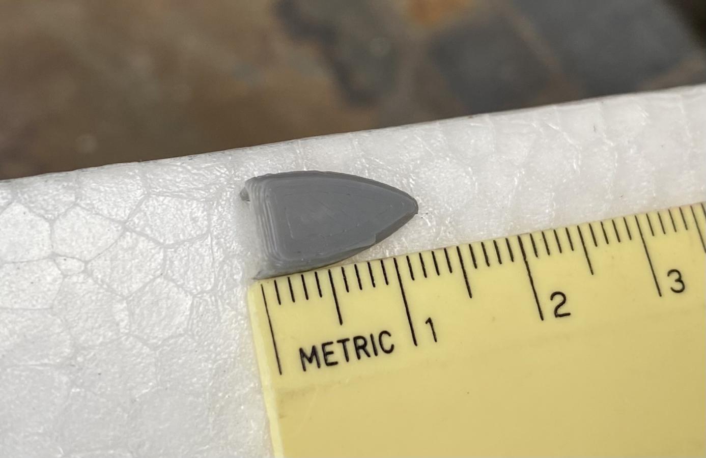

        I think I am following. You want to add the 2nd row of exhaust ducts which are forward and circumstantially offset from the ones on the FL model?
        Certainly this could be solved.
        Challenges
        1) Modeling the duct. I haven't modeled this type of geometry before, so would need to invest some time in learning.
        2) Matching the existing ducts. I would likely cover or remove the existing ones to get the set to look same & scale.
        3) Attachment to the nacelle. Would be helpful to see what is behind this exposed surface to create the attachment features for the duct.
        4) Design for print-ability. Depends on 1 to 3.
        If I had the B-25 model in hand so I could get all the needed data, estimate I would take 15 to 30 hours to develop this duct (eg design, print trials & initial installation).
        There may be others who can knock this out more quickly - please be my guest!
        Click image for larger version  Name:	B-25 Nacelle exhaust blisters 01a.jpg Views:	1077 Size:	21.7 KB ID:	386100 Click image for larger version  Name:	B-25 Nacelle exhaust blisters 02a.jpg Views:	107 Size:	19.1 KB ID:	386101
        The modeling challenge is very similar to the gunship nose so I will start exploring with that challenge in the next 2 or 3 weeks.
        It's moving along more quickly than I expected. Not quite minimum viable product but a decent 1st draft.
        If someone wants to share the HxWxL for the ones on the model, I could refine it. My guess was 4.4x6.8x13mm
        Also interested in the nacelle diameter for the curvature of the duct mounting surface. My guess is 70mm...

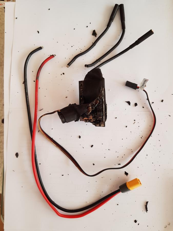

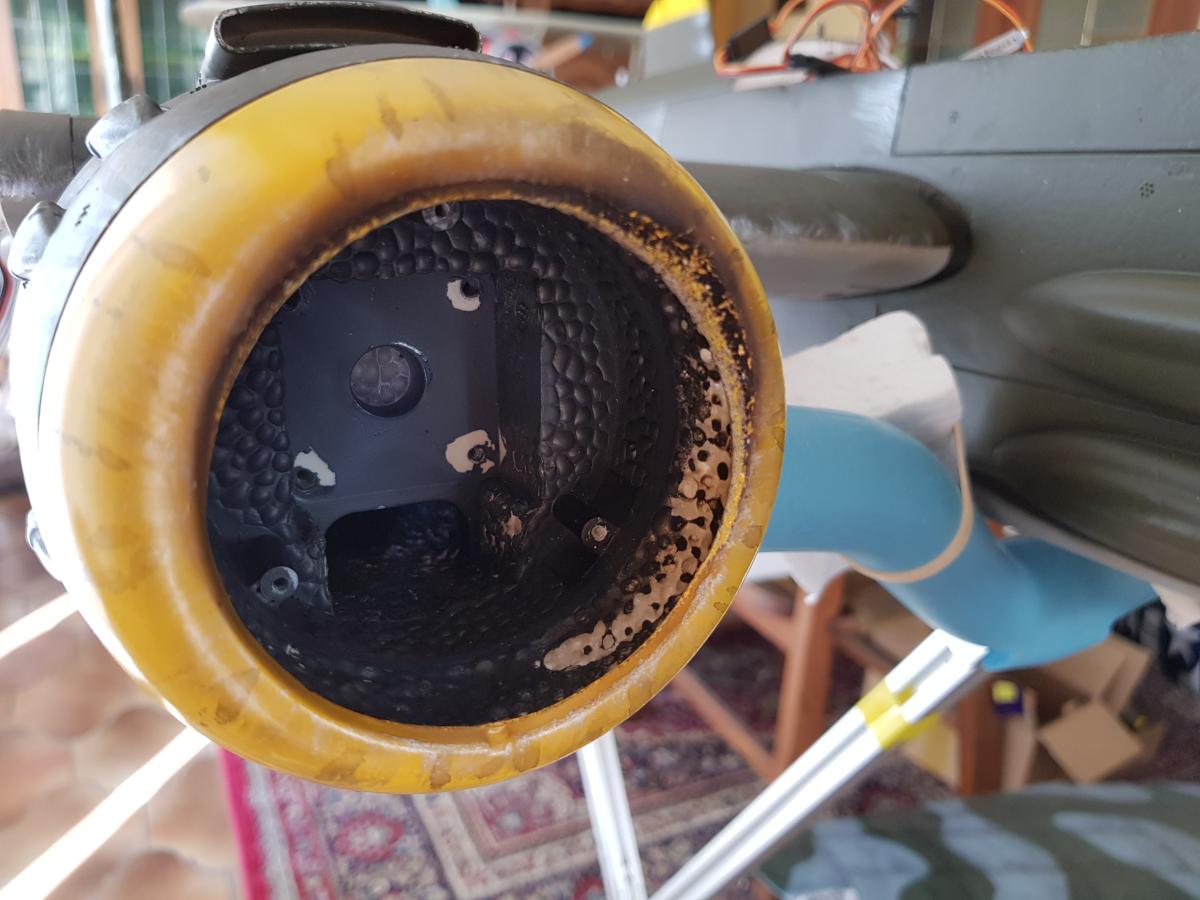

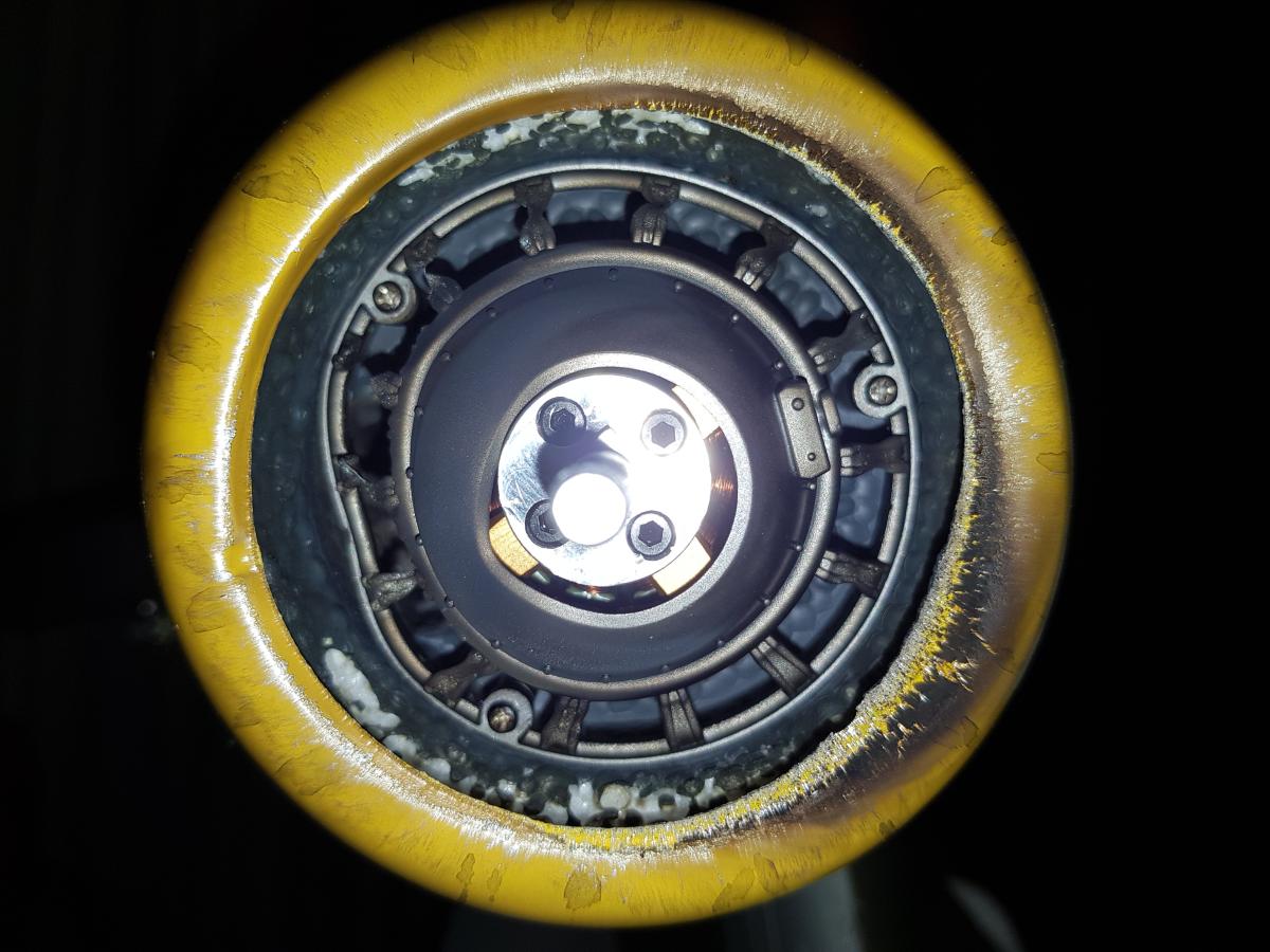

                    I have a similar ESC calibration problem now after the loss of one ESC (fire). I connect the second ESC (with UBEC) directly to the receiver, plug the 6S lipo and it is only beeping (about one beep per second) and no way to get out of this mode. Cut-off disabled. I can't find on MRC the ESC manual. Is the second ESC dead too?
                    About the ESC on fire (posted on FB group) I had 7 flights of 5 minutes with an Admiral 5000, no issue, plane flights great, maybe a bit fast to be fully scale, and still have 48-50% of capacity available, flying at 50-60% of throttle. But climbing to the sky when flaps are down.
                    I wanted to program the elevator compensation for the flaps last weekend at home, when I connected the battery, I got a huge electric spark at the battery connector and immediately a "pof" (sounded like a capacitor explosion) and flames coming out of the (right) nacelle. It was impossible to unplug the battery (electric soldered). No other choice than pulling everything that could come with it (the power cable of this ESC came with it). The inside of the nacelle is a bit melted, as well the engine plastic cover and the yellow cover, and 2 holes in the nacelles where the ESC is located. I could avoid a total loss by unassembling as fast as possible the wing and the nacelle while still black smoke was coming from that nacelle.
                    I raised a ticket on MRC site on Sunday evening but still no return to date.
                    Click image for larger version  Name:	B25J1.jpg Views:	0 Size:	307.4 KB ID:	386316 Click image for larger version  Name:	20230910_164031.jpg Views:	0 Size:	54.3 KB ID:	386317 Click image for larger version  Name:	20230910_164059.jpg Views:	0 Size:	102.5 KB ID:	386318 Click image for larger version  Name:	20230910_011011.jpg Views:	0 Size:	119.5 KB ID:	386319

                          Can you strip off the burnt shrinkwrap and read any identifying markings on the ESC to possibly determine its mfg?
                            • 5423
                            #373
                            FreeWing made by HobbyWing. Note it’s opto, no BEC.

                              #374
                              Unfortunately, nothing to read anymore.
                                https://www.motionrc.com/products/fl...-1179593751520
                                Thanks Evan.
                                Must be this one that took fire, because the remaining one is the ESC with BEC. Despite the manual says "ESC 50A Brushless x2 7A UBEC", I assume only one is with the UBEC.
                                Now wondering for the motor, because flames went trough it, and it is darkened and smells horrible.

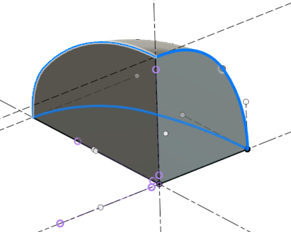

                                    Started working on the gunship nose and having some success with lofting to generate geometry in the CAD tool. 1st time for me 😃.
                                    Using this approach i generated 3 curve sets which control the geometry (blue lines in the 1/4 section view shown). Each curve is composed of 3 tangent arcs. By trial and error with these 18 variables, I could use this to generate something representative with the model in hand. However, that will take some time and won't be scale.
                                    Wondering if any of you would help me locate the scale geometry for the nose?

                                      #378
                                      Fast N Light Am I correct to presume the cross section you are showing is 'upper right' looking nose on? Best, LB
                                      • Fast N Light
                                        • Apr 2021
                                        • 118
                                        #379
                                        Yes that's probably the best perspective explanation for the pair of photos. However, the nose of the B-25 shown seems to have symmetry top/bottom, left/right, so it could be any quadrant...
                                          Elbee commented
                                          Editing a comment
                                          If that is the case then I'd say you're very close in shape. Now it's about actual dimensions. Nice work.
