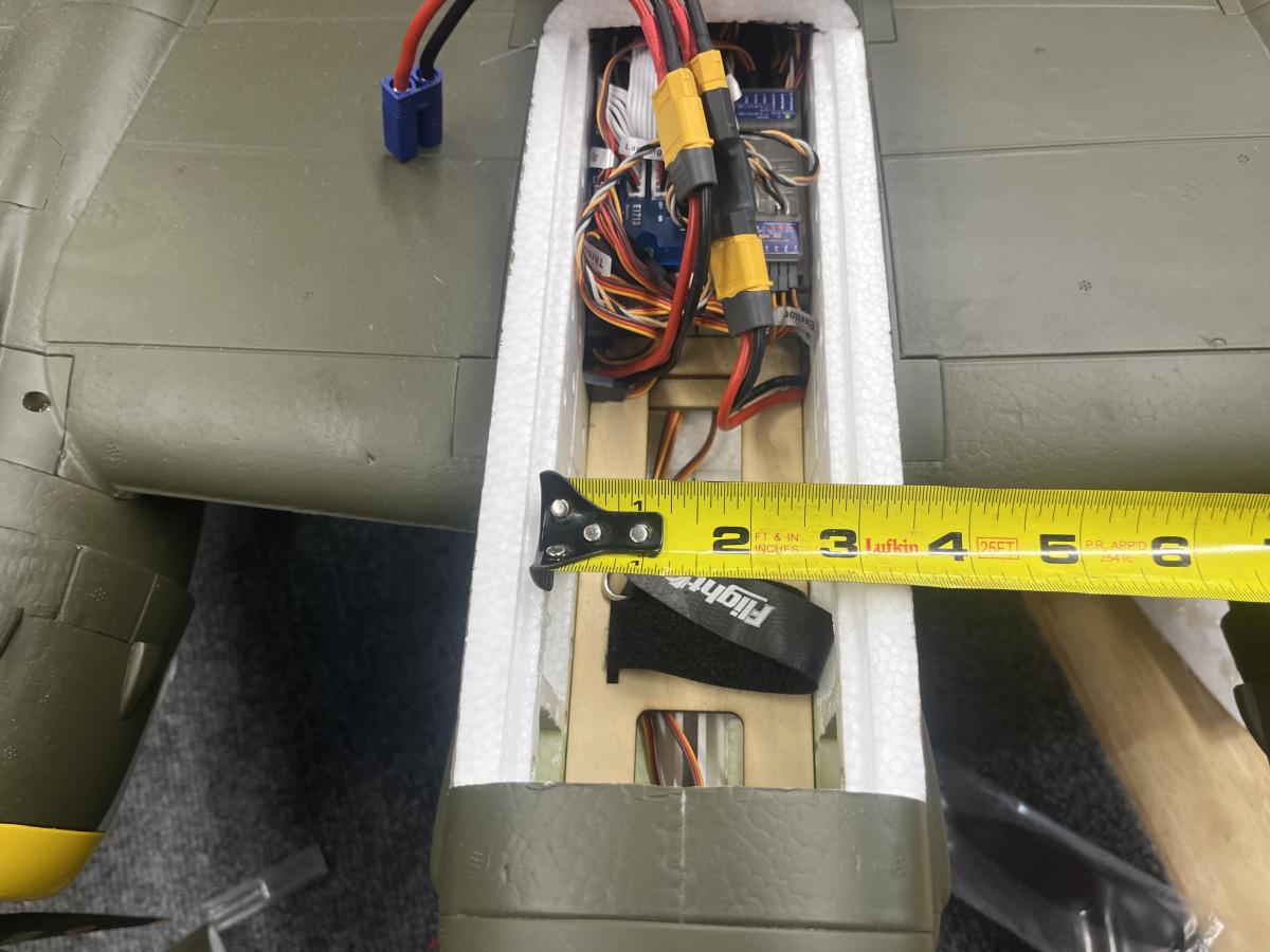

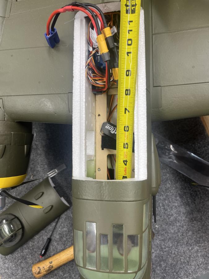

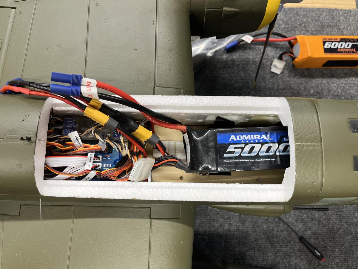

Tom, thank you. I am chagrined in that I have watched the build video multiple times to pass the time while waiting for my plane to arrive and have seemingly missed that measurement. Thanks for your input IanB and the picture of the battery bay. You are right, it is quite tight with the battery, blue box, and receiver in it. I might opt for a Spektrum AS3X receiver though I think there is room for receiver and gyro, even if I have to relegate the receiver to the top of the bombbay. As for gyros, I guess you would say I am a wimp. But I enjoy the build, the looks of the plane in the air, and landing them without incident. I don't have the skills requisite for loops, rolls, etc and after 35 years of being an ICU nurse I don't need any additional stress in my life. I think I can fly good enough to bring a plane safely down in the event of a gyro failure but hope and pray I never have to find out. Happy flying.Comment

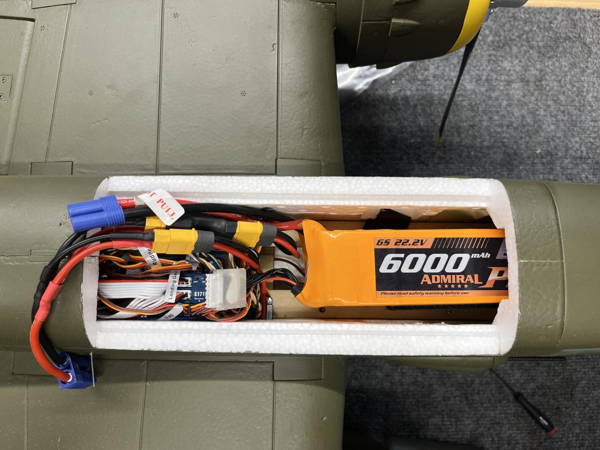

Hello everyone. As we close in on shipping for the B-25 here on the US side I’ve had several requests for measurements on the B-25 battery bay. Below is a 6000 pro pack, standard 5000 admiral, and a 4000 admiral. For customers that choose the 4000 I do recommended adding a little nose weight to hit the molded CG marks on the wing. For the 6000 you can slide the battery back and hit the CG. Be aware the battery compartment does get a little tight with the large battery. The CG on the wing is spot on so use that for your first flights. For customers that like it more tail heavy move it back slowly because it doesn’t like being tail heavy just like any WWII aircraft. Let’s use this post for any customers that would like additional pictures or have any other questions to ask away 😉 once again I can’t wait to see everyone receive this model and start customizing. Also for customers that like a more neutral center of gravity, I find the B 25 greatly benefit from a Gyro in slow flight and cross wind conditions. I have personally set up the model on our lemon 10 channel gyro with telemetry. The great thing about pairing it to this model as you can plug the XT 60 telemetry wire straight into the factory wiring harness.Comment
Wesley, thank you. Your pictures were very clear and very telling. I will be flying with the Admiral 5000 and I can see by your pictures that a combination receiver/gyro is the best possible solution, other than not using a gyro (which is not a solution for me.). I still think it might be possible to run the receiver on the roof of the bombay area.Comment

I wonder, if like the cougar, there might be enough space under the battery deck? In any case, I definitely plan on running at least one satellite remote receiverHello everyone. As we close in on shipping for the B-25 here on the US side I’ve had several requests for measurements on the B-25 battery bay. Below is a 6000 pro pack, standard 5000 admiral, and a 4000 admiral. For customers that choose the 4000 I do recommended adding a little nose weight to hit the molded CG marks on the wing. For the 6000 you can slide the battery back and hit the CG. Be aware the battery compartment does get a little tight with the large battery. The CG on the wing is spot on so use that for your first flights. For customers that like it more tail heavy move it back slowly because it doesn’t like being tail heavy just like any WWII aircraft. Let’s use this post for any customers that would like additional pictures or have any other questions to ask away 😉 once again I can’t wait to see everyone receive this model and start customizing. Also for customers that like a more neutral center of gravity, I find the B 25 greatly benefit from a Gyro in slow flight and cross wind conditions. I have personally set up the model on our lemon 10 channel gyro with telemetry. The great thing about pairing it to this model as you can plug the XT 60 telemetry wire straight into the factory wiring harness.Comment
I'm a fan of FrSky X8R and S8R receivers, and the telemetry modules that go with them. Even though the B-25 probably doesn't need a a stabilizer, a stabilizer doesn't hurt anything. About the only noticeable difference is that a stabilizer seems to add more expo. So, I just don't program much expo through my transmitter if running a gyro. So, I think that I'll do an S8R, with xbus expansions to get 16 channels. Each control surface servo will likely get its own channel. Nose wheel steering, too. Differential thrust. I'm sure that I'll also run a voltage sensor and a GPS sensor, neither of which take up much real estate.
