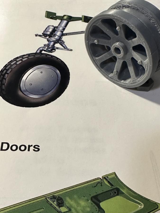

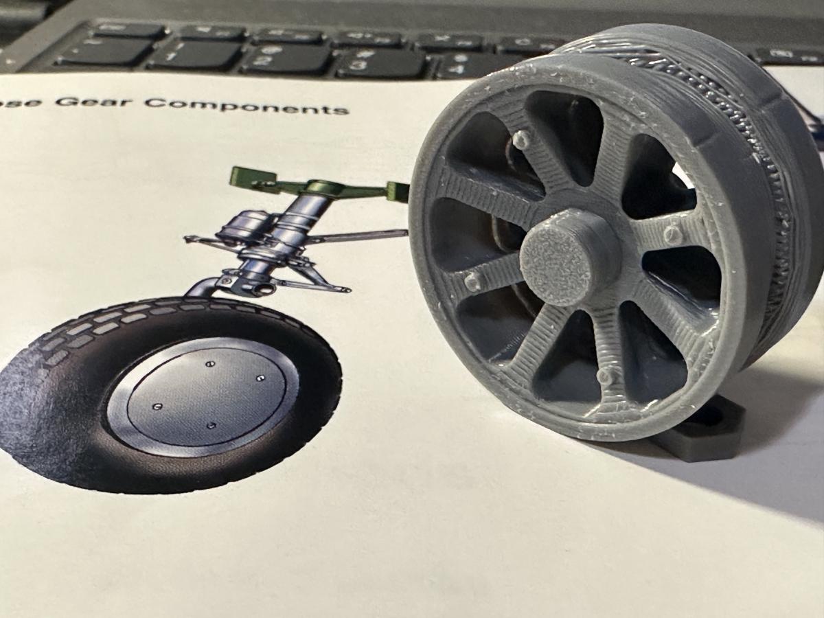

        Not knowing their purpose, I left those posts off the front rim. But since you took the effort to educate me, I'll see if they can be arranged cosmetically
        Printed in Polymaker ASA and Bambu ASA with same slicer settings. Quality is comparable, but the Bambu required glue stick to remain adhered to the plate.

        ​ Click image for larger version  Name:	Screenshot 2023-09-05 222328.png Views:	0 Size:	181.8 KB ID:	385861 Click image for larger version

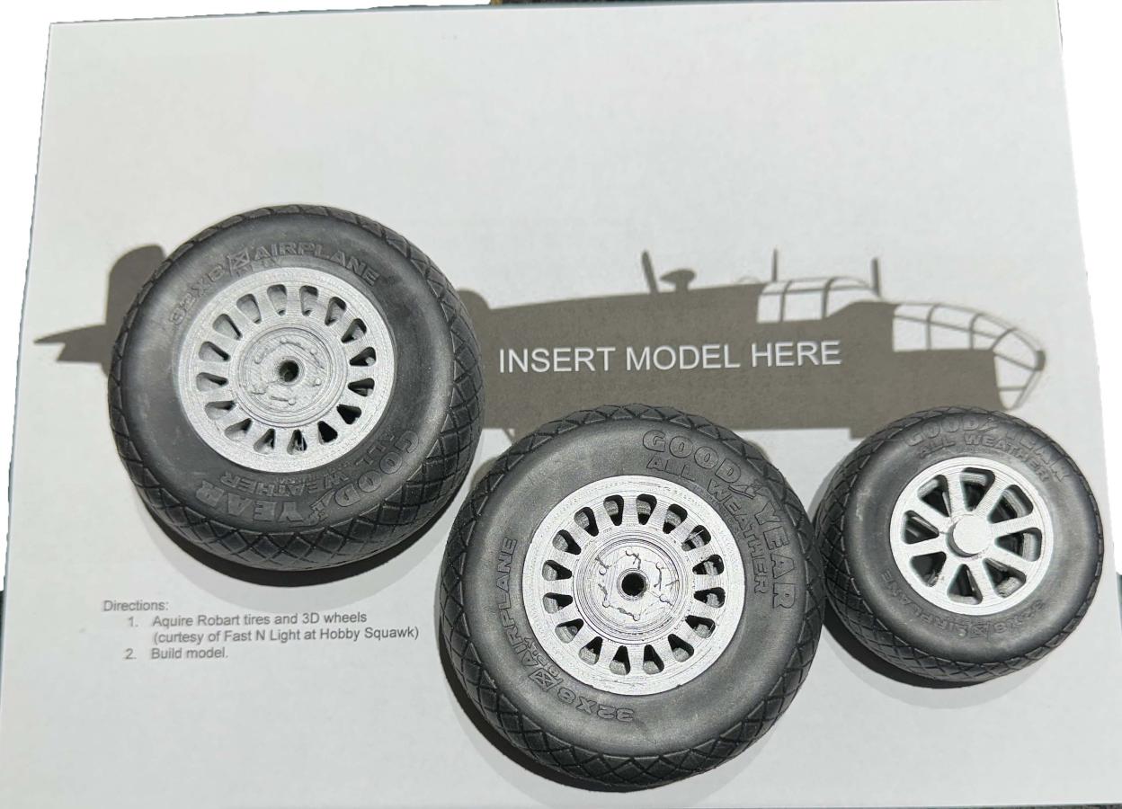

                        now I’m tempted to print out tires. Ha
                                Hah, great minds think alike. Best, LB

                                          It is so hard to be patient!
                                          Love the wheels Fast N Light! Click image for larger version
