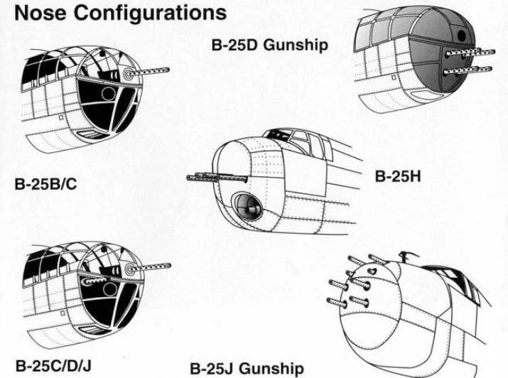

    Originally posted by Fast N Light
    Found this interesting montage of nose designs for the B-25

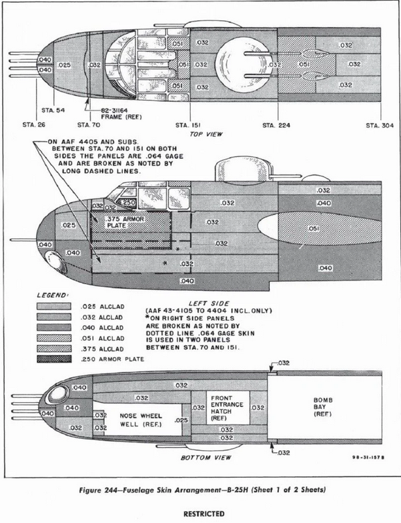

    Got excited when I came across these images because they would be perfect to get the scale curves for reverse engineering the nose design. Alas this H variant isn't representative of the J gunship nose which appears to be unique

    I’ve also noticed that the glazing on the canopy isn’t necessarily correct for some B-25Js. The drawings you posted show 4 panels in front which is consistent with my reference photos. I was wondering about that and you confirmed it. Easy enough to fix.

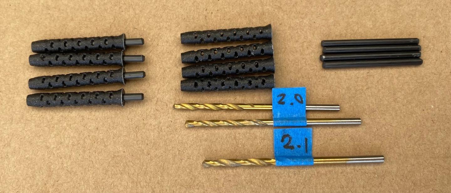

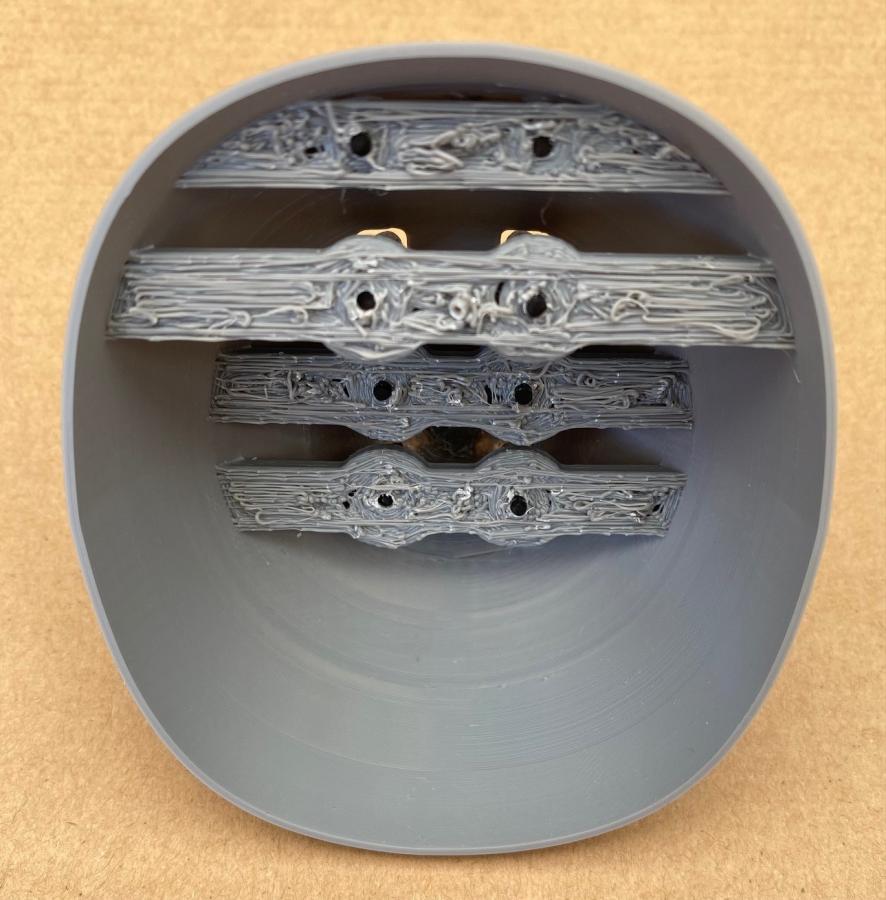

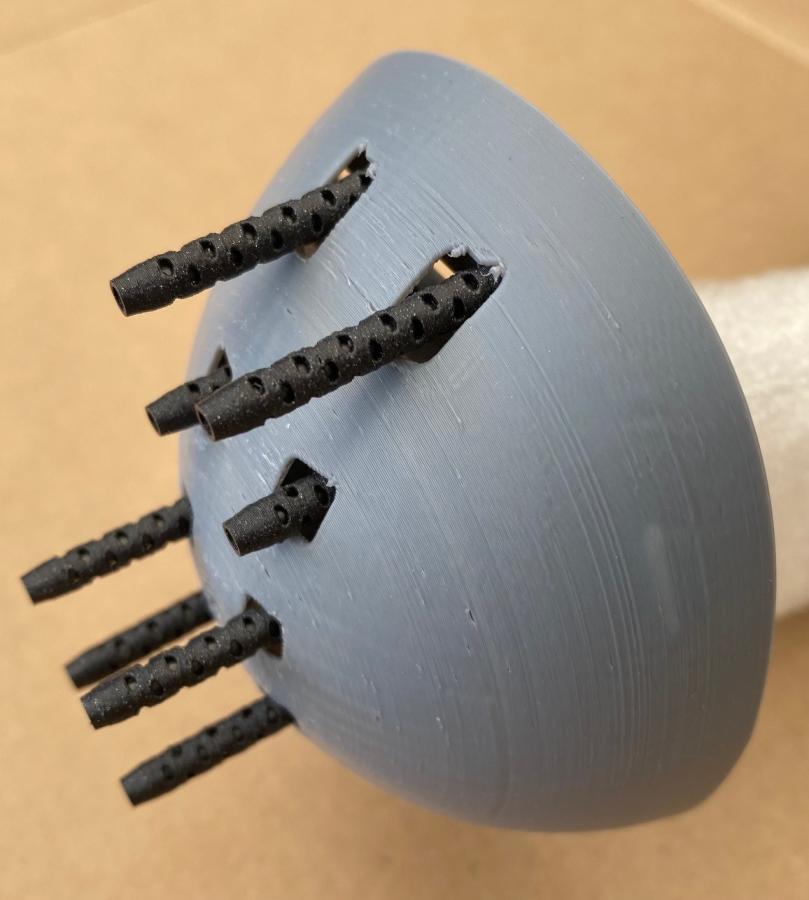

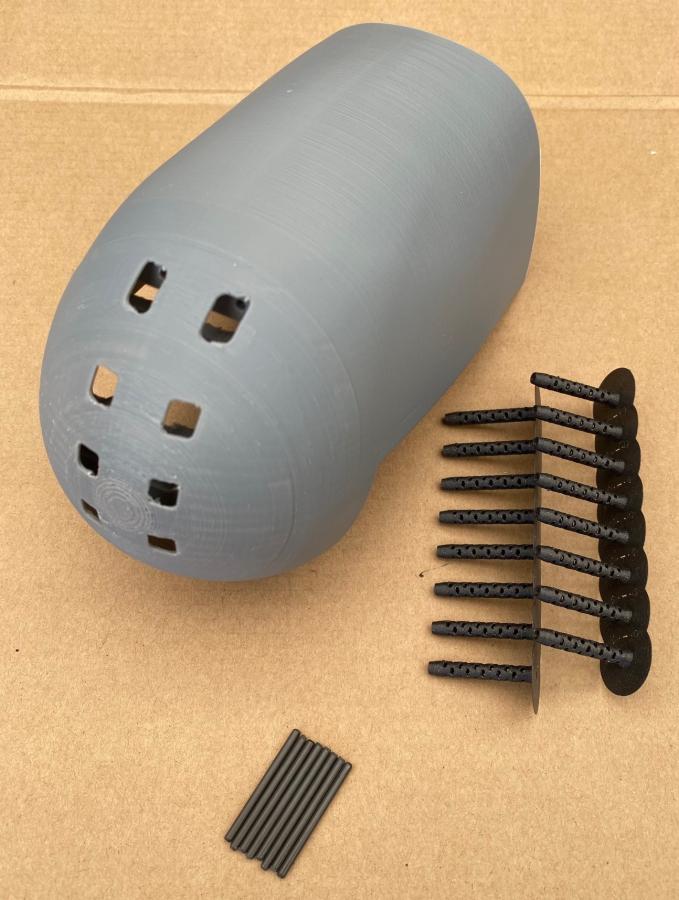

            Here is an update on the B-25J Gunship conversion
            1) Up-sized the Nose to approximate size of the model - Thank you Larry D
            2) Developed a gun barrel and attachment design - 2mm CF rod with a 3D printed skin for scale appearance
            Still much to develop before this is ready for prime time, but it's progressing nicely....

              Very nice work!!
              • William Gregory
                • Jun 2020
                • 3
                #407
                Nicely done !! Can’t wait to see the finished product.

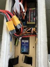

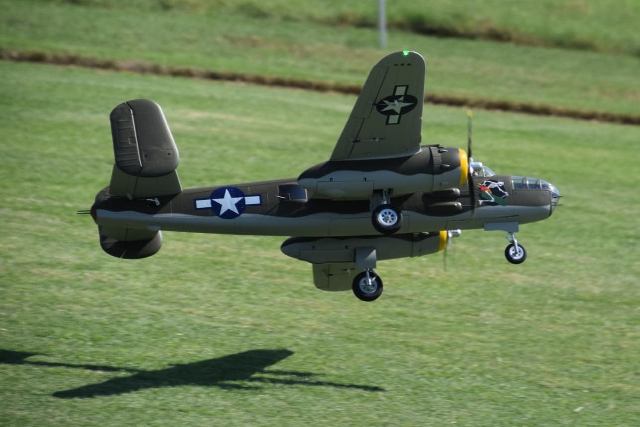

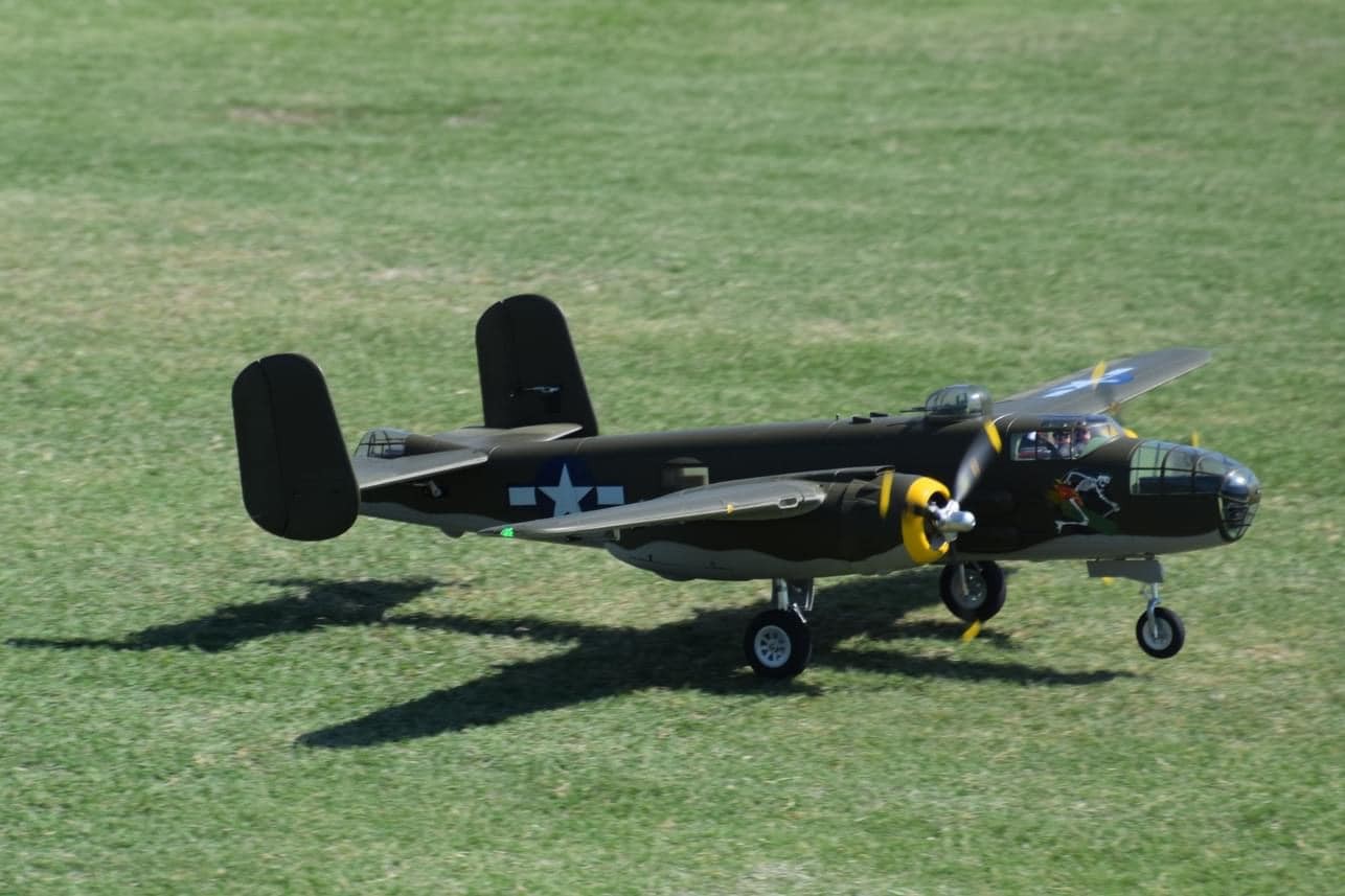

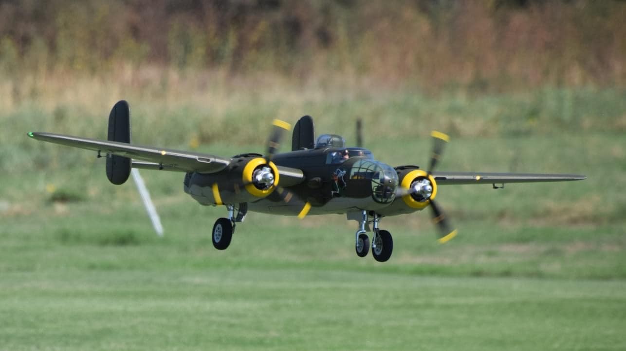

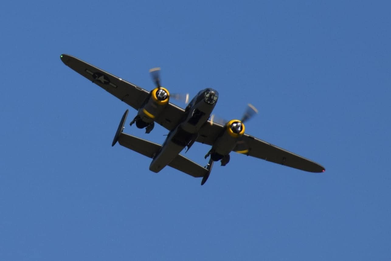

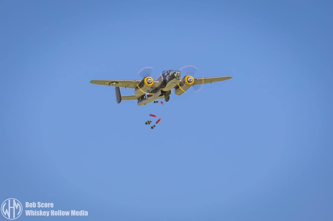

                        Had a chance to Maiden the B-25 this weekend. Another Fun aircraft and glad to see a Bomber actually have a working bomb bay.
                        The cutout on the battery board is a perfect location for the HobbyEagle Gyro. Recessed just below the surface and clear when battery is installed.
                        Be sure to check out Victory Girl Vinyl Decals – Tagged "Historic Nose Art" – Victory Girl​ if you are looking for nose art decals

                          Congrats. Will you be adding more decals to her?
