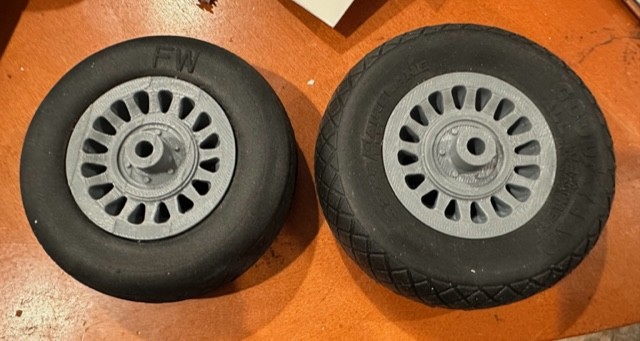

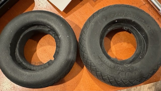

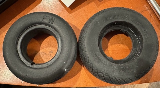

      I ordered a set of 3 1/4 robart mains hoping the wheel diameter would be the same as the 3-1/2 to fit the 3DP B-25 wheels. Unfortunately, the Wheel was also smaller. I originally planned to use the factory tire, so once the B-25 parts become in stock at motionrc, i grabbed a pair. Some minor dissection and they fit on the 3DP wheels.
      Ill CA them to the wheels just like we do for RC Cars.

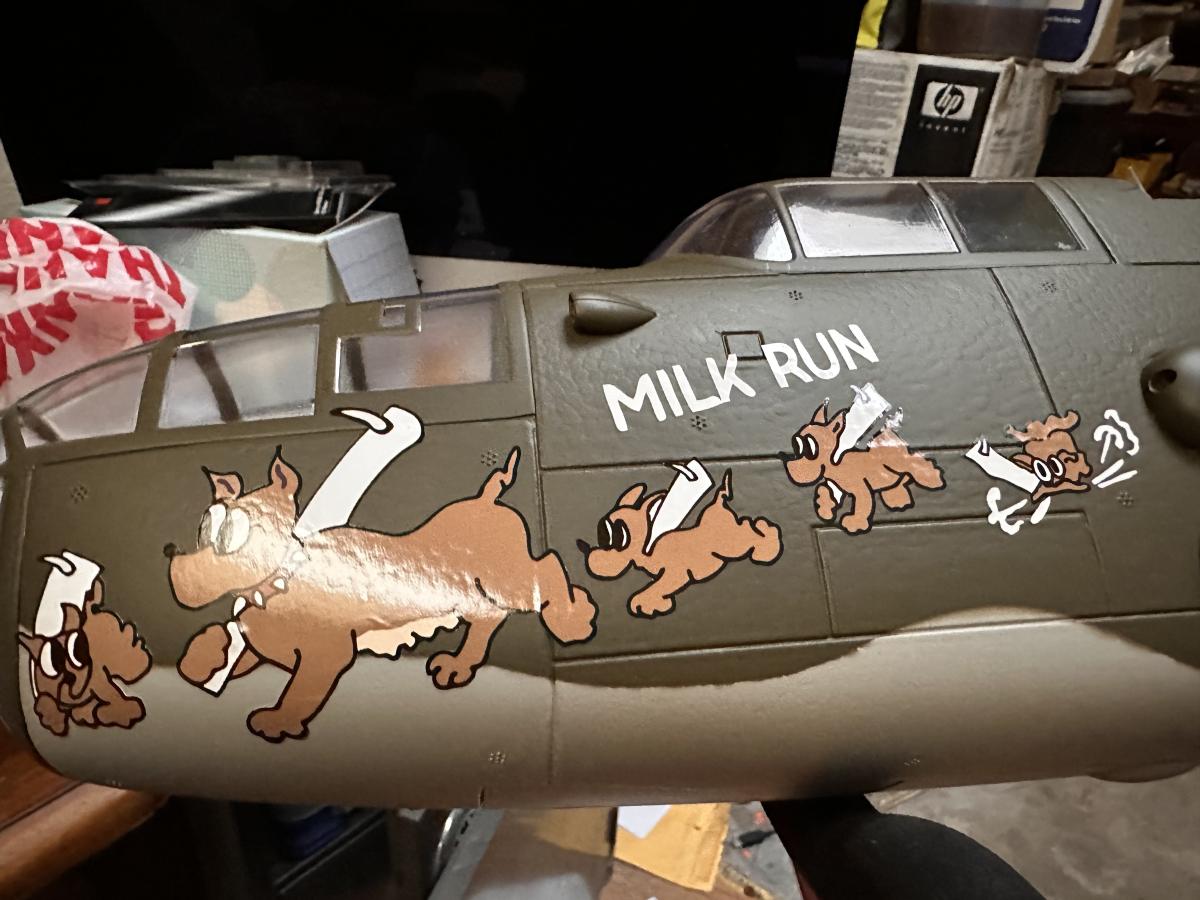

              Originally posted by Enzo_K

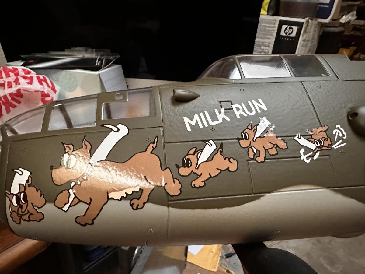

              Have the same issue on MANY Freewing/Flightline products. Dating back as early as late 2021 (Been a Freewing customer for years, early 2022 or late 2021 was the first time I encountered this issue)
              I have a whole story to share if somebody is interested. I will cut it short here: MRC CS is a joke. I don't wanna mention names. But if you are talking with someone's name starts with a D & an M. You are better off just rubbing it in.
              This "Gatoring" issue has been going on for almost 2 years. And no one at MRC ever wanted to address it.
              I am currently arguing with MRC about my B25. Screenshots from Arthur RC's video show how bad some of the "gatoring" is. Some of them are minor. Like my Ta152 and Mirage. You could probably deal with it. Some of them are just unbearable. Like my P38, B25 & A6.
              My speculation on this is the "Gatoring" happened during sea transfers. Which I think MRC is in charge of, correct me if I'm wrong. Because none of the social media in mainland China have I ever heard about this "Gatoring" issue complain. Nor has any of my friends in China ever experienced this "Gatoring" issue from Freewing/ Flightline products. At least not on a large scale (small imperfections are acceptable, but this is way beyond).
              Edited 1: I don't think it is caused by sitting at the US customs for inspections. As Arthur RC is located in France, and received his B25 in early August. Also, it doesn't explain past "Gatoring" on other models.
              Here are some examples of the A6 and the B25. Open attachments to see more life-like gators! Lol​
              Click image for larger version Name:	A6 bad fuse.jpg Views:	0 Size:	102.0 KB ID:	388329 Click image for larger version Name:	B25 bad wing 2.jpg Views:	0 Size:	54.6 KB ID:	388333 Click image for larger version Name:	A6 bad fuse 5.jpg Views:	9 Size:	65.7 KB ID:	388313 Click image for larger version Name:	B25 Arthur RC bad fuse.png Views:	7 Size:	1.07 MB ID:	388319 Click image for larger version Name:	P38 bad wing.jpg Views:	7 Size:	44.9 KB ID:	388306 Click image for larger version
Name:	B25 bad fuse 2.jpg
              https://www.youtube.com/watch?v=ha95x_uqLn4
              My B-25 looks almost exactly like your photos across all parts, and worse in certain areas. I opened a ticket for a direct exchange, but was told that all foam planes can be expected to have gatored finishes and that I could just return it. No remedy would be offered.
              Coincidentally, I ordered limited B-25 spare parts just to have them and they actually look great with zero of the gatoring evidenced on my full aircraft, so the MRC "customer service" response is pretty dismissive.

                Sorry to hear about this. Keep talking to them. Attach more photos. I decided to keep the plane and received compensation. You can either do that or return it and get a refund.
                The "foam planes can be expected to have gatored finishes​" part is definitely BS. Small areas of imperfection might be acceptable. But the whole top of the wing, the fuselage is not a small imperfection. And it is definitely not caused by the manufacturing process.
                Regarding the CS team from MRC? I can't say all of them. But 2 of their CS representatives have been straight out lying to me before, not once, but multiple times.

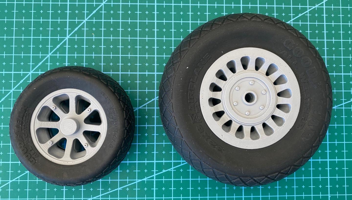

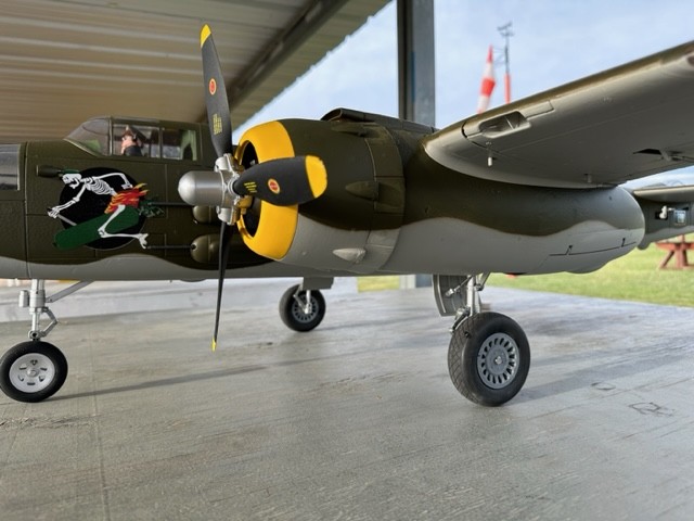

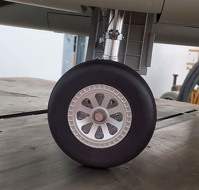

                    I have completed the pre-flight fit-up and assembly for the scale rims with Robart tires. Several design changes have been incorporated into the rims as a result of the fit-up. Updated .STL files and guidance are posted on Thingiverse​
                    My thanks to JD and others who helped me develop these

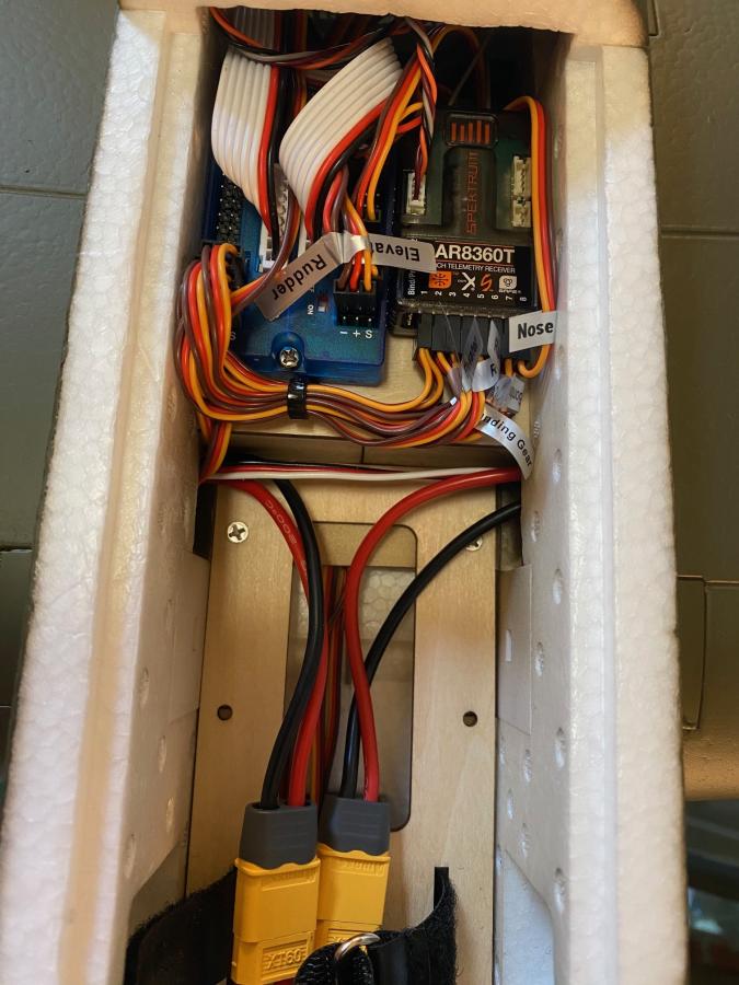

                      So...where are people installing their receivers? I have an 8 channel that does wedge in snuggly next to the wiring distro box but...not sure I like it right up on it. Not like it's high voltage pumping through but....yea. I've had problems with receivers being to close to the battery connection causing issues. I just don't see much room elsewhere for a receiver. Would love to see some pics of your setup folks.
                      she's a beautiful girl...for sure. If she flies anything like the AL37 I'll be a happy boy...lol. Took the last two winter flying seasons off after another knee surgery and...got into and hooked on 3D printing, raspberry pi, Microcontrollers and IoT dev. Afraid I'll be a bit rusty lol. Been waiting for a quality made B25 and here she is. Time to get back out there.
                      Next on the wishlist... A B26. Medium bomber that flew like a fighter.
                        • 5401
                        #511
                        Back behind the MCBe.

                          #512
                          Re-positioned the MCBe. Rx just fits next to it.
                          Satellite Rx on the aft wall of the bomb bay.

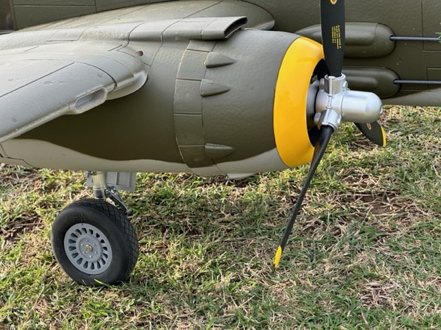

                            Finally had a chance to fly with a set of Freewing Tires mounted on the 3D Printed Mains. Many takeoffs, landings, and a number of touch in goes on a grass runway. Everything holding up well. I printed with Bambu Labs ASA filiment.
                            The Wheels look awesome on the aircraft.

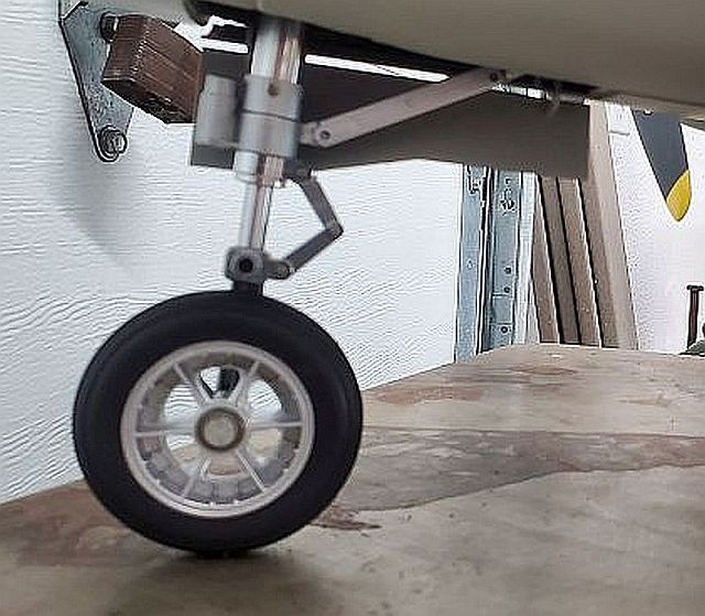

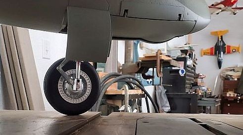

                              Hi guys,
                              Nice to see other modifiers getting into this bird. I Have many mods planned and it seems, like myself, the first was to get the rims and tires changed out. I was looking around to see what's used on other model that might get me there and came across the rims used on the fms f7f tigercat. So I got a set and had to turn down the axel to fit through the bearings in the rims (which I love). Also, I like the see through front wheel rim. Some have a flat plate cover and some add a star on it but I'm going to stay with the open look.
                              The tires are a little narrower than what I'd like but could modify the Robart tires to fit these rims ..........maybe later.
                              I came across the stl files after the fact but I don't do 3D printing.
                              Also, I've a adjusted the spring tension on the mains and the nose wheel so their actually functioning as shock absorbing struts. I've yet to get an upgrade that was appropriate to the weight of the plane.
                              Haven't maiden her yet but soon depending on the weather.

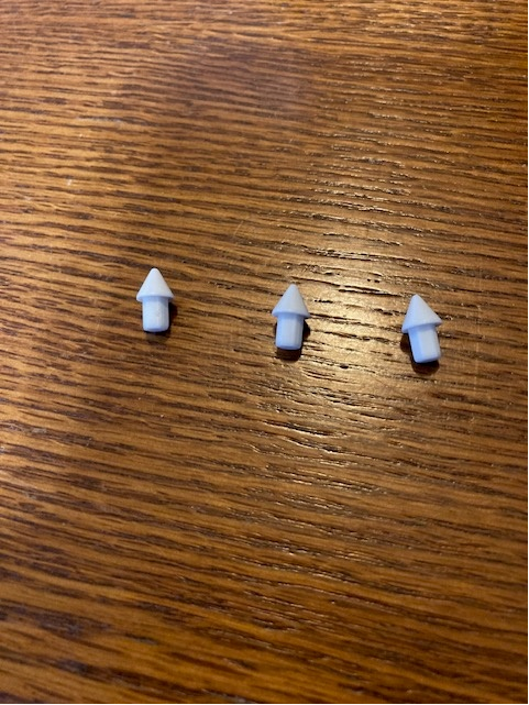

                                  These were in the pack of parts. What are they for?

                                    They go on the carbon fiber tube ends.

                                        Specifically they go on the end of rods for the tail section. They help guide the rods into the holes if you plan on removing the tail section for transportation.
