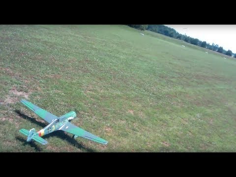

      I'm getting really frustrated with my Ta-152... grass field operations. This thing is so light in the tail that I can hardly keep it from nosing over long enough to get it into the air. I fly mostly tail-draggers and know how to the manage the tail for good, scale-like takeoffs, but I can't do it with this Ta. When I do get it moving, I'm having to hold so much back pressure that it leaves the ground before it's flying fast enough, and wants to torque roll on me. I can usually recover from the torque roll, but a couple times, I have not. I'd appreciate some sage words of wisdom from any of you guys who are successfully flying this plane on grass fields. Here's what I've done to my Ta so far.
      - Raked the gear forward a few degrees.
      - Battery pushed back as far as it'll go.
      - Greatly reduced the elevator throw, because this plane is prone to accelerated stalls. I/m coming to the realization that maybe I have reduced my elevator authority too much. It flies great, but the small elevator throw probably makes it too hard to the manage the tail properly, while moving on the ground. You can definitely see in the video how easily the tail comes up. Propwash alone seems to make the tail want to rise.
      Here's the video from yesterday's flight. I've bleeped out my colorful, frustrated language. I think it took me 5 attempts before I finally got the plane off the ground (narrowly averting a torque-roll-induced crash).
      Thoughts (other than throwing the plane in the never-to-be-flown-again pile, or me finding a new hobby)?:Confused:
      [edit] I was using a new hatcam, with a narrower field of view, and had it set a little too low. Most of my flying was out of frame. My apologies. I've cut out almost all of the actual flying because of that.

          observations from your video showed that you were takeing off with the wind. I noticed that when you turned your head to the people at the shelter to speak the flag was blowing in the direction you were taking off. I have a few birds that are really prone to noseing over on take off and i get somewhat frustrated myself. What i do is always take off into the wind (not with the wind) no matter how soft it seems to be. I also have my throws on my elevator on a switch for as high a rate as i can get for take off. Once i get the plane rolling i advance the throttle smoothly and work the rudder to control tourqe roll and keep the plane straight. While advancing the throttle i also start backing off the elevator as the plane gains a significant amount of speed. At this point ive gained pretty good speed and almost flying on the ground. When airspeed for takeoff has been reached then i gently ease back on the elevator again to take off and then switch to my normal flying rates. The field you fly off of really looks cuts nicely. I wish ours was. Just two days of growth and you have to nug a plane to even get it moving. But it always seems once i get my speed up over a certain point i have to impart very little elevator to prevent nose overs. Takes a little practice haveing to worrie with elevator,rudder and throttle but i can tell by your flying you will handle it quickly
          i hope this helps. Just remember into the wind,alot of up elevator to start decreasing slowly and rudder to keep it straight until take off. And if at all possible forget any flaps for take off. I have a Hellcat that any flaps at all and with all the elevator i give it it will nose over. I can leave the flaps alone and it is pretty reasonable then. On landing if i use flaps i have to dump them as soon as my wheels touch or it will nose over. Sorry for the book iwas just giving you a rundown on my nose sensitive birds. Happy Flights:Cool::)

            Thanks for your comments. It was a bit of a crosswind day. The trees make the wind do crazy things. We have wind socks on both sides of the runway, and they often point different directions, on low wind days, like yesterday was. We commonly get thermals passing across the field, that'll make one sock point north and the other south. That's probably what was going on with the wind sock you saw. The wind was SSW to SW all day, and I was taking off to the south. A little later in the video, the wind sock on the left side of the runway can be seen, and it is indicating a nose wind.
            I'm pretty experienced with tail draggers. I flew a bunch of warbirds yesterday and didn't have any problems. And, I've been flying this plane since it was first released. I'm just having problems with this Ta now, more than when I first started flying it. I was hoping to get some advice from guys who've flown this plane on grass and have overcome its nose-over tendency. I'm pretty well convinced that I've got to add some weight to the tail and/or increase the elevator authority. I'm thinking that lack of elevator authority is my main problem now.

              I am sure that you are correct there. Keep me posted on what you do. The only reason i dont have one yet is because im waitng on the 1600mm Spitfire to go preorder. Goodluck and happy flights

                Just don't get the last 1.6M Spitty before me!!! I'm definitely going to give the Ta back some elevator throw. Hopefully, that'll solve my take-off/taxi problems. Will report back after my next flight.
