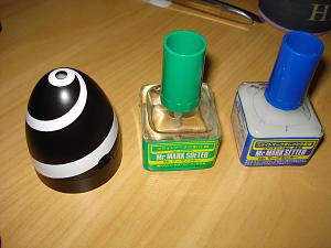

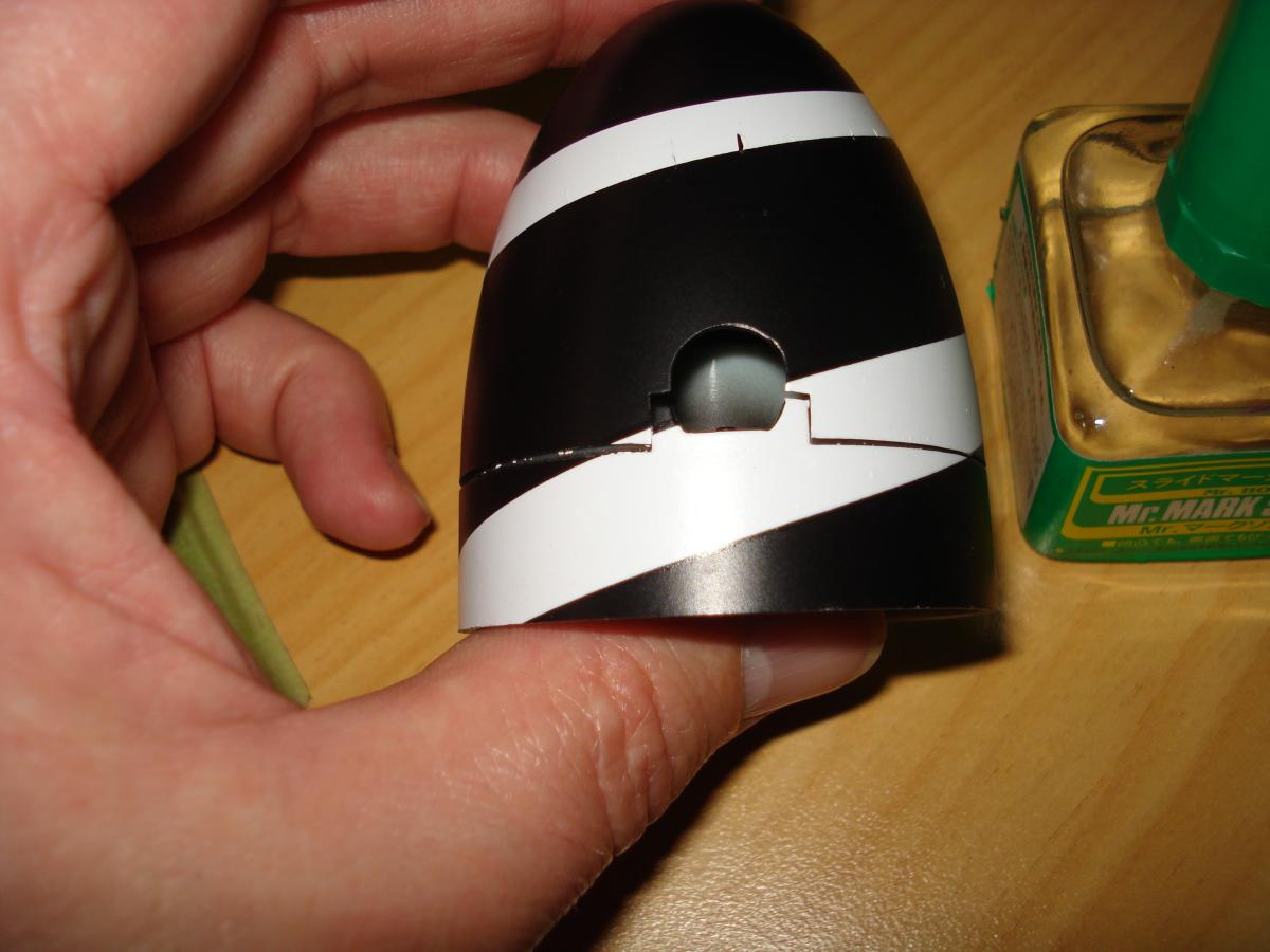

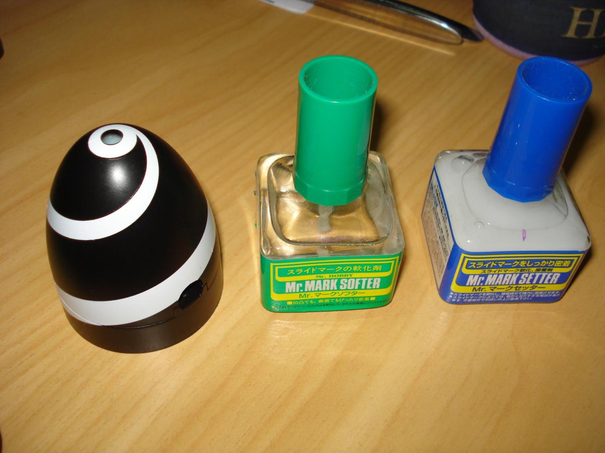

    Spinner decal works fine, My Hobby or Tamiya or Micro Set and Micro Sol work fine, just take your time, when it was finished I gave it a satin coat out of a Tamiya rattle can, One litte chip on the spiral due to impatience, Took a few ours of laying it, setting it and then a half dozen coats of Mr. Mark Setter.
    Put a coat on, walk away, come back on 30mins dub it dry and recoat then repeat till you're happy. Click image for larger version

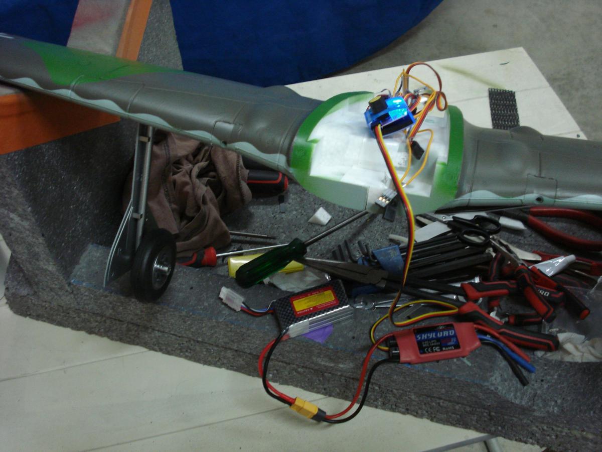

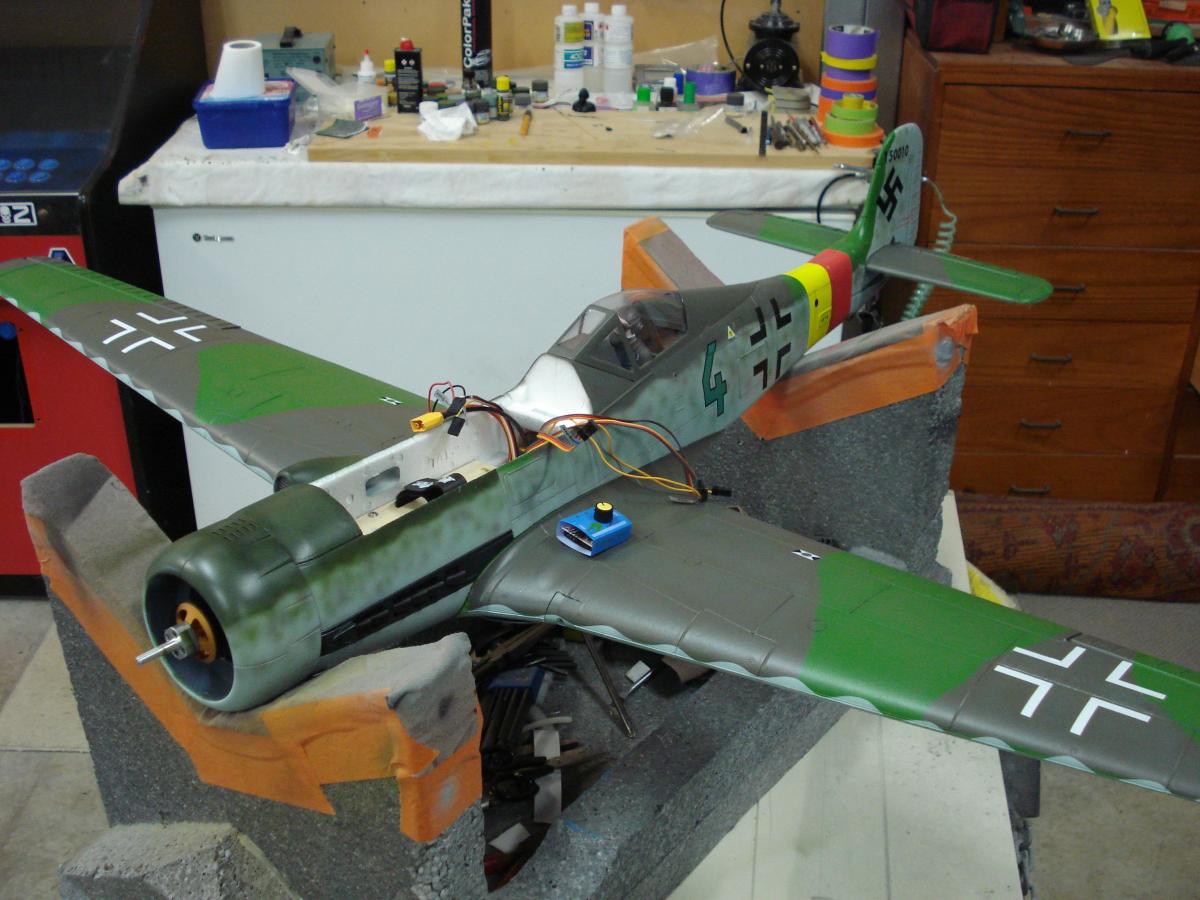

      Having a retract failure. Triple checked connections and even tried a second receiver and a servo tester.
      No luck at all.
      Would this be a 'blue box failure'?​
      Tried two receivers, two transmitters.
      Only way I can run the gear is to bypass the blue box.
      Can anyone help?
      Thanks in advance, John.
