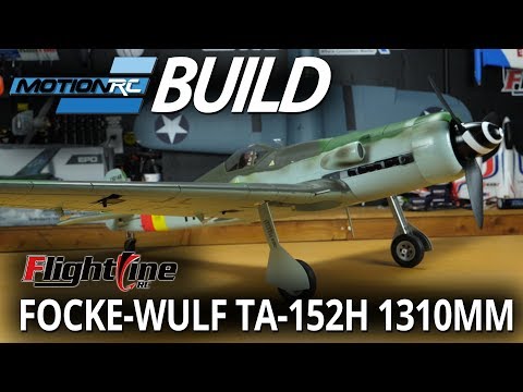

          I also took a look at the build videos. Seeing now how the prop/spinner works I am wondering what typically breaks in a prop strike? Prop, spinner, or both? It's a warbird so I'll probably have a prop strike at some point on our asphalt runway.
            #145
            It depends on the strike. Most often the prop blade will break first, by design. You'd have to hit it fairly hard with the motor spinning to transfer the energy to the spinner quickly and forcefully enough to break the screw holes where the prop blade meets the spinner.
