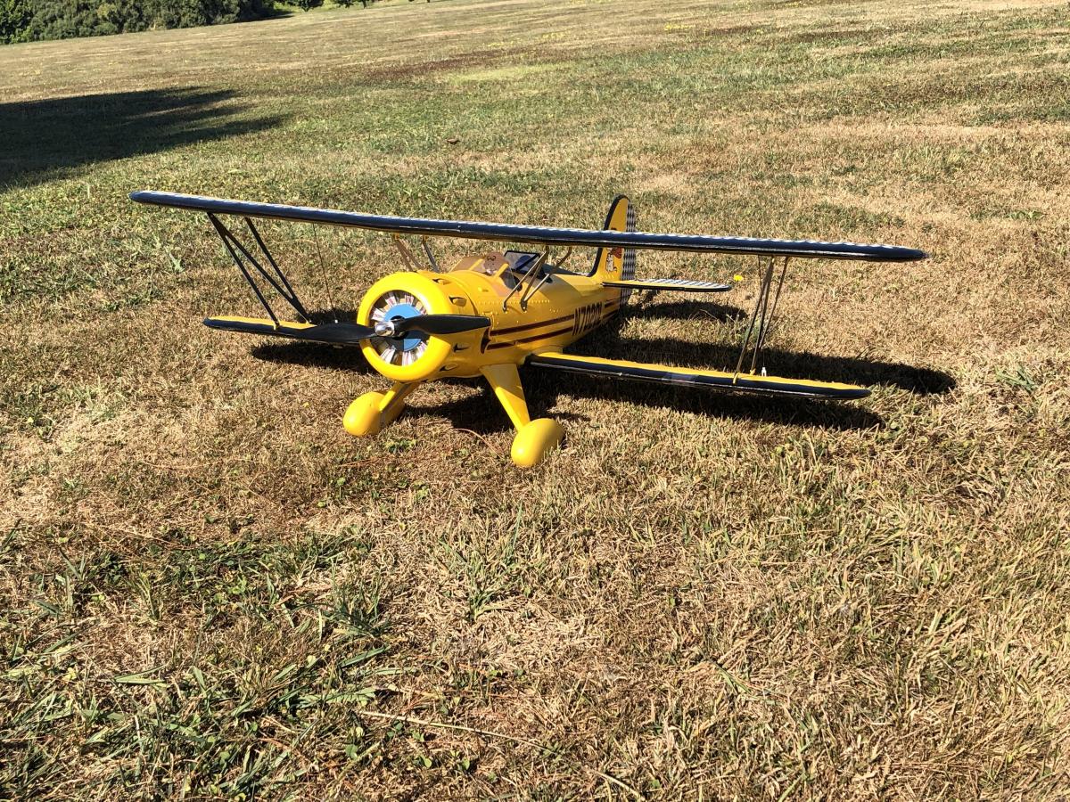

I know I’m late to the party but I’m a new member of the Dynam Waco club. I have it built just waiting for good weather to get the maiden done.
Official Dynam 1270mm Waco Yellow Thread
Im only running Admiral 2500s, so I had to add a bunch of lead in the nose. Seems as if most are running the 3000s and it fixes CG issues.Comment
One way to find out. I had to run 5ozs or more with the 2500. And had to switch props, went from 12x6 to 12x8 to get more bite to pull the extra weight. But it seems to be happy there. Hopefully you get a good day soon. We have snow and freezing temps in Ohio. Might be awhile, though i did break out the skis for the Eflite Cub.Comment
We got 4 inches today, now it just needs to clear up so I can take it out. Have a second set for the Turbo Beaver.Comment

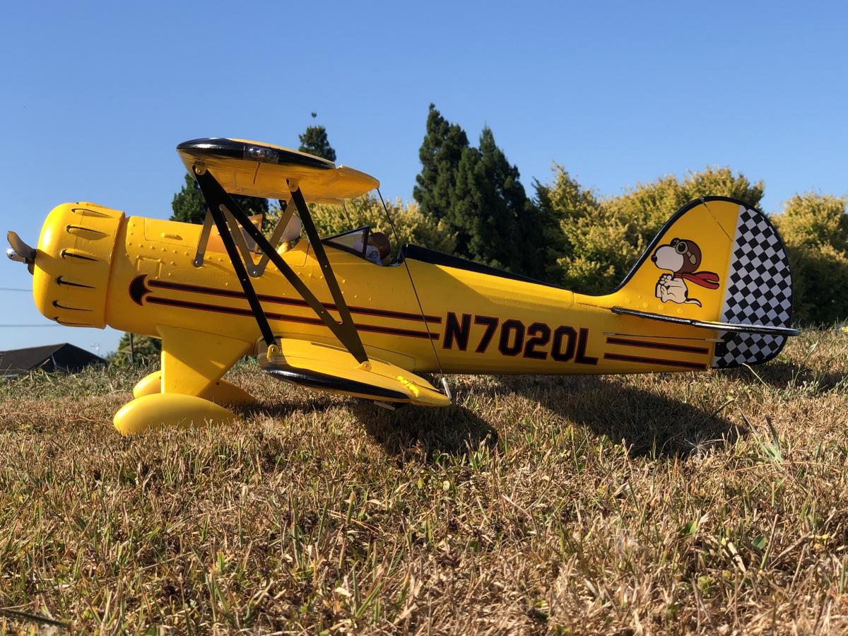

Just finished building my Dynam Waco-I never meant to get so carried away it just kinda happened. The photos don’t do it justice I can tell you that much-now my friends say “it’s too good to fly” and should be on display lol. I’ll fly it at least once or twice. It’s my first (and only) Biplane and I’ve heard lots of good stuff about it hence I bought it. Only mod I didn’t do was swap out the LED’s for a working kit-I was over the project by that stage, plus I have a raft of planes waiting to be built-plus my buzz is flying then, not detailing, so this is the only one I’ll go to this extent on. Has anyone tried an MAS Beech prop on this bird and if so did it reduce performance?3 PhotosComment
Took a few more photos and a bit of video doing my regular “pre maiden taxi round the yard” today. Soon as the wind settles after the weekend I’ll get it flying-in the meantime, what size lipo y’all using in this bird?? 3000 or 4000??7 PhotosComment

I have a MAS beech prop to go on it before I take it for a maiden flight next week. I always balance the props on everything (I even check my pre-balanced MAS ones). No guarantees but you might see it on my friends YouTube channel if I take it down to Tokoroa in 3 weeks time when we can fly there again-the airfield is booked for the next two weekends and I know Bruce is keen to see my “snoopy” plane lol2 PhotosComment

I managed to get my cosmetically modified one maidened last week too. I added 20g of weight behind the cowl and ran a 3000mah all the way forward and I must admit I wasn't expecting the take off charachteristics this plane has. Once I got it trimmed up it was a joy to fly-tons of lift, but I did notice it does not like slow flight and will drop a wing on you very easily especially in the turns, but once I got used to it the plane was a blast to fly. Was good to see I still had Snoopy, Charlie Brown, and Woodstock still onboard after the maiden flight. I had thought about selling this plane despite the money it owes me (the custom decals cost more than the plane), but I actually enjoy flying it. It will remain in my hangar as my only Biplane I think.Comment
I fly mine exactly the same way 20 ounces in the nose and a 3000 4s battery and it flies great and your right it doesn't fly slow but it is quite acrobatic at speed and fun to fly. It's my favorite bywing.I managed to get my cosmetically modified one maidened last week too. I added 20g of weight behind the cowl and ran a 3000mah all the way forward and I must admit I wasn't expecting the take off charachteristics this plane has. Once I got it trimmed up it was a joy to fly-tons of lift, but I did notice it does not like slow flight and will drop a wing on you very easily especially in the turns, but once I got used to it the plane was a blast to fly. Was good to see I still had Snoopy, Charlie Brown, and Woodstock still onboard after the maiden flight. I had thought about selling this plane despite the money it owes me (the custom decals cost more than the plane), but I actually enjoy flying it. It will remain in my hangar as my only Biplane I think.Comment
