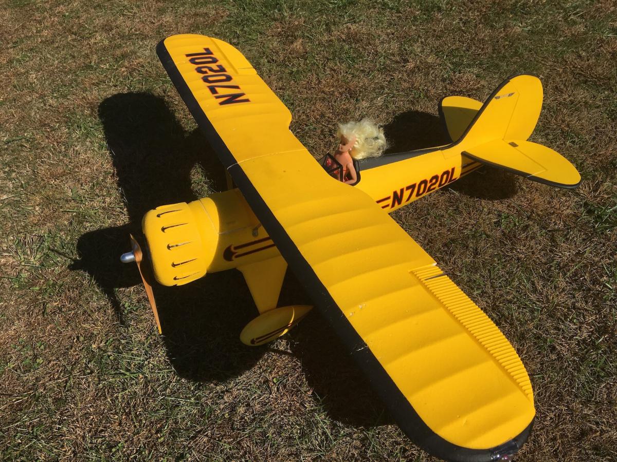

The rigging is done, and I'm very pleased with it. The tail rigging is elastic cord from the fabric store, threaded through small holes punched in the rudder and horizontal stabilizers, and secured at the bottom in small holes poked in the fuselage. Where the cord passes through the surfaces, I added a drop of flexible CA to secure it.
The wing riggings are made of small wire actuator or control cables of some sort that I found in a surplus many years ago, and thought they looked useful. They've been sitting around ever since, and they struck me as the perfect thing to make the riggings. The springs are from Ace Hardware, and I used photos of real Waco YMF-5D's from the Waco Aircraft Company website for placement. About the only thing missing are the two short lines that stretch from right in front of the foreward cockpit to the upper wing, and those would be problematic with that portion of the model being the battery hatch.
My pilot is still incognito until the decorating is completed, and the plane is ready for the full reveal.4 Photos

The decals from Callie arrived today, and look fantastic on the Waco. A couple more minor details, and I'll be ready to post the finished photos, and take her out for a maiden flight.
I should practice with the taildraggers a bit more on Realflight before then. This will be my first experience flying a taildragger in real life, and after as much work as I put into this, I don't want to mess it up on the first flight.
- Likes 1
And here she is - Air Hooterville, with your pilot, Arnold Ziffel.
If it confuses you a bit, you're probably a bit too young to get the reference.
The "Air Hooterville" and plane numbers are from Callie's Custom, while my better half made the flying pig decals on her Cricut. The pilot name (with my AMA number, since many clubs like the AMA number on the plane some place), was done on a basic Brother P-touch label maker.
Bonus points for anyone who gets the significance of the plane number.
The inspiration for the design grew out of discussion with a coworker on different amusing pilots I could put in the plane. Snoopy is always fun, but between this not being a Sopwith Camel, and that others have done it, I passed on that idea. Muttley, from the "Dick Dastardly" cartoons, would have been fun as well, but finding a workable figure from that old a cartoon wouldn't be real easy. We then joked about "when pigs fly," which led to some bantering back and forth, until I hit on the idea of Arnold Ziffel. Since Arnold was never a real large pig in the series, the smaller figure from the toy section works. His goggles (which I need to get a better photo of) are made of double-layered heat-shrinkable tubing and flat black lacing, while his scarf is simple white ribbon.
This has been one heck of a fun project, and I'm looking forward to a chance to get Air Hooterville airborn for her maiden flight.6 Photos
