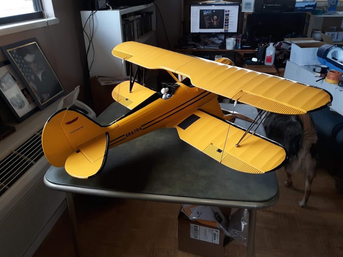

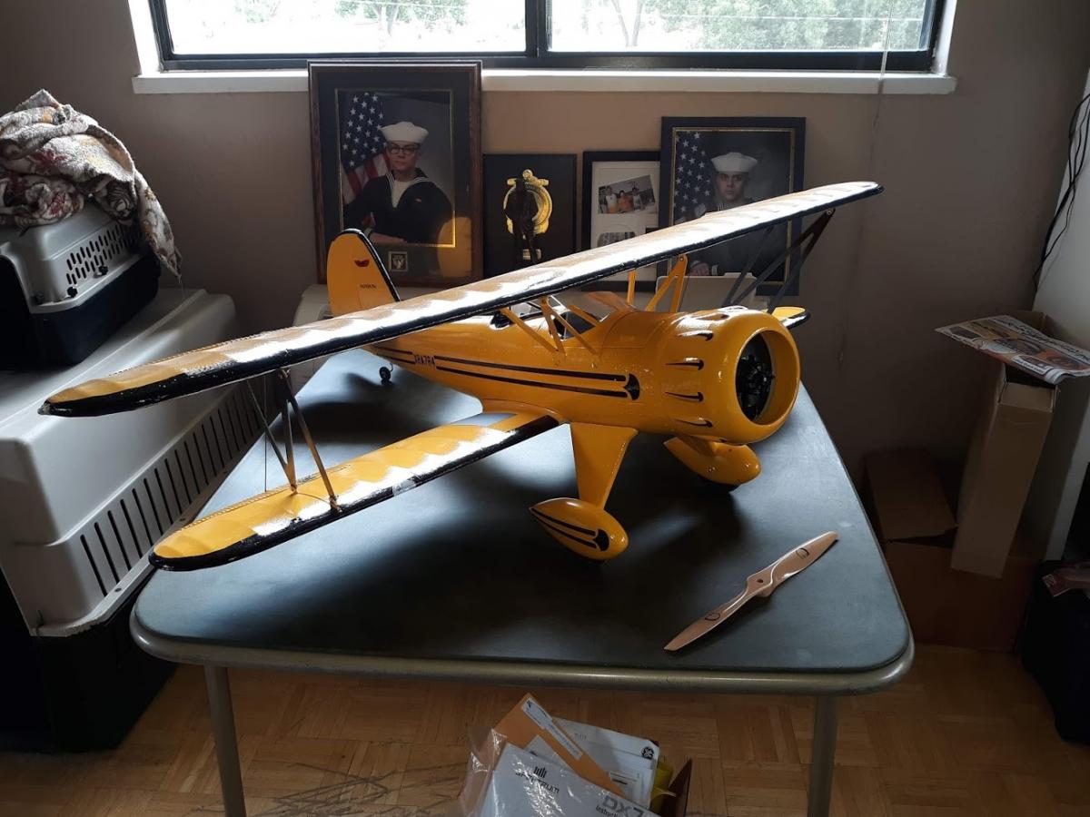

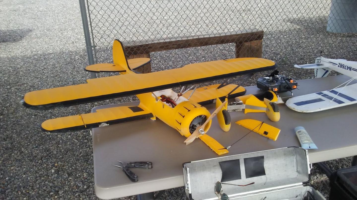

  • Last summer I dumb-thumbed my Waco into the deck. So after a year of looking at the pile-o-parts, I finally got her back together. And, I gave her the paint job I've been wanting to. Re-maiden will be next weekend. I'm still waiting for the new prop adapter which will be here on Monday. Overall I'm very happy with how she turned out, and I can't wait to get her back in the air.
    Excellent graphics by Callie as usual.
    • She looks great Prowler! One of the better scale foam bipes out there. Always enjoy flying it.
      • Thanks , TJ! yeah She's a beautiful flyer.
        • Looks brand new Prowler, nice work! That's my favorite biplane to fly.
          • What did you use for the glossy clearcoat, Prowler?
            • Thanks, Boomer.
              Hoomi, there isn't a clear coat on it yet. It is just Rust-oleum Painter's Touch Ultra Cover Gloss Marigold. When I do clear coat it, I will use Minwax Polycrylic Gloss. I'm using that on my Tigercat and it looks really good.

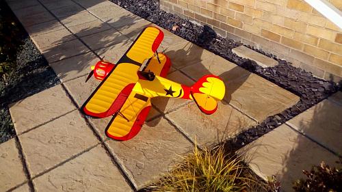

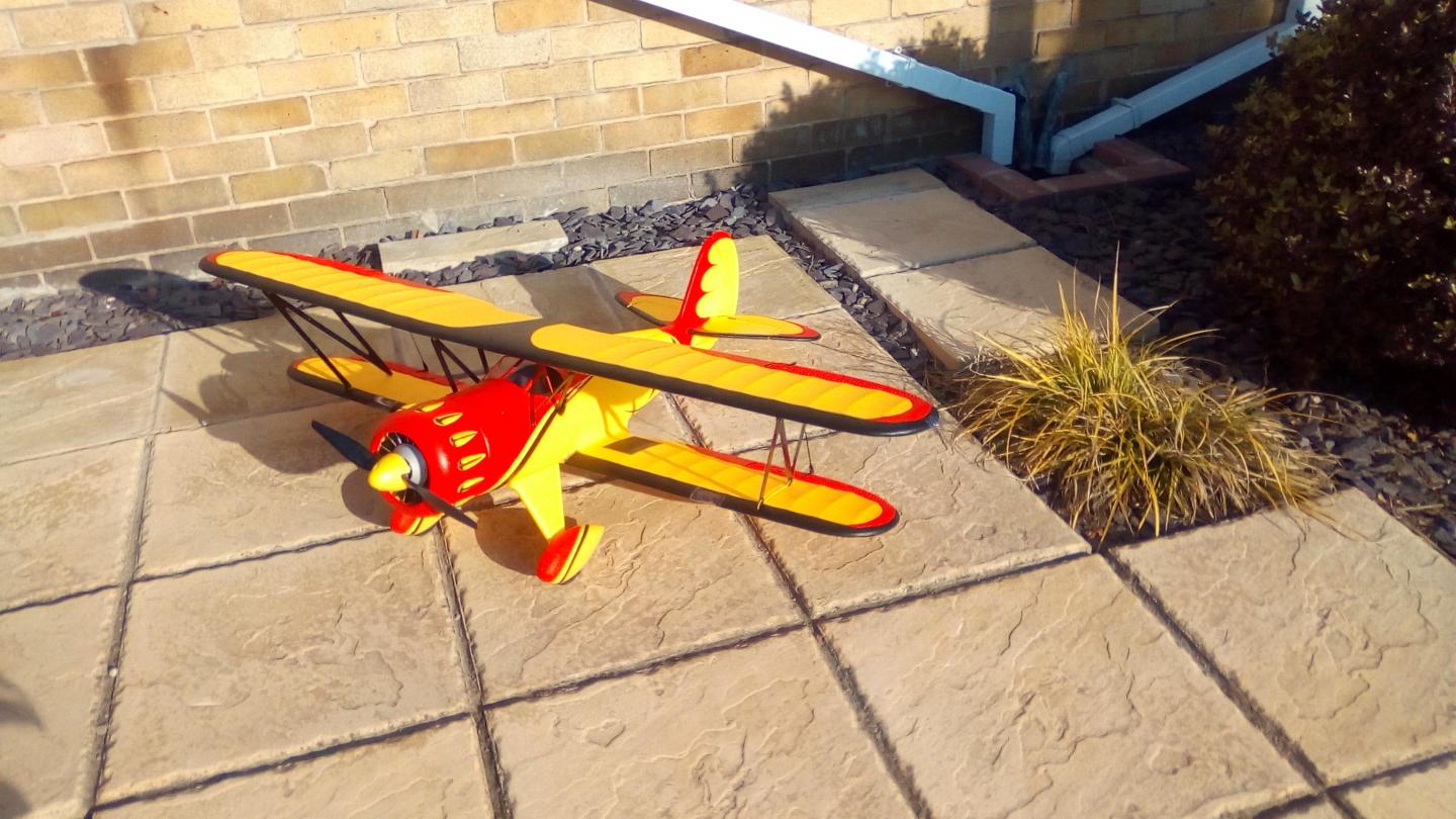

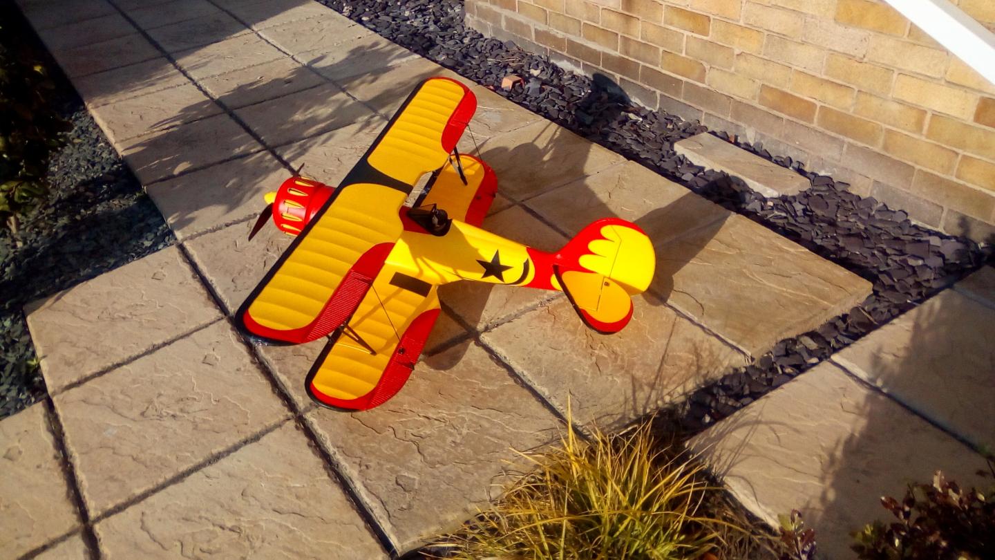

                      1800g 40.3dm2 WL 45gms/dm2. Detrum 3720A 650kvmotor 50amp Aerostar esc. Max power on Detrum motor spec 42A 630w. CG 75mm back from top LE. With 2200mah 60c 4s 1780g. cg 75mm ok . Power req 500w/600w. 12x10tgs FF 640w 42 amp16.6v ok.
                      this is my Mk1 version, dont know what the mk 2 power is but a bit more is always welcome. You will need some patience assembling and setting up as glue was sparse on mine and I had to straighten a few panels with weights and re glue the cf rods in the wings. I also replaced the hinges with hinge pinned nylon and added extra magnets to the hatch after adjusting the magnet fit. I have had this plane for a couple of years and its a great lazy day flyer in the setting sun. I also used a couple of cf sticks to grip the hatch.

                        • That looks great! paulrkytek
