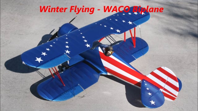

Thanks guys. Santa got a little stick time in it over the weekend.
