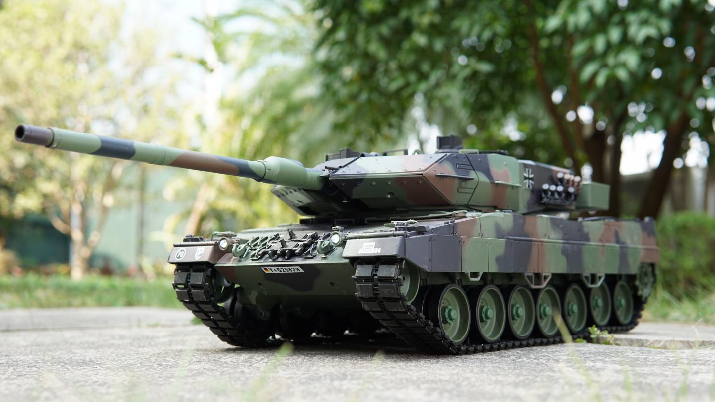

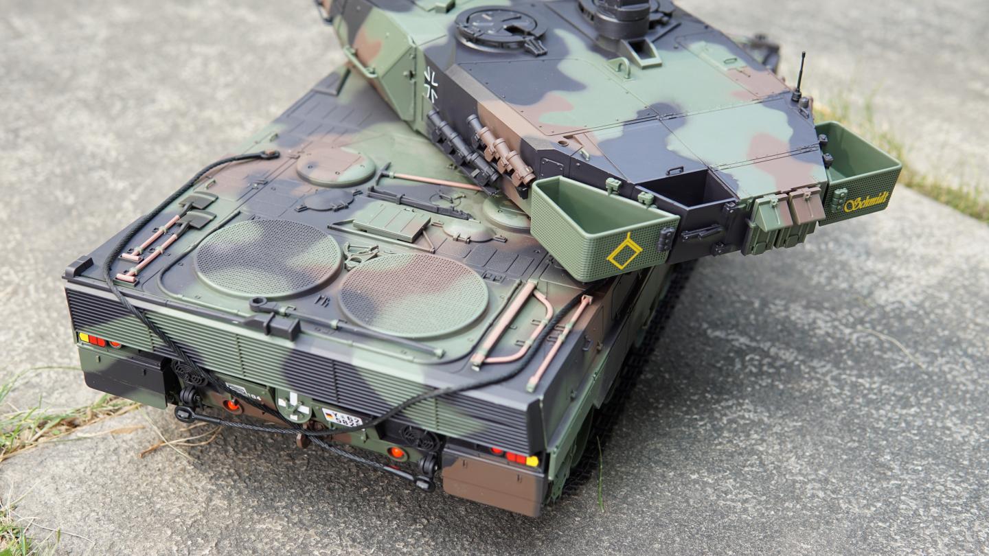

    Heng Long 1/16 Scale "Leopard 2A6" Modern German MBT (Main Battle Tank)
    Introduction:
    Developed in the 1970s and sharing several design and technological influences with the American M1 Abrams, the Leopard 2 is currently the German Army's Main Battle Tank. Recognized by many military observers as one of the most potent armored vehicles in history, the Leopard 2 has also distinguished itself by being one of the most widely exported tanks in current operation across NATO member countries.
    My Personal Averaged Total Score for the Heng Long 1/16 Scale "Leopard 2A6" German Main Battle Tank: 90 out of 100
    Heng Long's 1/16 scale Leopard 2A6 scored an impressive 90 out of a possible 100 based on my review. Read below to see how I arrived at this rating, as I evaluate the "Upgrade" version of this tank. "Upgrade" means that its exterior is plastic but its interior gears are steel. Note, where shown, the metal tracks denote a "Professional" version which includes more external metal parts at higher cost.
    As a visual companion to this written review, our Overview and Build Summary Video can be found *here*

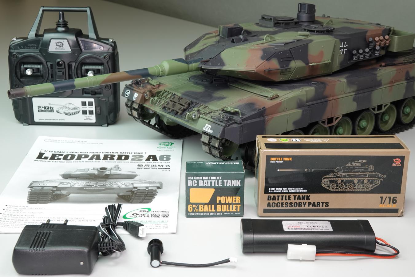

    What's In the Box:
    As an RTR or "Ready To Run" RC model, everything is included in the box except six AA batteries for the radio transmitter. In areas where shipping liquids is restricted, the glycerin used for the "smoke effect" is absent, but can be found locally at hardware or convenience stores that sell glycerin oil.
    The radio, tank, cosmetic accessory parts, tank battery, tank battery charger, and plastic BBs, don't require any "assembly", other than installing the aforementioned "cosmetic accessory parts".

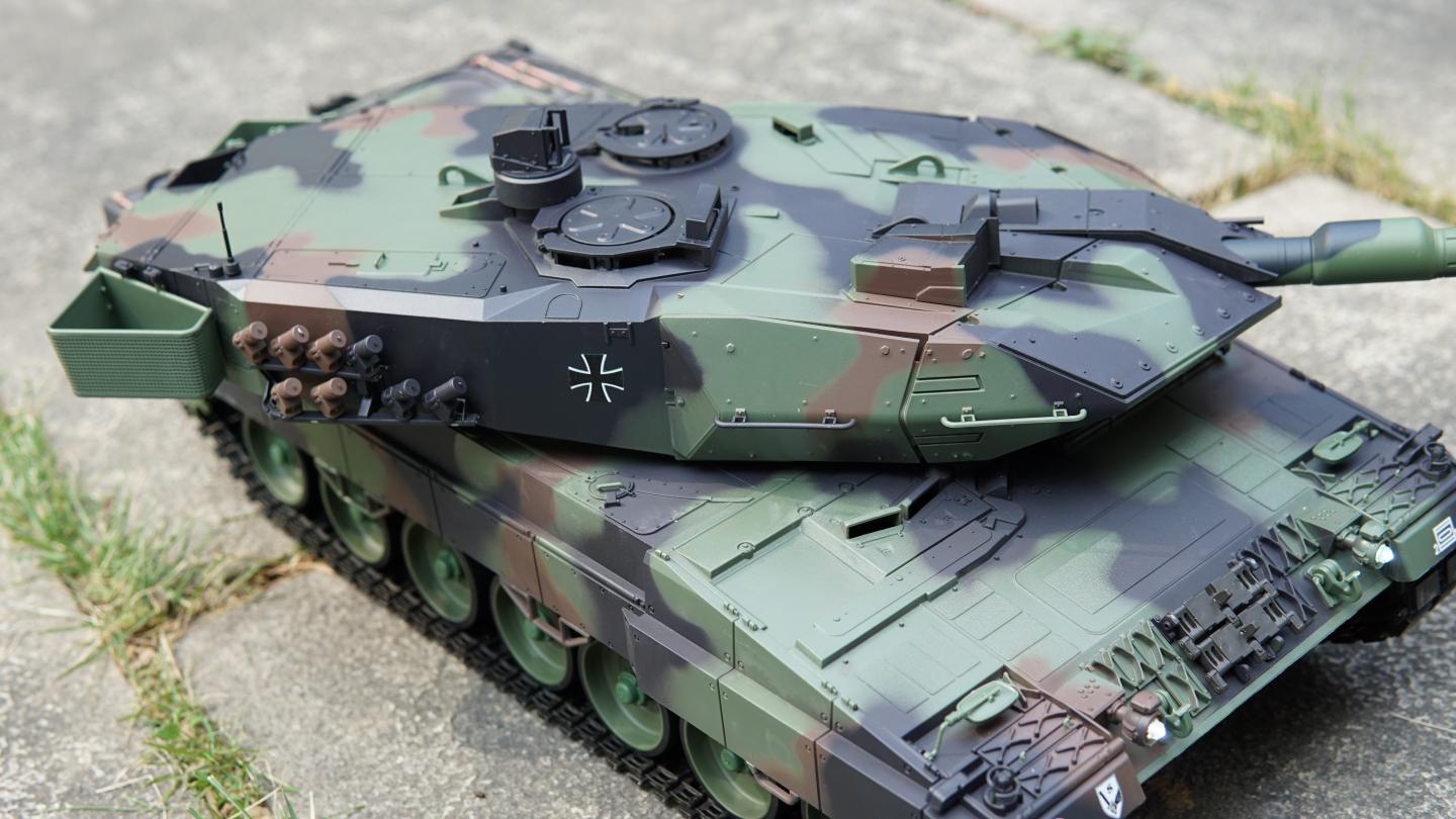

    Details:

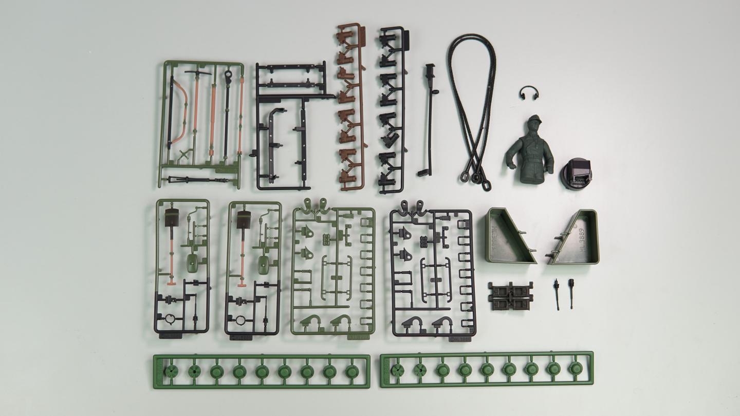

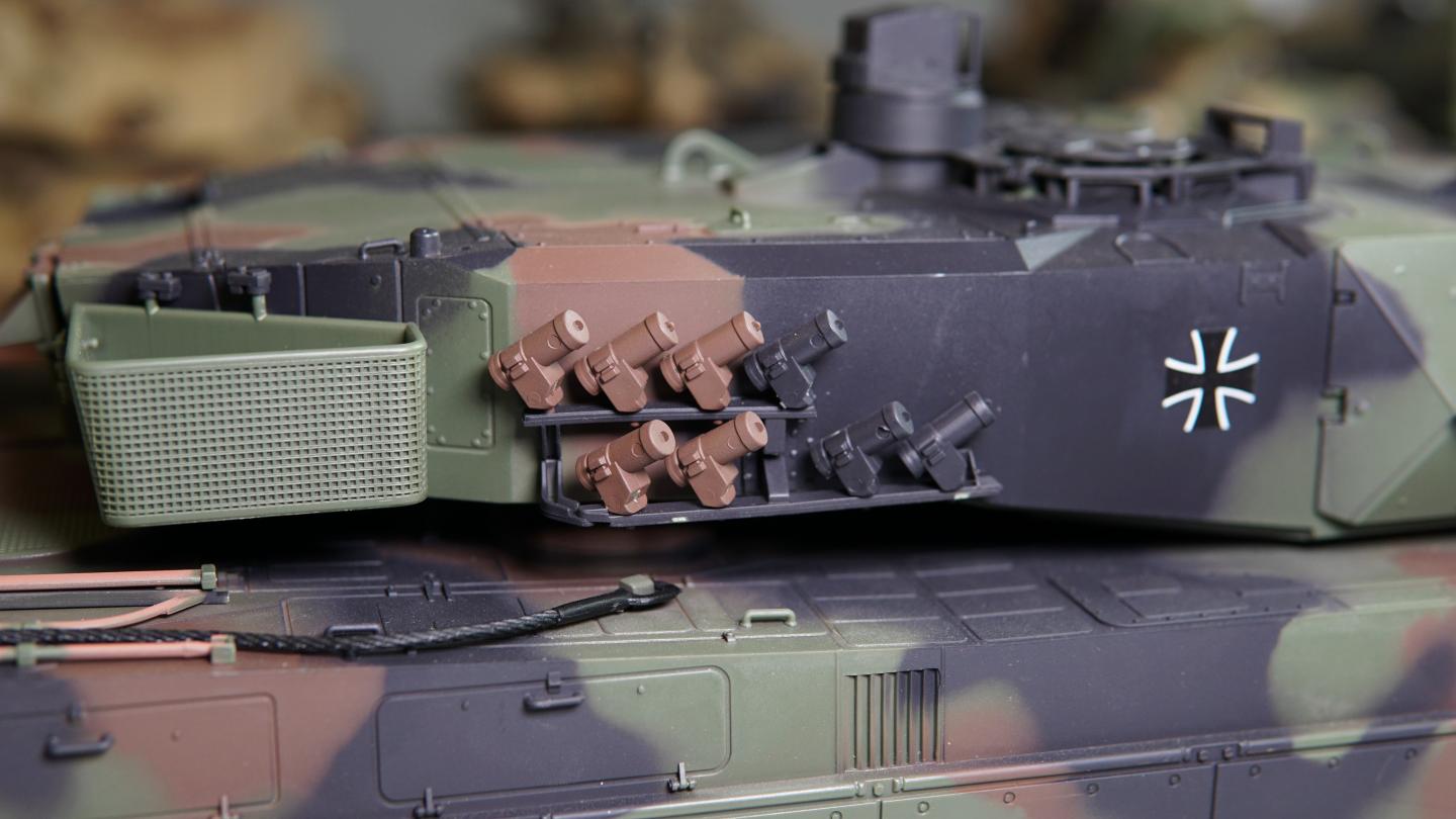

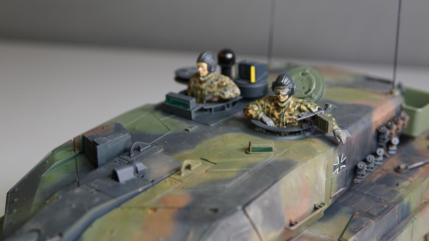

    Several sprues of plastic parts are provided for the modeler to install on the tank. These all plug into pre-drilled holes, and are nearly "snap fit". A few of the parts were loose, so I bonded them with ABS glue. But otherwise, I prefer to keep the parts unglued so they're easy to remove or replace if needed in the future. Installing the plastic "accessory parts", including the smoke grenade launchers, bustle bins, tools, rearview mirrors, and many grab handles is straightforward. Plan for an hour if you want to take your time cutting the parts out of the plastic sprues. I recommend a sharp clipper designed for this purpose, as it makes cleanup much easier. The accessory parts are pre-painted and really enhance the tank's overall surface detail, as can be seen on the engine deck. Flexible tow cables are draped over the rear exhaust manifold grille and anchored to movable shackles. The smoke effect is expelled through the two circular stacks seen in the photo to the right.
    Click image for larger version  Name:	DSC09790.JPG Views:	0 Size:	186.2 KB ID:	220764 Click image for larger version  Name:	DSC09467.JPG Views:	1 Size:	124.1 KB ID:	220766
    The Leopard 2A6 does include some delicate parts, such as the rear view mirror arms. ABS glue helps to keep them in place. When transporting the tank, I grip it by the glacis (the front slope of the tank's "nose") and avoid gripping anywhere near the rear view mirrors. The smoke grenade launchers are numerous but assemble easily. Take your time.
    Click image for larger version  Name:	DSC09462.JPG Views:	1 Size:	103.0 KB ID:	220767

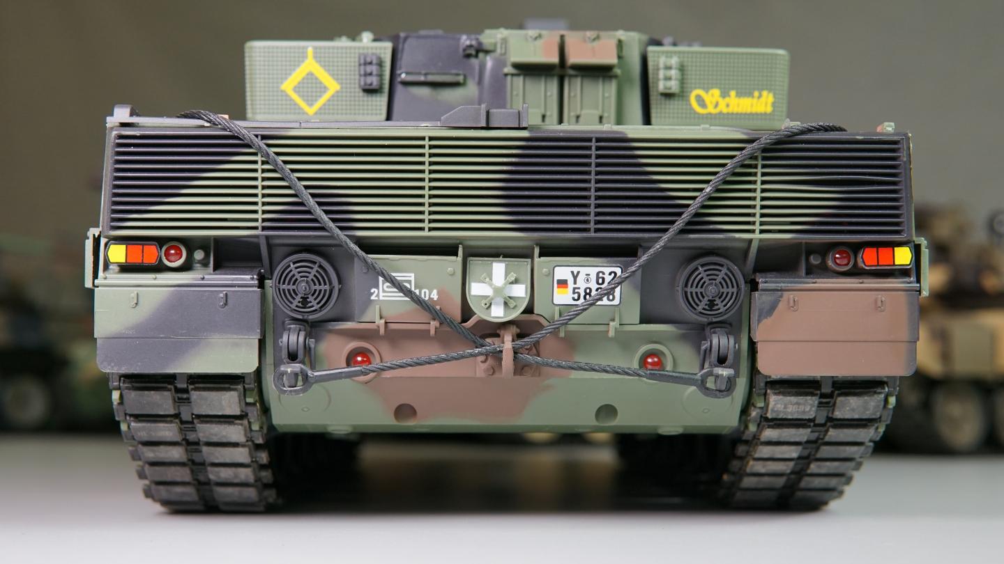

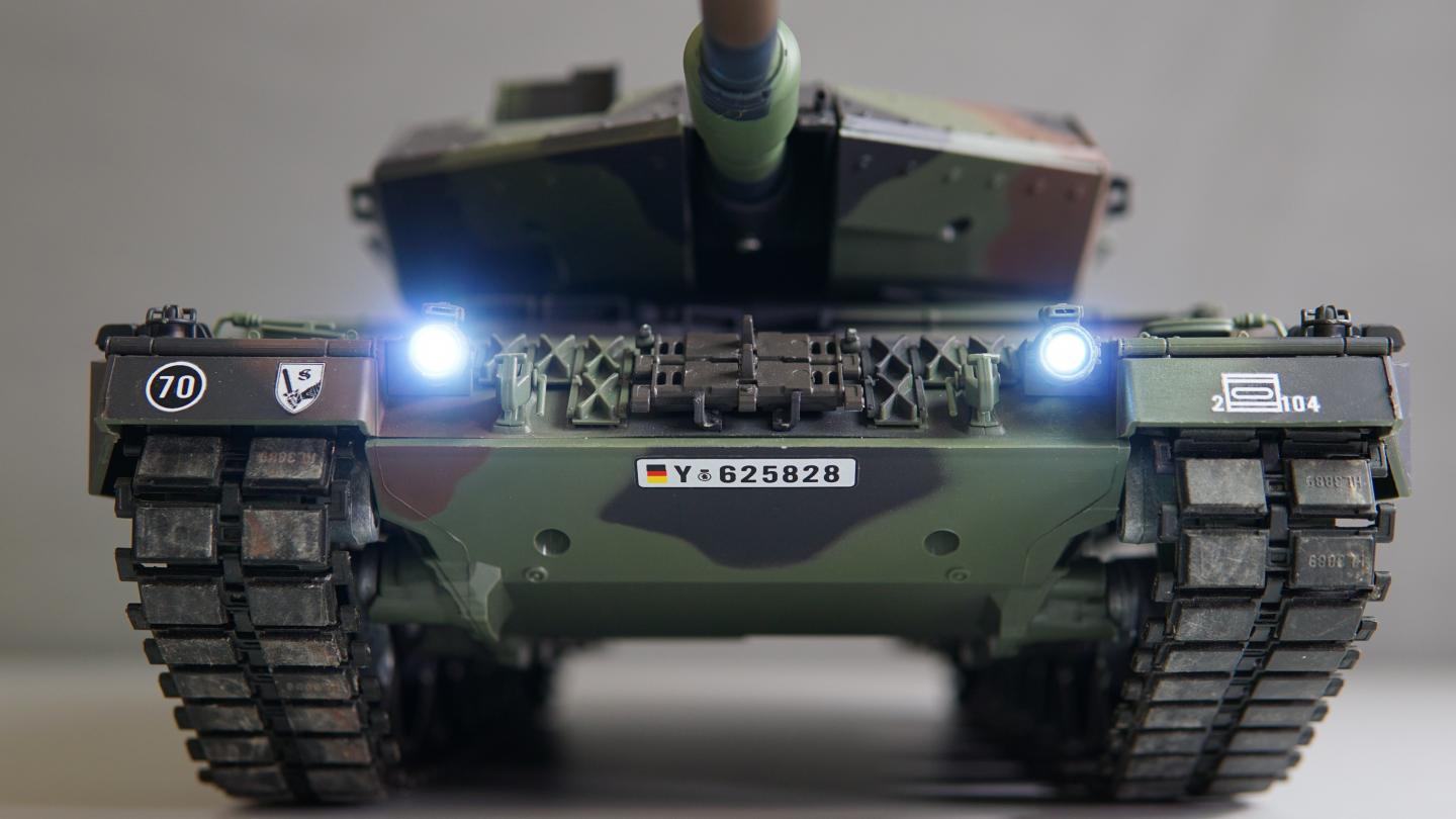

    Apply the decals, as desired, on a cleaned and dried surface, using the instruction manual's clear diagrams. These are simple "peel and stick" adhesive vinyl decals, NOT water slide decals, so do not soak the decal in water otherwise you'll ruin the adhesive. Stick the decal to the surface, then use the back of your fingernail to firmly burnish the decal onto the surface, then carefully remove the clear upper film off of the decal itself.

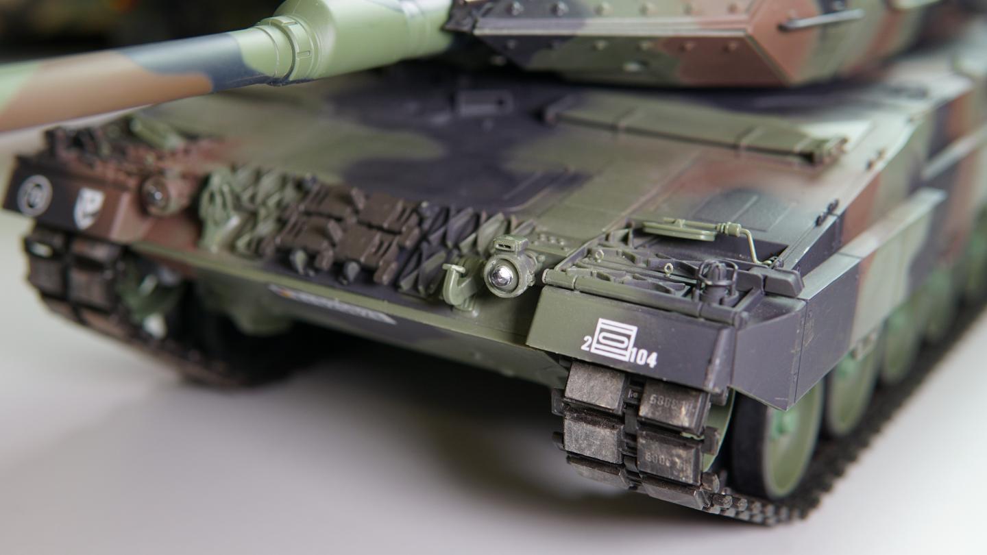

    Like many tanks, the Leopard 2A6 doesn't have many markings on it. But I think they do add a little pop of color and sense of scale.
    After applying the decals, you may want to seal them in with a clear coat such as a spray can of Testors Dullcote or WBPU ("Water Based PolyUrethane") from either Minwax or Varathane. I didn't apply a clear coat, but the decals continue to hold well to the surface, so I do not consider a clear coat absolutely necessary for casual use. If you do decide to apply a clear coat, always test under the tank first to ensure the colors do not react adversely to your chosen clear coat product.

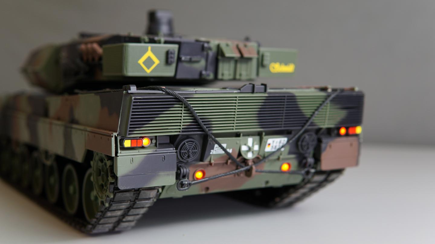

    The pre-installed LEDs look excellent, and together with the decal markings help breakup the three tone NATO camo scheme. It's not too flashy, and still retains the intimidating factor of this behemoth.

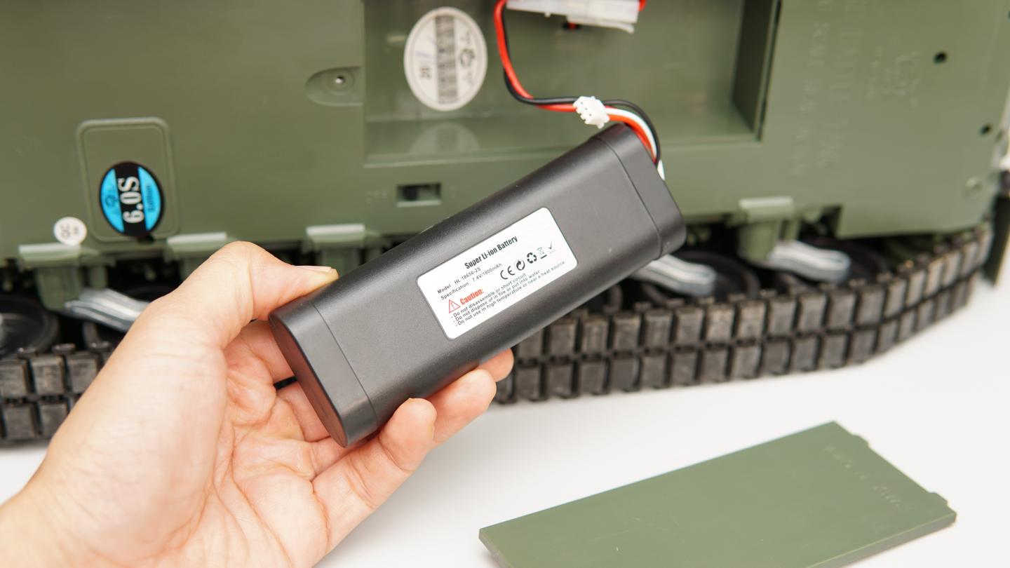

    Plug the battery back into the battery bay under the tank. I like how Heng Long designed the screw to always stay connected to the battery bay door, so it's impossible to lose that little screw. The 2s battery uses a Tamiya-style connector for main power, and also has a conventional three wire balance plug. I've found this to be convenient for checking the battery voltage with my battery voltage checker, just as I do with my larger airplane batteries. Heng Long's system will automatically shut down when the battery is depleted.

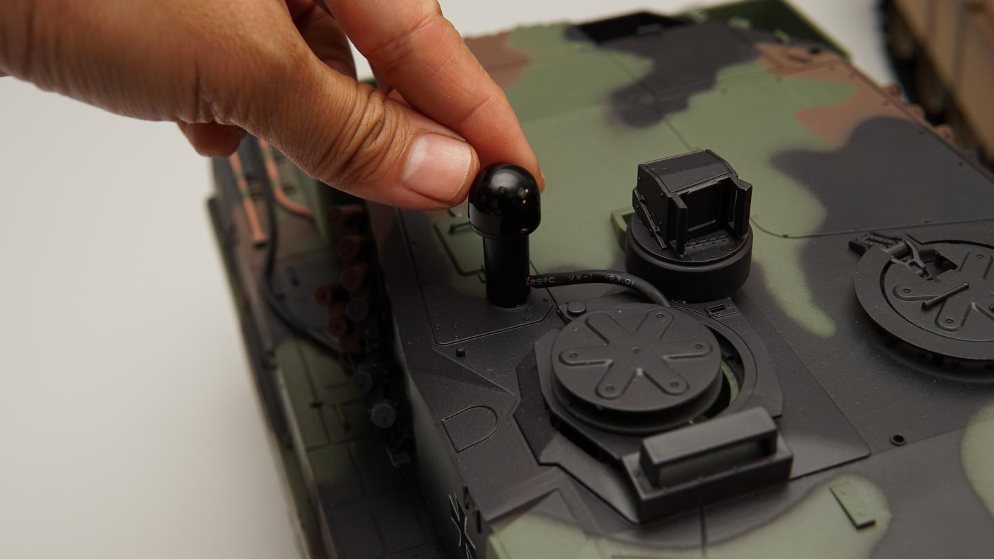

    If you plan on battling your friends with the included IR (infrared) system, plug in the IR apple and locate its magnetic anchor spot behind the hatch. Heng Long's magnets are concealed inside the turret and thus there isn't any unsightly mount visible from the outside of the turret. The IR apple is low profile, and reasonably sensitive in overcast conditions out to ~10-15 meters.

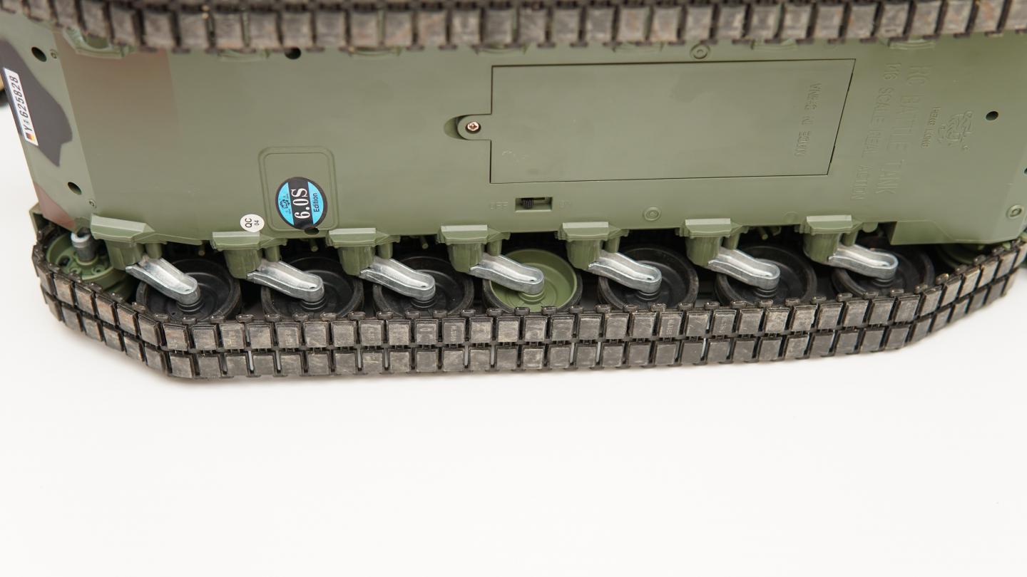

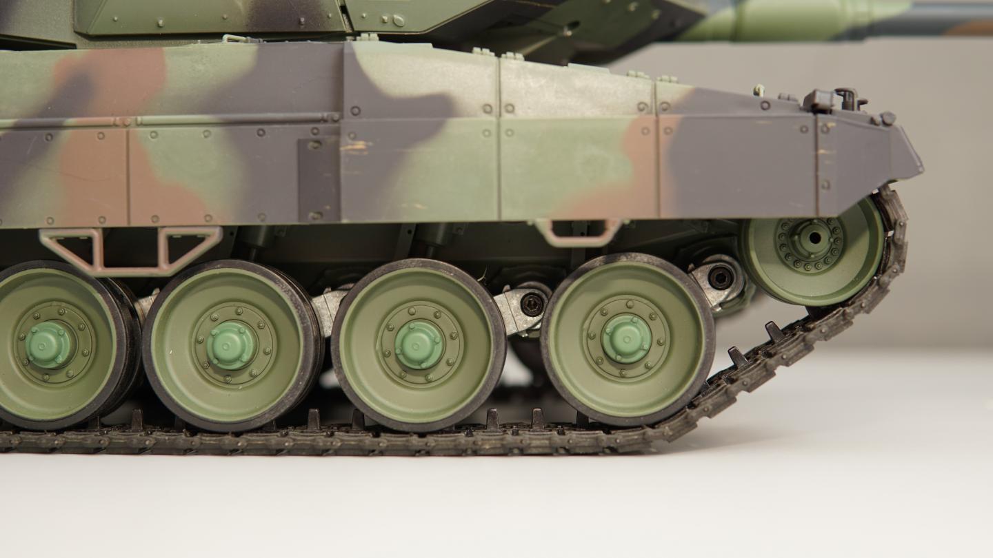

    As part of your pre-drive routine, inspect the suspension arms for any debris from previous use, especially if you run it outdoors in dirt or gravel. Check the suspension travel to ensure each road wheel moves smoothly. On the less expensive Original and Upgrade versions, the arms rotate on bushings, not bearings, so it is normal to have some play between the parts. However, excessively loose or wobbly road wheels or suspension arms should be tightened with a screwdriver or allen key before driving. For this reason, I do not recommend gluing the wheel covers on, but instead recommend relying on their tight press fit to remain attached. They will remain removable if in the future you ever needed to access the screw that connects the wheel to the arm for either tightening it or replacing it.
    Note that even the most basic version of Heng Long's Leopard 2A6 includes metal suspension arms and metal idler axle mount. I like that!

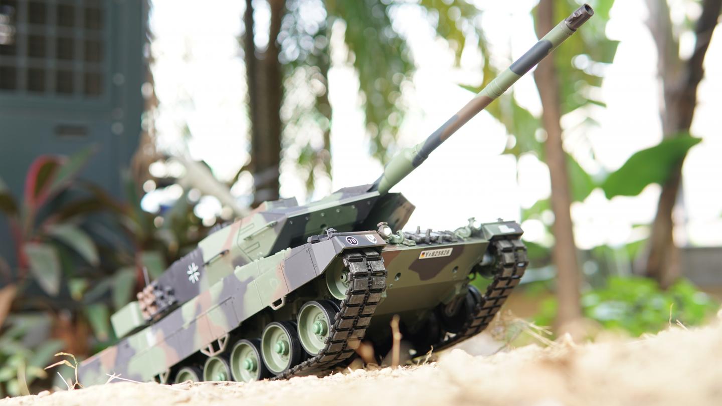

      Driving the tank is straightforward. The right stick controls forward and reverse, and left and right travel of the tank treads. The left stick controls the turret's traverse (side to side) and elevation/depression (up/down) of the main gun. The trick is to synchronize your movements so that the tank moves realistically, and points the gun as the tank moves in a different direction. All Heng Long tank turrets can traverse 320 degrees, and the barrel elevates and depresses through a range of 20 degrees or so. When you hear a "clacking" sound, the movement has reached its maximum limit and you must stop pushing the stick in that direction. Perhaps in the future Heng Long will be able to implement a limit cutoff switch.
      Refer to the manual for how to fire the machine gun, the main gun sequence, load 6mm BBs, and conduct IR battles. The TK6 also allows the user to program a range of features by means of pressing down a combination of buttons and moving one or the two control sticks. The amount of recoil can be adjusted higher or lower, the top speed can be set to two limits, the sensitivity in forward turns and reverse turns, and other actions are programmable in mere seconds. Out of the box, the Leopard 2A6's track recoil was too high for my liking, so I reduced it to the Low setting. The forward turning was too fast for my liking, more akin to an RC truck, so I reduced it down to turn more slowly and react to my inputs more sensitively like a real tank. RC Airplane pilots would recognize this feature as adding "Expo" or "Exponential". It's a neat feature that Heng Long has included in this latest generation of TK6 MFCB.

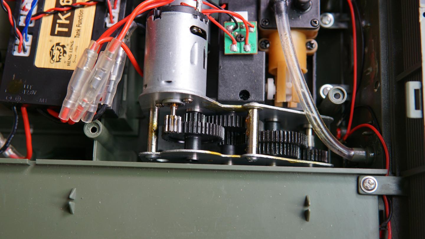

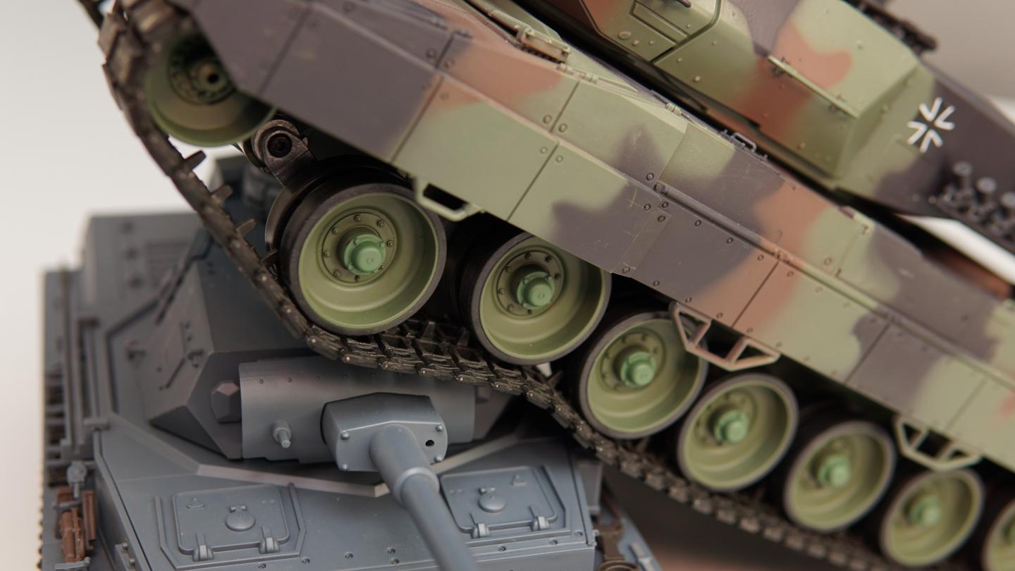

      Gears, Driveability, and Run Time
      The Upgrade version available from Motion RC does not use Zinc Alloy gears like Upgrade versions of years past. Rather, as of 11/2019, all of Motion RC's Upgrade version tanks include Steel gears, which are superior to the old Zinc Alloy gears in every way. While the remainder of the tank's running gear is ABS plastic, I prefer this Upgrade version because the steel gears in the gearbox are very durable, yet the plastic tracks keep the tank light and maneuverable. The Leopard 2A6 is already such a large tank that it has a good weight without extension metal parts. The Professional version replaces the plastic tracks, drive sprocket, and idler wheel with metal versions. This roughly doubles the weight of the tank from ~5+ pounds to ~10.5 pounds, and increases the cost as well, so I recommend the Pro version for tankers who don't mind having a shorter drive time or having to buy a couple spare batteries. The durability and heft of the more expensive Pro version will appeal to those who want weight above all other considerations. By contrast, for the average casual RC tanker wanting to save weight and cost, I think the cheaper Upgrade version is worth considering.
      The Upgrade configuration of the Leopard 2A6 can climb comfortably at 35 degrees with good traction. Like other tanks at the Upgrade level, the plastic tracks grip most surfaces well, although it tended to spin out sometimes on tile floor. On a hard dirt hill, the Leopard 2A6 climbed a 50 degree slope.
      Indoors, the sound is very loud, the LED headlight is bright, and the smoke is easily visible. Outdoors, the sound is still readily audible and the LED is also visible in daylight, but the smoke becomes difficult to see. This is just as well, since the real tanks weren't constantly venting smoke as if they were on fire, so I don't mind the reduced visible volume in daylight. The Leopard 2A6 has two exhaust ports, just like the real tank. Accessing them to refill the smoke oil isn't very convenient, but simply hold the tank's rear upward at a 45 degree angle and you'll be able to see the outlet tube partially concealed behind the exhaust grating.
      The stock battery is 2s 7.4v 1800mAh. With the smoke running, sound to maximum volume, and moving constantly, a big tank like the Leopard 2A6 will consume the battery in about 20 minutes. With scale movements and firing sequences, medium volume, and with the smoker turned off because it's not very visible in direct sunlight, I can stretch the battery to about 30 minutes or more. The much heavier metal tracked Professional version uses the same motor, so pulling much more weight decreases drive time. Buy extra batteries because they're inexpensive, or consider upgrading to the Admiral 2s 2200mAh or 4000mAh. The Heng Long battery bays, on all tanks except the T-72 and T-90, can fit much larger 2s packs such as the Admiral 2s 4000mAh. 2s is the maximum recommended limit for the stock components.
      Click image for larger version  Name:	DSC09774.JPG Views:	0 Size:	123.0 KB ID:	220778

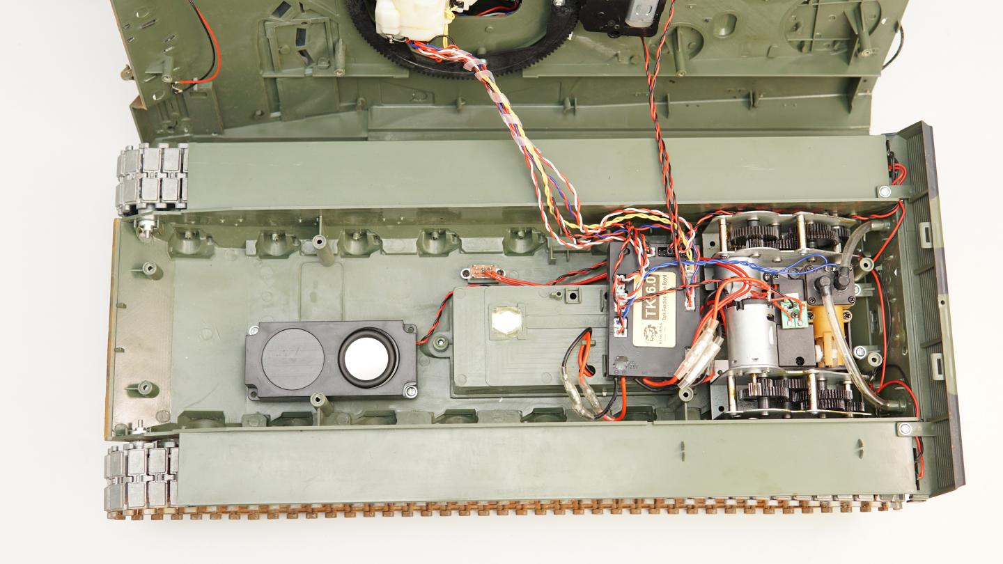

      Upgrade path and "Wrenchability" --how easy is it to service, maintain, and upgrade this tank?:
      Speaking of the TK6 MFCB, I was pleased to see that it has several unused ports. There is a brake light port, and also turn signal ports. There is even a "Main Cannon Barrel LED" port, that flashes in sync with the cannon sound. If you were okay with running an LED into the barrel and cancelling the airsoft BB firing function, you could within minutes have a neat simulated "flash" at the tip of the barrel every time you fired the main gun.
      In terms of overall ease of working on the Leopard 2A6, like its fellow "big tanks" the Abrams and Challenger II, I'd give it a 10 out of 10 because its hull and turret are both very large. This makes accessing the tank's internals very easy, and there is a lot of space for adding a larger speaker, for example, or implementing a recoiling barrel or other DIY upgrades.

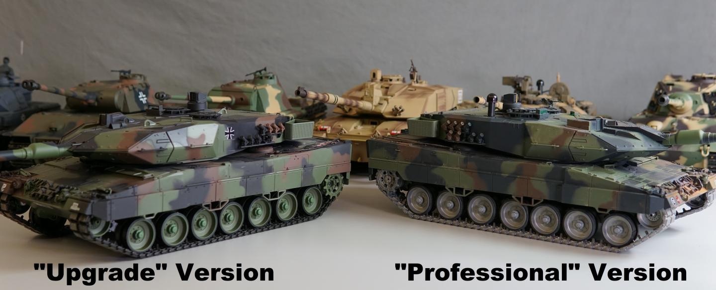

      As mentioned previously, my Leopard 2A6 is the "Upgrade" version, meaning its exterior components are all plastic, while the gears in the gearbox are steel. I find this to be a great balance between cost, driveability, and weight. The more expensive "Professional" version features metal tracks, road wheels, idler wheel, and drive sprocket --essentially all the moving drive system parts outside of the tank--. This significantly increases the weight, which some tankers may enjoy, and also the durability in certain conditions, but the trade-off for this weight gain is lower drive time. For anyone operating the heavier Professional version, I recommend buying a spare battery.
      The metal parts also arrive unpainted, making it easy to visually distinguish in product photos which version is which. If the road wheels are green and the track is black, they're plastic and that's the Original or Upgrade version. If the road wheels are metal colored and the tracks are as well, then they're metal and that's the Professional version. The metal wheels would need to be painted by the user, if he/she prefers. I know I do!

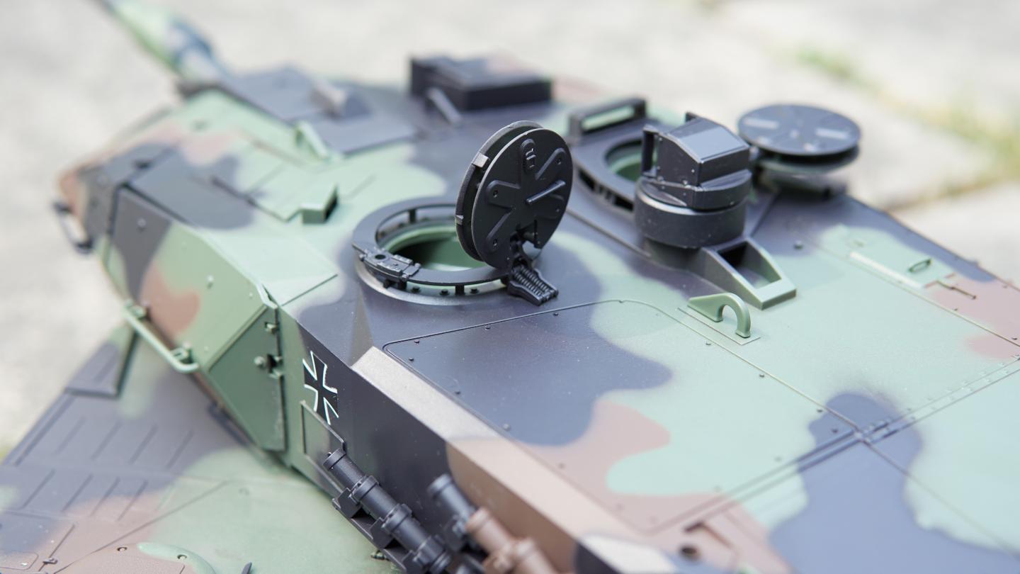

        Several sprues of plastic parts are provided for the modeler to install on the tank to enhance its overall scale appearance. These all plug into pre-drilled holes, and are nearly "snap fit". A few of the parts were loose, so I bonded them with ABS glue. But otherwise, I prefer to keep the parts unglued so they're easy to remove or replace if needed in the future. Installing the plastic "accessory parts", including the smoke grenade launchers, bustle bins, tools, rear view mirrors, and many grab handles, took about 45-50 minutes from start to finish. Plan for an hour if you want to take your time cutting the parts out of the plastic sprues. I recommend a sharp clipper designed for this purpose, as it makes cleanup much easier. The accessory parts are pre-painted as shown below, and really enhance the tank's overall surface detail, as can be seen on the engine deck.

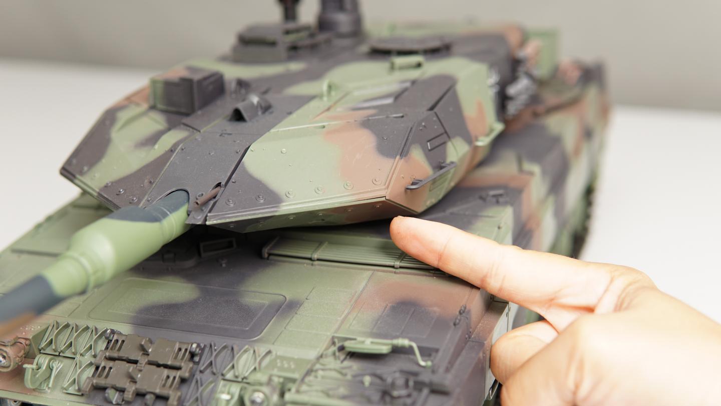

        A subtle but important advancement is Heng Long's inclusion of raised "non-slip" surface detail on certain areas throughout the tank, which adds more scale realism than the Abrams, which omits such a detail.
        There are some limitations inherent with this price point, however. The implementation of the Leopard 2A6's taillight cluster is simplified for RC drivers but at the cost of less realism for scale enthusiasts. The bustle bins are also the most visible scale aspect that distinguishes the Heng Long from a Tamiya, because the Heng Long example is molded from plastic with softer detail. Also, the Leopard 2A6 lacks clear vision blocks, as does the Abrams. I rectified this by adding clear plastic sheet salvaged from a yogurt container.
        Finally, the blue decals provided to depict the Doghouse and CITV "glass" elements were left off my tanks because I think they look unrealistic.

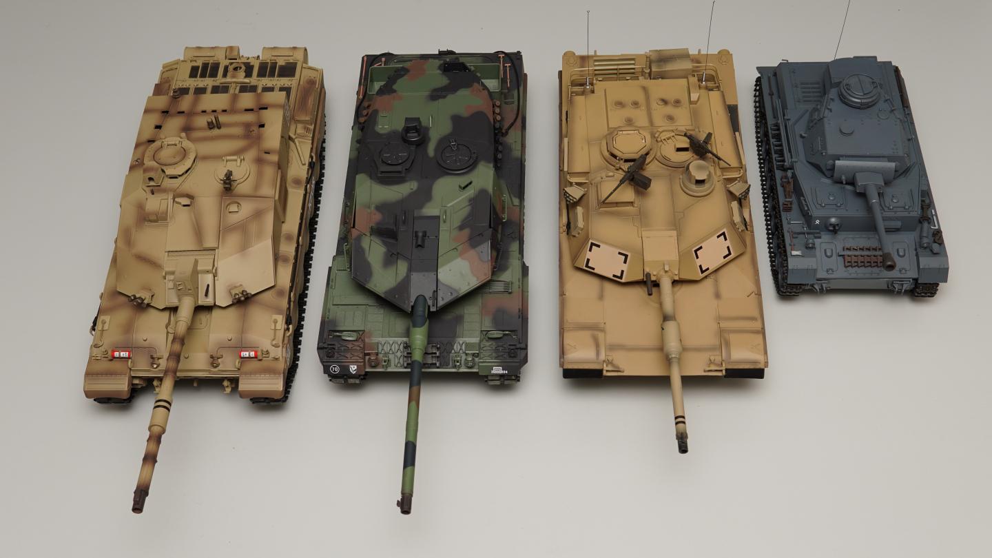

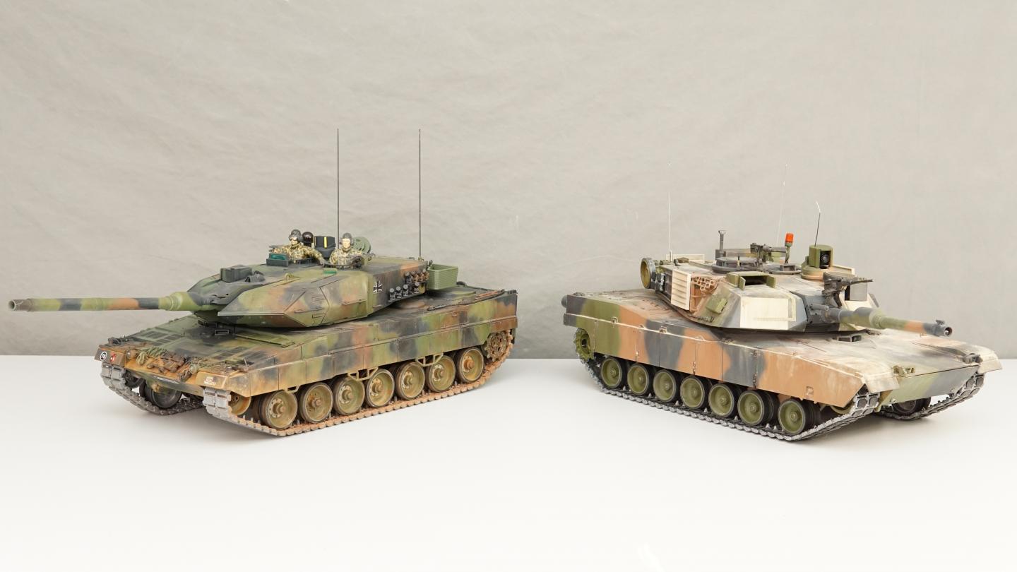

            Agreed. What's also amazing to me is how the MBT-70 program, which originated in the late '60s with the West Germans and Americans collaborating to construct the next generation of main battle tank, eventually gave rise to the M1 Abrams and the Leopard 2, both of which remain front line platforms and are slated to remain in service for another 15 years. To have a machine in service for 60+ years says a lot for the original "bones". Although they initially struggled over whether to design in metric or imperial, eventually both sides got a solid tank out of their respective offshoot programs.
            I also find it interesting that the Abrams fires a licensed version of the German Rhinemetal 120mm L55 cannon, which is what the more recent iterations of Leopard 2 fire as well. Shared munitions, shared heritage, similar fundamental approaches, yet two distinctly different tanks. I need to finish weathering mine...

              Another interesting point about the 120mm cannon shared between the Leopard 2 and A2 Abrams is the longer barrel used on the later models of Leopard 2. Why is it longer many people ask? The simple answer is that the Germans are a "non nuclear" arms country and is such will not use Depleted Uranium (DPU) metals in their anti tank "heavy armor" penetrator rounds like the U.S and other NATO countries. Instead they still use a Tungsten based metal. So to achieve similar performance of their penetrator rounds they lengthened the barrel by almost a meter. Longer barrel = higher velocity = more energy = greater penetration.
              The problems with this longer barrel are one, that the Leopard 2s equipped with it cannot fire the 120mm U.S. or similar made rounds as the ballistics are far different and the Leopard 2 fire control computer is reported not to be able to adjust for the difference. The same goes for the A2 Abrams firing the rounds intended for the longer barrel. The second problem is the barrel is so long it greatly increase the difficulty with maneuvering the tank in the already tight terrain environments of the European landscape like the typical old world villages, large cities and dense forest. Third and to a lessor degree for the German army is transport by air. Because of these draw backs it is common to see other countries that use the newer model Leopard 2 using the "original" shorter barrel as used on the A2 Abrams as it allows for the use of U.S. and standard NATO 120mm rounds yet does not add to the maneuvering issues.
              With regard to the Heng Long Leopard 2 and using it in IR battling the issues of the longer barrel is clear and it is a harder tank to fight effectively with. The Heng Long Abrams with its shorter barrel yet similar overall size is an easier tank to maneuver in a simulated city scape or heavily brush laden battle field. It is not uncommon to see modified "shortened" barrels on Tamiya and Heng Long Leopard 2s that are used in IR battling, these typicaly represent non German army late model Leopard 2s.
