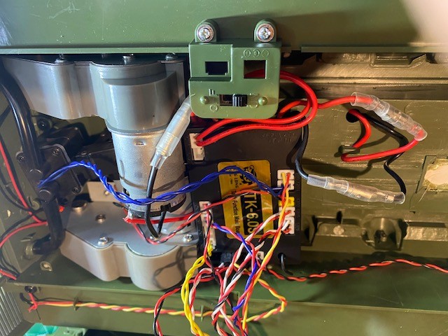

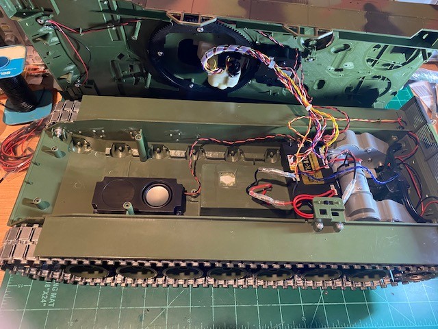

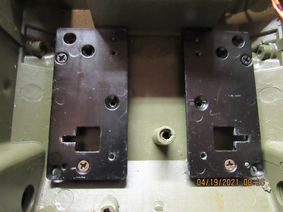

                I received my Heng Long German Leopard 2A6 RC tank a month ago. I got the "promotional version" which seems to be mid way between the Upgrade version (all plastic external) and the Professional version. It has the following metal parts:
                1. Steel gears driving gearbox
                2. Tracks
                3. Sprocket wheels
                4. Idler wheels
                5. Barrel

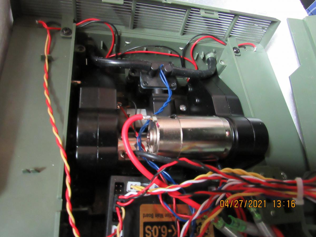

                The road wheels are plastic and it got the weak grey 380 motors. The gearbox is the all steel (non-ball bearing) normal version. It gets a grey plastic cover that I did not see before.
                Click image for larger version  Name:	IMG_1320.jpg Views:	0 Size:	113.6 KB ID:	310598Click image for larger version  Name:	IMG_1319.jpg Views:	0 Size:	97.2 KB ID:	310599

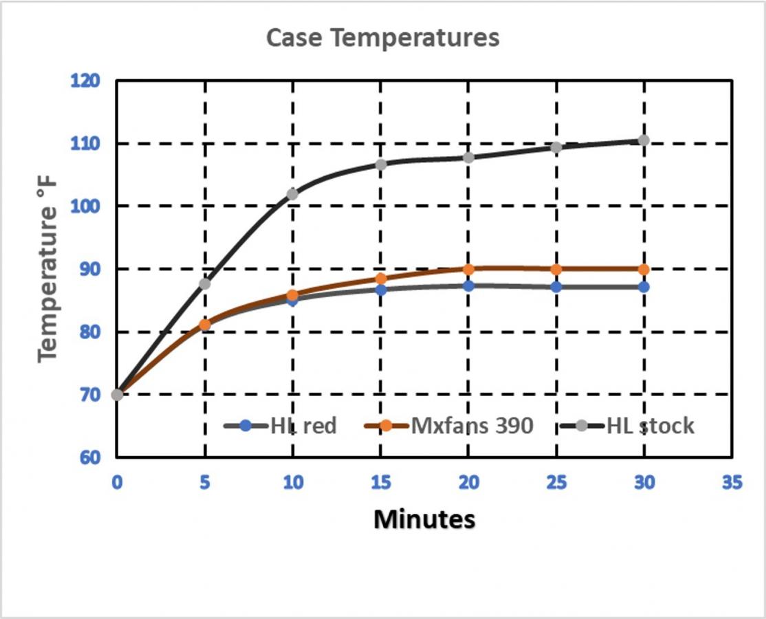

                The little motors run quite hot at 40°F above ambient. It stabilized at 110°F in the 70 deg cool basement. It is not what I would like when running the tank outdoor at 90+ temperature. However, it does give the Leopard decent road speed.

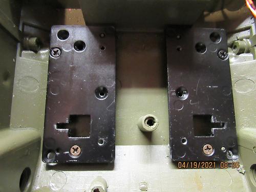

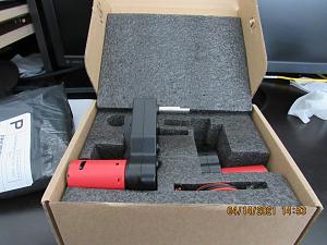

                I did a quick upgrade with the excellent Heng Xin all ball bearing gearbox. You may notice that I did not use the red motors. The motors are Fxfans 390 motors which have identical performance to the red motor. I just like the electroplated case better.
                Click image for larger version  Name:	IMG_4980.JPG Views:	0 Size:	105.0 KB ID:	310600Click image for larger version  Name:	IMG_4962.JPG Views:	0 Size:	132.5 KB ID:	310601Click image for larger version  Name:	IMG_4964.JPG Views:	0 Size:	121.7 KB ID:	310602
                Click image for larger version  Name:	390casetemp_leopard.jpg Views:	0 Size:	73.0 KB ID:	310603
                The Heng Xin gearbox uses 8 DGB (deep groove bearing). It is very quiet and vibration free. The 390 motor has plenty of reserve power to drive the metal tracks. This gearbox costs about $90 for US stock and about $65 if you can wait for shipping from China. It is one of the best upgrade investment I made.
                With the TK-6.0S RC system, the proportional control is a large improvement over the 5.3 version I had on older tanks. Overall, I am happy with this purchase.

                    I like one of the fringe benefit of the Heng Xin gearbox. The mounting plate is a good strengthening of the factory mounting. The gearbox ships with M3-6mm counter sunk screws which is way too short. I use M3-12mm ones. Counter sunk screw in small metric size are hard to find in hardware store. I found mine at Amazon and got a whole box of various length for only $8. You can use 4 counter sunk self tapping screws and one machine screw for each side of the plate/box. The gearbox is now much sturdier than the original HL scheme.
                    Click image for larger version  Name:	IMG_4968.JPG Views:	0 Size:	162.5 KB ID:	310812

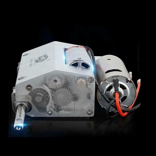

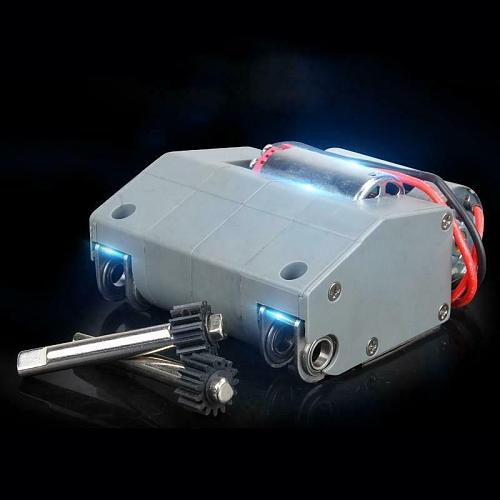

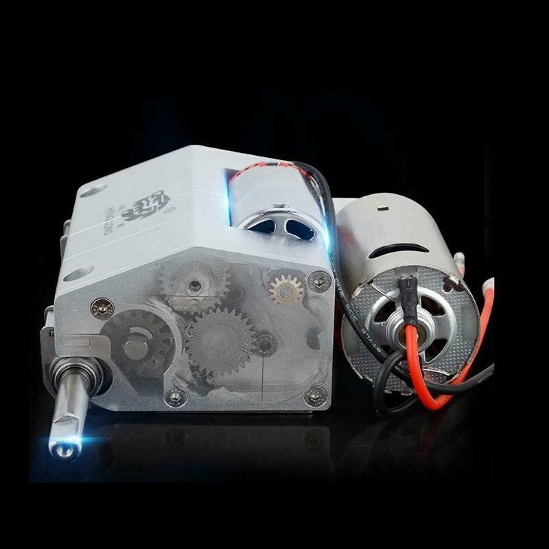

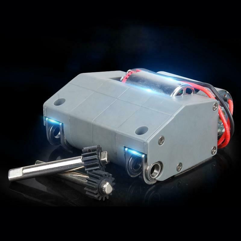

                            I saw this Heng Long driving system for the Leopard II. Has anyone bought one? It shows on the box that it is for the top 1% Leopard tankers :-)
                            It is quite cheap, lol :-(

                                Yes they are quite good. Smoother and quieter. But overall do nothing more then what the stock steel gearboxes equipped with upgraded 390 motors can do.
                                Oh and it can be used in most HL tanks NOT just the Leopard 2.

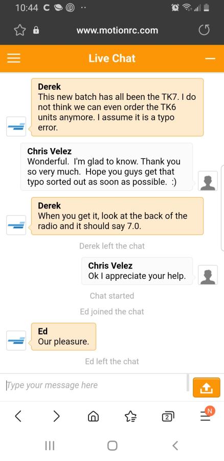

                                    Can anyone confirm if motion is currently stocking the tk7? I ordered a t90 with the latest generation tk7 and the description said "All of Motion RC’s Heng Long 1/16 scale tanks utilize the latest TK7 MFCB for outstanding control, performance, playability, and upgrade potential!"
                                    I immediately ordered a leopard. Today I read on the description of the leopard that its a TK6. I think they are sending 7.0 but haven't updated their description to state the leopard is running the latest TK7. Maybe. Hopefully.
                                    I wouldn't mind either way but I prefer the engine idle sound of the TK7 over the TK6. The TK6 has a repeating audio file that will drive me insane lol.
                                    Anyway I will reach out to them but figured someone here may know.
                                    • Woohoo\o/
                                      • Feb 2020
                                      • 186
                                      • Cape coral Florida
                                      #38
                                      Just got the info I needed from live chat. In case anyone in the future may find this helpful.
