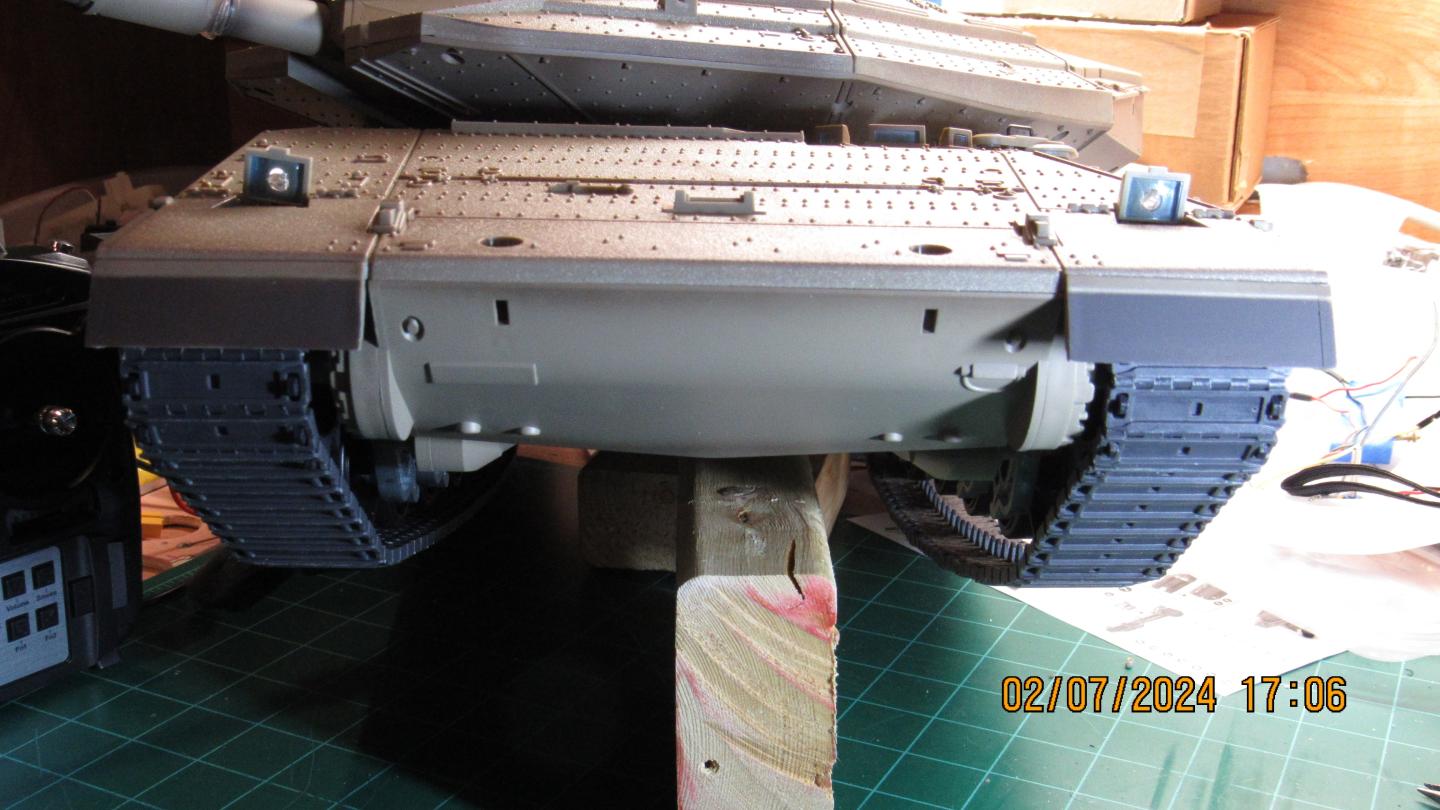

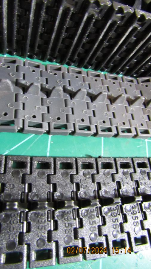

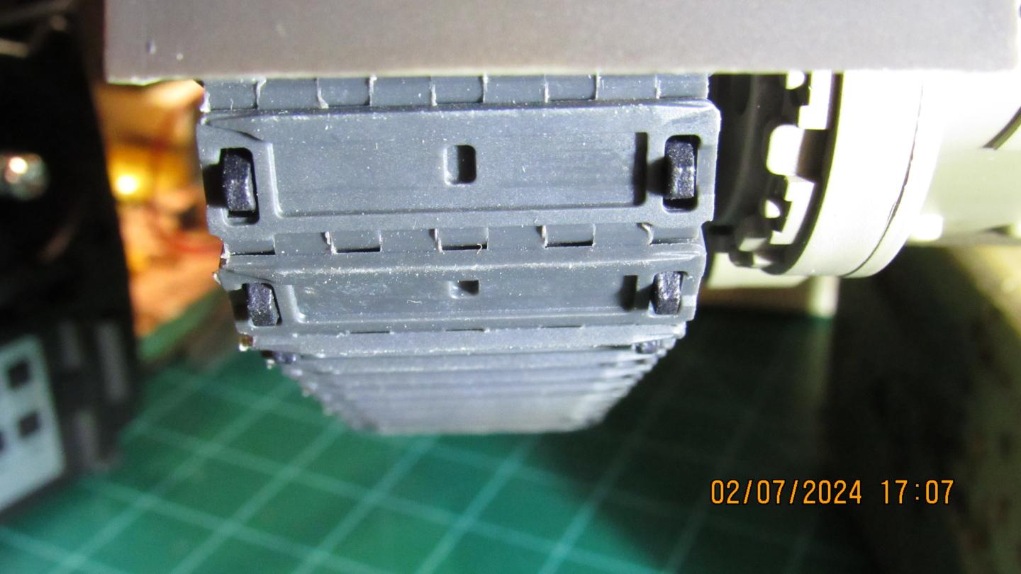

    For the Merkava, I thought you used the hooben track that I have, as I am not aware of torro making any Merkava parts. And you had to purchase their brand sprockets as well as they do not fit the henglong sprockets
    You are right on all counts. I have the Hooben sprocket and tracks and like them very much.
    The Hooben track has different pitch than the HL track and needs the Hooben sprocket to work properly. The Hooben spindle is a double D shape, so is the Hooben sprocket hole. It is not difficult, but tedious to make the nylon sprocket hole single D to match the Heng Xin drivebox axle. I used a 4 volts rotatory tool and some small files for the job. I worked slowly to assure a slug fit.

    Your point is well taken. It reminds me of the effort I made to adapt the Hooben nylon track and sprocket to the HL IDF Merkava. I am obsessed with a closed pin track and Hooben is the only game in town. While not a drop in replacement, I actually enjoyed the half day work that makes it possible.
