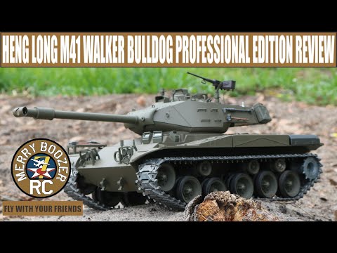

    So let’s talk professional bulldog. I’m about two months into owning the bulldog and this tank is becoming my favorite of the three I have access to. Something about the way this tank looks and the suspension really set it apart from the others I have played with. The BB gun is super powerful and the tank has no problem driving in the grass unlike my two upgrade edition tanks (as expected). Check out the video I really tried to put it through it’s paces and show how capable this tank is.
