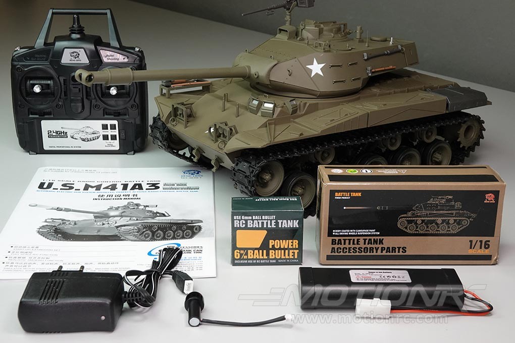

    What's In the Box:
    As an RTR or "Ready To Run" RC model, everything is included in the box except six AA batteries for the radio transmitter. In areas where shipping liquids is restricted, the glycerin used for the "smoke effect" is absent, but can be found locally at hardware or convenience stores that sell glycerin oil.
    The radio, tank, cosmetic accessory parts, tank battery, tank battery charger, and plastic BBs, don't require any "assembly", other than installing the aforementioned "cosmetic accessory parts". A nicely printed manual is also included with clear diagrams for locating the cosmetic accessory parts, programming/adjusting the radio's settings, and bevy of warnings. The charger and battery are not shown here because they are being used off camera.
    Click image for larger version  Name:	DSC09549.JPG Views:	0 Size:	118.7 KB ID:	222511
    Initial Two Minute Function Test:
    Because the tank itself is functionally complete and it doesn't require the cosmetic accessory parts to run, I recommend testing your tank's basic functions immediately after unboxing the tank, before you install the cosmetic accessory parts. If there happens to be any problems, it is better to report them to Motion RC for warranty support before the tank has any cosmetic parts attached to it.
    To conduct this initial two minute test, insert six AA batteries in the radio and turn it on. Plug in the tank's included 2s battery and slide the tank's switch to On. The radio and tank are already "bound" to each other via 2.4Ghz signal, so simply press the Key button on the radio and your tank will activate. Move all the tank's controls in every direction to evaluate their function. Refer to the Manual for all controls. Note that the turret and cannon barrel will produce a "clacking" sound when they reach their maximum travel points. This sound is normal and is a warning for you to stop moving it in that direction. Importantly, DO NOT run the tank more than two minutes for this initial test, since it arrives with only a storage charge.
    Once satisfied that your tank is operating normally, plug the battery into the included wall charger. While it's charging, turn your attention to the installation of the "cosmetic accessory parts", covered in the Details section, below. Installing the cosmetic parts onto the exterior results in this:
    Click image for larger version  Name:	BulldogIncludes.jpg Views:	0 Size:	148.8 KB ID:	222513Click image for larger version  Name:	DSC09561.JPG Views:	0 Size:	70.9 KB ID:	222510

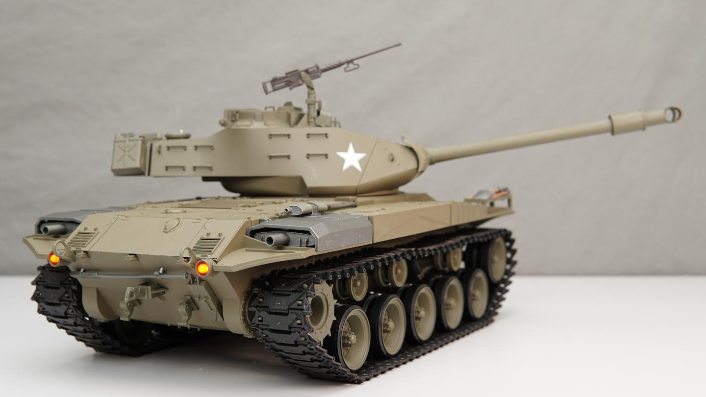

    Exterior Quality:
    The Bulldog is primarily composed of ABS plastic, and is painted evenly with a matte olive drab. The exhausts are painted metallic silver, and the plastic tracks on my Upgrade version is molded in very dark gray that looks almost black.

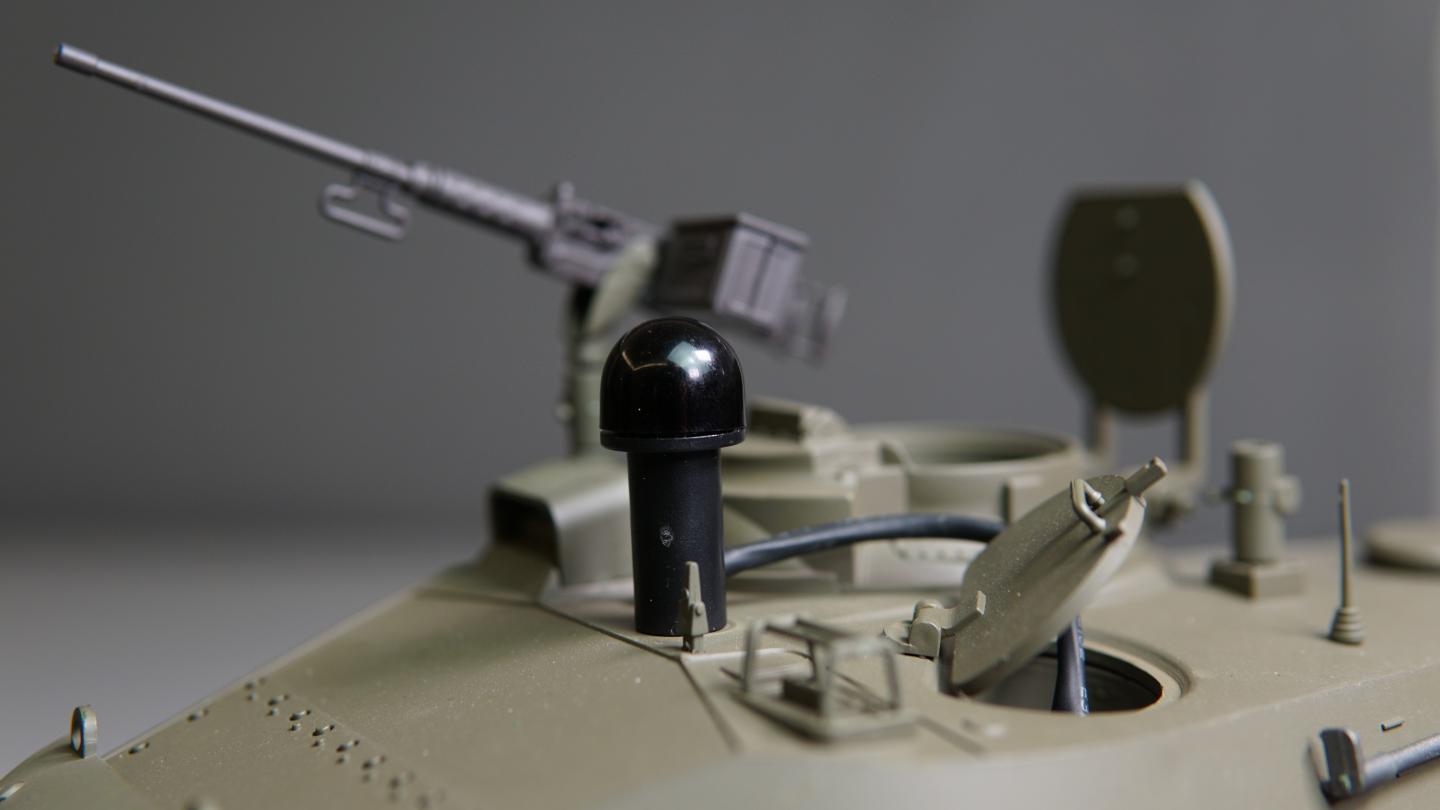

    Details:
    Several sprues of plastic parts are provided for the modeler to install on the tank. These all plug into pre-drilled holes, and are nearly "snap fit". A few of the parts were loose, so I bonded them with ABS glue. But otherwise, I prefer to keep the parts unglued so they're easy to remove or replace if needed in the future. This installation process can be completed in 30-60 minutes depending on your pace. The many handles along the turret side faces and the machine gun on its AA mount are some of the details that enhance the Bulldog's appearance.The lights look great, also:
    Click image for larger version  Name:	DSC09565.JPG Views:	0 Size:	73.7 KB ID:	222512
