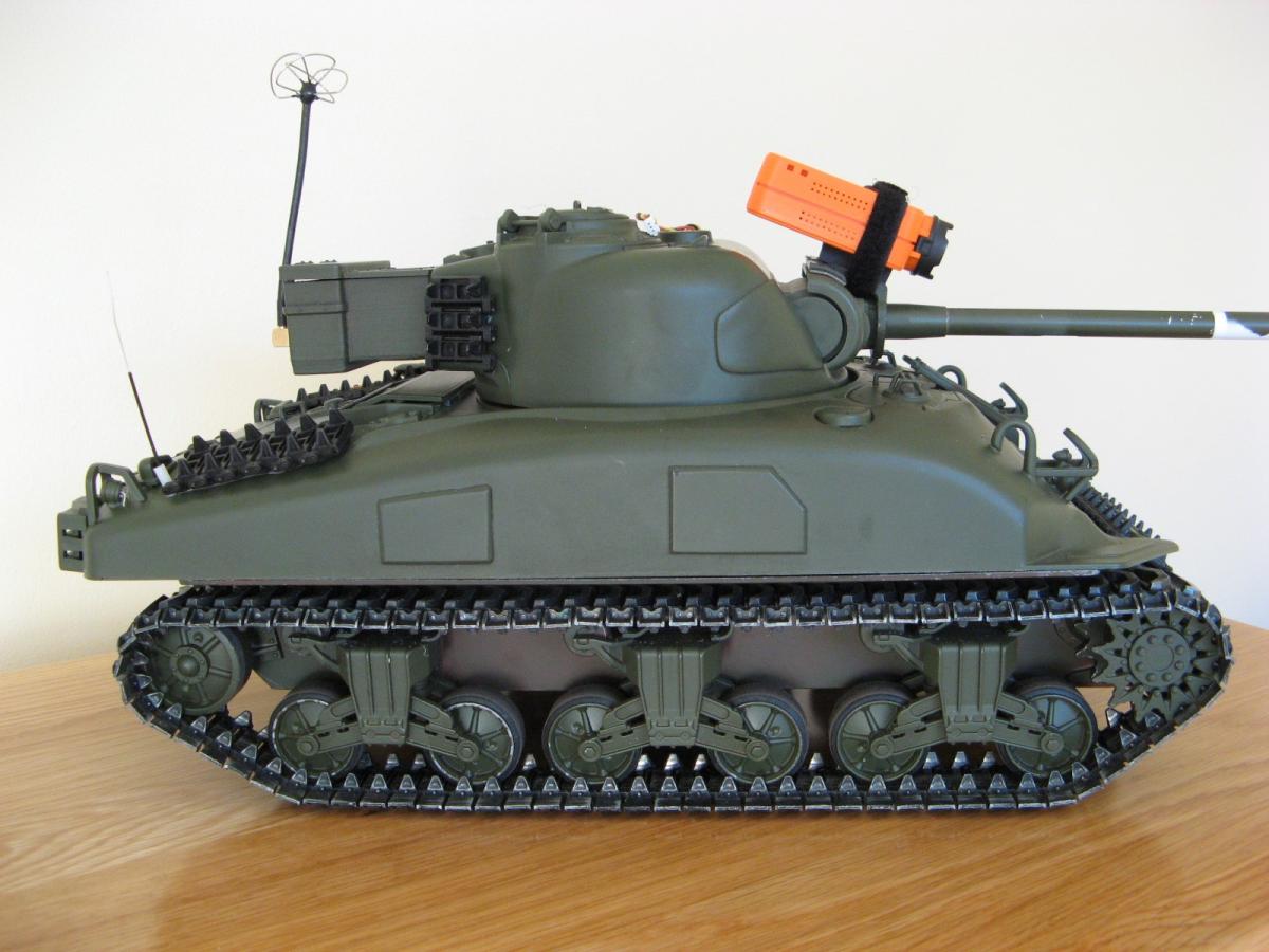

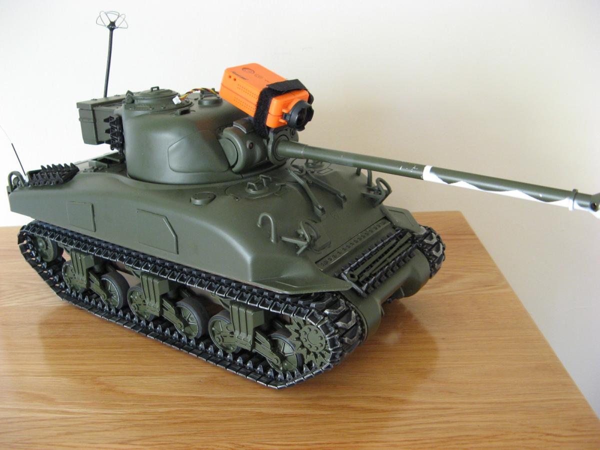

                                  Just in case anyone is thinking of going FPV here's a couple of videos. First one is with the mic's inside the turret and video taken from goggle DVR.
                                  2nd is with the mic's taped to the outside of the turret
                                  3rd is direct from the Runcam2 SD card, I can't show you the FPV feed from the R2 as both my VTX harnesses are in use on my two FPV trucks.
                                  • Arcright
                                    • Mar 2020
                                    • 16
                                    #18
                                    Drawback of the Runcam2 is the size and colour, good news is there is a new 4k version out ?
