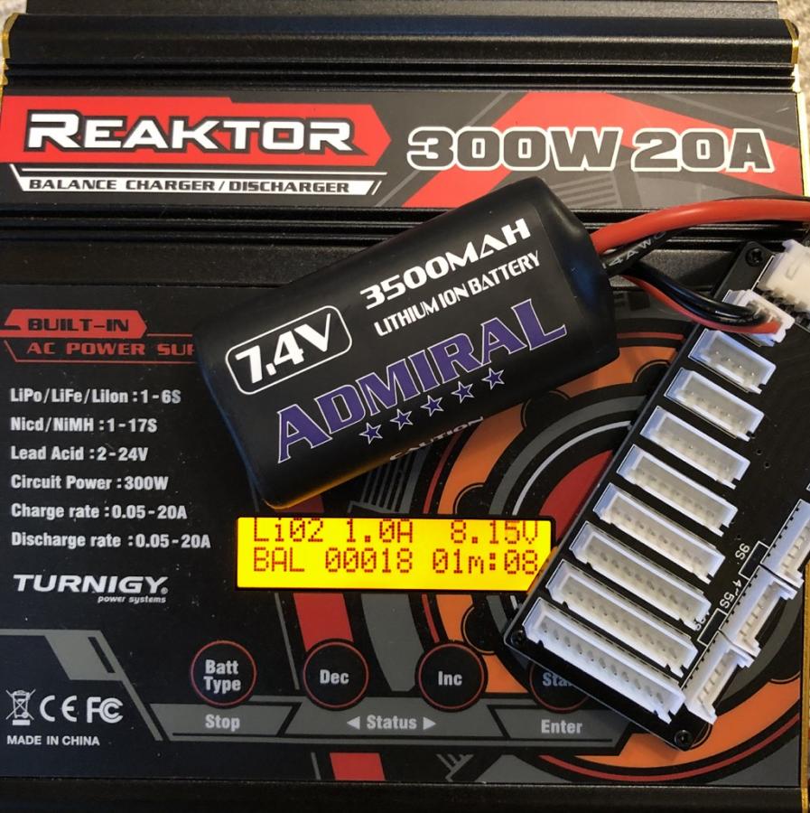

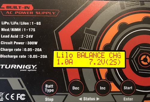

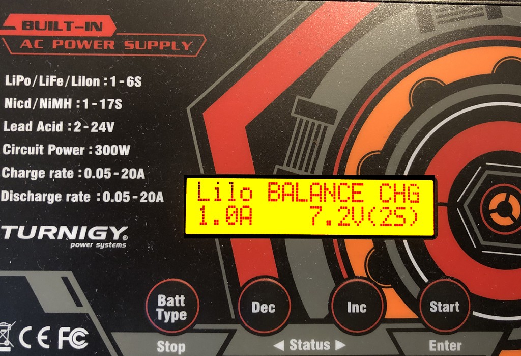

    Yes. Lilo is the correct battery selection. I use my Turnigy Reaktor Quad and Single 300W chargers to charge my Li-ion tank batteries. I charge at 1amp just to be on the safe side and with the balance lead connected it knows how many cells.. So far I haven't any of them blown up ...:flushed:
    This is my setting for the Admiral 3500mAh Li-ion pack before charging:
    Click image for larger version  Name:	LiionCharge1.jpg Views:	0 Size:	210.1 KB ID:	257805

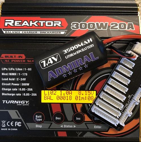

    This is during charge:
    Click image for larger version  Name:	LiionCharge2.jpg Views:	0 Size:	133.3 KB ID:	257806
    I should be getting the new Admiral 7000mAh Li-ion pack in the next day or two so I can see how they look. I just read that max charging current for Li-ion is 0.8C which would be 5.6amps for the 7000 but that spooks me and I don't want to blow my new batteries. I'll probably stick with 1 or 2 amps unless someone tells me different. I have the time so I can be gentle with my batteries..

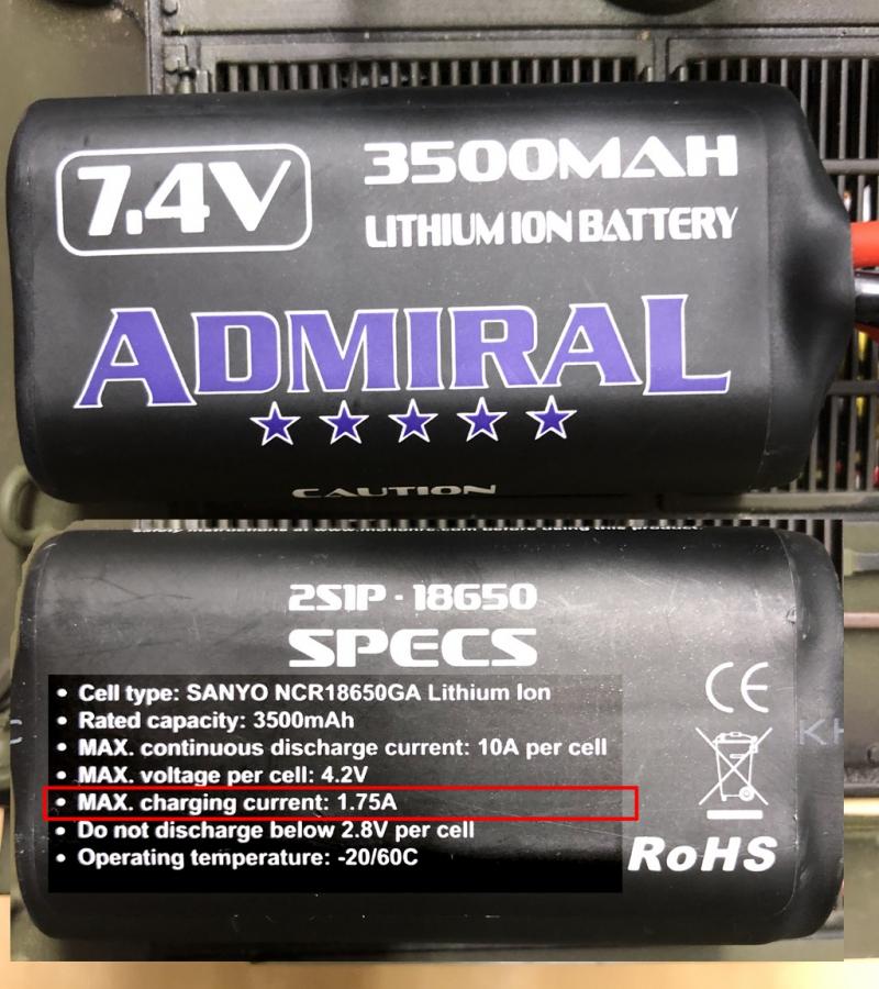

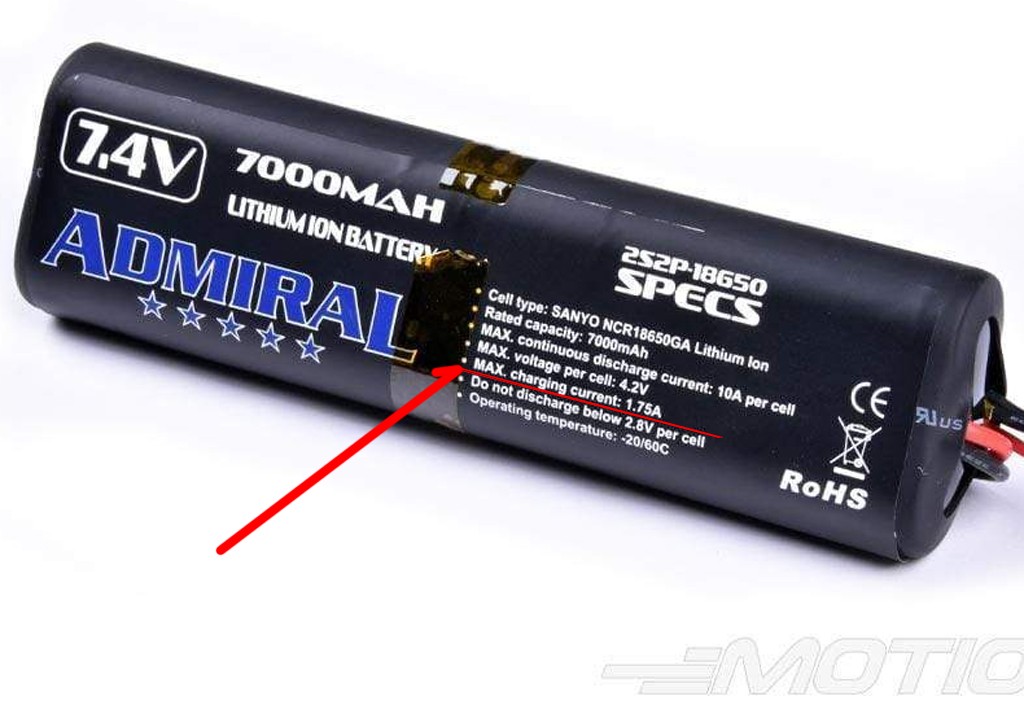

        I guess if I wasn't such a guy I'd have read the back of the battery! LOL!
        Click image for larger version  Name:	Admiral3500ChargeCurrent.jpg Views:	0 Size:	101.4 KB ID:	257812
        The new 7000mAh batteries have the text right on the front! Doh...!
