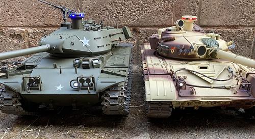

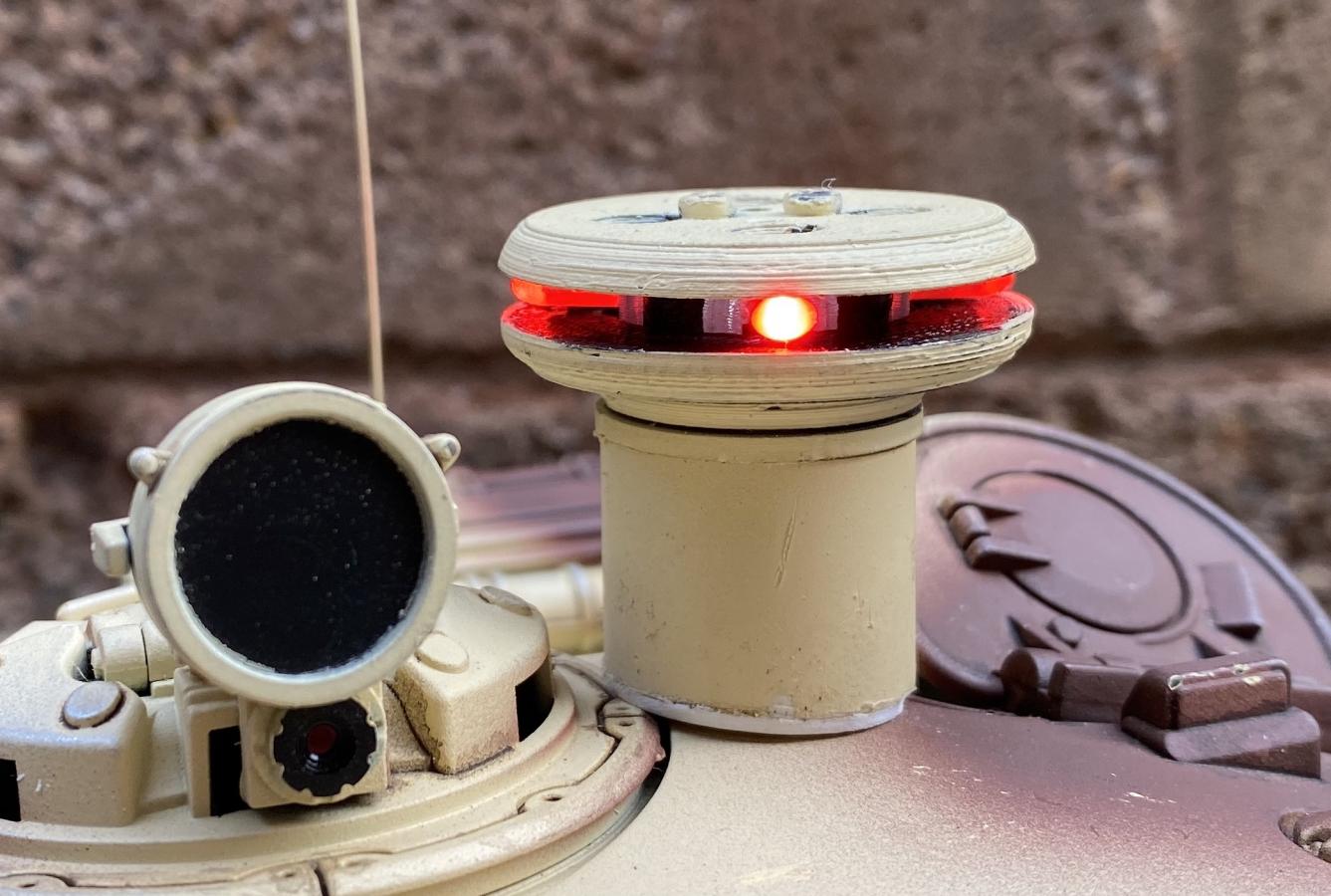

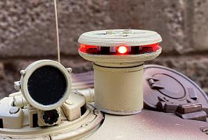

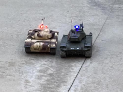

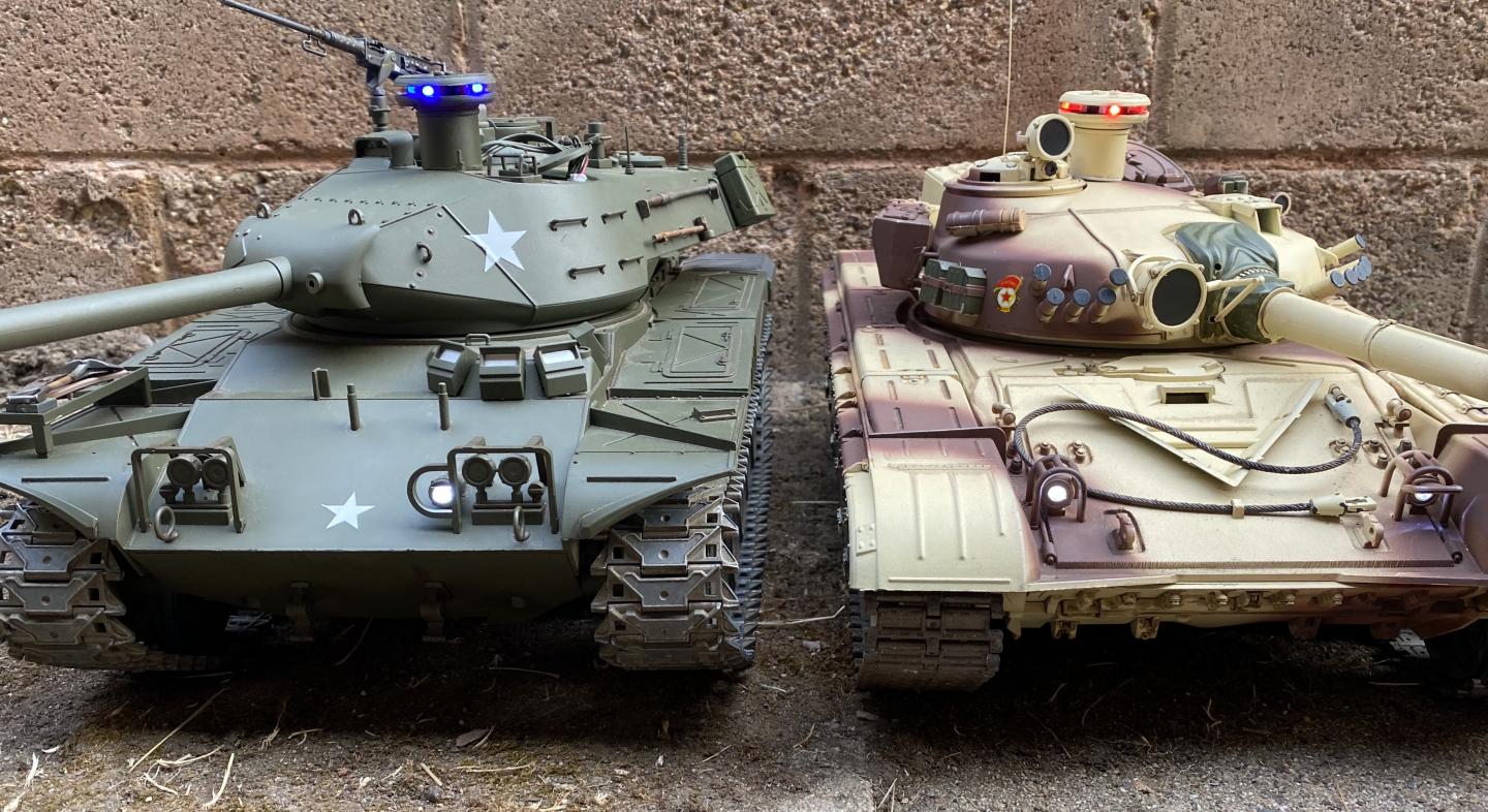

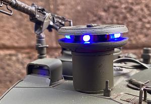

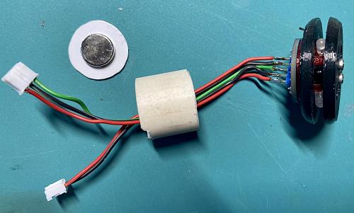

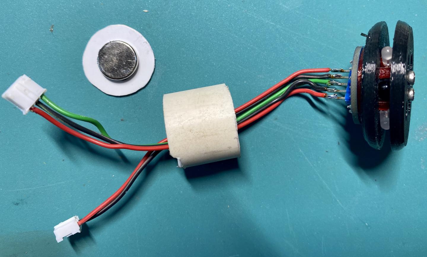

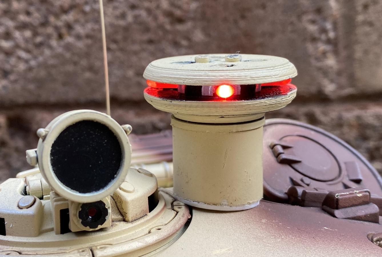

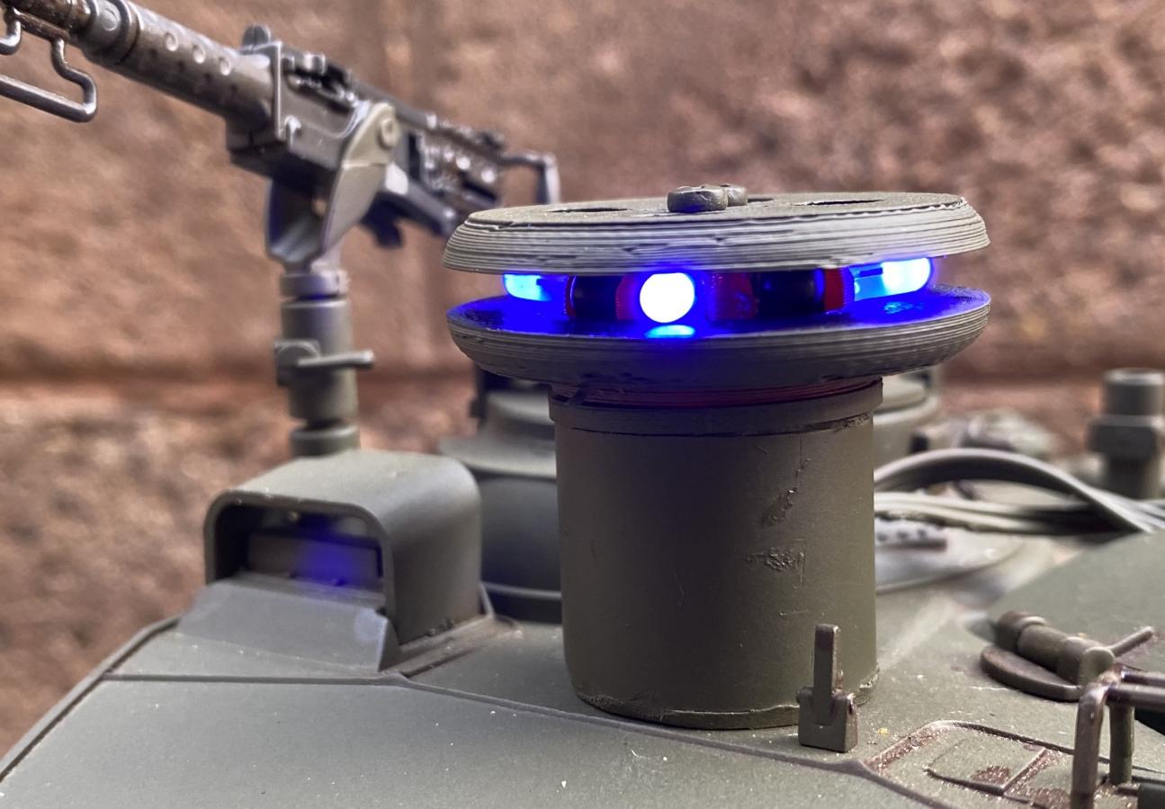

              I now have two receivers mounted on my tanks. What an improvement! I tested reception at 45 feet separation, one in sun, one in shade. Both worked flawlessly. The stock receivers worked intermittently at 6 feet in the same light.
              I made my own mounts from PVC pipe, card stock and rare earth magnets. Although LegoDEI provides cabling with Dupont connectors to hook up both the sensor and the lights to the main board, I chose to solder wires directly to the unit, and used three-line and two-line JST-PH connectors to make it easier to take them on and off.
              Both are the new versions where the LED's are mounted horizontally so the lights are more visible from a remote operator's position. I got one red and one blue for comparison. The following pictures were taken in indirect outdoor light. The headlights are on so you can assess the brightness. Later I may take more pictures in noon day sun at a distance. I'm guessing the red may be more visible, but we'll see.
              Red on the T-72:
              Blue on the M-41
              I made the mounts so as to put the sensors at the same height as the stock units.

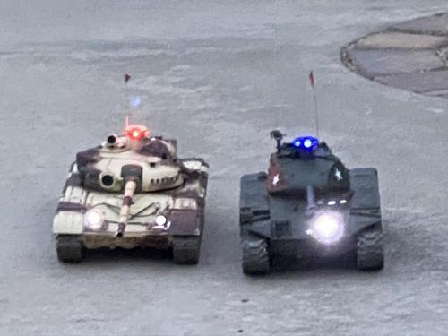

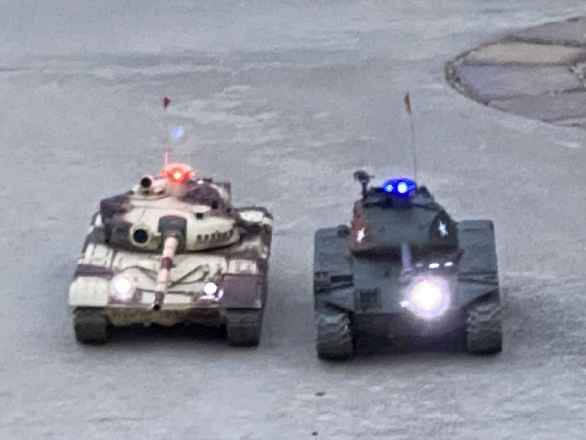

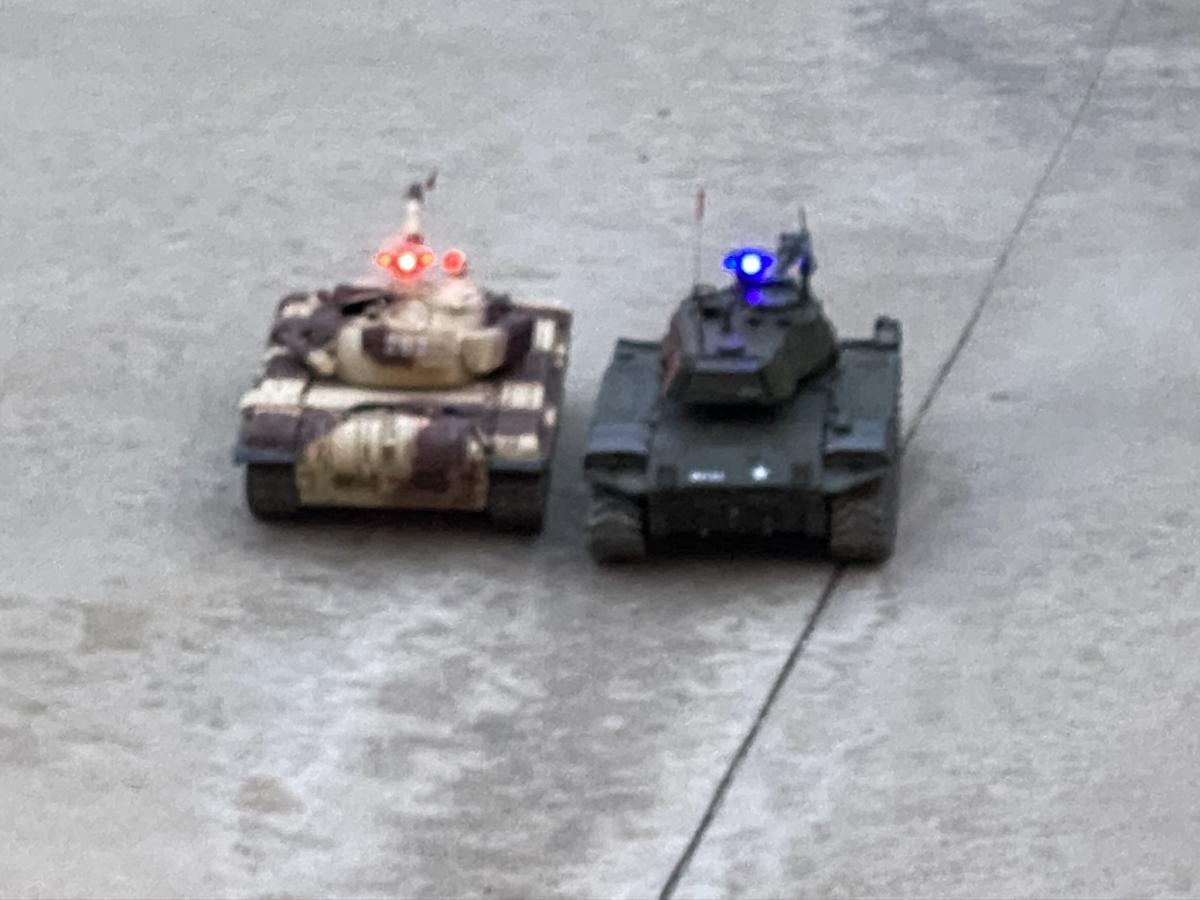

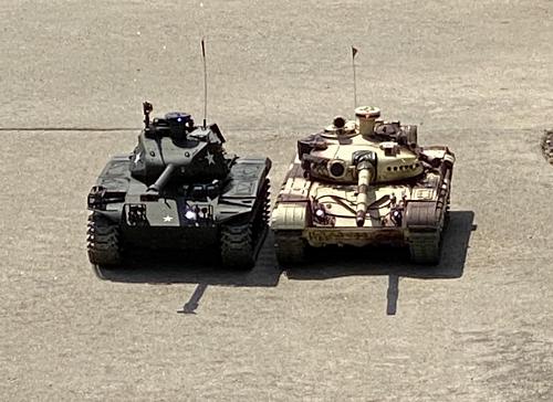

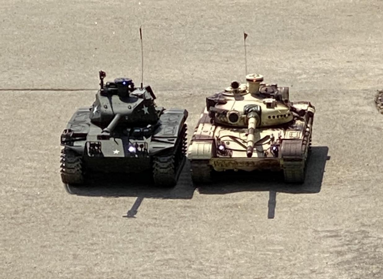

                      Here are some examples of the LED's in various light environments.
                      Bright midday sunshine:
                      Click image for larger version  Name:	IMG_0882.JPEG Views:	0 Size:	134.4 KB ID:	270139
                      Evening, from about 30' away. Compare the lights with the one headlight:
                      Click image for larger version  Name:	IMG_0884.JPEG Views:	0 Size:	88.1 KB ID:	270137
                      Same time, facing away to eliminate the white light:
                      Click image for larger version  Name:	IMG_0885.JPEG Views:	0 Size:	99.3 KB ID:	270138
                      Regardless of any actual lumens on the LED's, it's what your eye perceives and interprets that is relevant. I've left the LED's on constant, in reality they'll flash which would catch your eye.

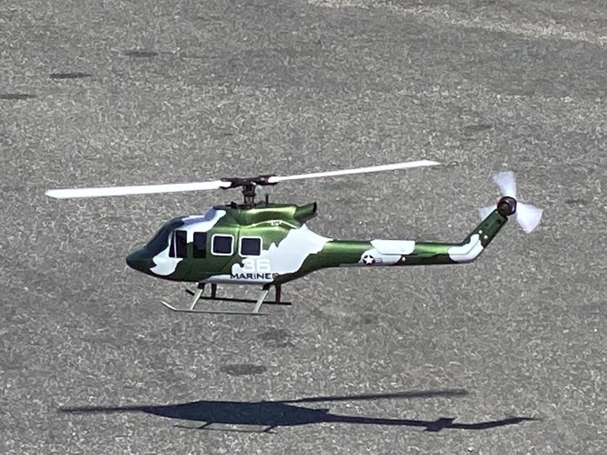

                                  Speaking of "airborne", this would allow close ground support! It would need IR emitters, but NO receivers! I wouldn't want to fall out of the sky!
                                  Blade 230S heli with a Microheli fuselage.
